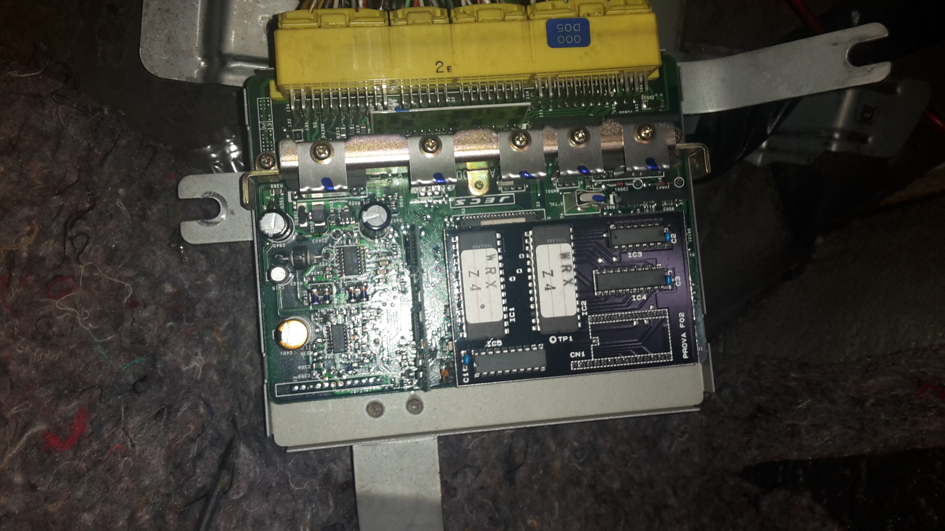

Afternoon everyone, im after a little bit of advice iv been speaking to andy forrest about getting my 1992 classic wrx mapped and he needs me to take a pic of the internals of the ecu to see if its still standard or not. Im just wondering if anyone could tell me where its located, a lad at work who prepares rally cars thinks its behind the passenger kick plate but he not sure. Thanks in advance for your help guys :biggrin:
Thanks for letting me know that phillip he said in the email that he would either have to fit an esl chip or a new ecu at a cost of £700 supplied fitted and mapped so not sure if that price is just for the ecu but will find out more once i get a pic of the internals sent off to him on saurday. At least now i can say to him i kinda have an idea of how much the esl should be thanks again

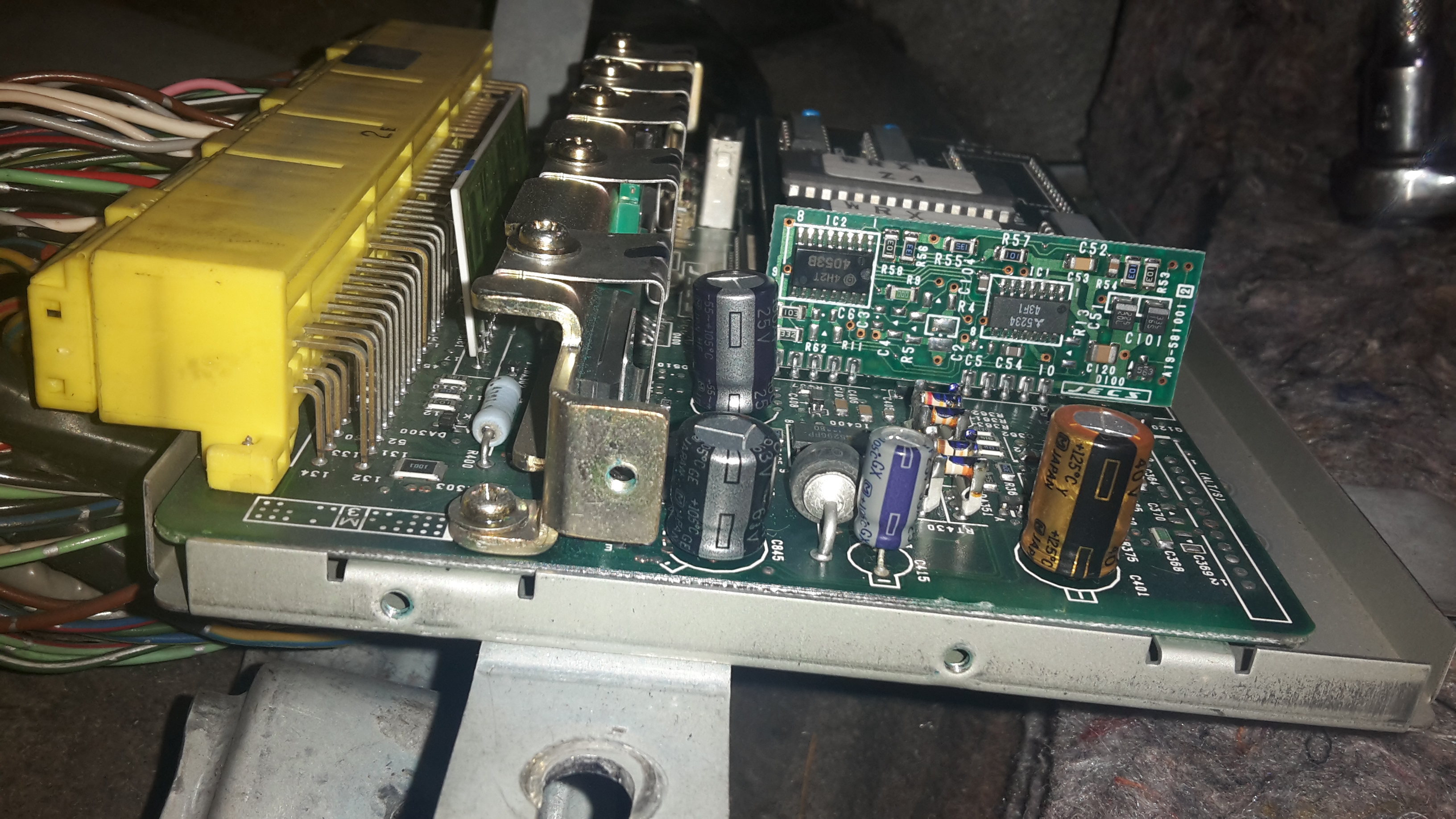

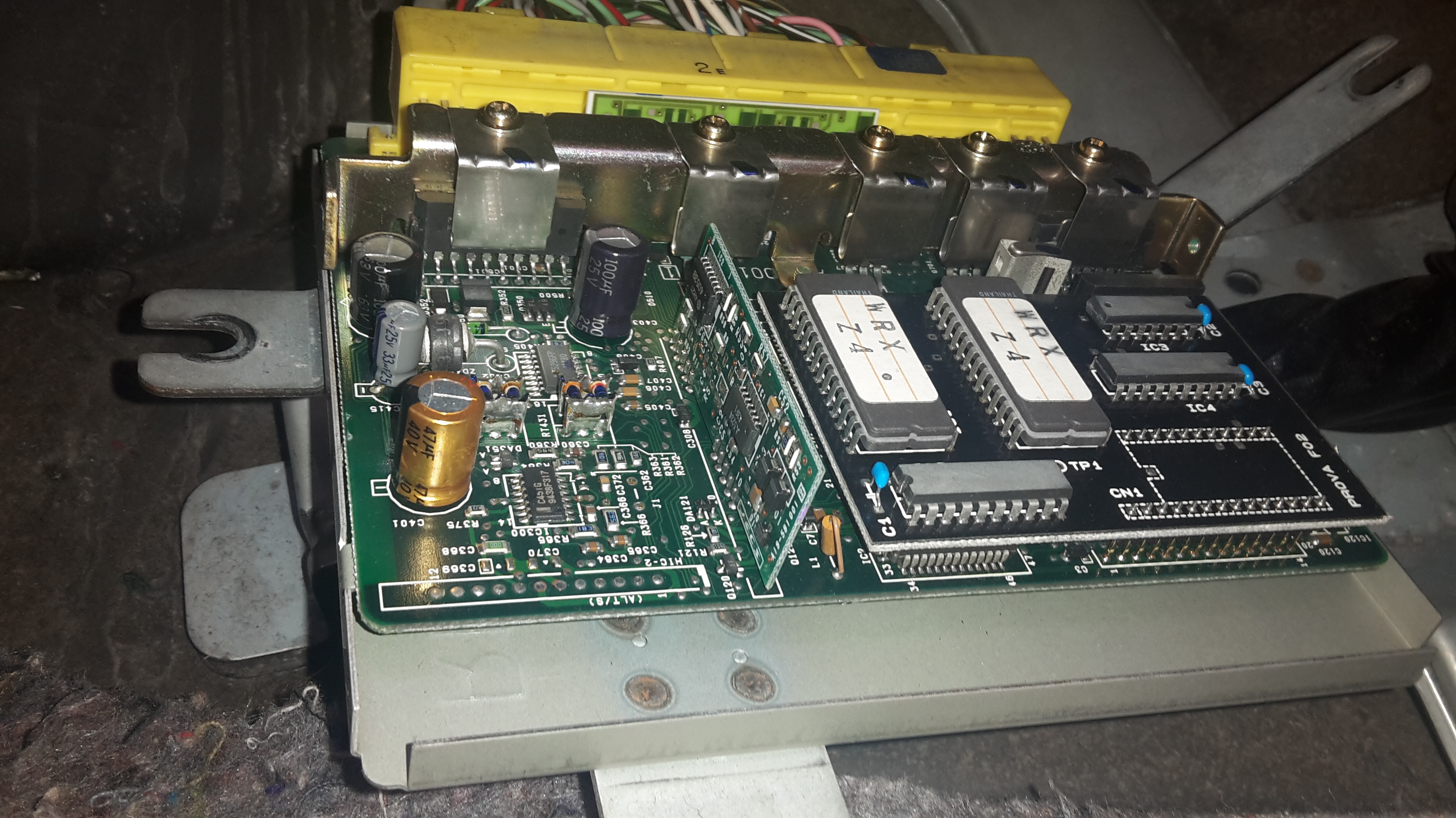

Hi everybody just a quick update, thats the pics of my ecu internals been sent off to andy and i'm holding out hope that the car has been mapped previously coz when i went to take the cover off the ecu i noticed that the screws which hold it on had already been off as they were slightly rounded off, fingers crossed i only have to pay for a remap and dyno run :smile:

Any v1 (92) to v2 (early 96) ecu will fit into your loom harness but i wouldn't just fit a second hand esl'd ecu as the map could be way off what suits your engine .
The wrx z4 ecu punches out 260 hp as standard and classic ecu's do seem to "learn" better than newage ecu's . I've personally never added a decat or changed from standard air box to cone filter without mapping shortly after . As a free flowing decat and cone will allow a lot more air in and out of the engine than the original fuel map is set for .
