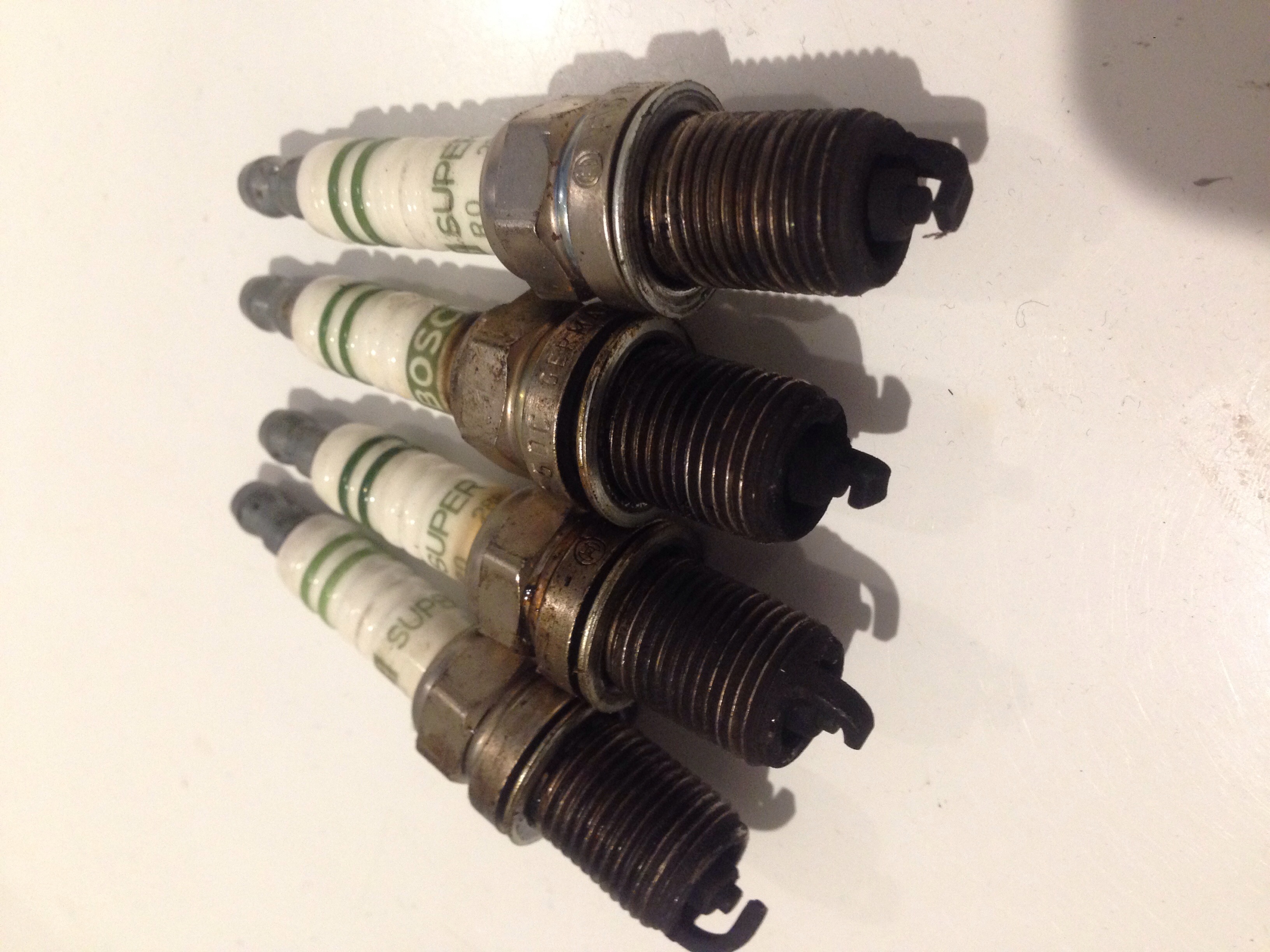

What happened was the car just cut out on me pulling it out the garden and then after that the car would only run for 5 seconds then cut out again but then after a day or so it wouldn't start at all, so I checked the maf and the top of it was full of water some how so I dried that out and it just about started so then I changed the plugs for some really cheap ones from ecp £2.30 each lol just to see if it was them then it started on the button but really hesitates at 4K and struggles to go past 4K but does eventually but to the previous question the car kept on getting started but then turned off again with the original plugs hope that makes sense to someone
Chances are it was the maf tgen mate, and once you've sooted the plugs up you've had it as the spark will just track straight down that black stuff to earth, I would imagine the cheap plugs just may not run your car properly especially on boost

Yes I will be putting a new maf on, i did put up a wanted post on here to see if anyone had one, but I'm not too clued up with all this so because the maf has gone and because I kept on trying to start the car it actually sent the plugs black is that right

Good possibility that you've blackened the plugs if it's only been running on cold idle starts and especially with possible maf issues . Regap the plugs to 0.6 mm when refitting and it should help if it's a "spark on boost " misfire making the plugs black.
