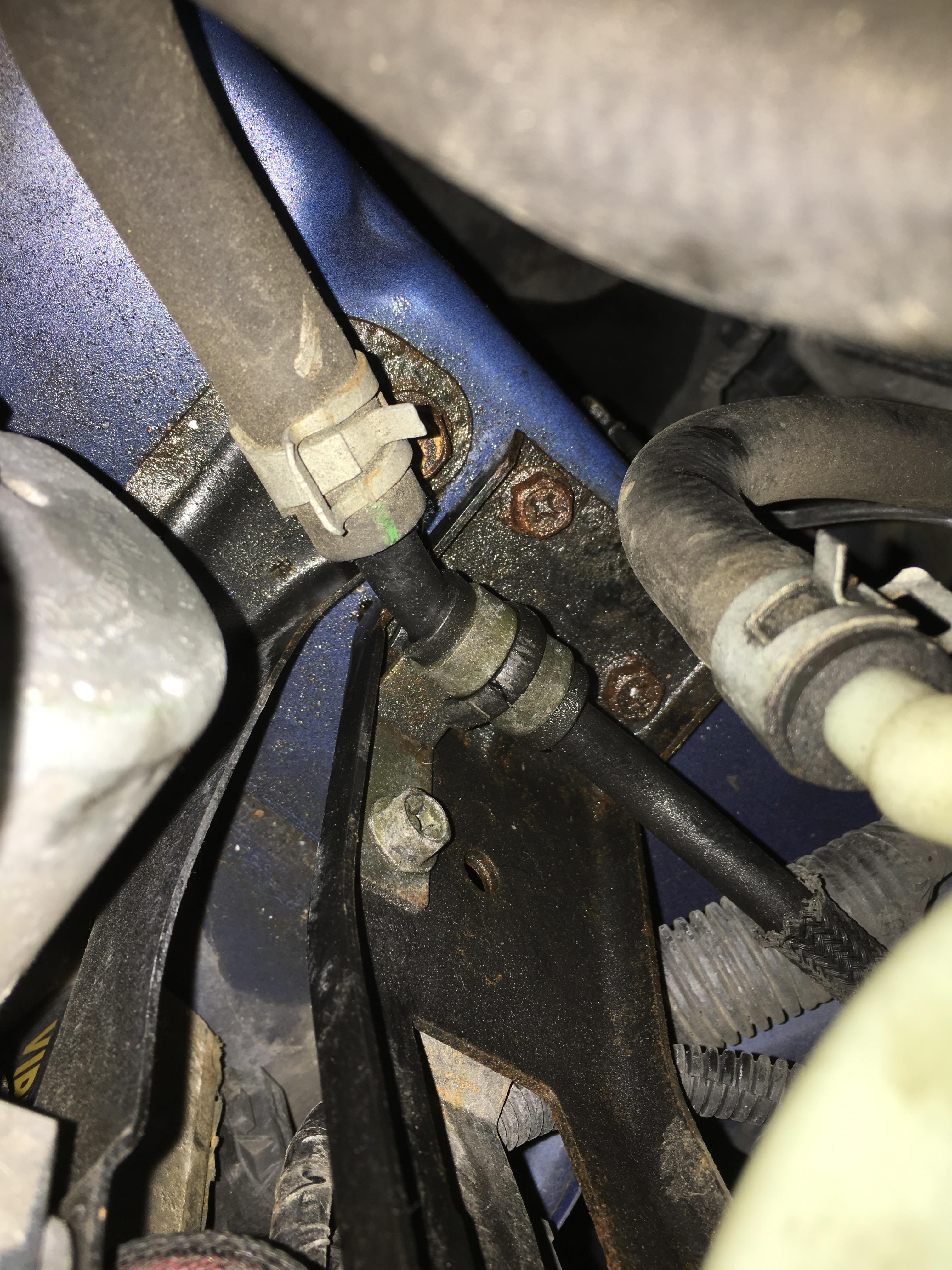

That looks like its just a little bracket to secure the pipe with the pipe running through it, it will be rubber lined so it doesn't rub through the pipe, is it wet as can't really tell from the pic 😎👍
I moved the reservoir to get a picture of the underneath, the reservoir itself looked okay and pipes that connected around looked okay too.
The bracket was a little bit wet, dabbed it with some cloth and no obvious colour so I’m not sure what that is.
Thought I was on to something then!
To lose enough to top up again after a couple of days then it should be visible however i had the same kind of symptoms with my wifes alfa and it was the steering rack seals which was filling up the boot on the track rod and it wasn't until it had filled right up and exploded oil everywhere that i found where the leak was, its just a thought though, could be worth a check 😎👍
