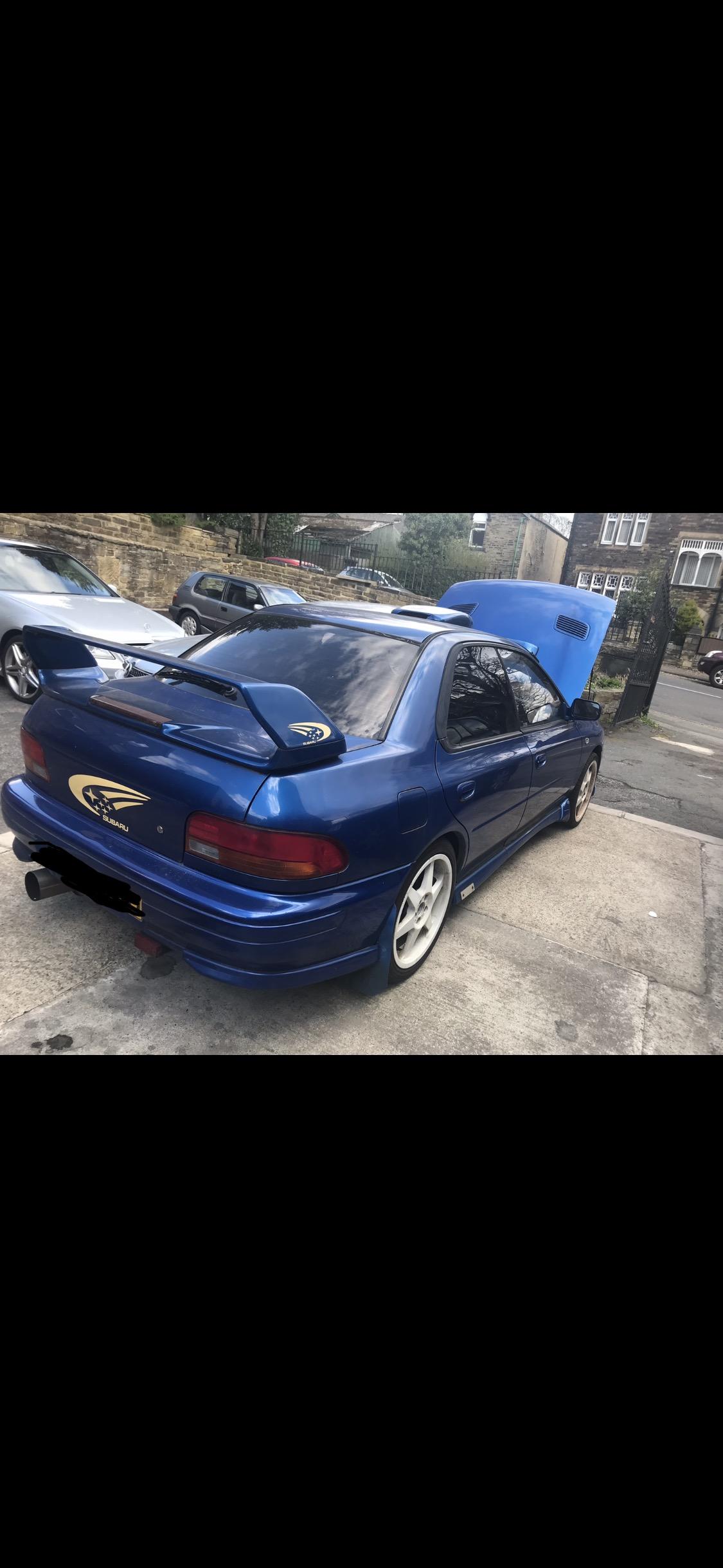

Hi everyone - I have just joined the subaru owners club and need some help. Someone probably has already asked about this issue but I couldn’t find anything on the forum so here goes. Apologies in advance
I had bought my first Subaru Impreza going back almost 2 years ago where everything was fine and she drove spot on. I started it one day after ages (barely driven it 500 miles since I’ve had it) and let her run for around 20 mins and noticed that it was overheating and had lost all fluids. There was a big wet patch on the floor.
So the next day I topped it up with water and started it and could see it was still over heating after 15 mins or so. However it doesn’t seem to be losing any water. So I started it again yesterday and the same happened again.
Now im not sure what it could it be - I’ve checked to see if there’s any leaks but can’t see anything. I have no clue what is going on with this thing. Any help will be appreciated.
This is a 1993 Subaru Impreza WRX turbo (import)
