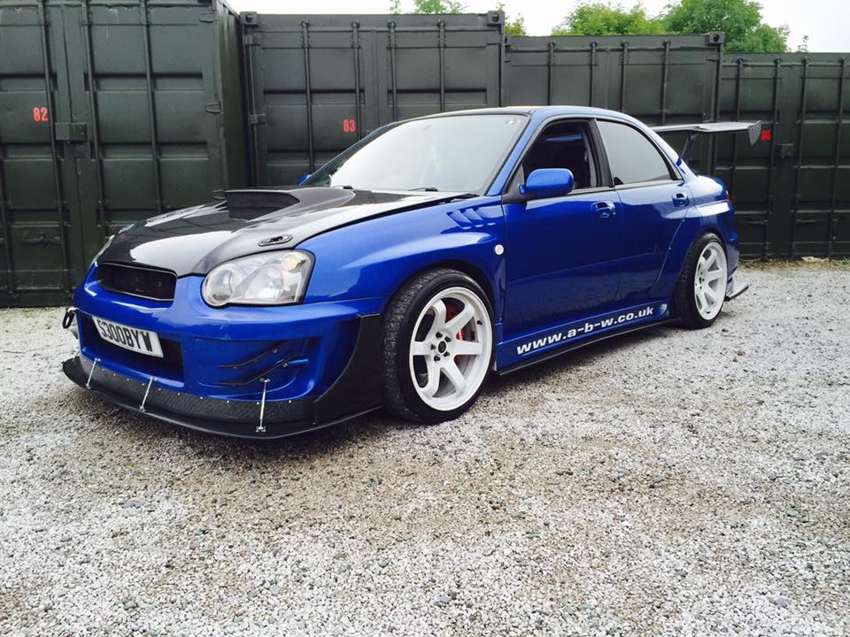

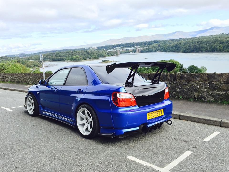

Hi I just purchased my first Subaru Impreza, always wanted one of these since a kid and finally went for it and traded my Bmw in for this beast, probably not some peoples cup of tea and is certainly a change from my usual choice of vehicle.

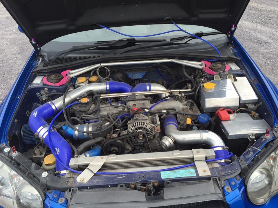

it was originally a bugeye and as you can see it's had a lot of work done to it including loads of modifications and I'm absolutely loving it, first car I have owned with a turbo as well so getting a bit pedal happy and enjoying the flutter, now the turbo also whistles when I accelerate which I read can be a leak of some sort or can just be normal but what's leading me to think it's a leak is when I come to a stop it's hunting for idle and dips a few times then will sit around 1000rpm but while its dipping the oil pressure gauge is dropping well below 2, beeping and flashing red which I know is obviously a problem if your driving along normally but is this I problem I should worry about at idle which is causing the oil pressure to dip rather than and actual major problem causing it to drop? Again I'm totally new to subarus and turbos so I'd like to get know a bit more, also it's the 2001 2.0 litre engine....just thought as well could the idle hunting be caused by the idle control valve being dirty or something? Really hoping the rough idle is an easy fix, cheers
Looks great with the number plate to match :) seems common to move from BMW to Subaru! Haven't had a turbo one yet but own an NA legacy and friend has an NA Impreza but both idle below 1000rpm
Thanks, funny enough my names Will so the W on the end of the plate actually means something now as well, I'm putting it into a garage near me and the guy there owns a scooby himself so hopefully he can get it sorted and knows the cars well, hoping it's just a dirty/faulty idle control valve or something as I have had so many cars in the past with a lumpy idle and it's drives me nuts, worries me for some reason especially with this car as the oil pressure gauge is going bananas on idle
nice one :) well come :) rear spoiler not my cup of tea :D
Welcome!
I'll have a cup of that! :biggrin:.  Very well turned out motor there. Did they cry when they handed over the keys? I would've.  Has it been rolling roaded recently?
Your idle dip is a classic icv issue so start there along with inspection of all vac hoses.  It's a process of elimination really but come back and let us know.
Right up my alley that mate im not sure if ive lost top spot as the clubs largest spoiler award now ...
Lovely car mate
looks great, really like that pal!
I have also just gone from BMW to Subaru, I bought one cheap needing work though, must admit missing my beemer but only because this isnt on the road yet!

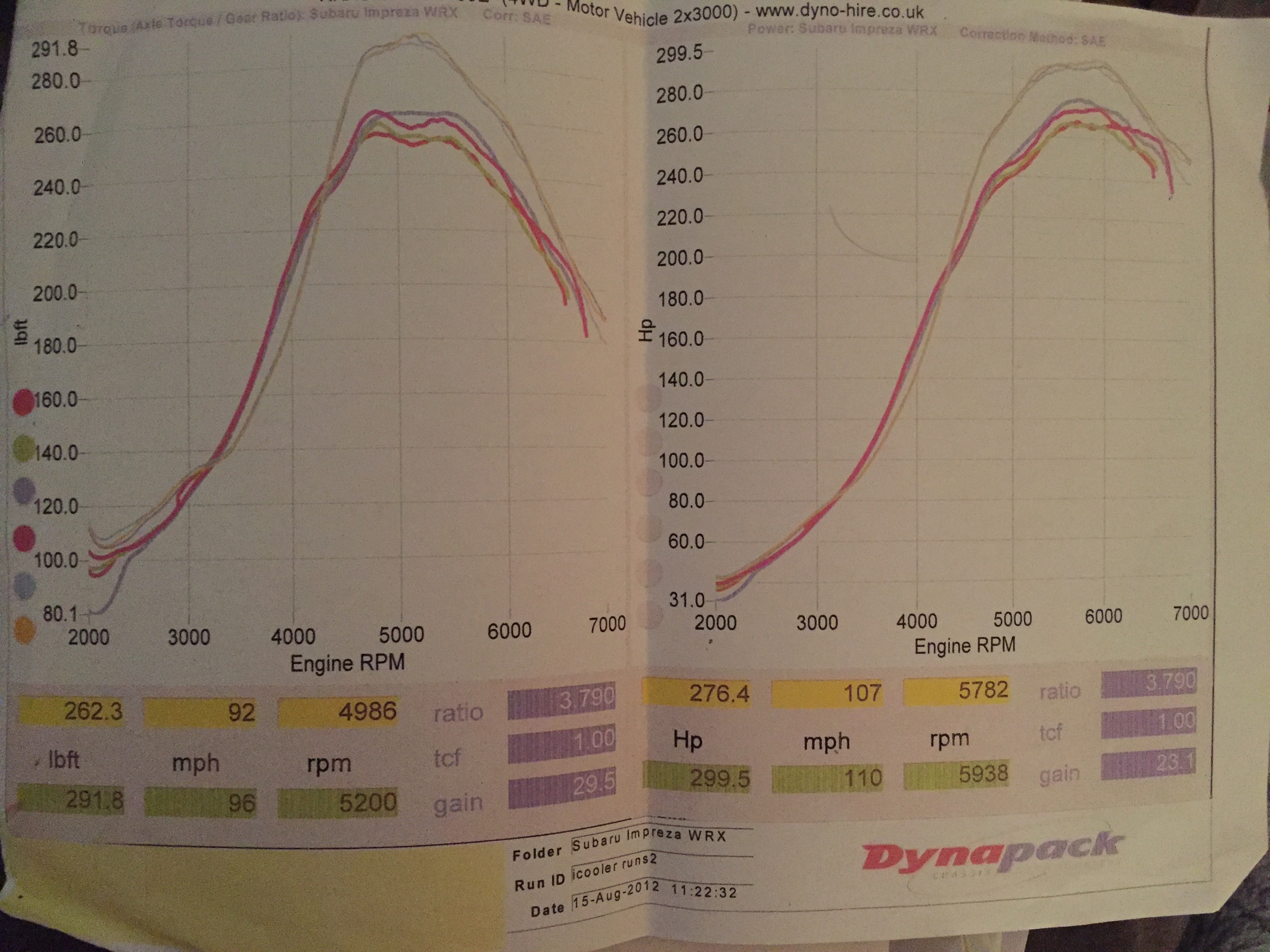

He was quite gutted but he got my old Bmw and a bit of cash so I'm sure he's over it lol also I'll put a picture up of the dyno printout

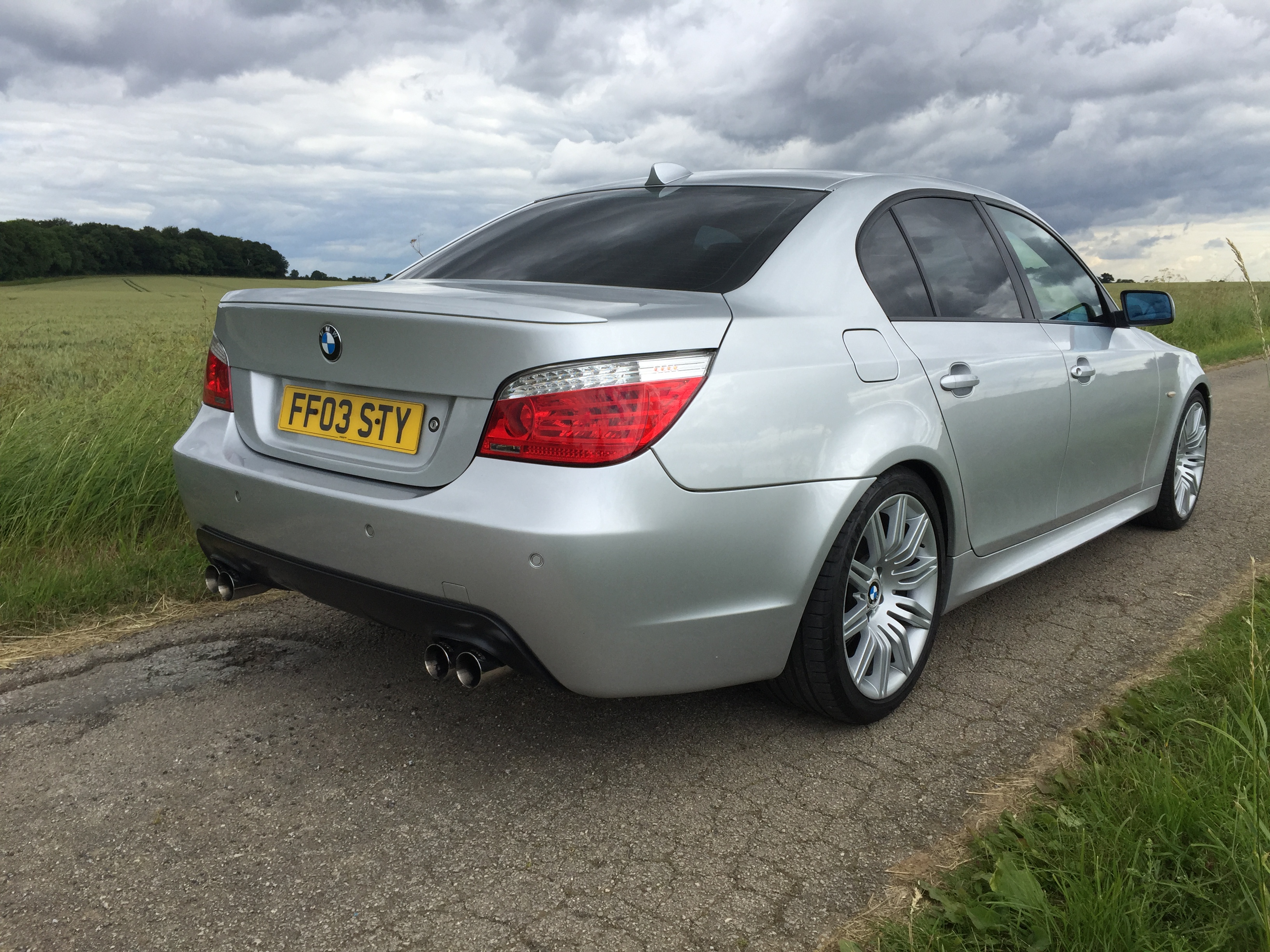

@Will I had the E60 530d m sport, was running 300bhp and 705nm, so it defiantly moved! pics just to show.

She gets hot as well in traffic, goes to around 100 celcius on the oil temp gauge which worries me a bit just hope it's something simple as it runs nicely around 90 celcius but anymore and I can tell it's not liking it
is the fan kicking in as it should?
@donnylad yer it is kicking in around 100c, when I start getting a bit of speed up for air flow it'll cool back down to 90c but again as soon as I hit traffic or slowish town driving it goes above 90c, I'm not sure weather I need to find a way of keeping it around 90c constantly or if there's something wrong causing it to go above that, maybe the idle dipping but not sure that would be the thing making it get hot?

Whats the issue with oil pressure at idle,
have a google of "wrx oil pick up problems"
@Piggysniffer basically when the car starts warming up and I come to a stop at traffic lights etc it'll dip well below 1000rpm which brings the oil pressure right down because obviously the engines about to cut out, it does dip when cold as well but because it's cold it's running just above 1000rpm so when it dips it's still at normal rpm but anyway I'm wondering if the problem with it getting hot in traffic (going over 90c) is down to it hunting at idle also I have done quite a lot of googling and come up with a list of things to check so hopefully next week it'll be all good as I'm hoping to put some more money into it and get the car looking mint and sort a few minor bits out so I'm confident to take it to shows and maybe a run to the Nurburgring some time soon :)
Does it bring the oil light up on the dash, if so that's not great as that is set to about 2psi apparently and we need about 10psi for each 1000 rpm, I think my hawk tickover is about 750ish, does it take a while for the oil light on the dash to go out when you start it or is it pretty much immediate, also, if you turn the car off and ignition lights back on after starting, how long before the oil light shows back up
The oil light doesn't come at all it's just the pressure gauge dipping right down when the idle dips so I'm hoping the idle dipping is just the idle control valve or something which will stop the pressure dropping, I'm hoping it's not the heat problem causing the dipping etc but rather the other way round so the icv sorts it all out...I dunno but I'll find out Tuesday from the garage, it's going to Smd near me and they seem to deal with a lot of turbo cars and high powered drag cars plus the bloke running it has a scooby so should no the cars well

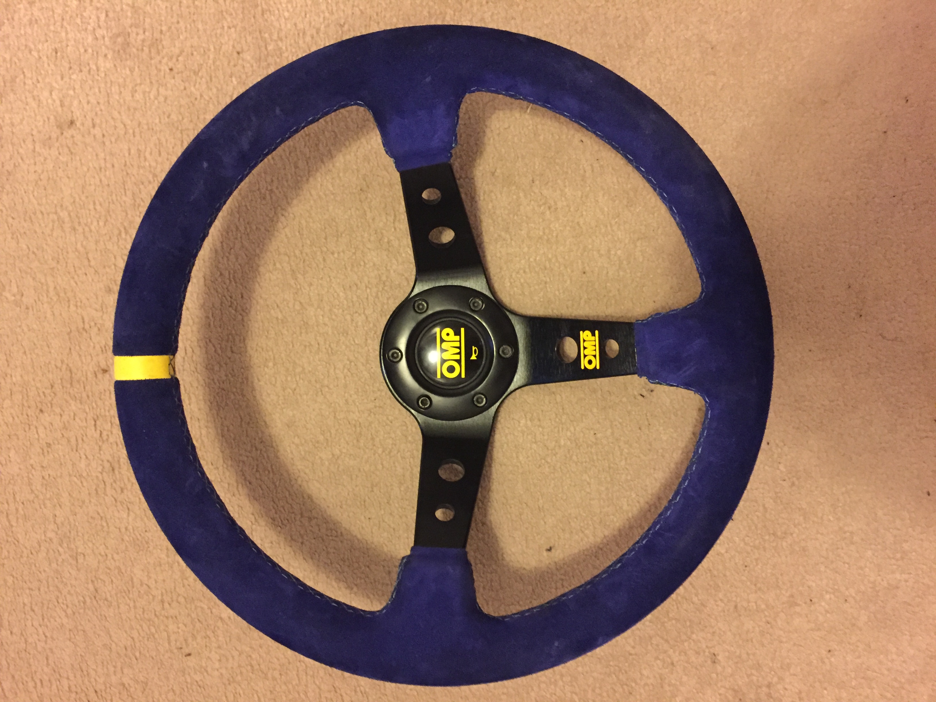

I also found out the cars been undersealed as well which is ideal, plus my Subaru owners club stickers turnt up so looking forward to getting them on the car and getting some more pictures up and I ordered a blue omp steering wheel so hopefully that'll be here this week at some point.

one thing is though the idle is still playing up and dipping along with rising so I'm hoping it's just the iacv needing a clean up, gonna order a gasket it in the next couple days and get that sorted but it's causing the oil pressure to dip and sometimes cut out so I'm slightly worried but the cars keeping a lot cooler than it was, also the guy in the garage said the cars remapped to let the fan kick in a bit to late which is something I need to sort, really want it perfect so I can happily take it to shows and meets etc and feel confident.
