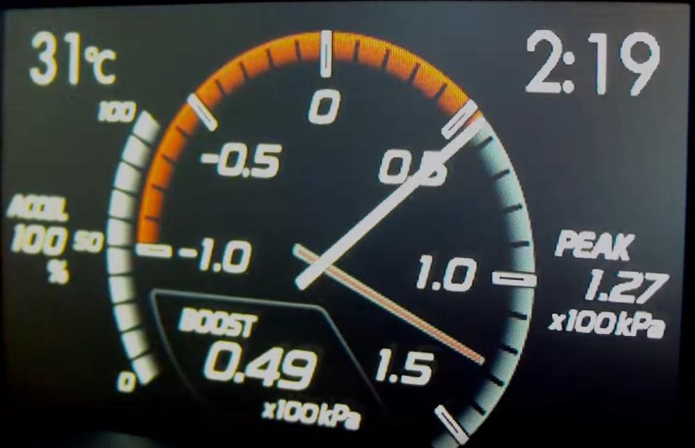

Think it was Scooby Pete that measured the boost in the different modes, i-mode gives you 0.5 bar, Sport gives you 1.0 bar S# gives you 1.5 bar - its in a post on a similar discussion somewhere on here so you will def feel a difference. Also Salsa initially found running in sport mode gave 2-4mpg difference - I found the same on mine, sport mode should really be the default mode

My understanding is that the Si settings simply change the throttle maps and don't change the 'power output'. Max boost will not be changed directly by these settings. The throttle is electronically controlled so the Si simply controls how quickly the throttle opens in relation to the pedal position.
I agree that compared to other tubo cars I've owned in the past, there isn't that real shove in the back when the boost winds up. That is more due to the fact that ECU maps and turbocharger technology etc has improved significantly over the years and car manufacturers want smooth linear power delivery. Doesn't mean to say the car is any slower - just feels that way due to the way power is delivered.
Peak boost in any gear/setting is recorded as 17.6psi (122kpa or 1.2 Bar) on my vehicle. Unless the car mentioned above has been modified from stock, you are not going to see 1.5 Bar unless something is very wrong :unsure:

I can't get 1.5 bar no matter how hard I try, this normal ? Only seem to get 1.2
boost is only 1.2 as stock I believe as thats all I got out of the one I'm picking up this weekend when having it for a few days also Ive been told to turn traction contol off makes a big difference
Why display up to 1.5 on the boost gauge ?
