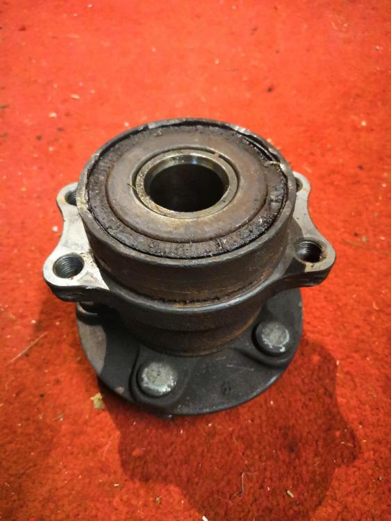

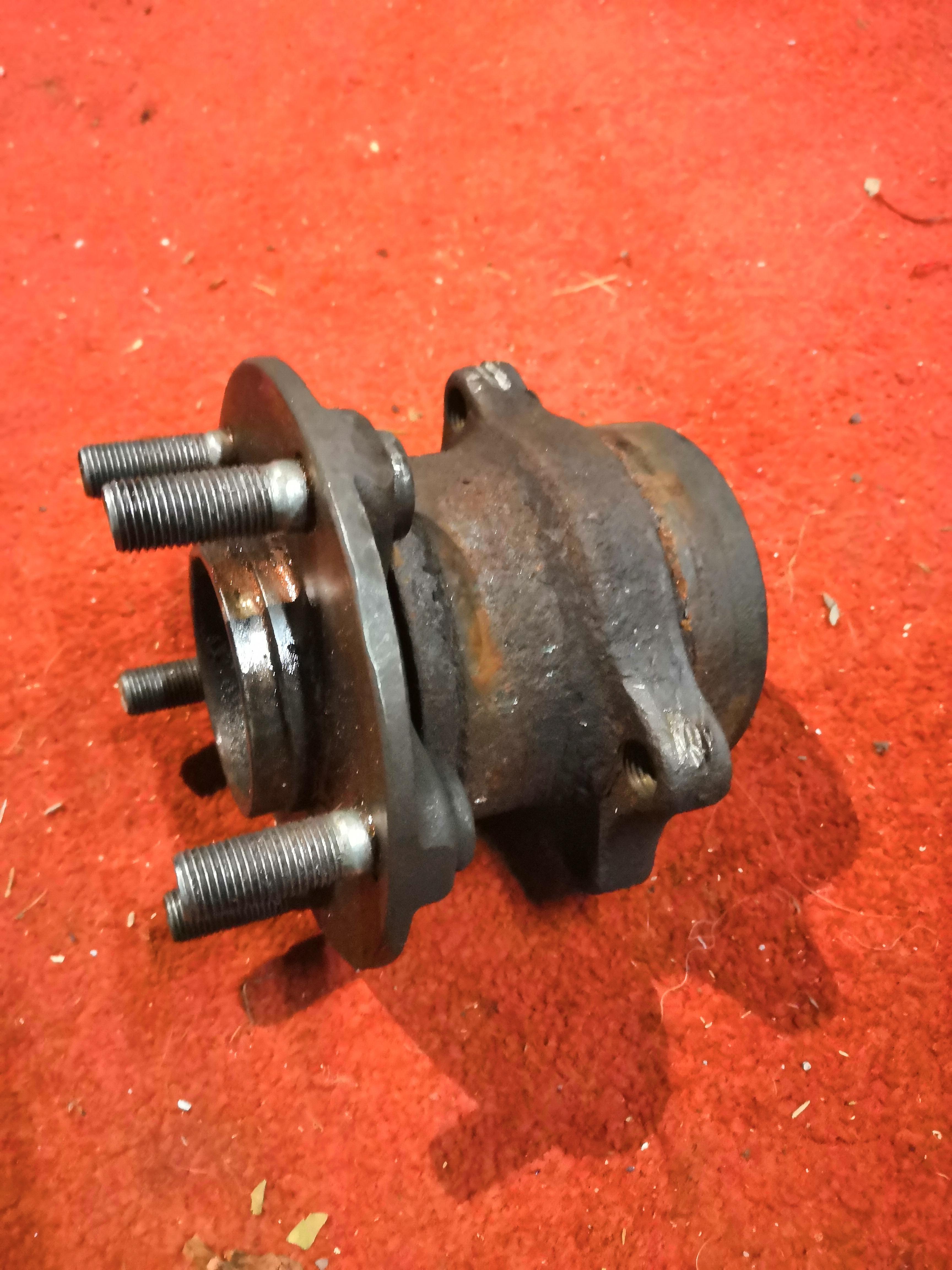

So our XV (2012) has just hit 70,000 miles and a couple months ago one of the rear wheel bearings started to go bad. It was just before the Mot and I didn't have time to deal with it so let the Mot garage do the work. To get a subaru part was going to cost ~£180+vat so they ended up fitting an aftermarket part for around £120 + 2 hours labour. Anyway fast forward a couple months and the other side starts to rumble. I managed to get a subaru one from ebay for the price of an aftermarket one, and with some spare time thought I'd have a go myself. Last weekend I watched a few YouTube videos and started taking things apart. All went well until the final removal of the assembly. That thing would not budge! I spent a couple hours trying everything to get it out with no luck. As time was marching on and my wife needed the car the next day I soaked what I could with penetrating spray, cut my losses and put it all back together. Fast forward to today. Having a better understanding of what I was getting myself into I went down to my friends unit so we could use the lift and have a better go at it. To start with we tried the same deal, put the 4 bolts through loosely from the back and hit them with a hammer. No go. Put everything back together loosely and roll car back and forward left and right to try and break the rust. No go. Three prong puller on the drive shaft/axle. I stopped when I thought I was going to wreck the CV joint. In the end we had to release the two non pillow /ball connections to the suspension (of a toltal 4) so we could get enough movement of the hub to pull the axle out. After that, bolt it all together again to hold it firm. We then tried another puller but couldn't get anything solid to pull against. Eventually it came down to getting the biggest socket we could onto the back of the housing and hitting it as hard as we could again and again. Anyway, once it popped out, I cleaned up the rust put a large amount of copper grease on and put the new one in.
So in short. If you have some rust on your car, don't trust the YouTube videos, and be prepared to get some use out your big hammer. If it doesn't go easily you might have to go to pound town on it.

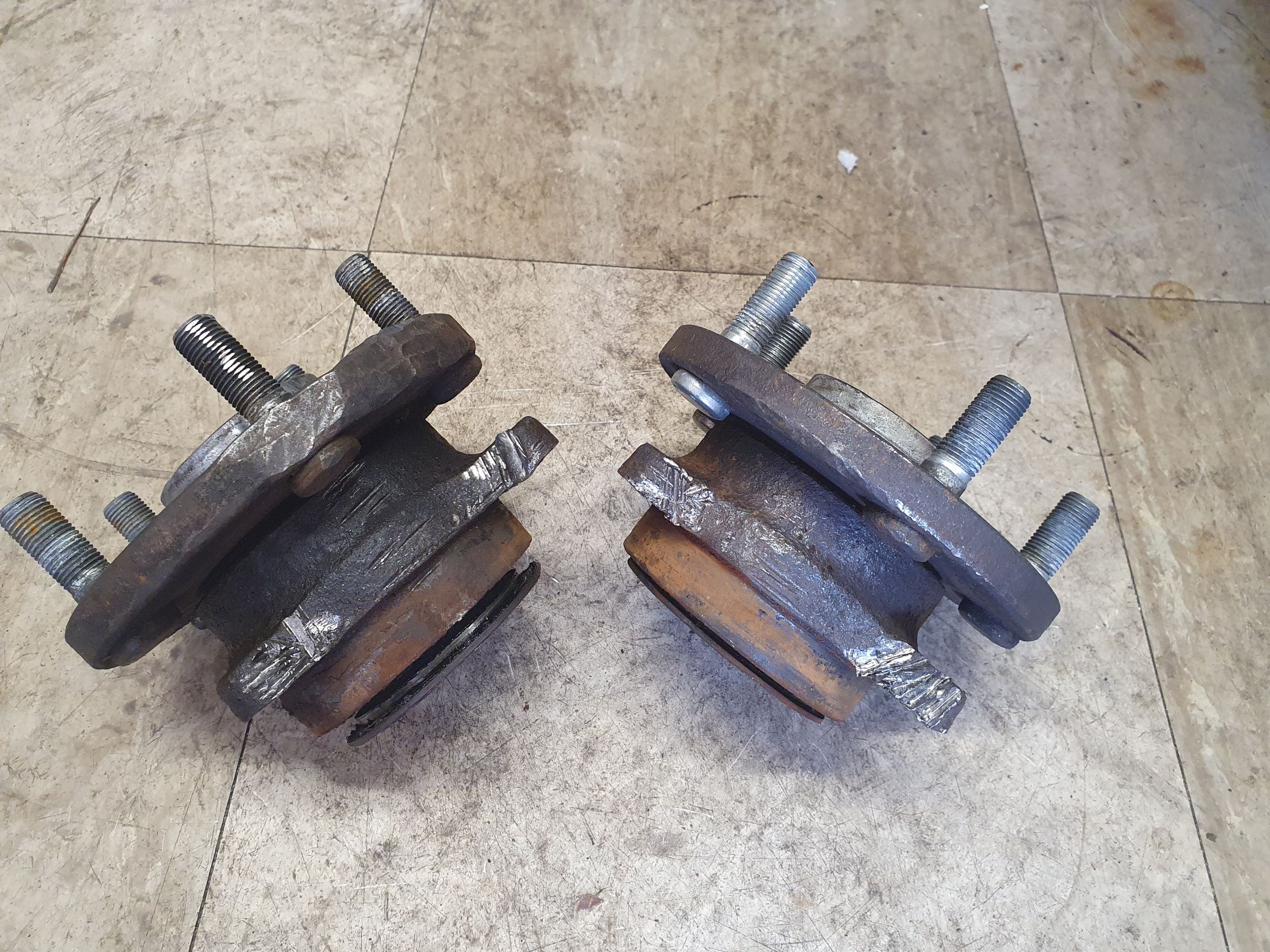

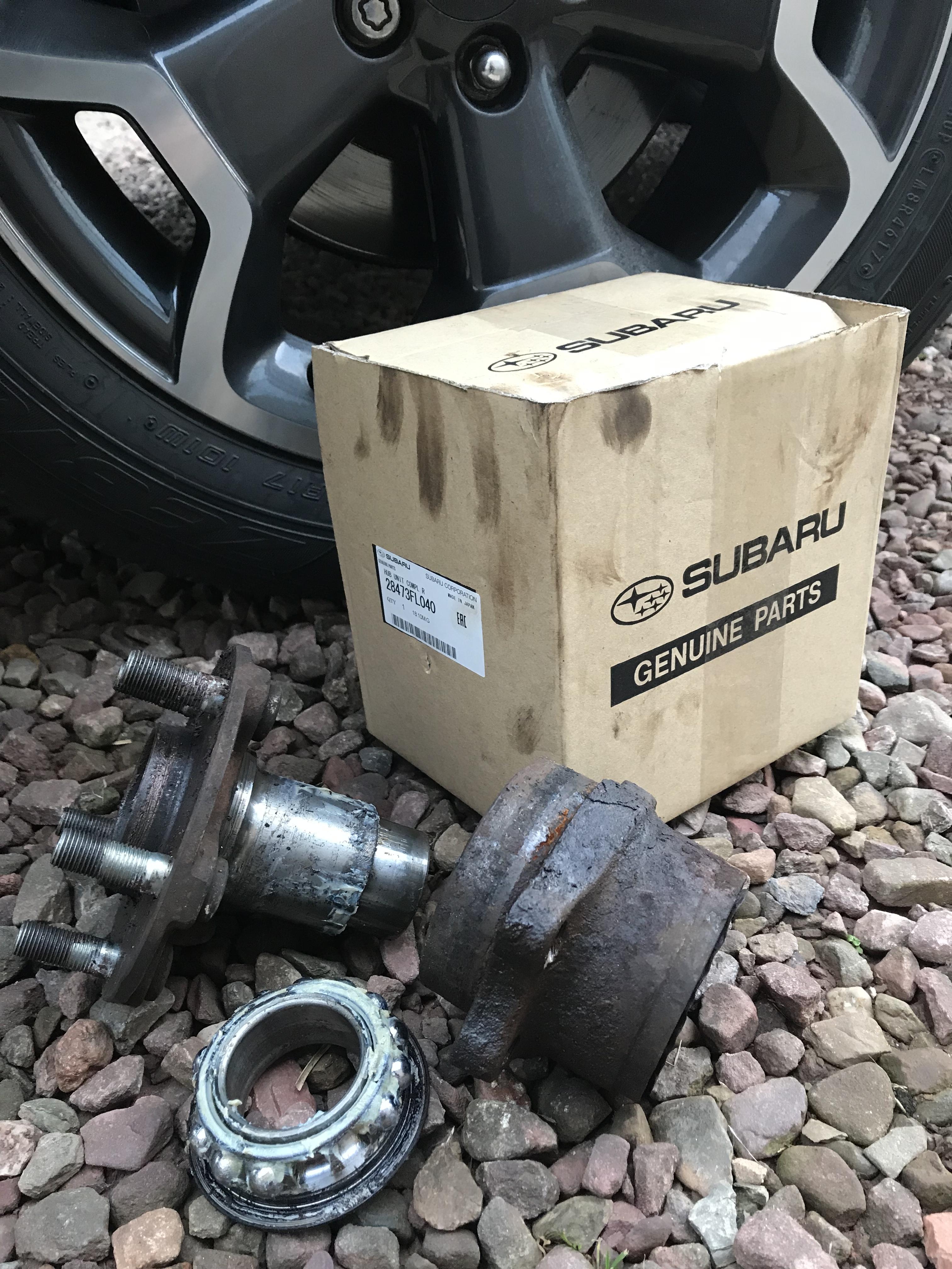

my dad and I replaced the n/s/r hub today and the old one looked like this when finished 🥵😳
Wow, that looks like a lot of brute force went into getting that out! How many miles were on the car for them to look like that?
That looks to have been a real pain it the BTM!
Yes plenty brute force just what you need when doing the job on the driveway!!!! NOT!
63k on the clock but that corner did take fair thump from a pothole just recently 🥺

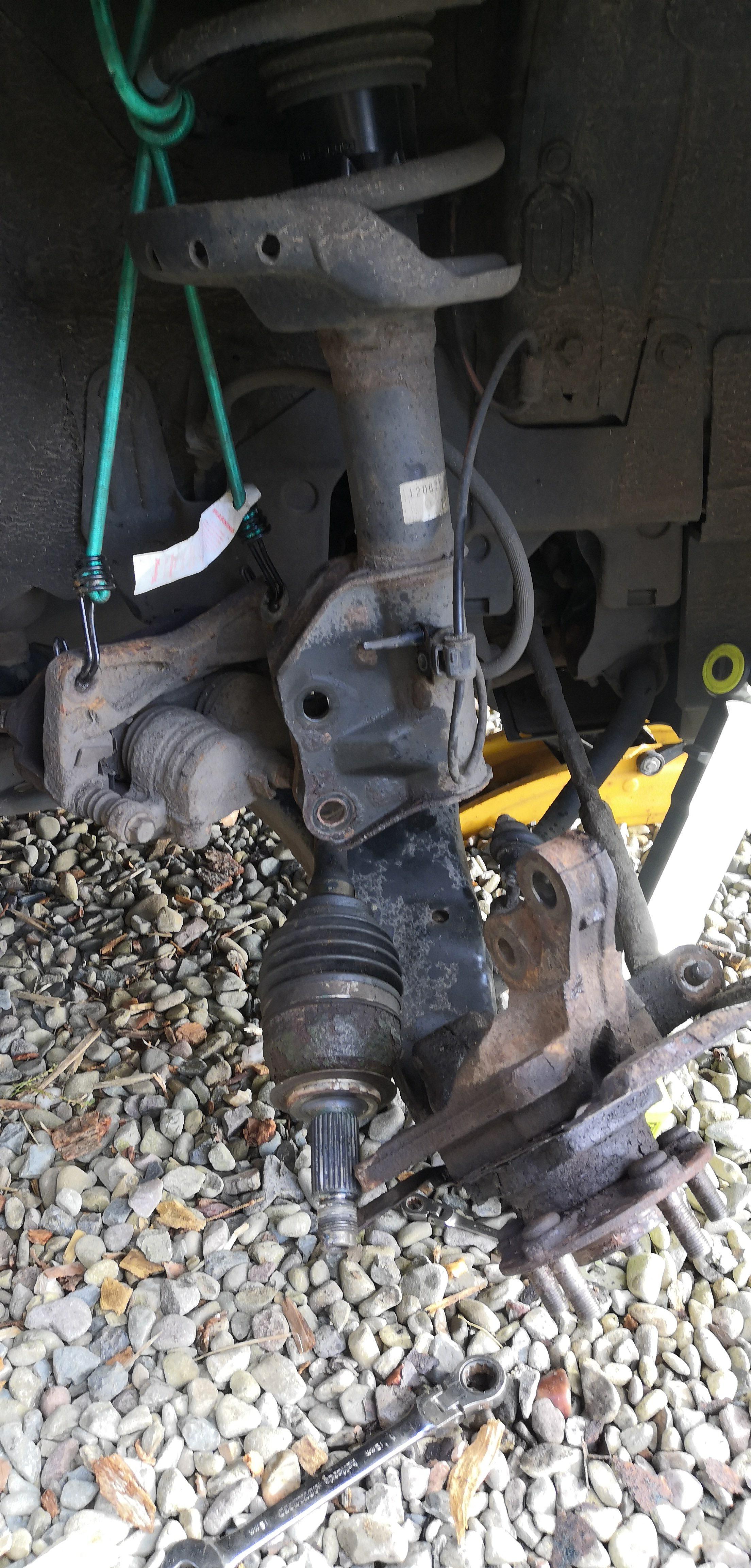

Had to do the front right wheel bearing over the weekend and was dreading it! It actually ended up being not too bad. Still had to do a fair bit of deconstruction to get access, but managed to chap it out using the 4 bolts. Maybe the fronts just get less rust? Was about 4 hours on the driveway with a bit of tea drinking while waiting for the hammerite to dry on the brake dust shield.
Fingers crossed if I have to do one again it's this painless.
yeah front always cleaner as engine heat keeps it more dry .
More you do better methods you get on dealing with it, backs can get so bad very hard deal with at home with minimal tool options .
Best thing can do is spray all bolts/joints with a spray can of waxoyl or similar as makes night and day difference to corrosion level and lubes the threads .

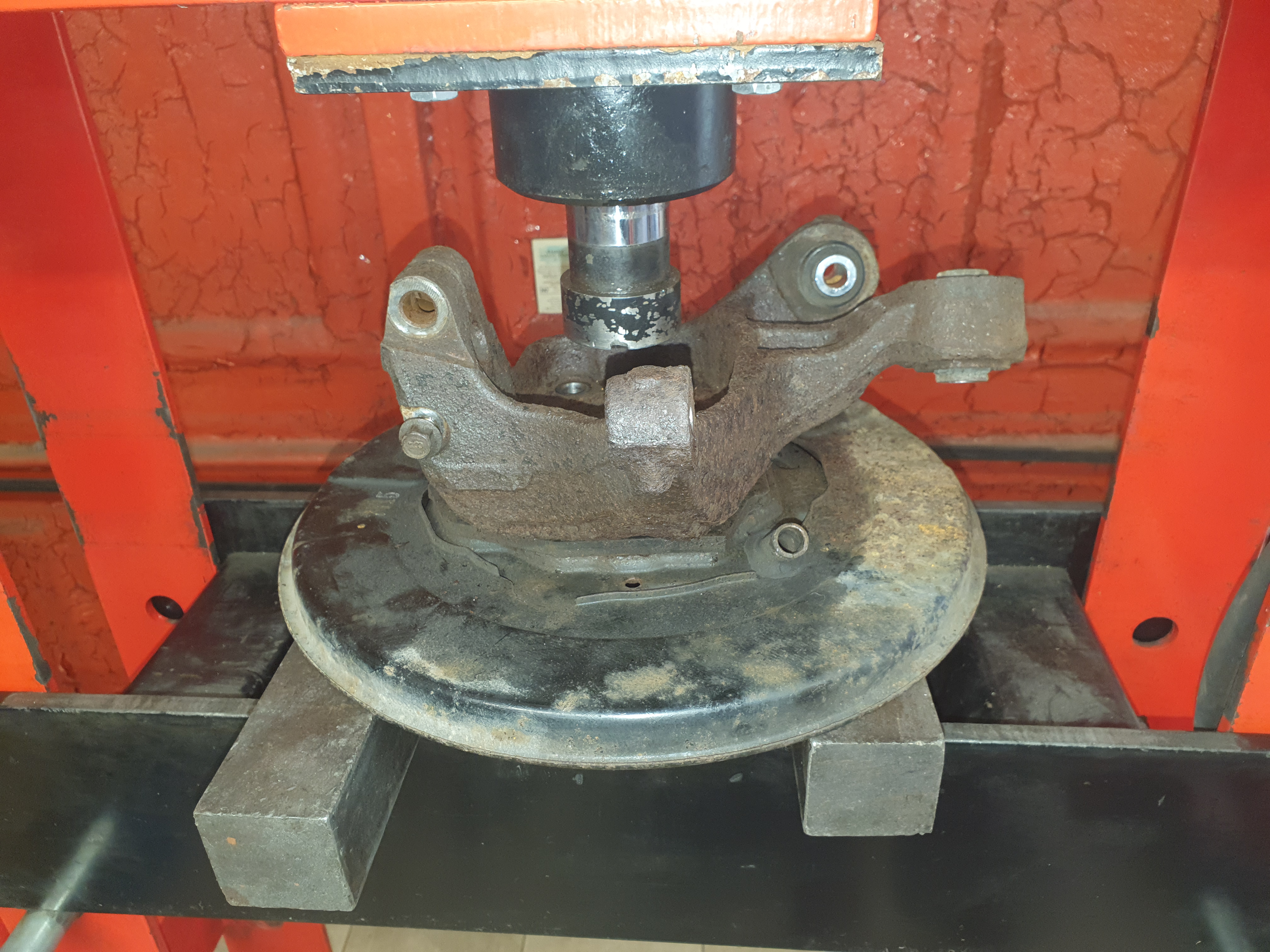

I soaked mine for a week in plus gas then it took 11t in the press to shift it.

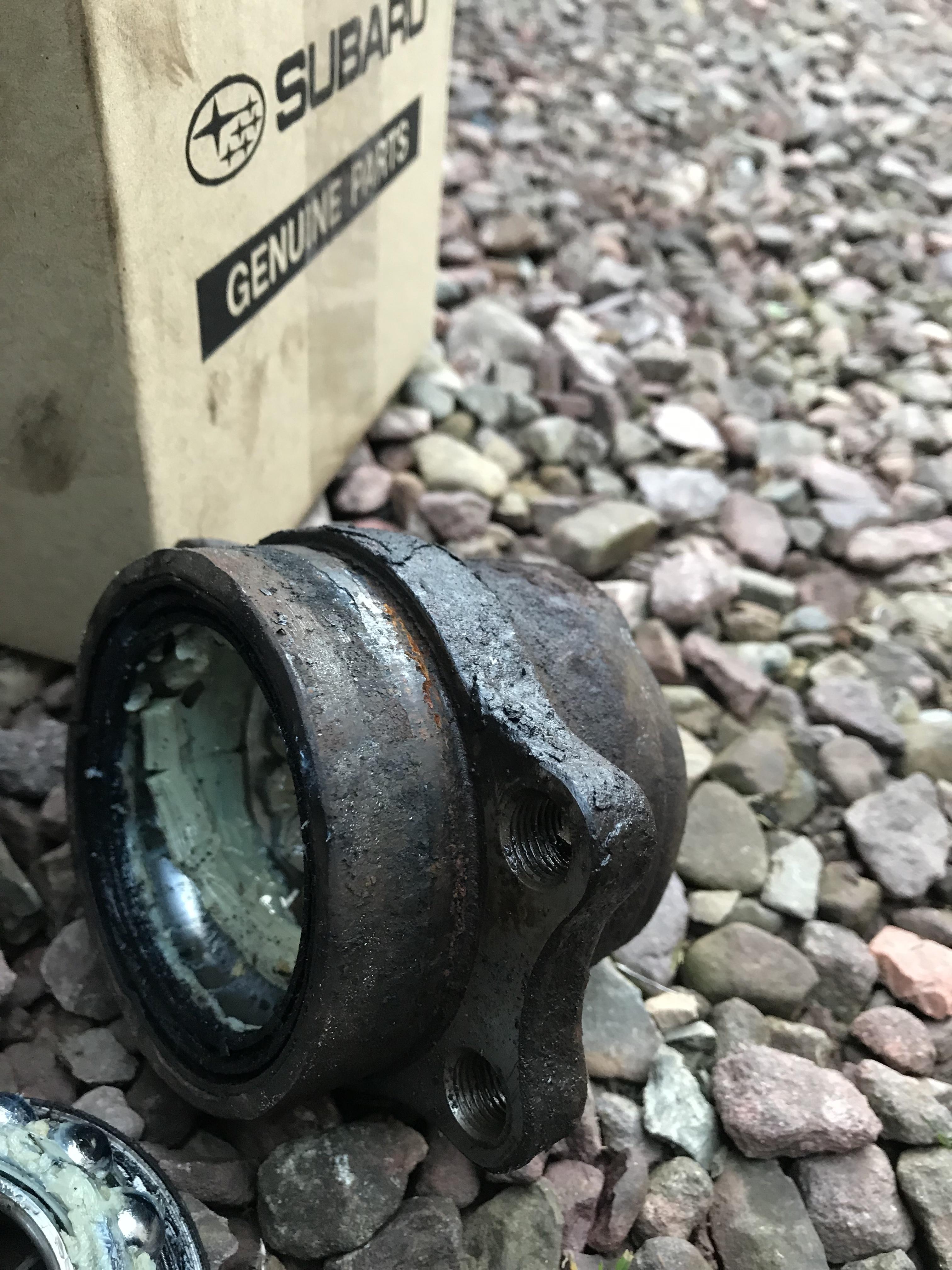

When it came to the fronts I approached it in the way suggested by Mr B with his air hammer and lots of heat. initially a lump hammer and bolster would not shift it and as I didn't have an air hammer I used my SDS drill with a chisel bit.
They did yield eventually but you can see the ring of rust, that was also matched on the hub as well they just go solid. I get the impression Subaru just assemble them dry.
They are just a nightmare task unfortunately
The most time effective way of dealing with them is replace the hub and bearing at the same time, far quicker but costs more in parts. The trade off is garage labour cost vs parts - Is the cost of a hub relative to the labour time spent removing the bearings worth it? Down to the individual for that choice
Wow, interesting photos that clearly show the effort to get those off. This seems to suggest that the design/assembly procedures does not make any effort to think about maintenance.  Sadly, this does look to be a problem with many parts that might need replacement, e,g., spark plugs.
