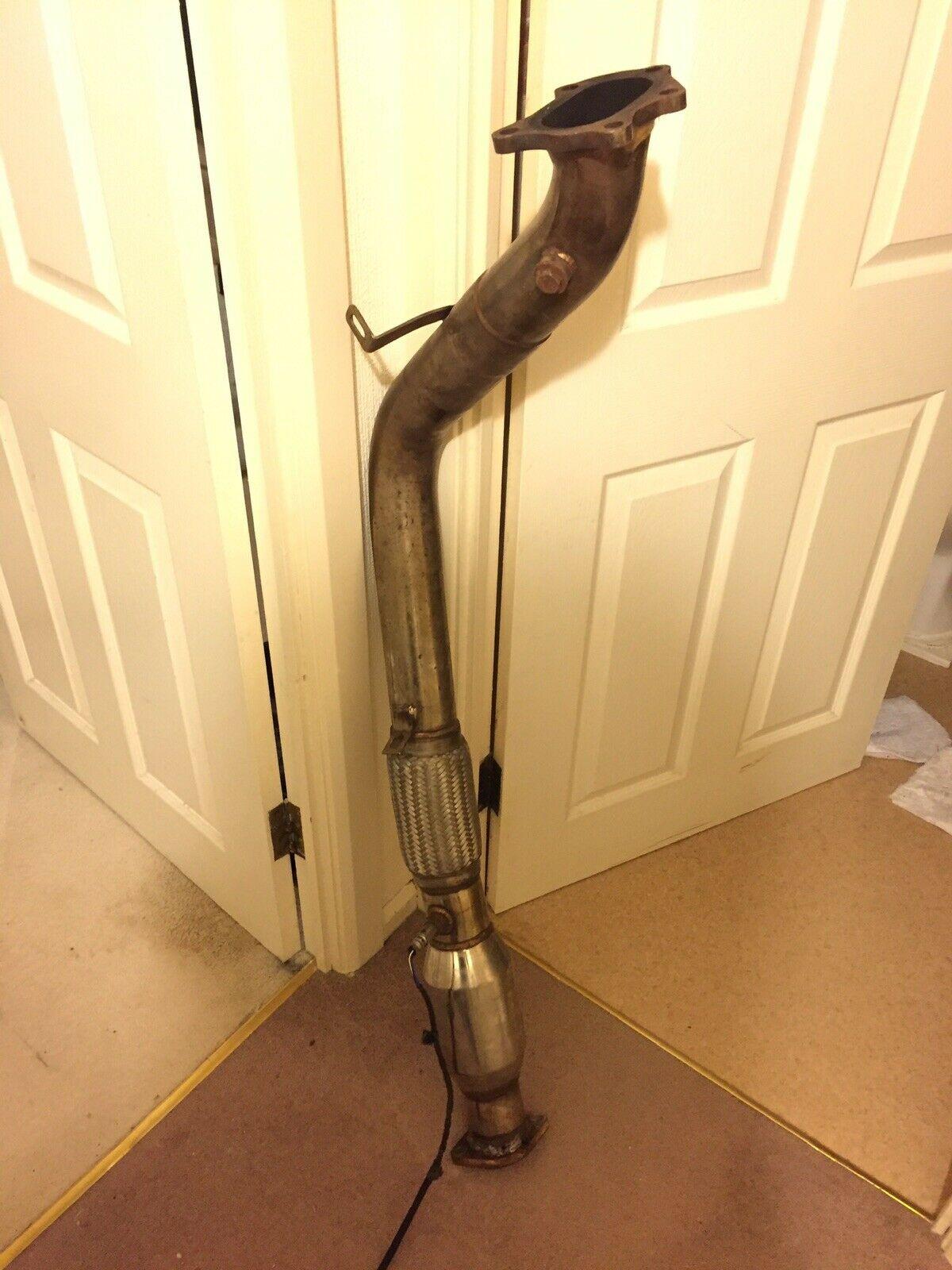

As the title says, I have a down pipe with sports cat to fit (I already have a cat back fitted), my main worry is will it over boost and damage the engine if I don't get it remapped. I know it's advisable if fitting a full de-cat, but not sure about high flow cat.

Everything's fine with the cat, the down pipe and sports cat where a bargin off ebay, only paid £77. Had been looking at a Cobra one at £430 so just bought it on impulse really.

If I wait to fit it, whats the best way to store the downpipe for 18 months?
Not heard anything about flexi being a problem, could you elaborate a little please.... Do I need to start a new thread 😵
I've just discovered this exhaust is made by Toyosports, aka questionable quality, putting it politely. It won't be getting fitted.
