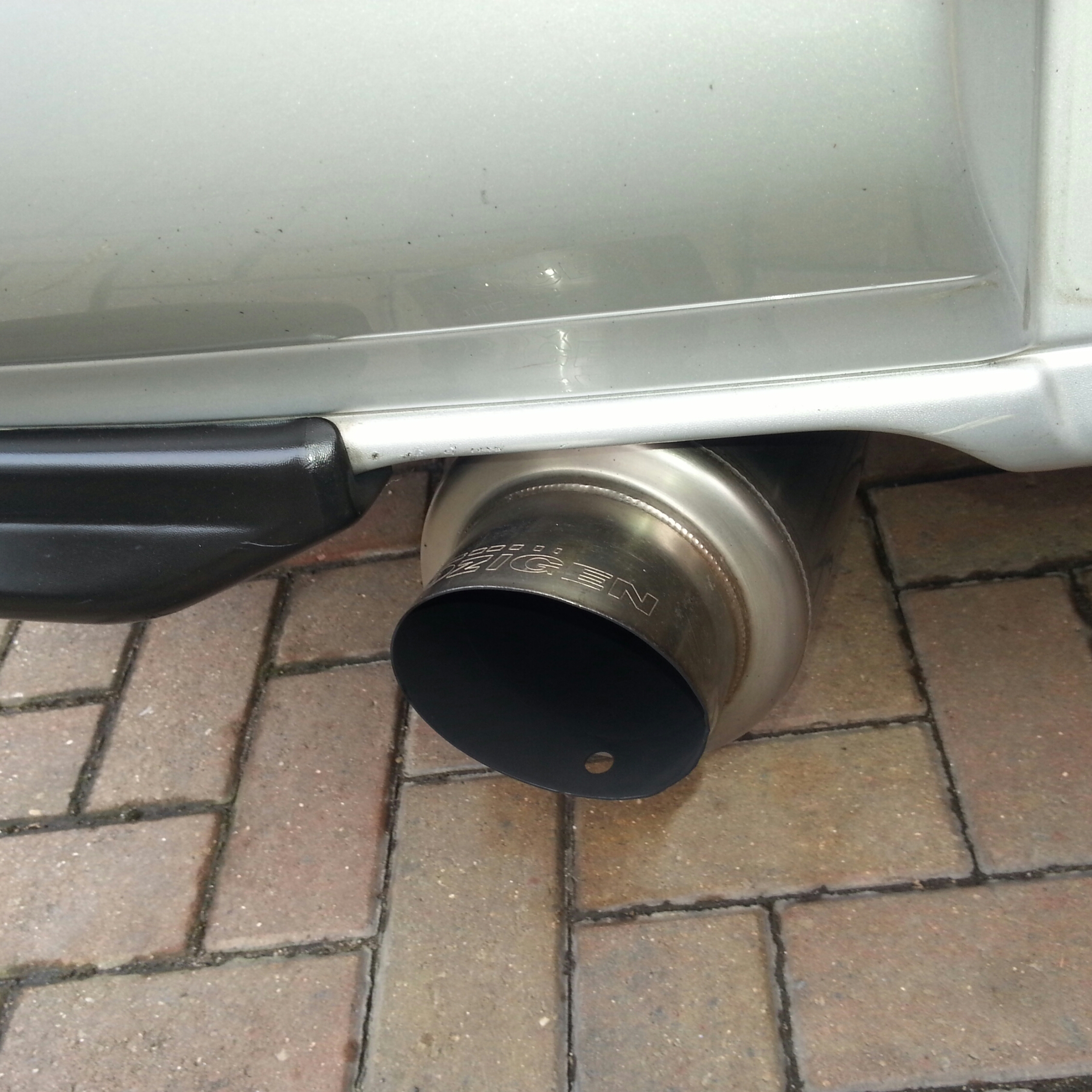

There's a lot of wind noise and attowe's dyno cell is a sealed room but It's !Removed! brutal over 3 k [emoji19]
It wasn't too bad before I fitted the cusco downpipe .
The mrs likes it and it stops me doing over 3 k unless I'm on a slip lane [emoji6]
I'm wondering weather to get rid of one of the resonators in my centre at idle everyone else's drowns nine out and i've never heard it on a drive by

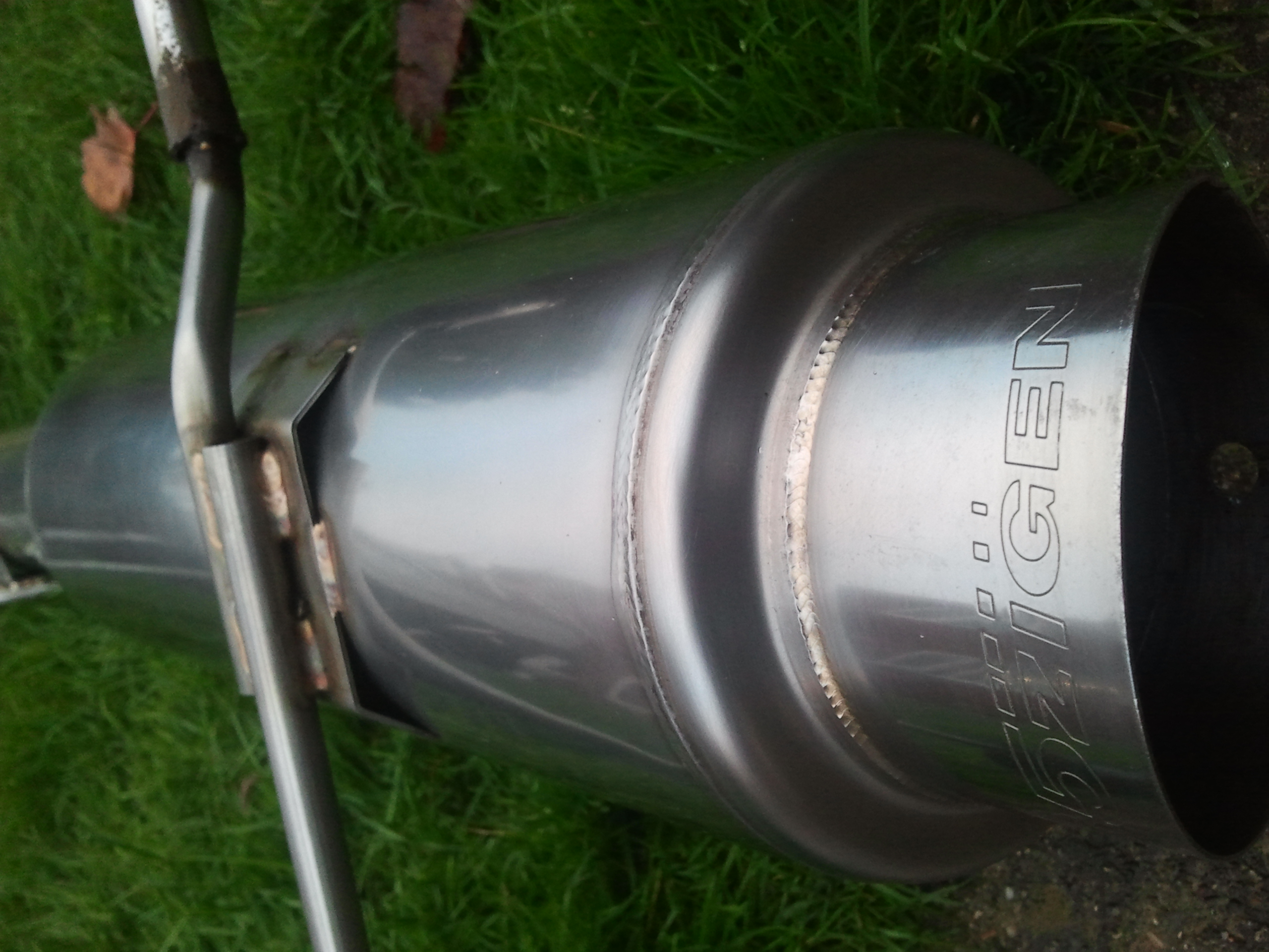

It's a 5zigen jasma (jdm race spec) catback ,extremely light and pretty rare cos I've never seen another gc8 one for sale .
It's got a resonator box , fully slip jointed and very well made .
I love the look and quality of it but with the rim refurb , geo set up eating into the "bigger turbo fund" I just can't afford something more subtle sounding of the same quality atm

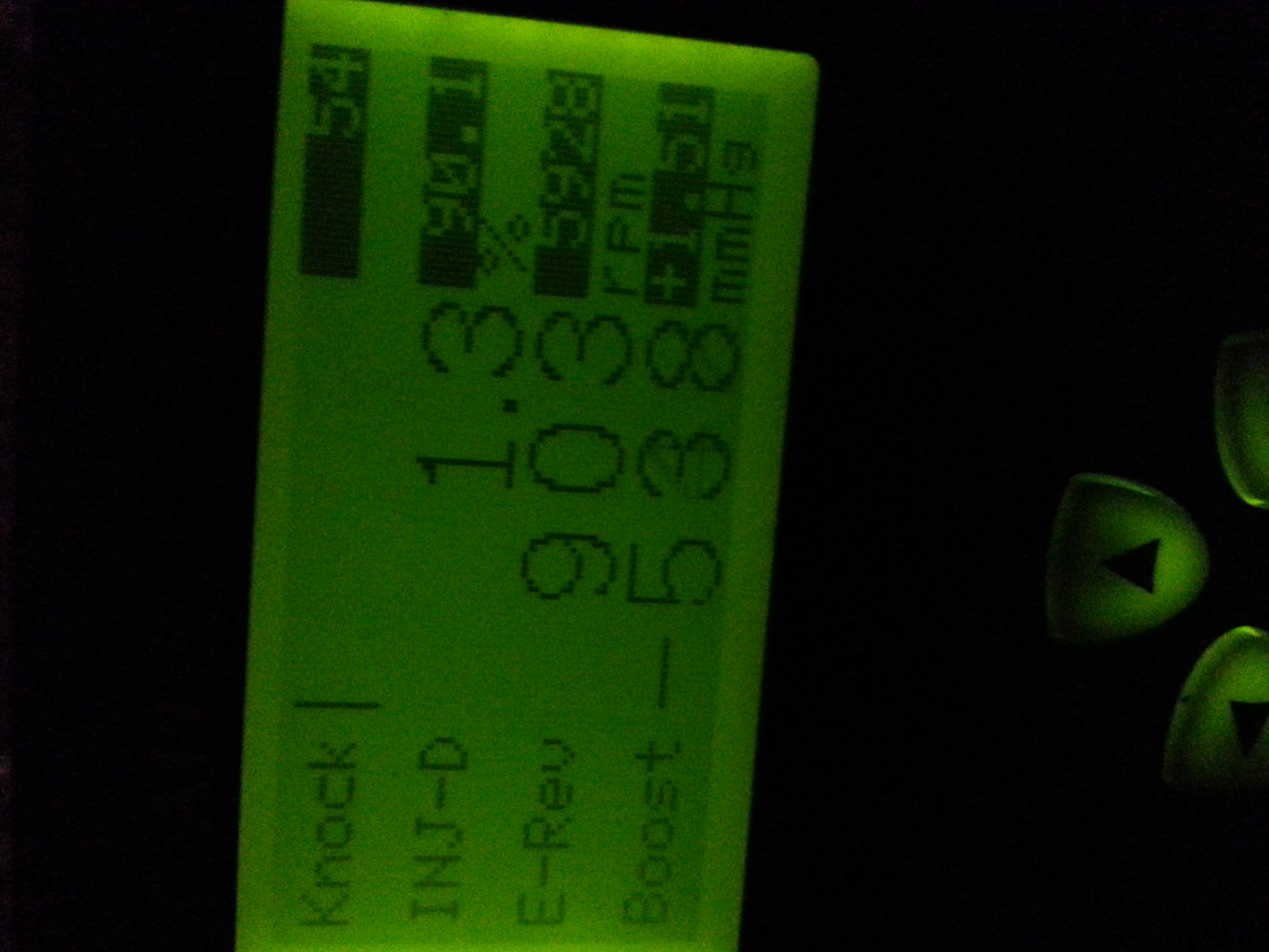

still not had the opportunity to have someone to double check the live readings on the apexi controller during a 3rd gear pull[emoji57]
I'm fairly confident the filter swap worked though as the boost is holding better higher in the rev range according to my boost gauge [emoji41]
So I tried the other setting attowe said to switch to and midrange torque /top end pull are much better with a fair bit of boost for 3/4 throttle uphill post-1399-142740433588_thumb.jpg

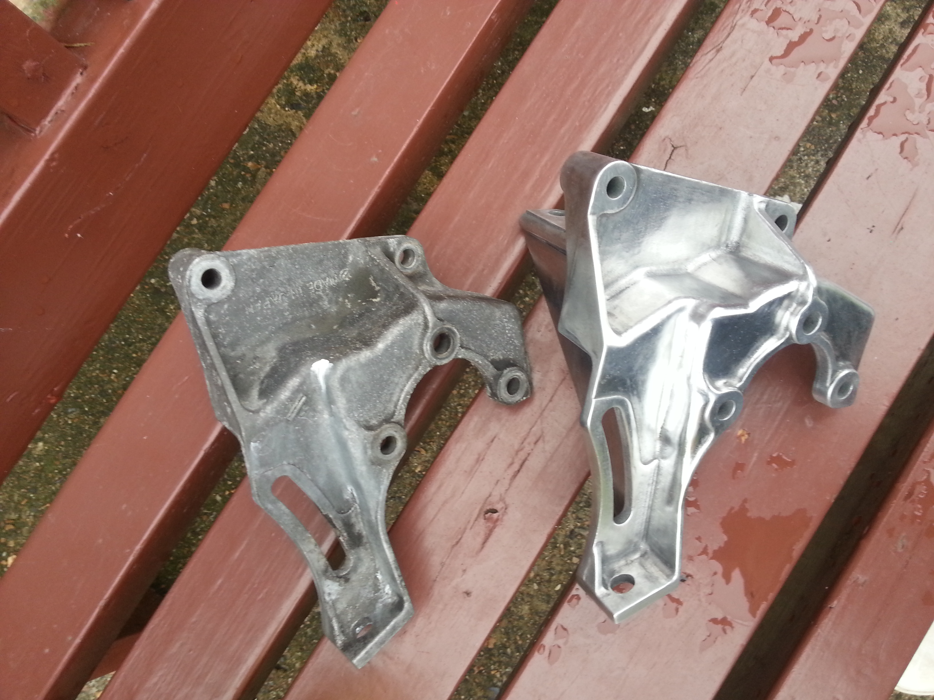

Been fettling a few bits for under the bonnet as it only takes time, doesn't eat into the "moding pot " and keeps my idle hands busy [emoji6]
polished up a spare ally power steering bracket

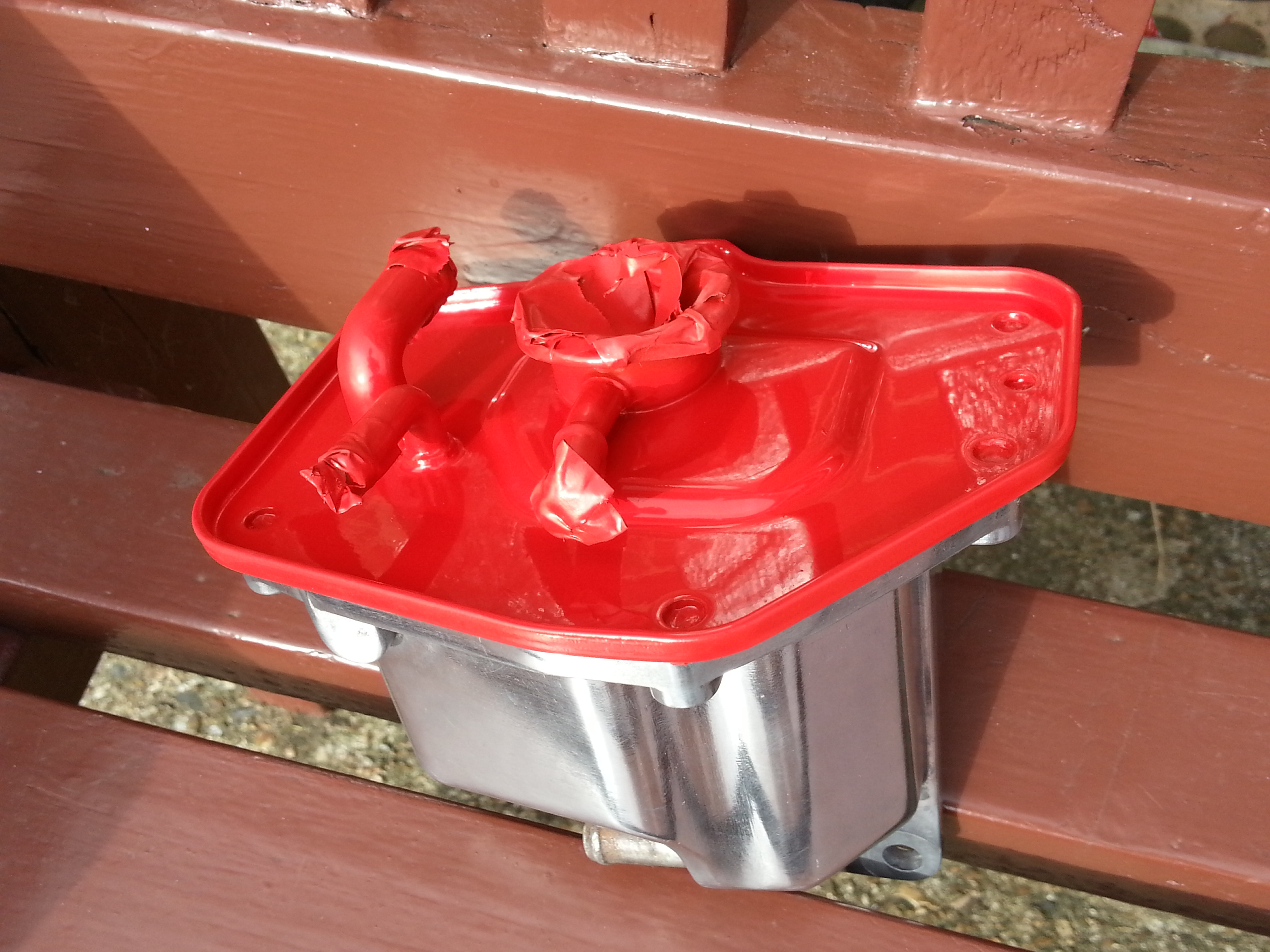

And prepping a v3 header tank (not quite finished yet )

Hi Clive where does the water at the top of your radiator run to

Rick i have two small bore pipes from the header tank one goes to the rad itself the other goes to a thin metal pipe that runs right across the rad to the plastic expansion bottle near the battery.
