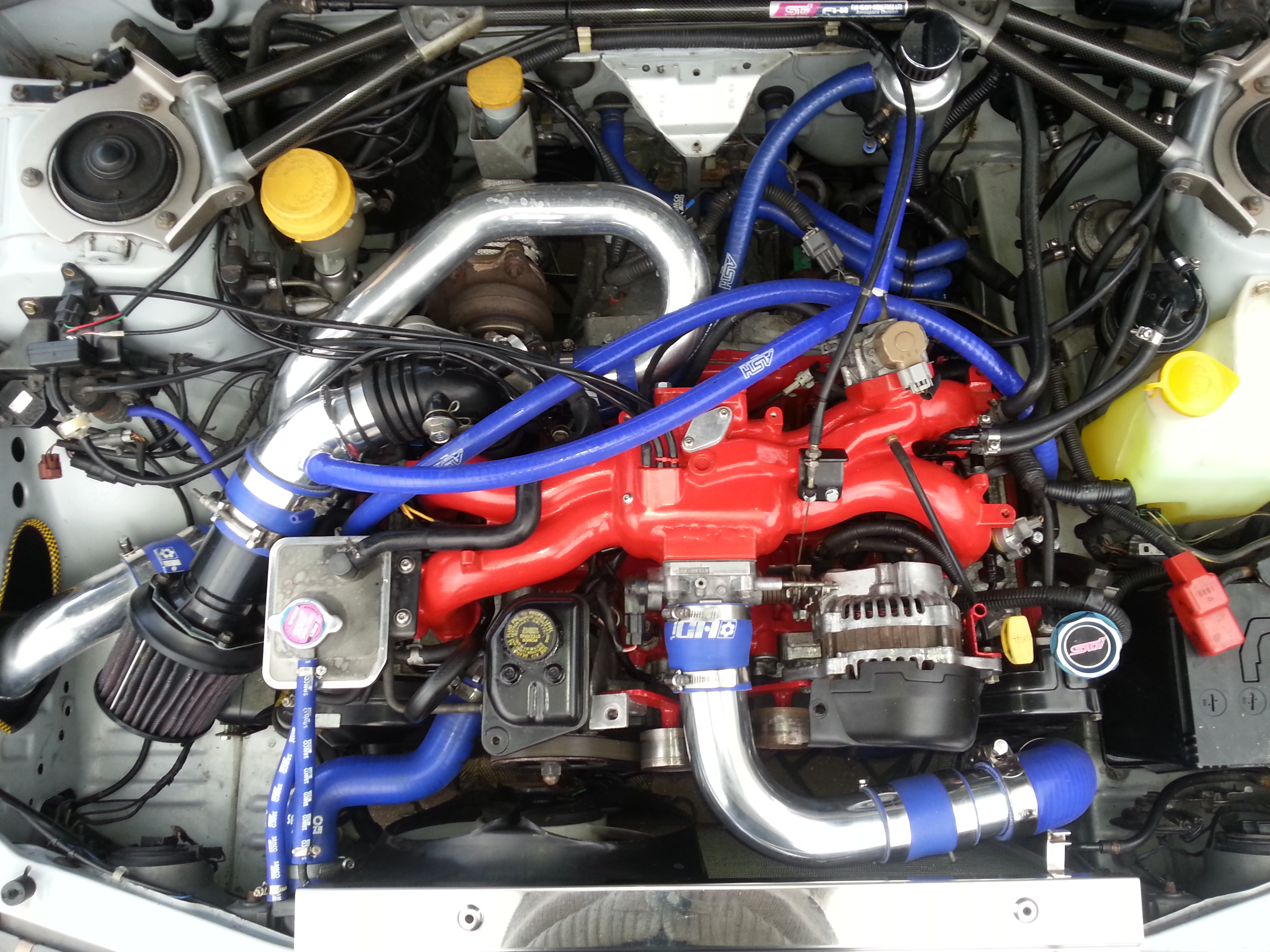

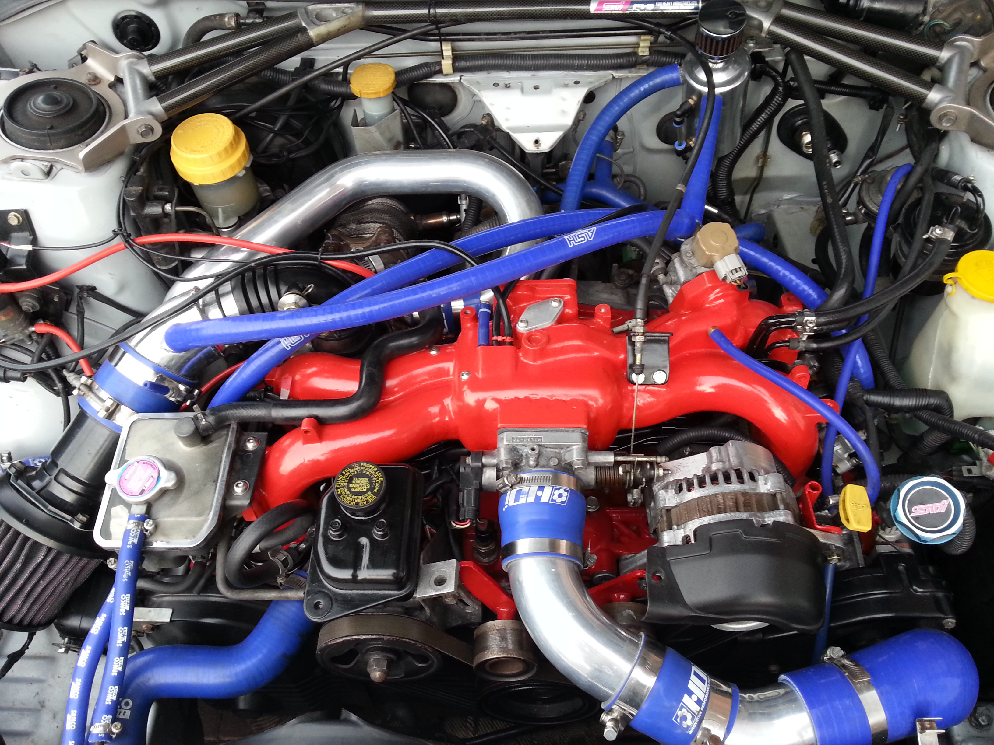

Had the bits from ash turn up today so set about tidying up the fmic core to throttle body pipework .
Although it was functional it was temporary as it was made mainly of cut up bits of the old pipework without the swaged ends at the joins .

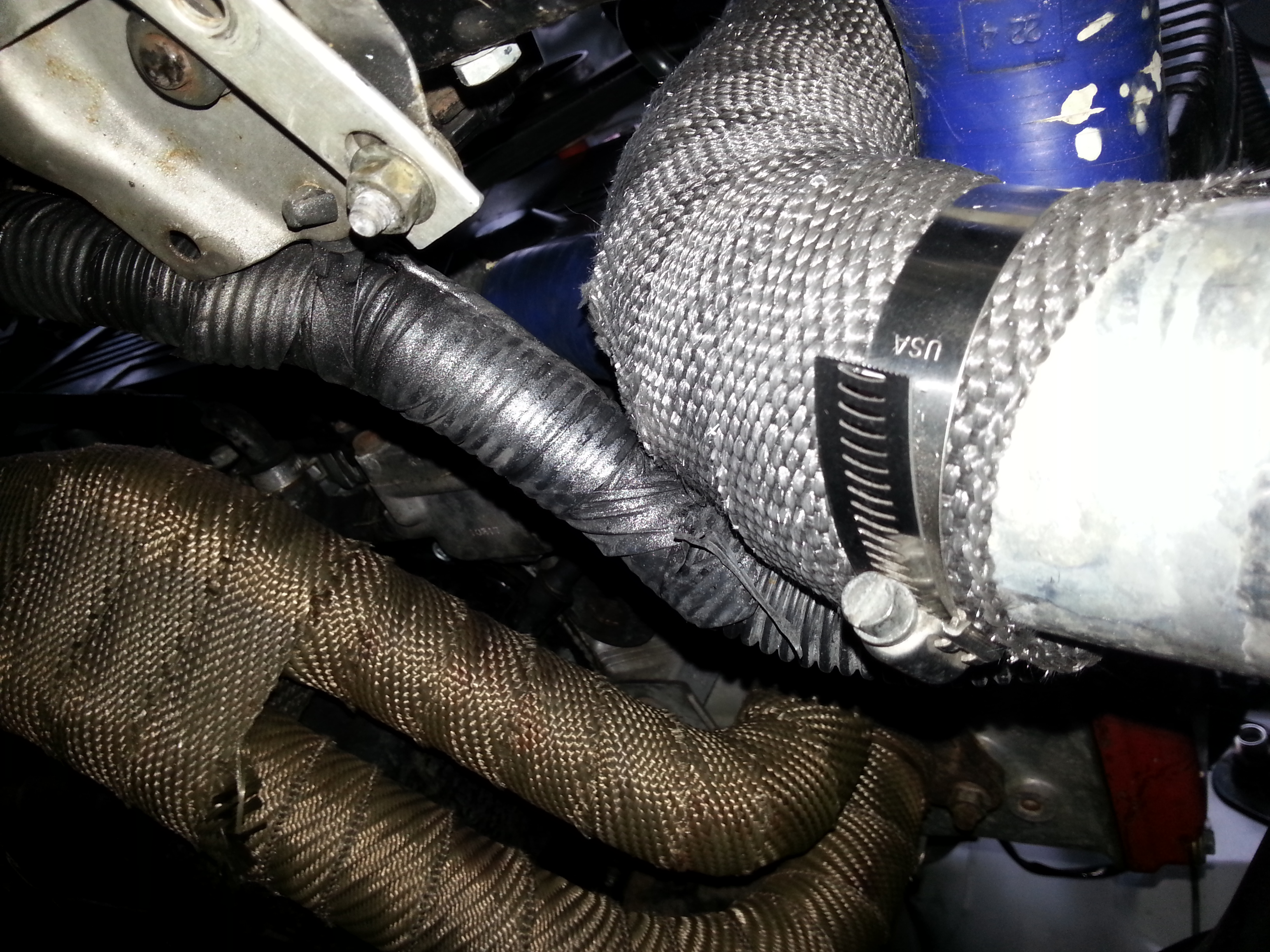

The fmic pipework passes up and (almost) rests against the bottom rad hose in most impreza kits so I lagged this section of pipework while it was off post-1399-142454205946_thumb.jpg
Much happier with it being permanent, now time to think about shortening the turbo to core side [emoji6]
just not sure about the new black vac lines , think I should have got blue [emoji4] post-1399-142454236192_thumb.jpg

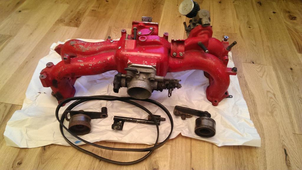

I was quite lucky tbh rick as this ex andy forest ported reversed inlet and alternator relocation brackets came up for sale for £150 as it needed some tlc post-1399-142460420207_thumb.jpeg
I did have to hack a leg off the alternator and prep n paint everything but the end result works .

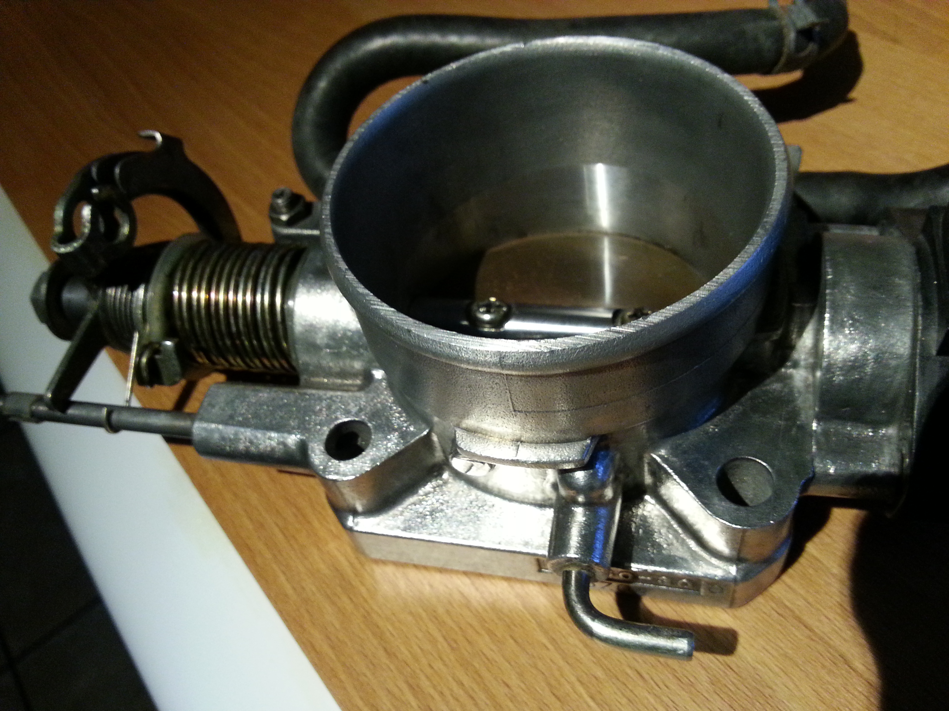

Got bored last weekend so ended up polishing a spare throttle body and re working the throttle linkage to tidy up the flipped inlet some more .

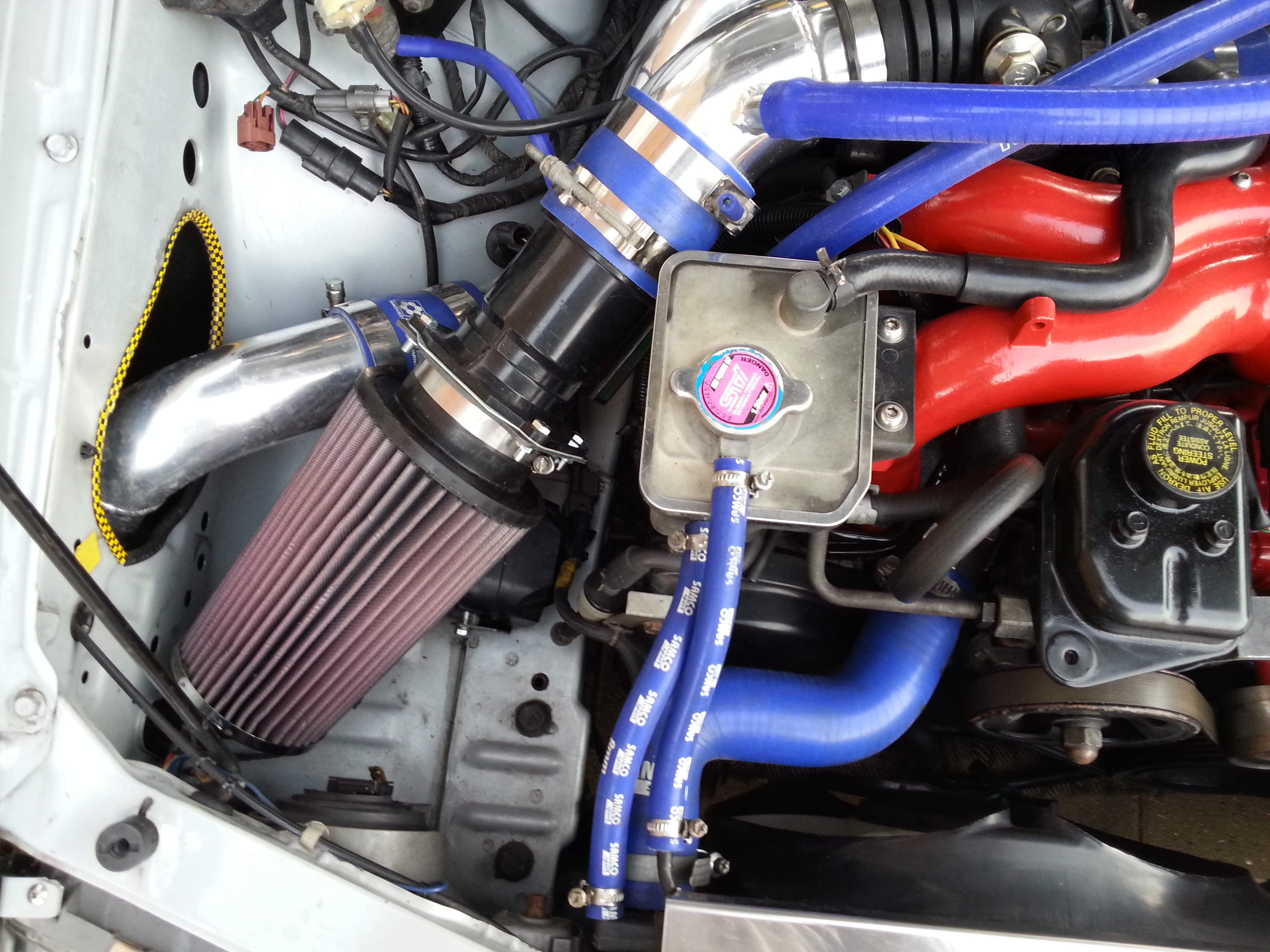

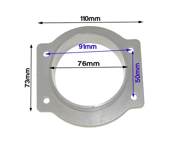

Ordered one of these so I can fit the massive k&n I had on the v3 and switch it for the antique apexi super intake post-1399-142566884344_thumb.jpeg

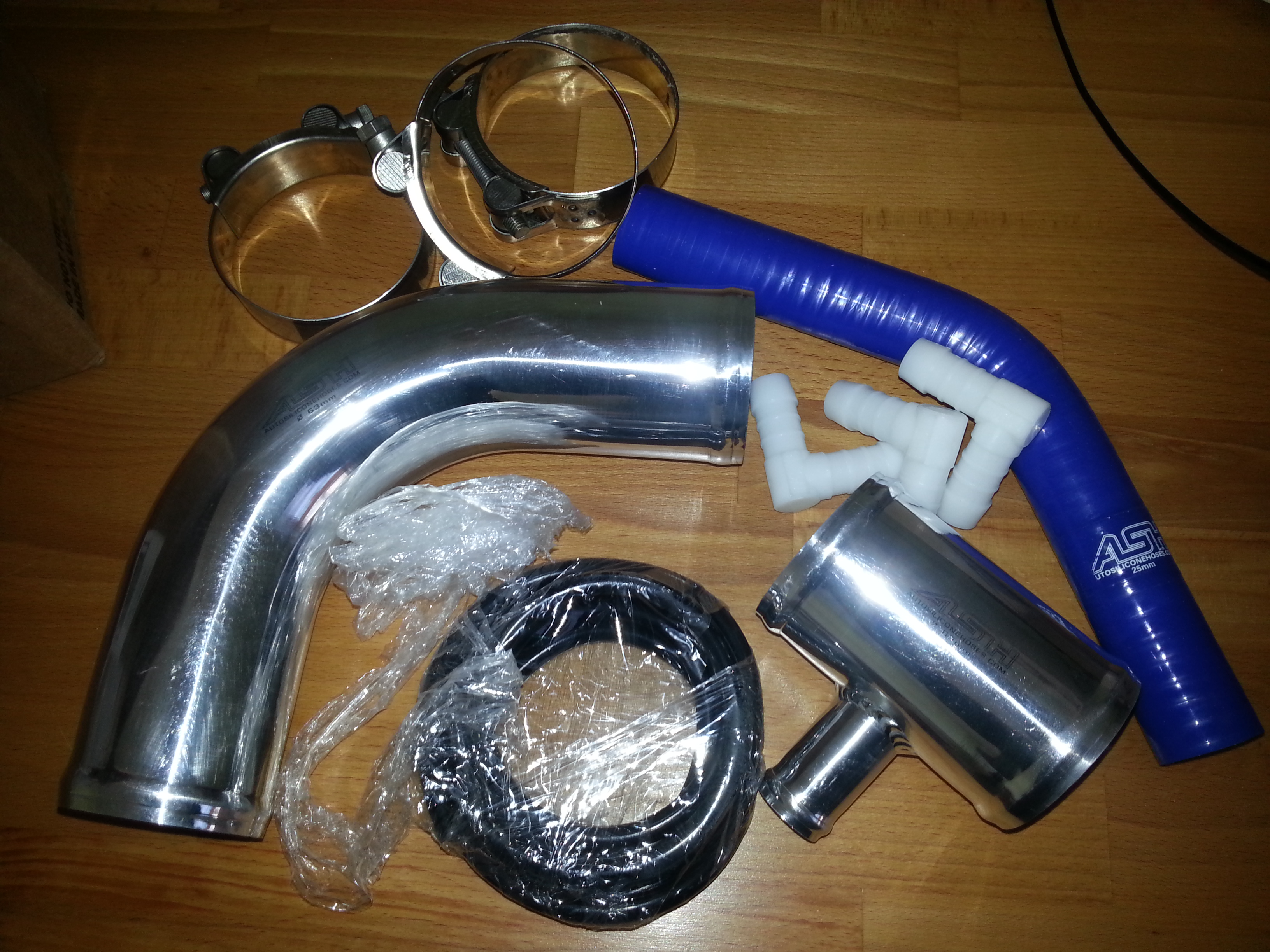

Had some scooby shiny stuff turn up today
eibach rear camber bolts
Maf cone filter adapter plate
Blue vacuum pipe

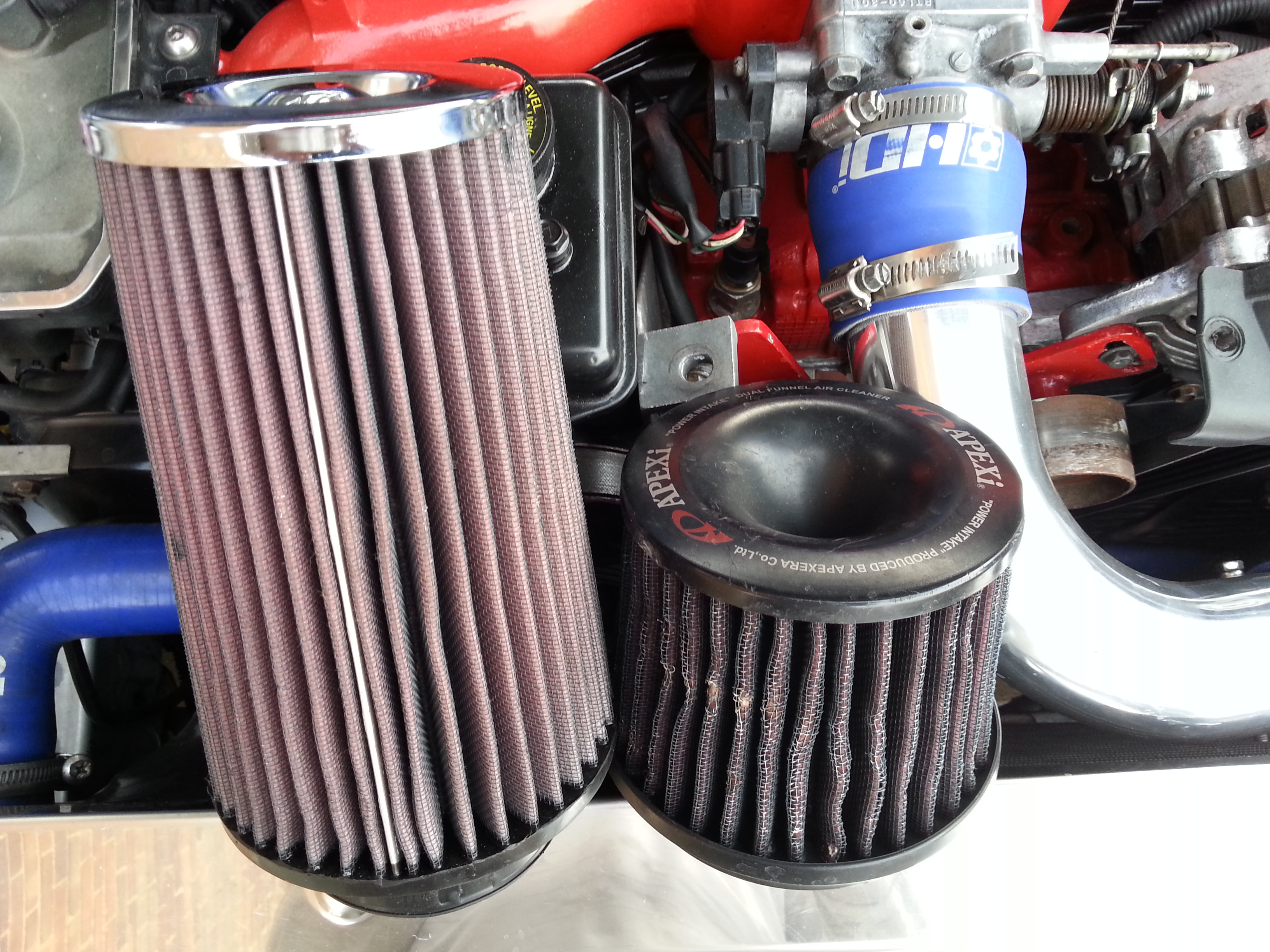

So I set about removing the apexi super intake as it was on the car when my brv bought it in 2011 and had seen better days
Comparison pic with the massive 3" intake k&n and battered tiny apexi
Hopefully it's the reason I wasn't able to hold 1.4 bar above 4.5 k [emoji57]
Seems like a likely culprit as when the engine was in the v3 uk(with the k&n) it held 1.4 bar till over 6k although the esl ecu seemed to keep richening up the map and drowning the power with fuel . I'll switch over actuators at the weekend as I've got a spare one anyways.
My workload has increased lately so I'm unsure when I'll get chance back to the dyno (again lol)
But the k&n looks like it will be more than up to the job[emoji4]

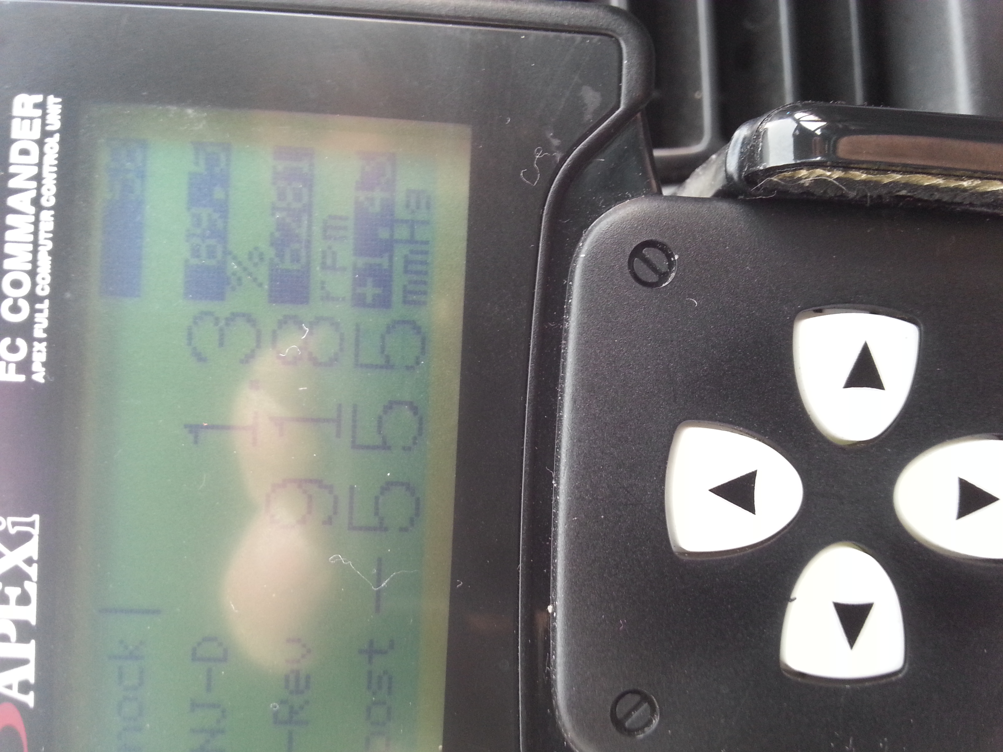

Attowe set up a few settings for me on the apexi hand controller for me to use once i think it's sorted and the eml to flash if any things not right .
I can see the live parameters and it will hold peak boost , knock ,injector induity, revs ect but it hits 1.4 bar quite early and only holds the peaks for me to see .
I need a co pilot tbh so they can monitor real in time higher in the rev range and not just peak boost afterwards [emoji6]

I might just try changing the controllers setting's to read just boost (bigger readout for just one parameter) and tape it to the cluster while driving up n down some slip lanes
