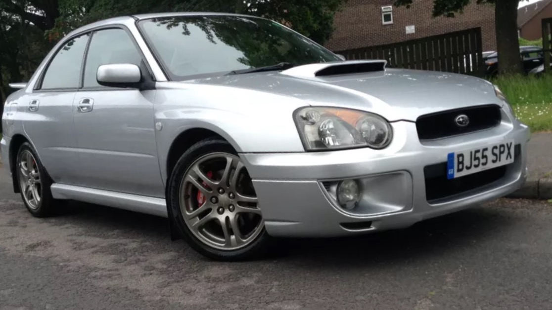

im in the market for a wrx, it will be my first one, but I have had an Impreza before. 2000 2.0 sport wagon. Ever since I've loved them, so why not go for a wrx now I have a bit of cash.
my budget is £6-£7k. I originally was looking at the hawkeye, but was advised they have some engine issues. Is this correct? So much now looking at the blobeye. Around 2005 model. I wanted as new as I could get.
on Sunday I'm looking at a 2005 wrx. It's had the brakes, shocks and clutch updated. And it has the prodrive exhaust and prodrive silicone hoses, but not the sport cat. Also it's only 50,000 mile. It's got to be worth a look imo.
What do I like? I'm not into the sti as I'm no long a boy racer (44) and the spoiler puts me of them. So I like spec d models. I would like the car to just blend in, but have a bit of punch, if I need it.
if I was to get the car above, what extra mods should I do? I'm not looking at getting it to 500 bhp, just sometime a bit more that standard. I was thinking about either
1. Change air filter, then re map or
2. De cat up pipe, de car centre section, change air filter then remap.
tbh I don't really want to mess with it too much (money and effort) could I just do 1? Or is that just not enough?
