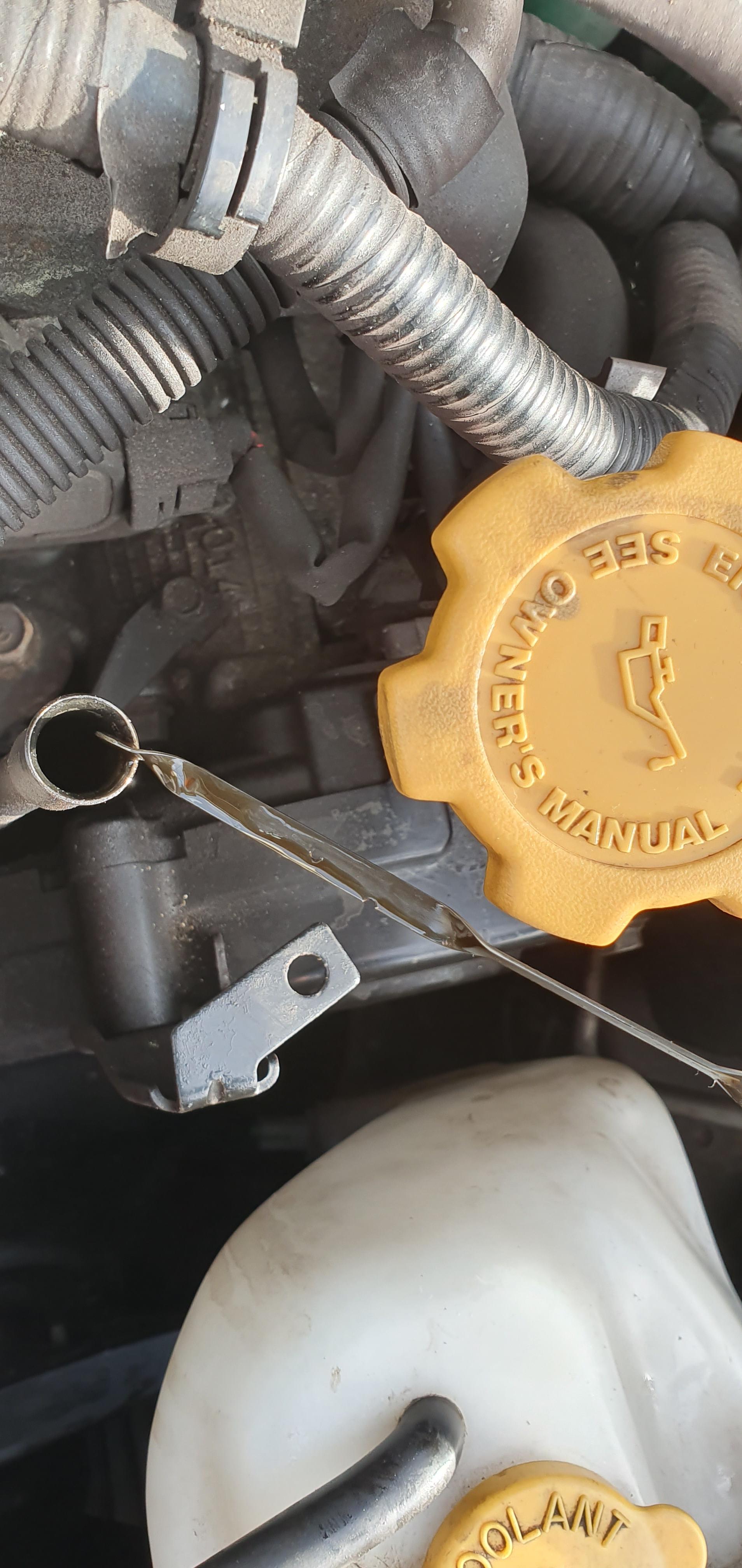

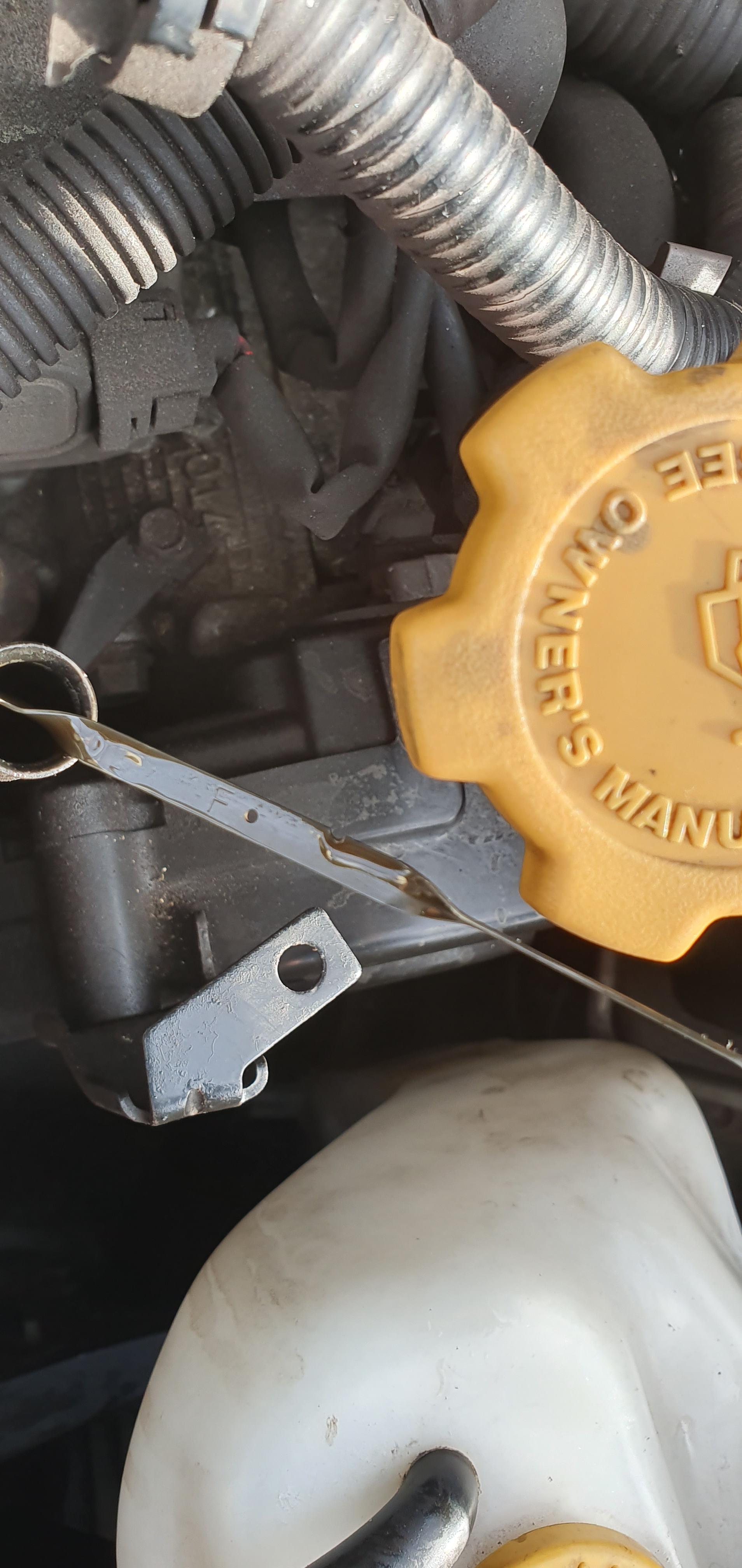

How am I getting this weird reading off the dip stick?
Not even an trailing up the sides, engines stone cold. This is what it was like after I did it hard to read
Ahh the dipstick on these is not the best. I also struggle to read it easily.
What i do is clean dip stick and then push it in hold for 3 secs and then pull it out quickly. Make sure the icon on the dipstick is in the correct orientation. Worse dipstick on any car I have ever owned. Tricky.
If anyone has a full proof method I would like to hear it.
