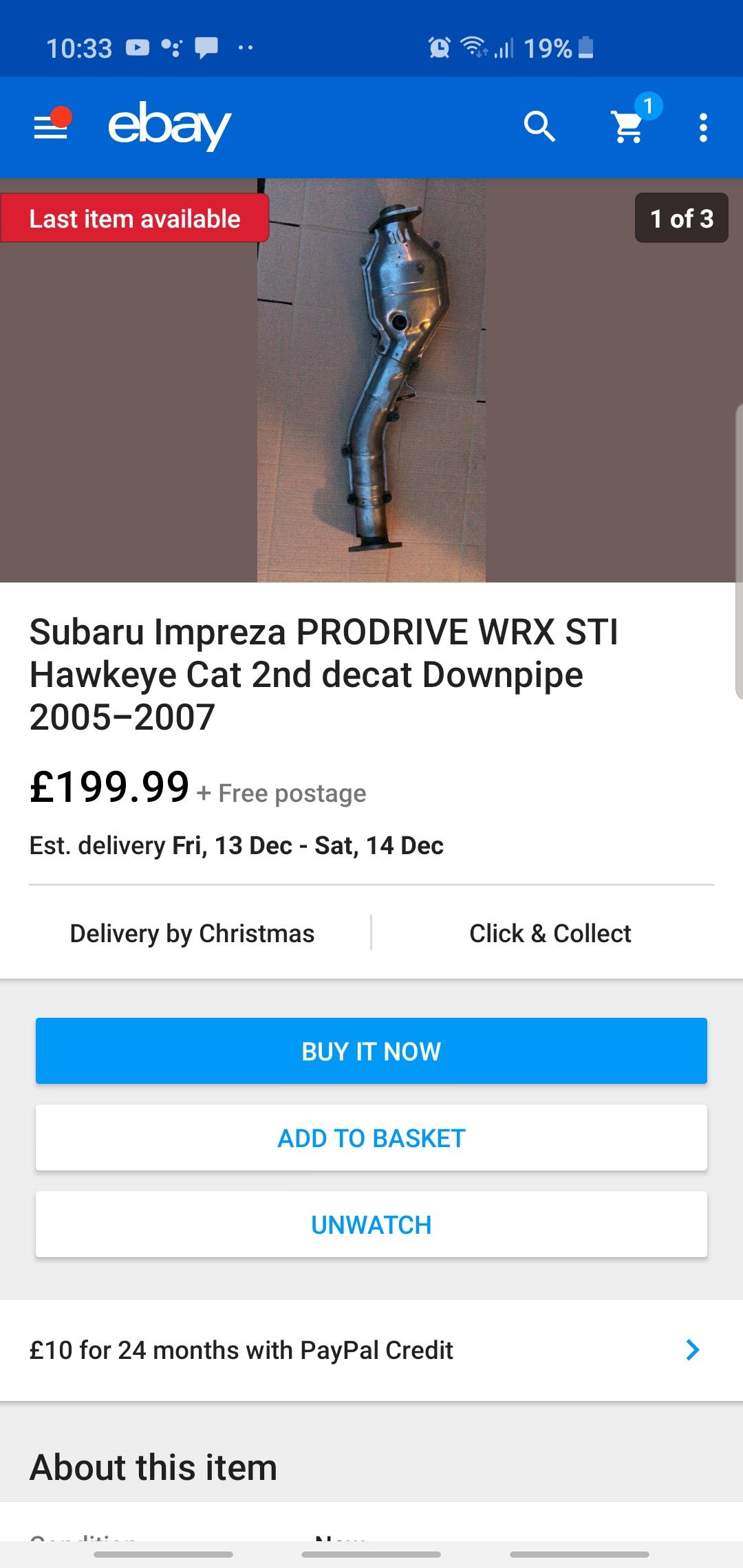

Would I need remap with a sports cat? Just found one on scoobyworld to replace downpipe an an 2nd cat says mot friendly, cant find the one youd put up siluro from scoobyparts.

Guys just offered me this 20 quid off at 169 says lambda sensor can be put In but will it work? An will this still need mapping? Apparently it's an mot pass he reckons you can get away with cat on downpipe?
30 off actually my maths😂
Done a bit of reading on it seen a few people saying the 2nd cats ok to remove an wont need mapped an will pass an mot, thoughts gents? Their is access point In this pro drive part for the sensor but will it work right?
Sacked the cat idea off just gonna go decat route spoke to someone at scoobyworld. Hayward&scott straight through ordered no mot problems no remap needed coming tommorow get in
