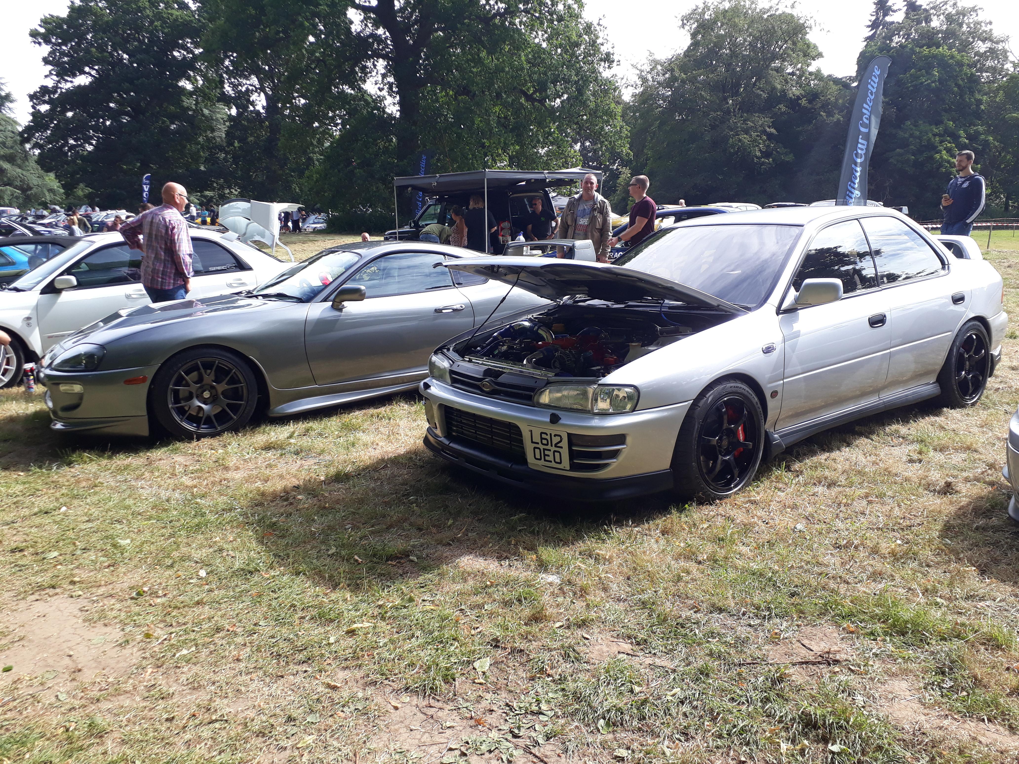

Cheers Stu , gotta say it was the oldest and probably shinest Scooby at the car show 😁
@stants  not sure if it's cos I've missed her , the new tyres all round or the geo set up but she seems to handle better😎

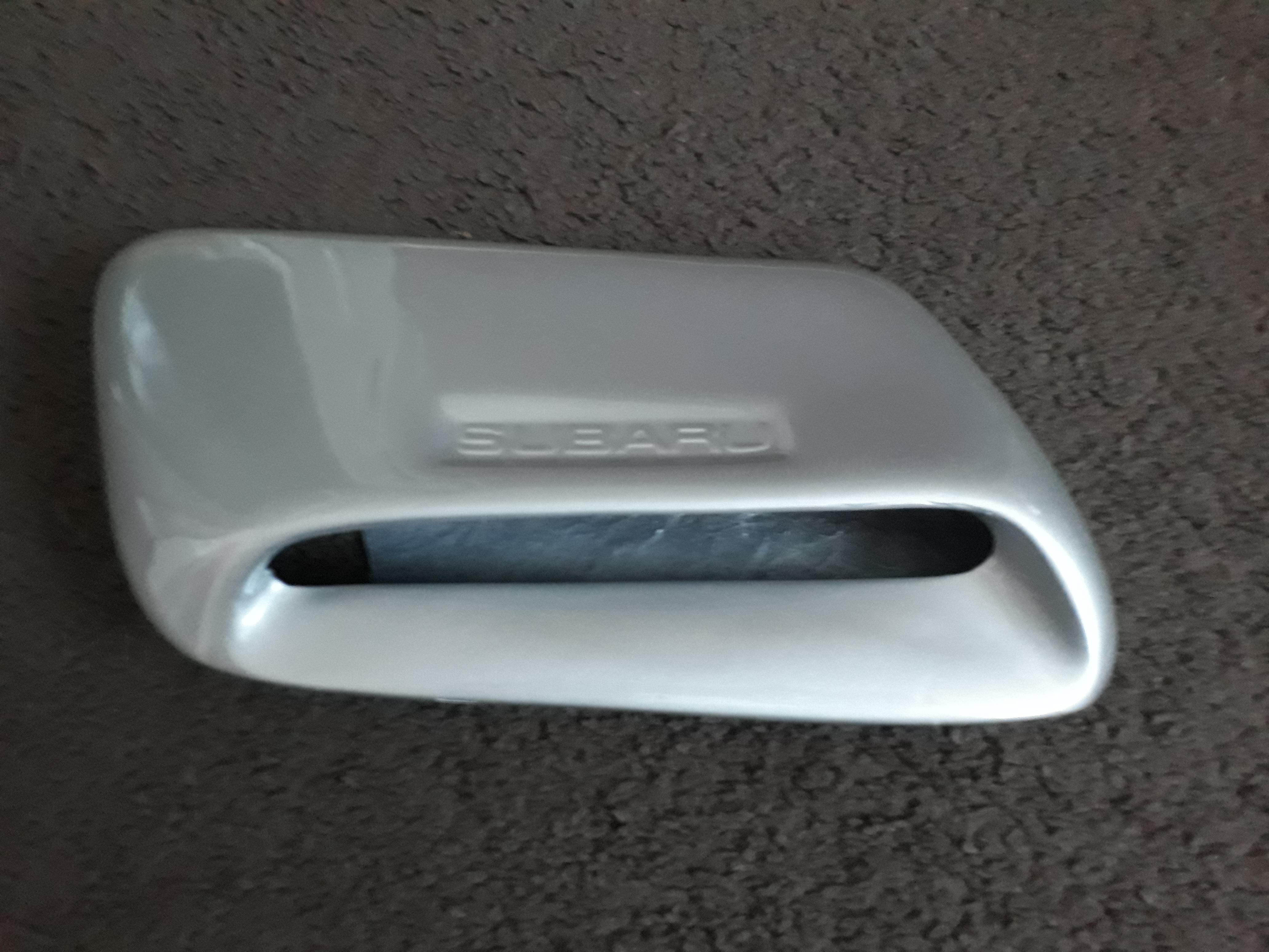

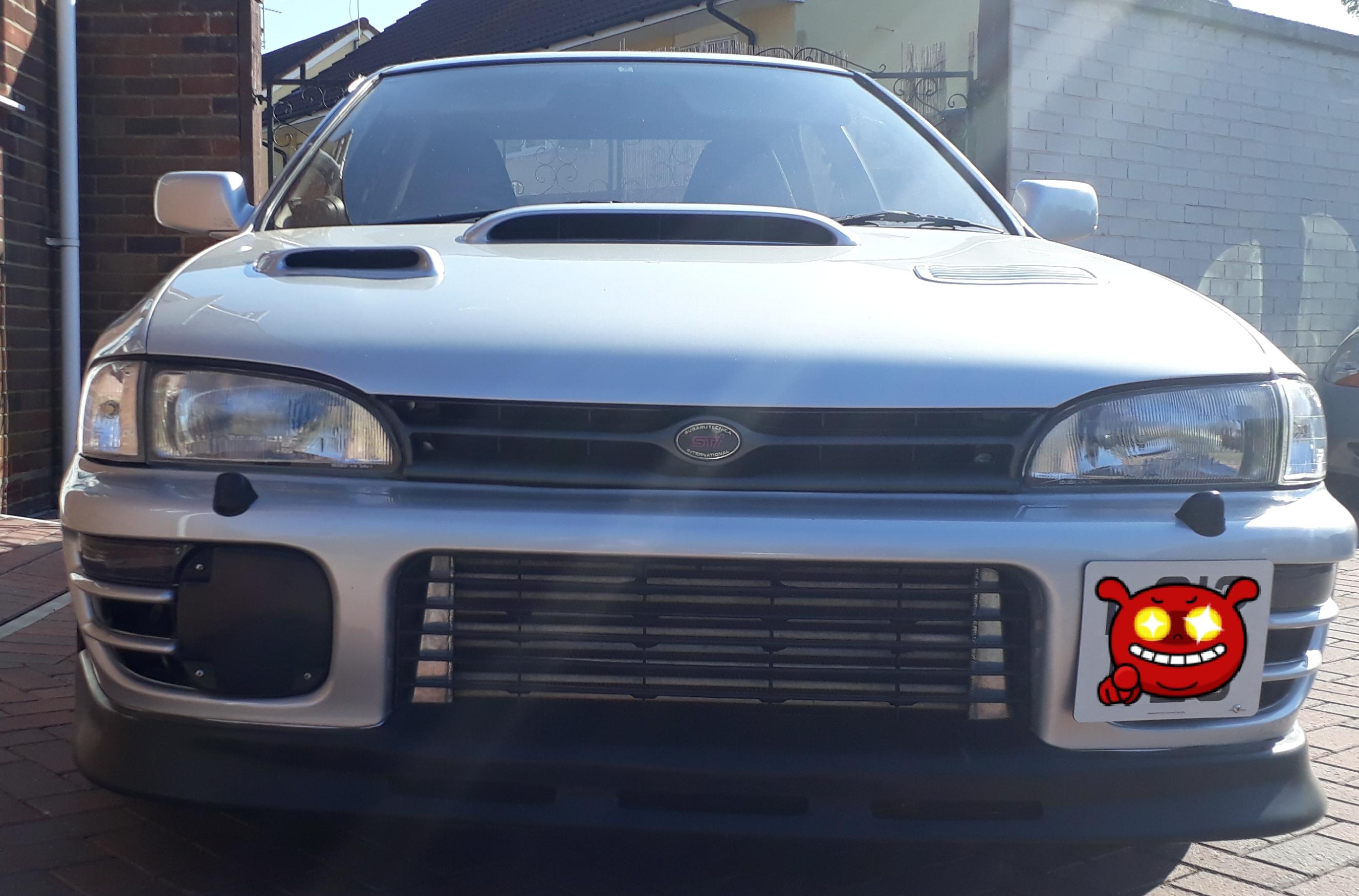

What with getting her back and getting the bug sti up n running I'd forgotten about the induction scoop that I'd left with the body shop , well until they phoned me to say it was done 😂

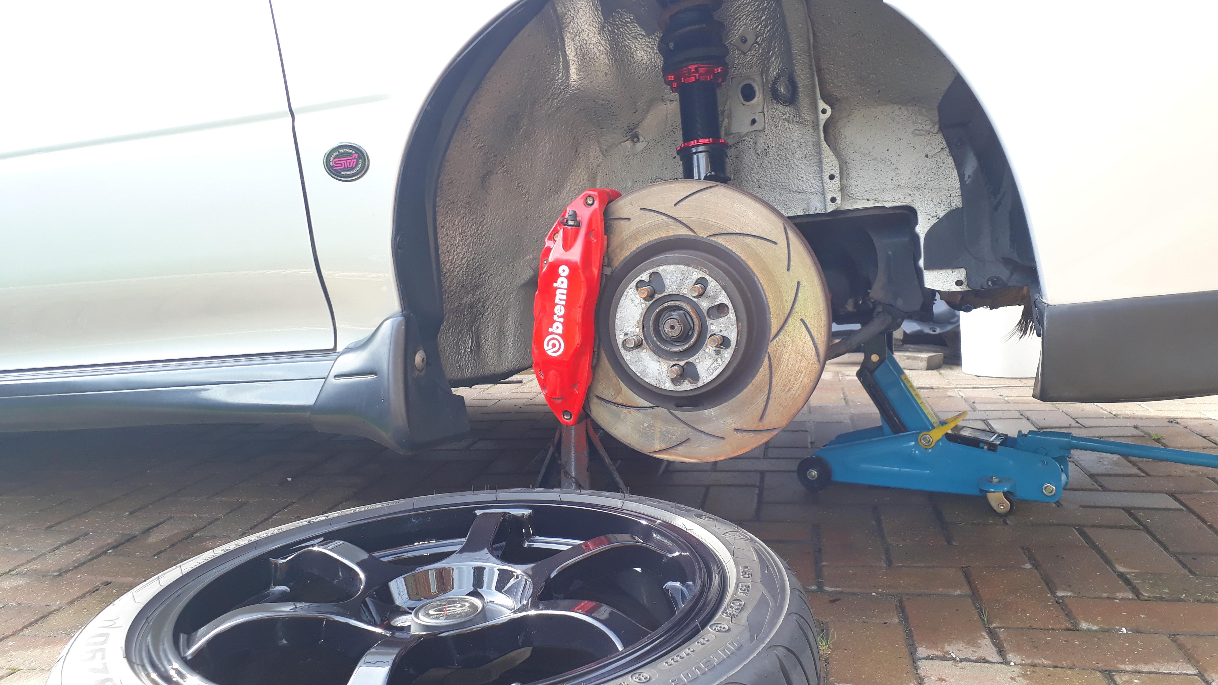

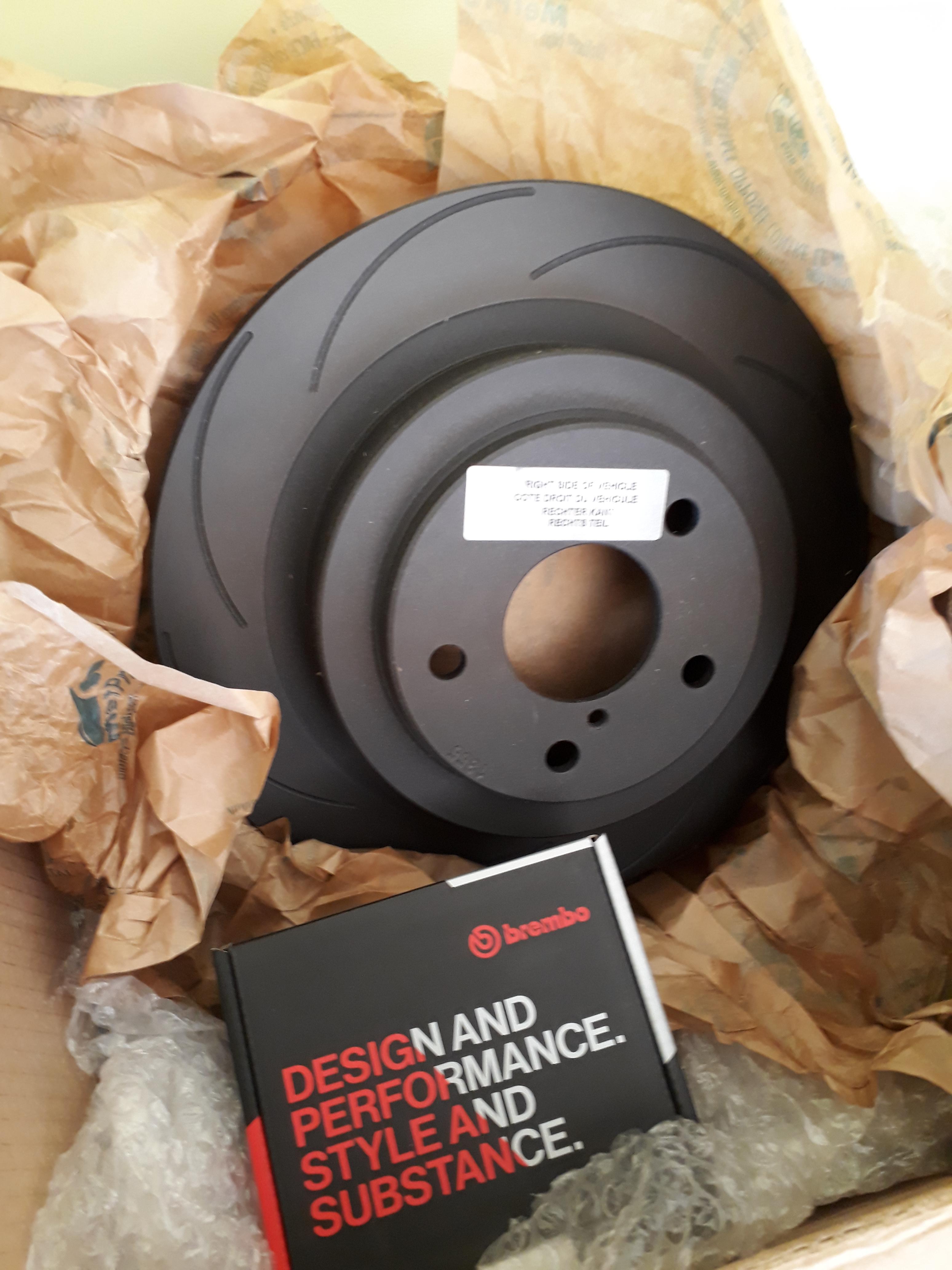

 Did have a parcel from alyn at As performance turn up today

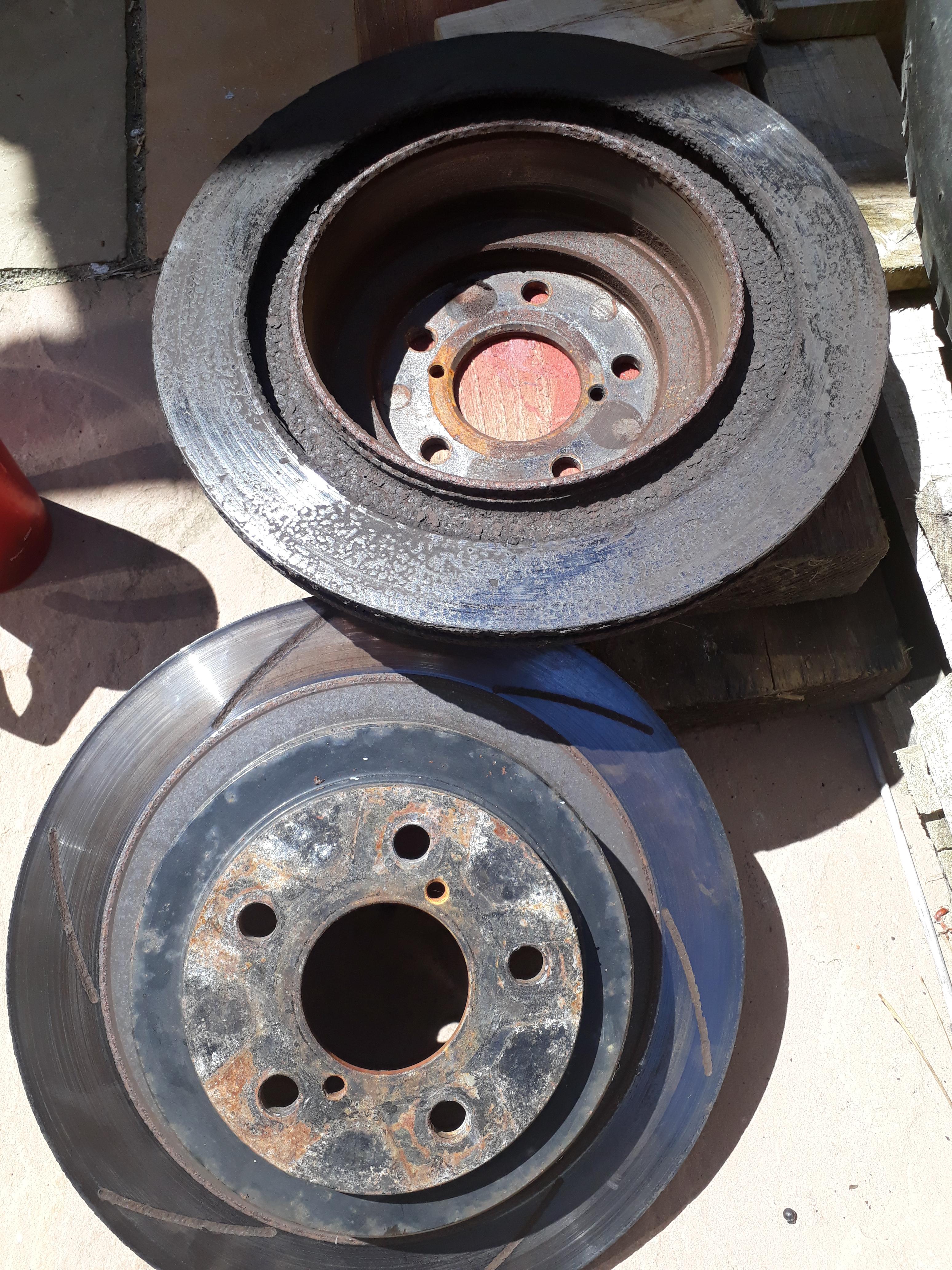

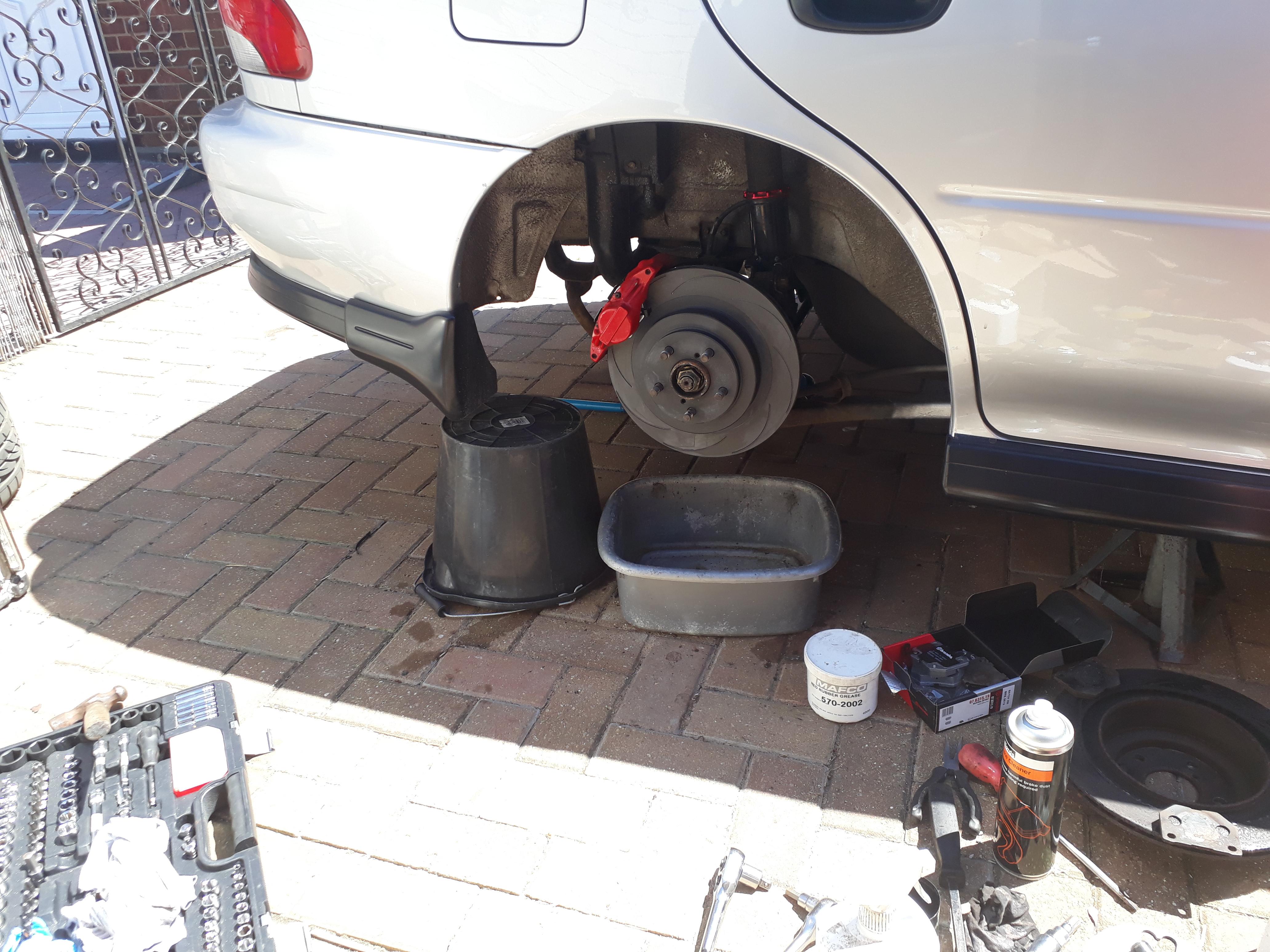

Nothing too exciting though , just some new rear discs and brembo sport pads for the rear 2 pots .I knew the rear discs and pads were due a change. After all they were the ones off the v3uk and the discs were bought 2nd hand off a mates 04 wrx then (so they've done well)
 I knew the rear discs were overdue ,as last winter I'd felt a change in the peddle under heavy braking . So I finally got round to changing them yesterday and although the outer sides of the Godspeed discs looked ok , I knew the inner faces were worn . But check out the 1st pic 😲
Think the v1 was getting a bit jealous of the bug sti sitting in the tlc spot in the back garden lol . Although I've not pushed the brakes yet , due to them needing to be bed in , peddle and cold bite are definitely improved 😎

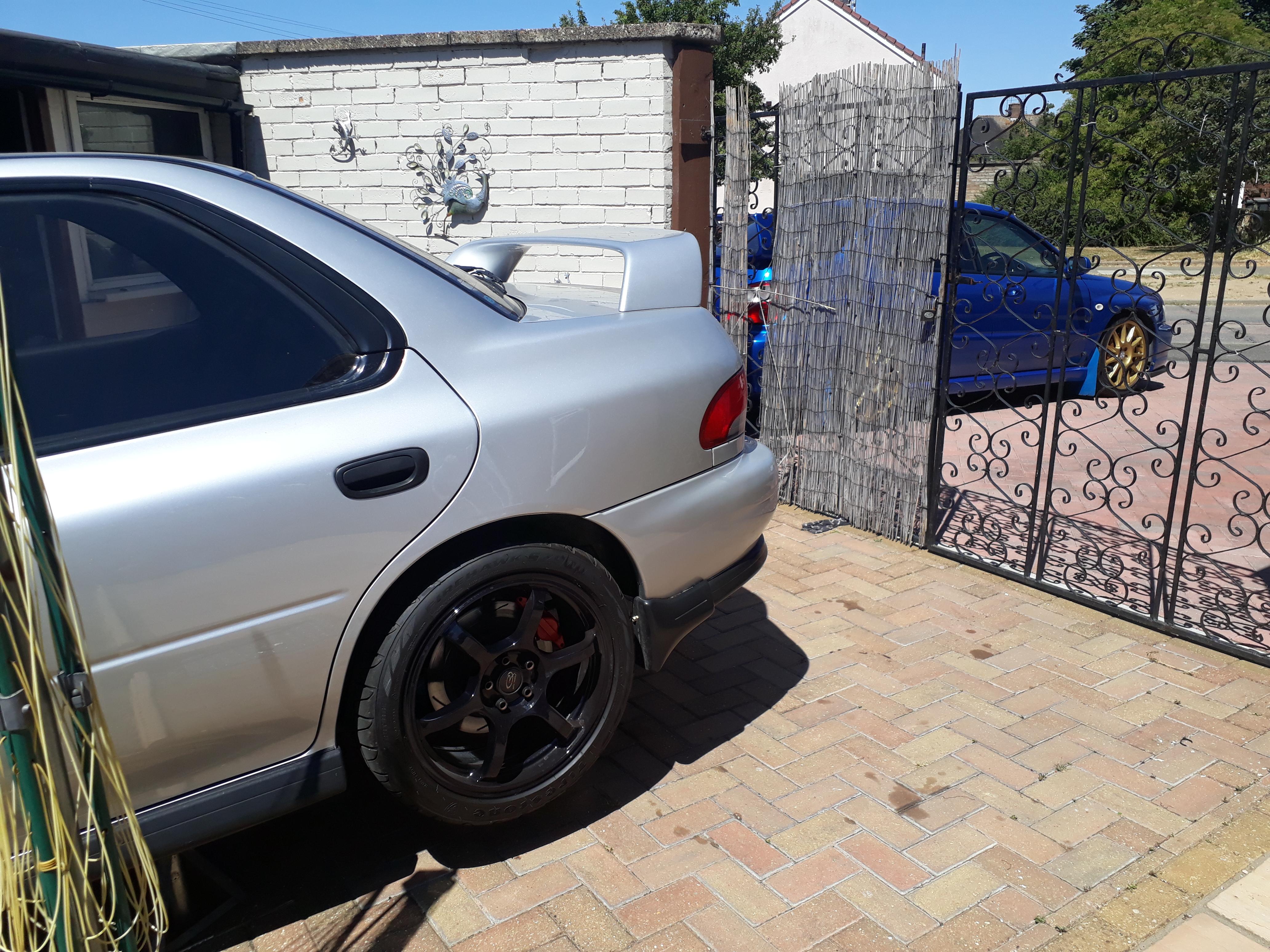

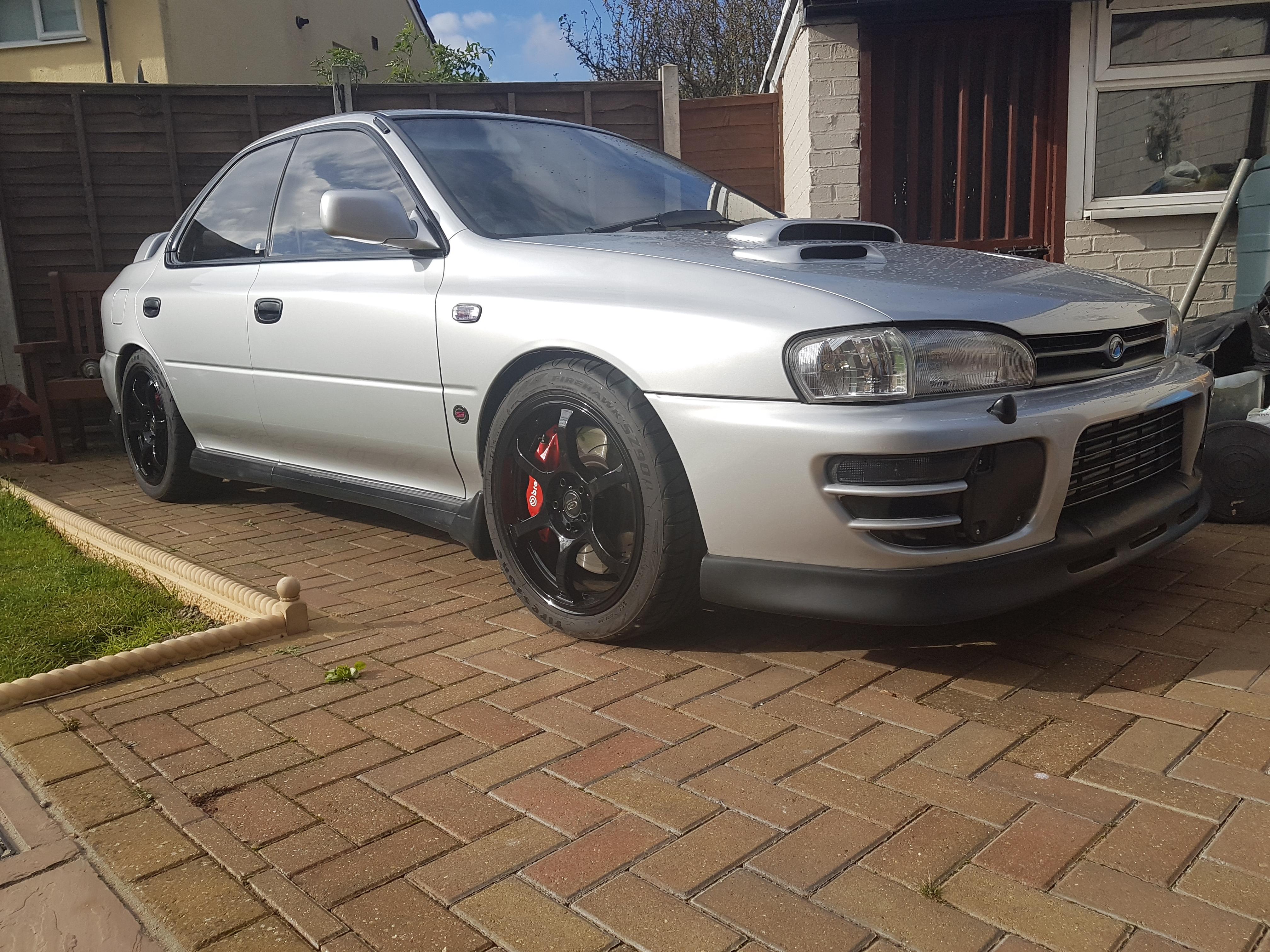

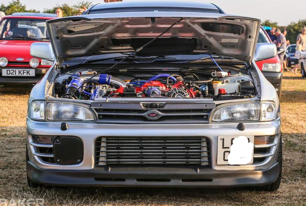

Not really much of a update tbh as all I've been doing is cleaning it and driving it but here's a few pics of it at local shows along with a couple of it on the driveway with the other v7 sti "project" 😊
Hopefully late summer early autumn,  I'll get chance to get it off the road , too get the inlet manifold de lugged and powder coated along with the cusco h brace and rear lateral links .Then fit the billet rails ,parallel fuel lines ,fuel lab fpr .Along with the whiteline anti lift kit and a few superpro bushes .  Not that im after chasing ponies but if it's not broke ..... upgrade it 😊
The classic looks great with the chin spoiler, skirts and door handles non colour coded with the dark wheels....
Agreed the classic is looking ace mate 👍, the bug is looking top notch aswell 😎👍

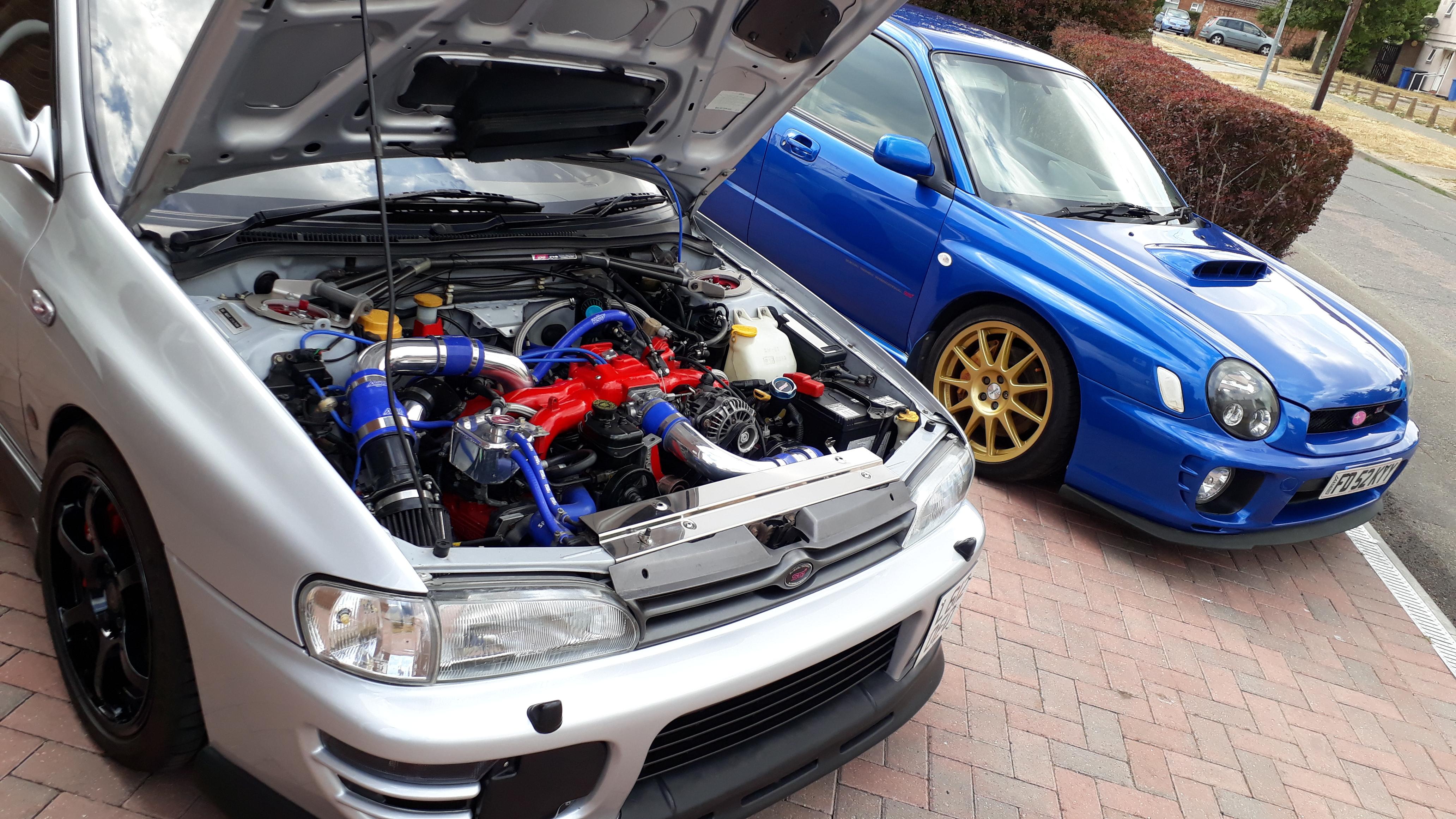

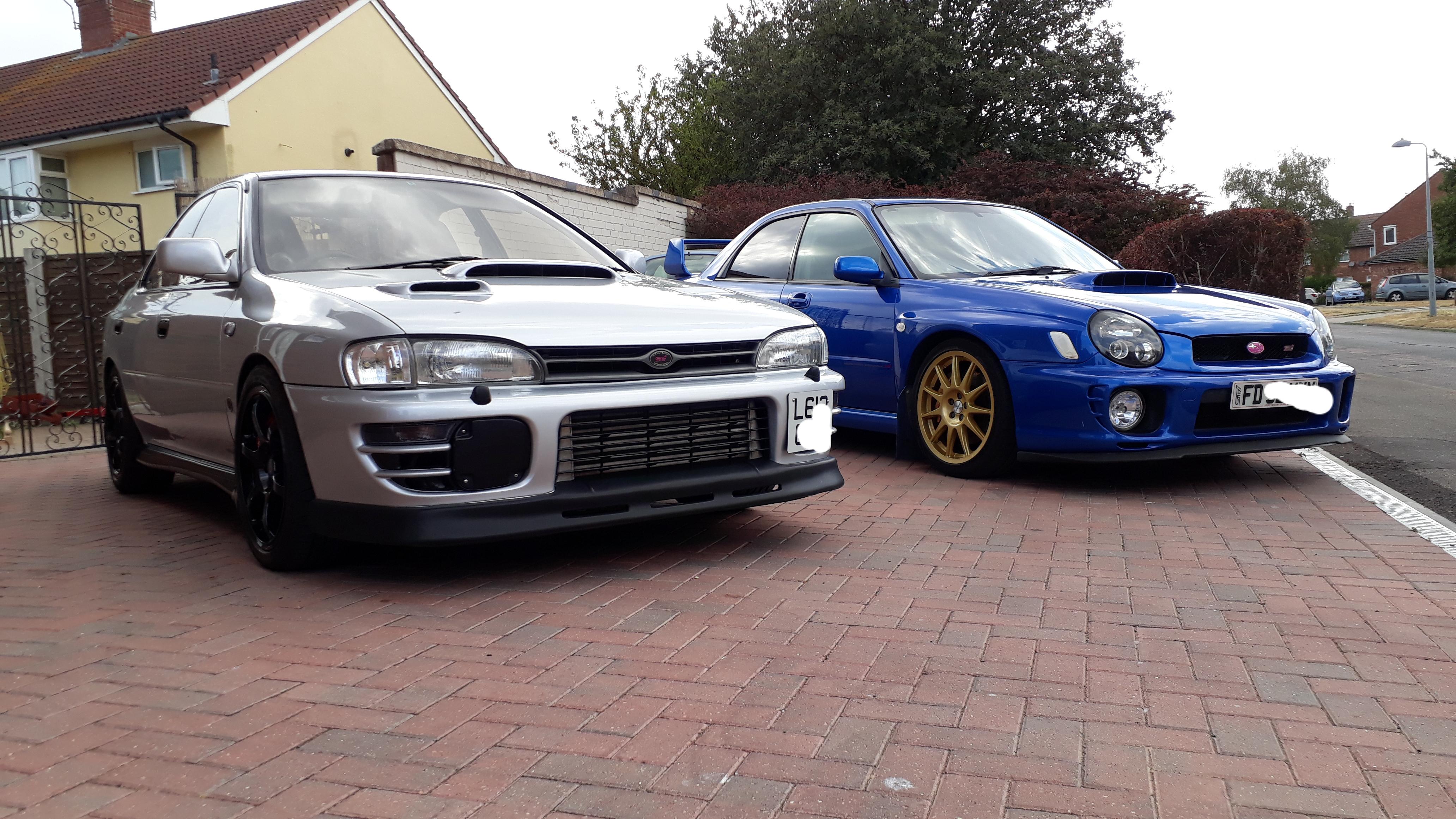

Thanks stu , i will admit it's nice looking at 2 on the drive 😎  But know i can't afford to run them both forever 😕
The bug sti definitely feels more refined with its linear power delivery , the v1sti is "savage" in comparison ,even though its only running 30 hp ish more than the bug 😊

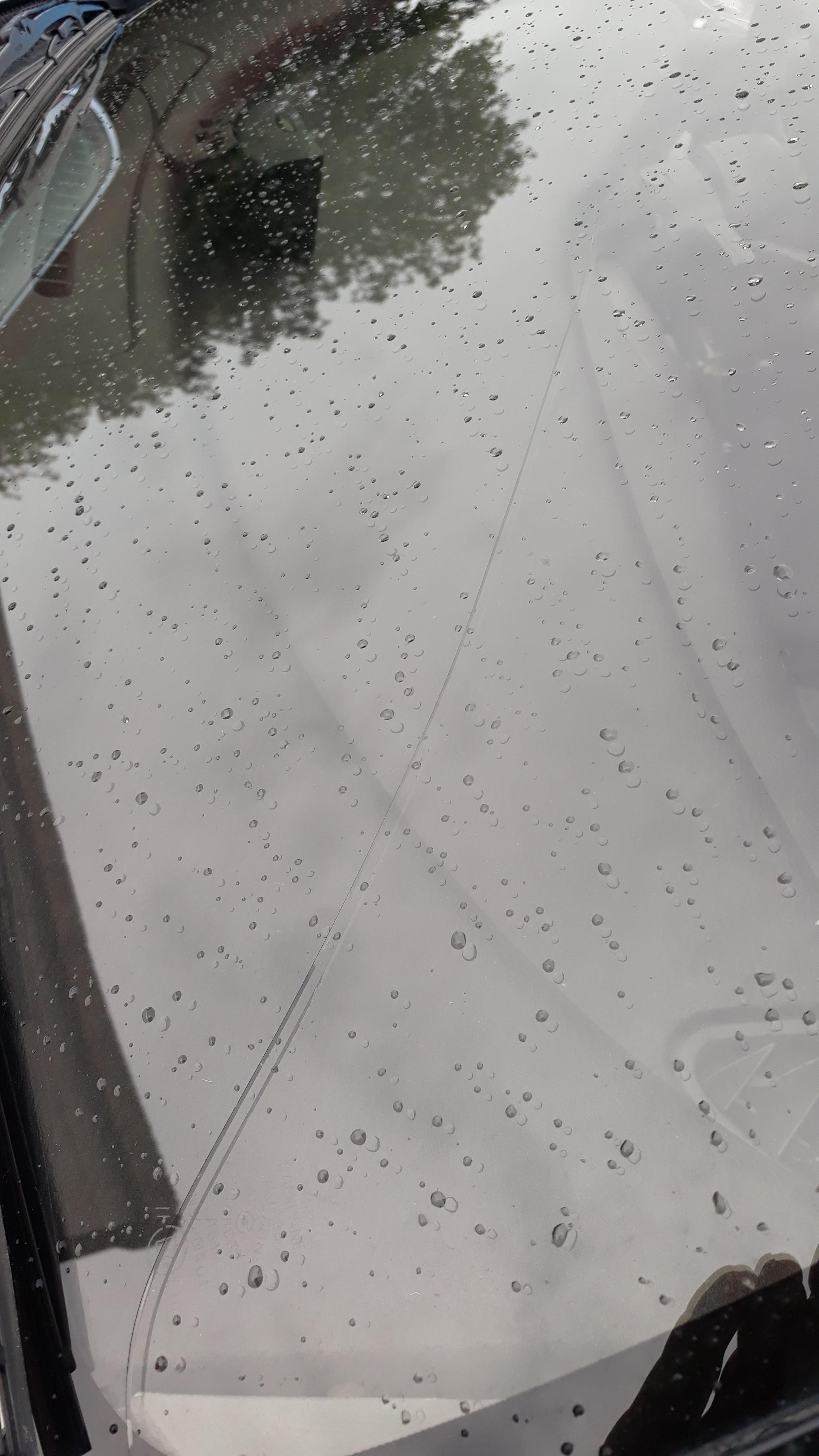

Well fml , guess when that muppet hit the scoob a few months back it must've cracked the edge of the front windscreen under the trim .
As i woke up this morning to find a crack across the passengers side of the windscreen,  No sign of any impact from a stone chip and it definitely wasn't there yesterday when i was driving it 🤔
Can only assume it's happened as the sun heated it up this morning ffs 😠

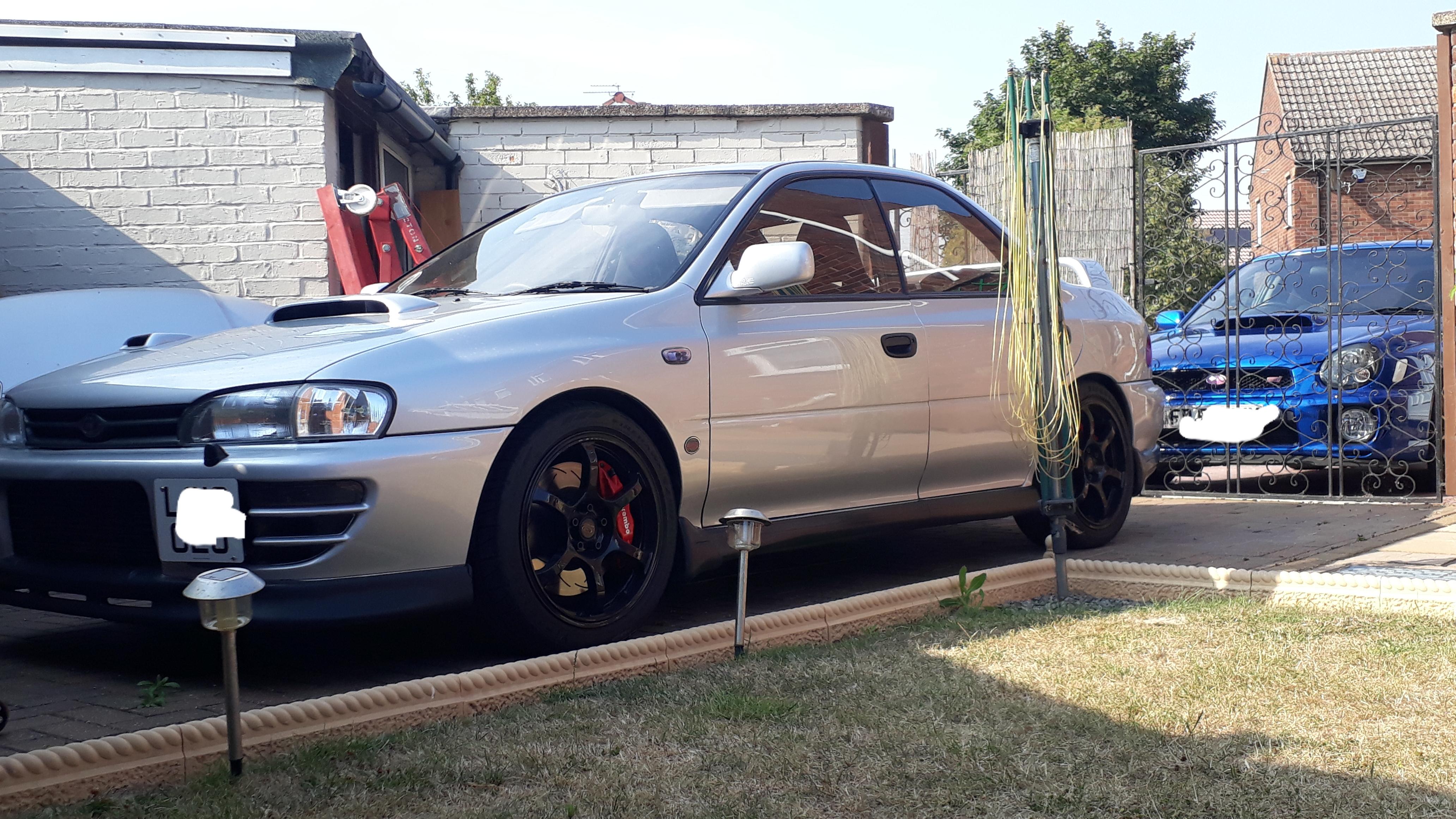

Well she's been demoted to the back garden "spot" for now as we're off too Wales for a week soon in the bug sti.
Hopefully I'll get the windscreen sorted shortly after we get back and I'll get chance to enjoy the bug on the road trip.

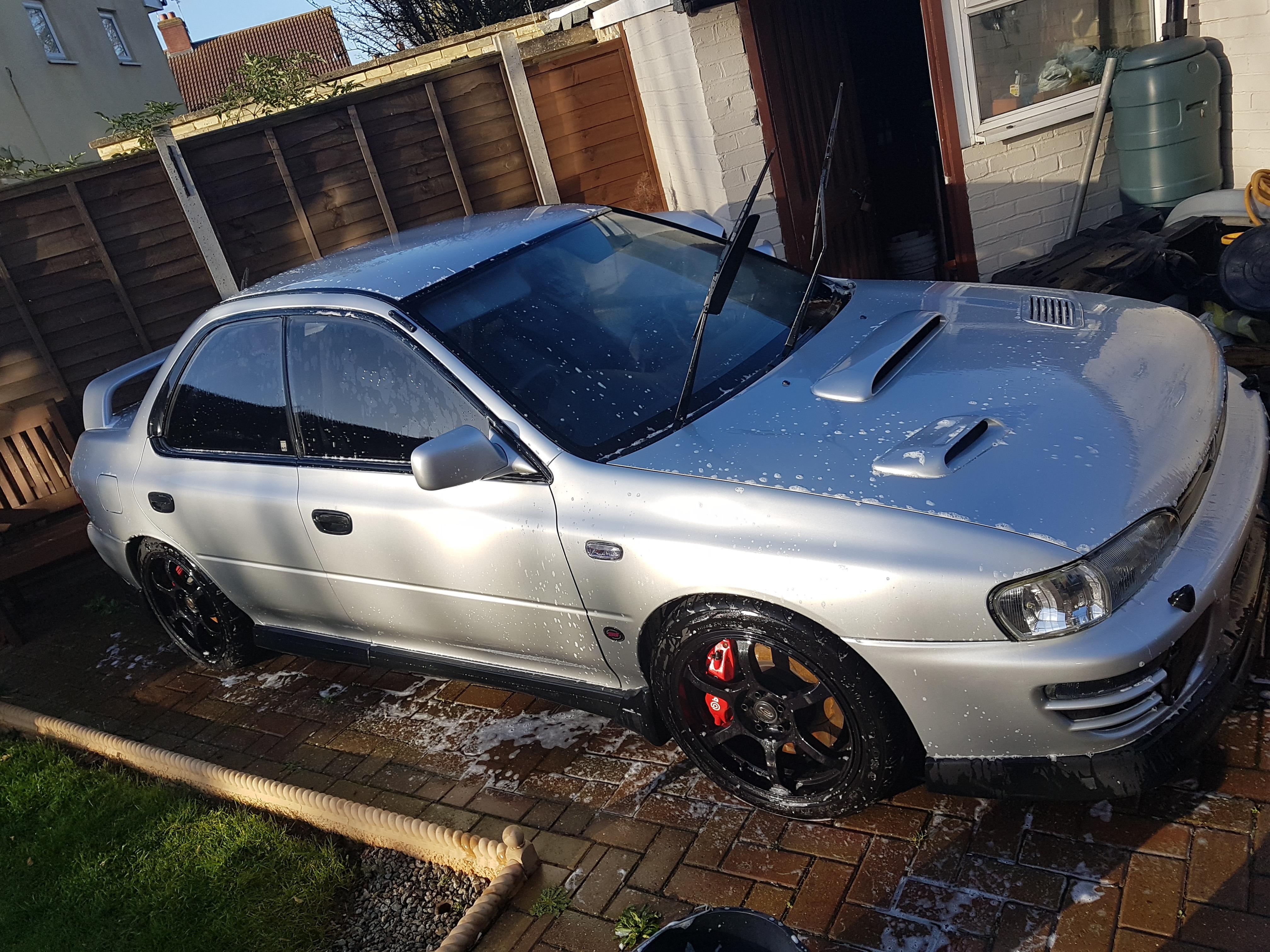

I've always driven the v1sti all year round but seing as i have the bug sti and the 24yr old sti has recently had a full respray,  i thought I'd take it off the road for the salty season.  I finally found a seemly decent 5 ply breathable car cover  for £50 😎

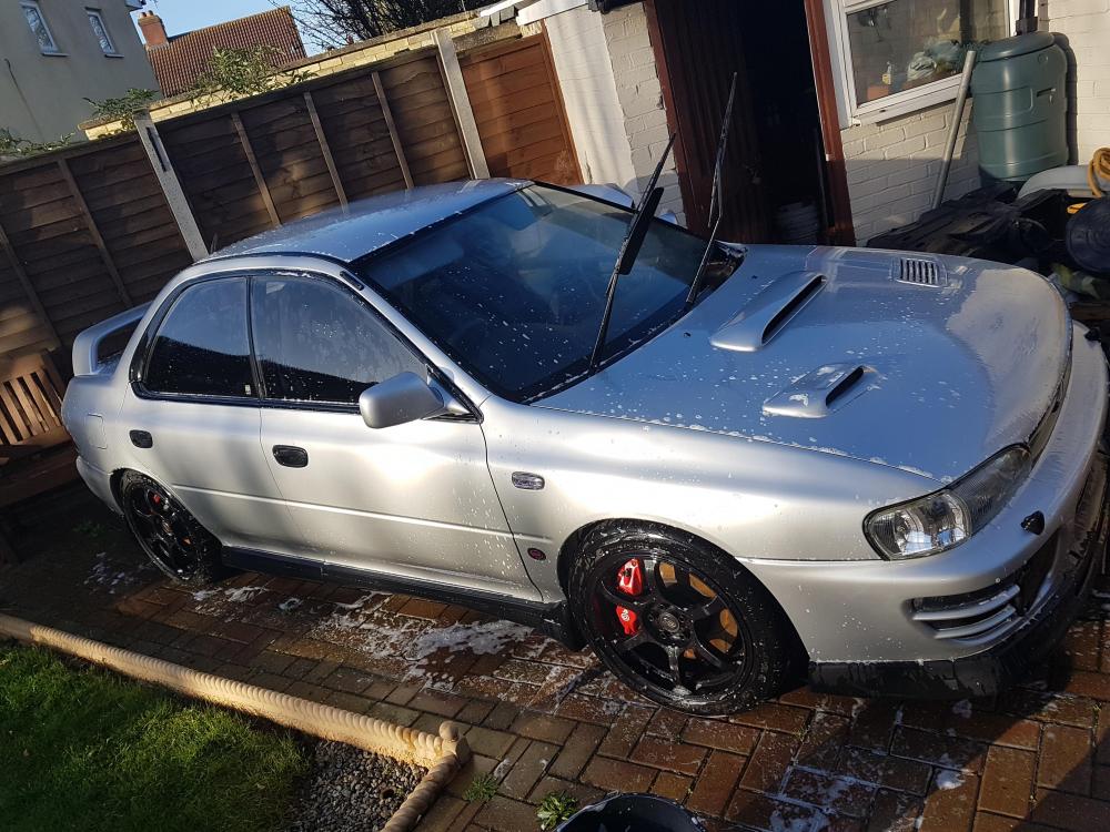

I gave the old girl its last bath of the year and took her for a "spin dry" to drive the moisture out the panel gaps and get the surface rust off the discs.
Being a scooby fanatic,  you'll probably be surprised to hear i quite like the look of evos 😶 but I'm not keen on being tailgated through town . Hit the sliplane and by by 08 plate evo 😊 well up to 70 mph when i dumped it 6th and backed off the throttle and he flew past looking unhappy that my 24yr old sti rinsed him from 0 to 70 mph 😂

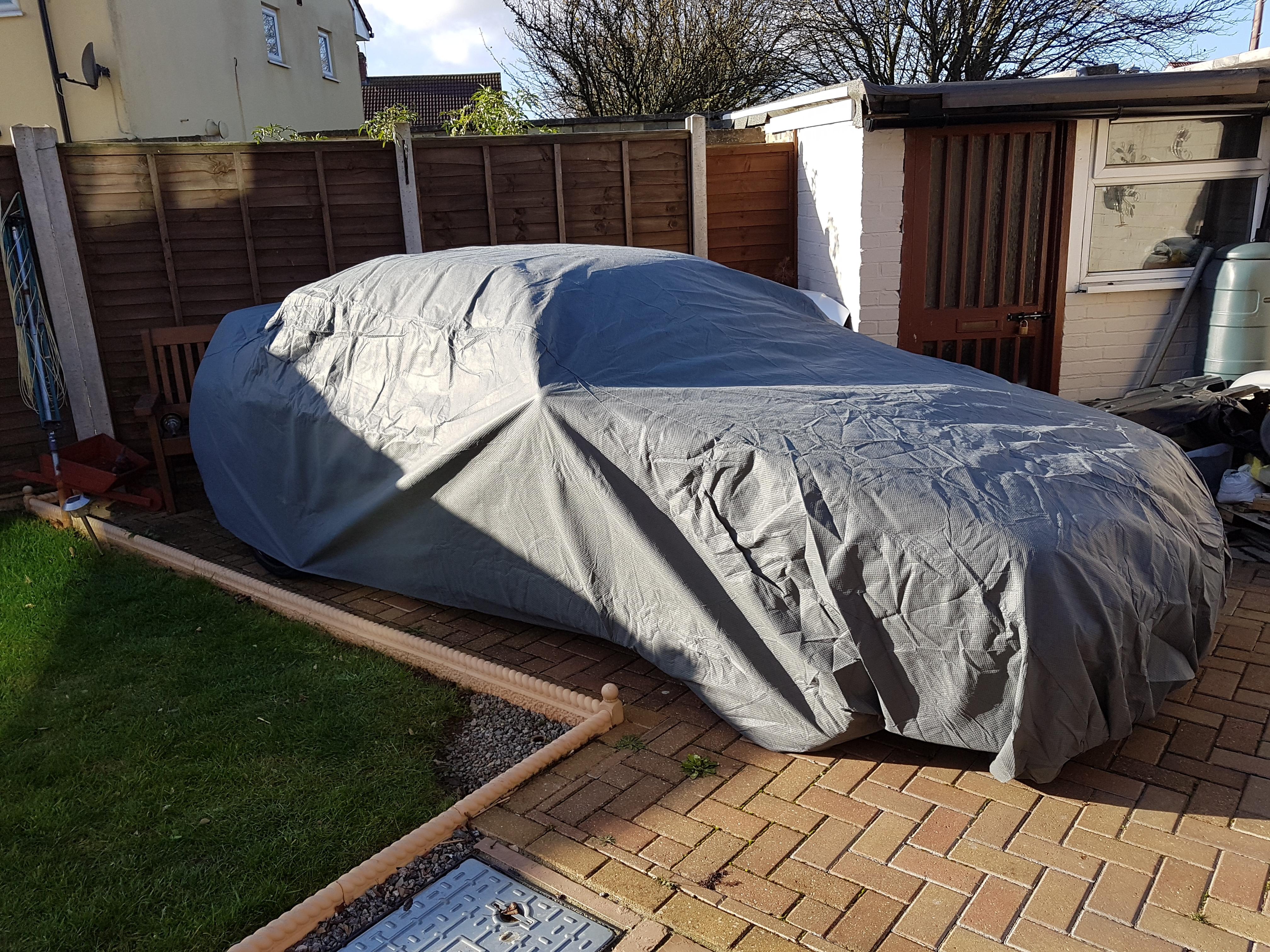

Soapy pic and one of it's current  hibernation situation 😥

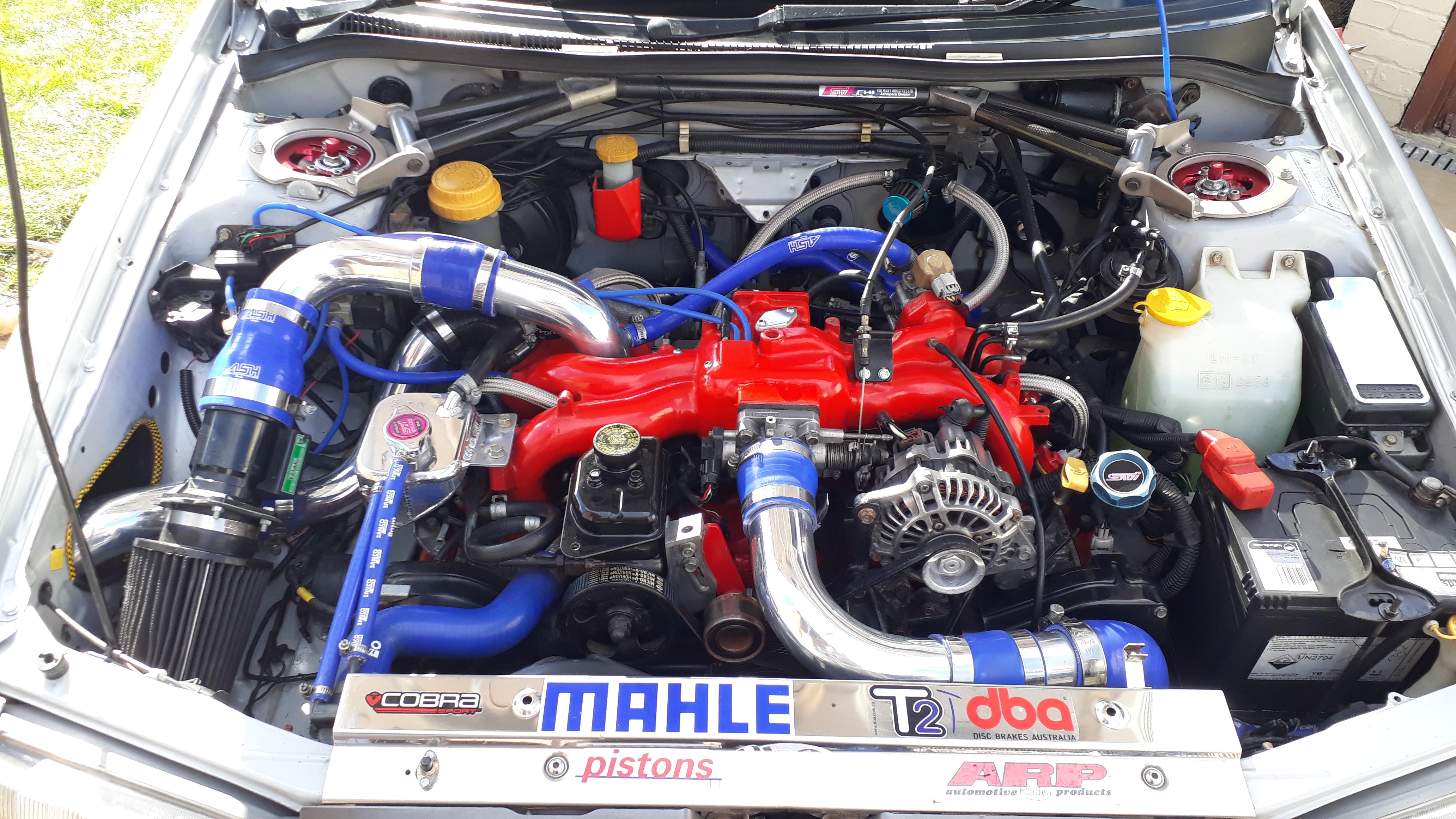

Seeing as she's been sleeping for a while and the weather's been in the plus degrees, I decided to start her up and run it up to temp . Gotta say I'm impressed with the car cover ,cos she's proppa shiny still underneath it 😎
Although it's still a bit too cold to strip the inlet manifold off ,it's spurred me on to start the ball rolling on getting the old engine loom replacement lined up.
Due to the custom reversed inlet manifold I'm running a v3/v4 throttle body ,cable and tps . I've also done a newage coilpack conversion, so decided to get "jt innovation " to make a custom made loom .As not only would a second hand loom be 25yrs old ,with insulation just as brittle as the original one ,it would need to have the newage coil pack pigtails and v3 tps plug spliced in again 🙄.

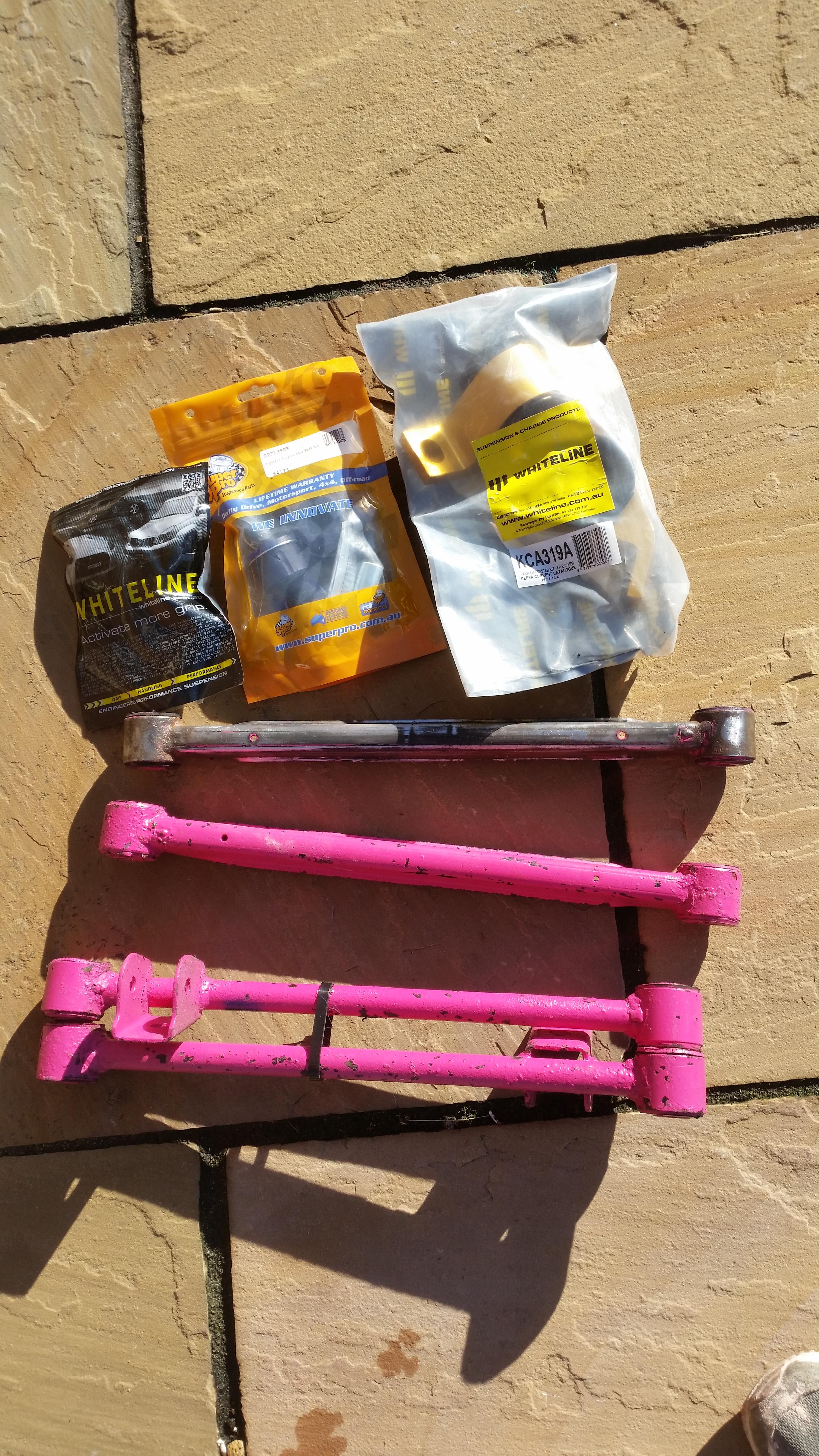

Seeing as I'd bought a Whiteline anti lift kit and super pro wish bone bushes ,I decided it would be rude not to freshen up the rear bushes too 😊
So I bought a set of second hand rear trailing arms and lateral links for a tenner to clean up and fit new bushes in.I'd been putting off cleaning them for a while, as it's a gonna be a cack job to remove the "sti pink paint " that had been slapped over them .
