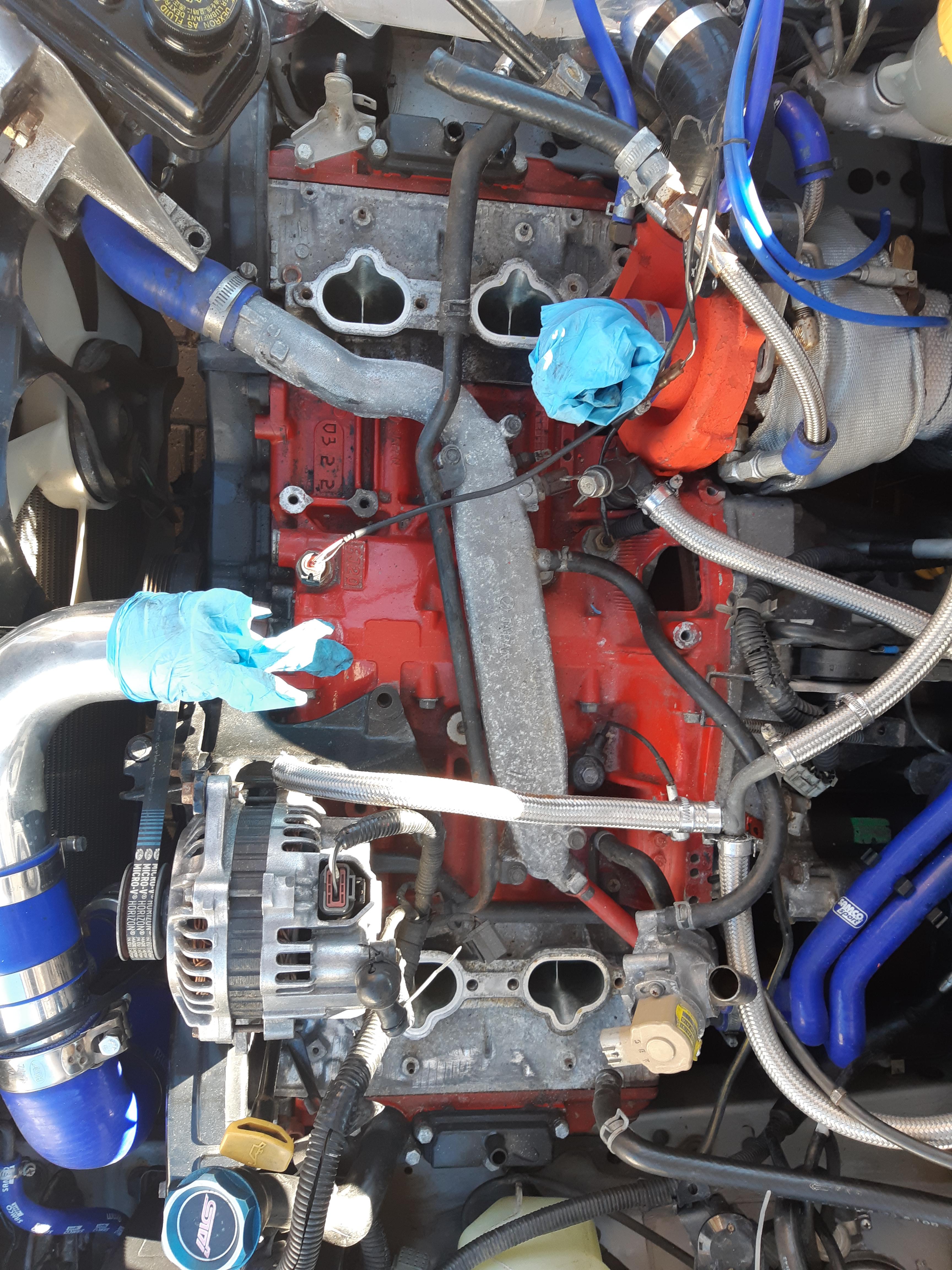

Had a little free time this afternoon,  so started to strip the the car down. Seeing as I'm going to get the inlet manifold powder coated ,I thought I might as well see if any of the disused lugs can be cut off the inlet to tidy things up a bit .

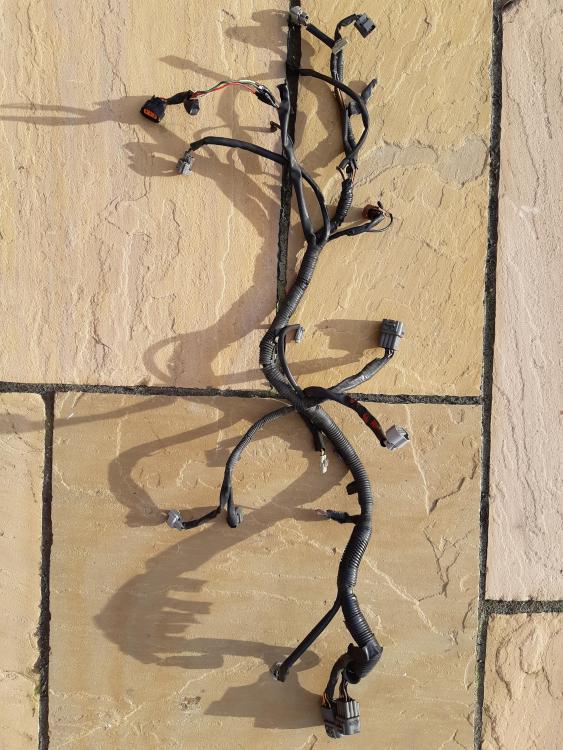

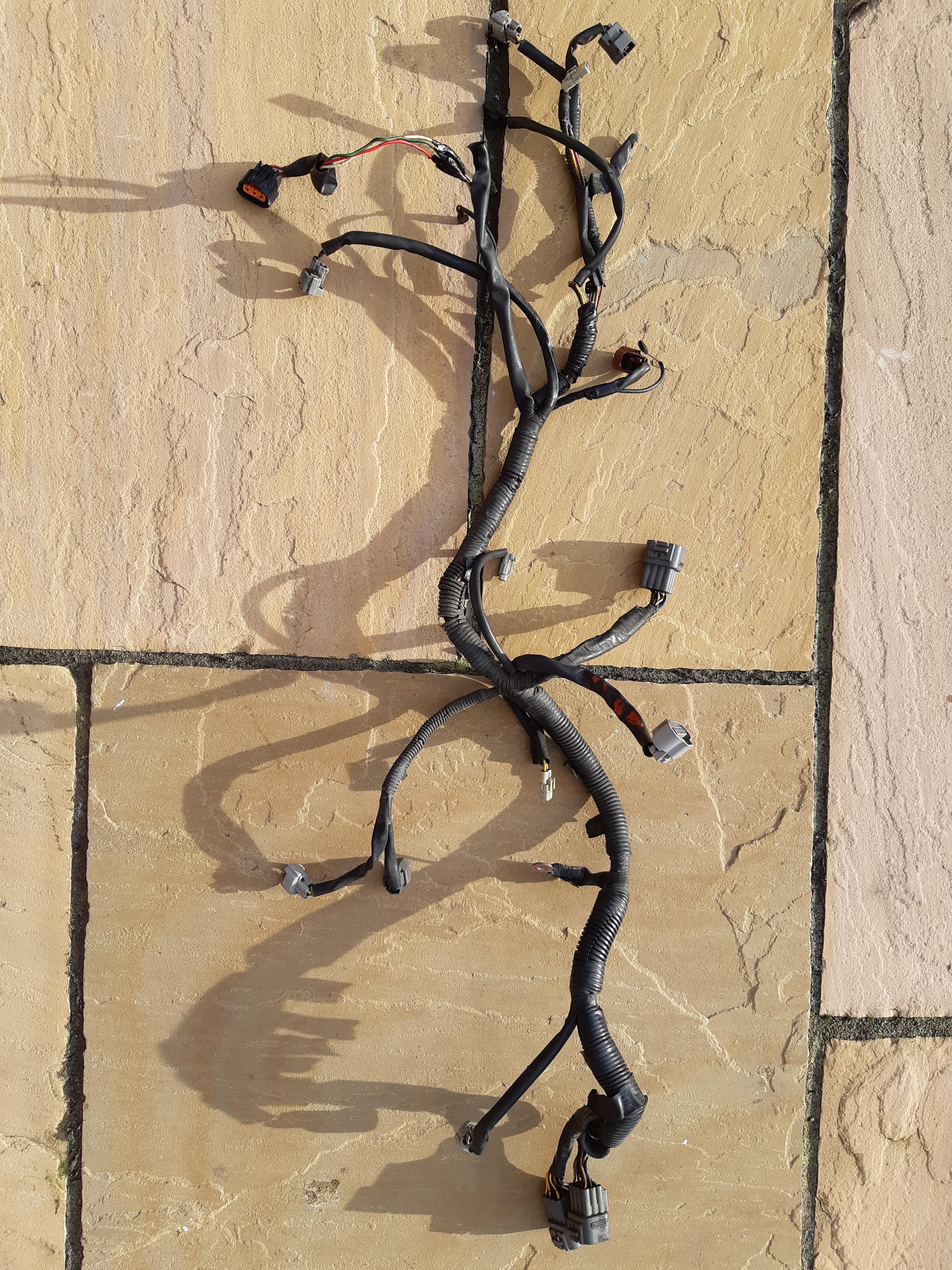

The 25yr old engine loom has seen better days and has caused a few electrical gremlins, due to the insulation going brittle . I'm currently running a phase 1.5 tps , tps plug and new age coilpack conversion , so even if I could find a good second hand replacement I'd have to splice a few things in again .
I've bought a few sensors off J.T innovations in the past , so decided to get them to make a new custom engine loom . Pic of the previously patched up crispy loom .

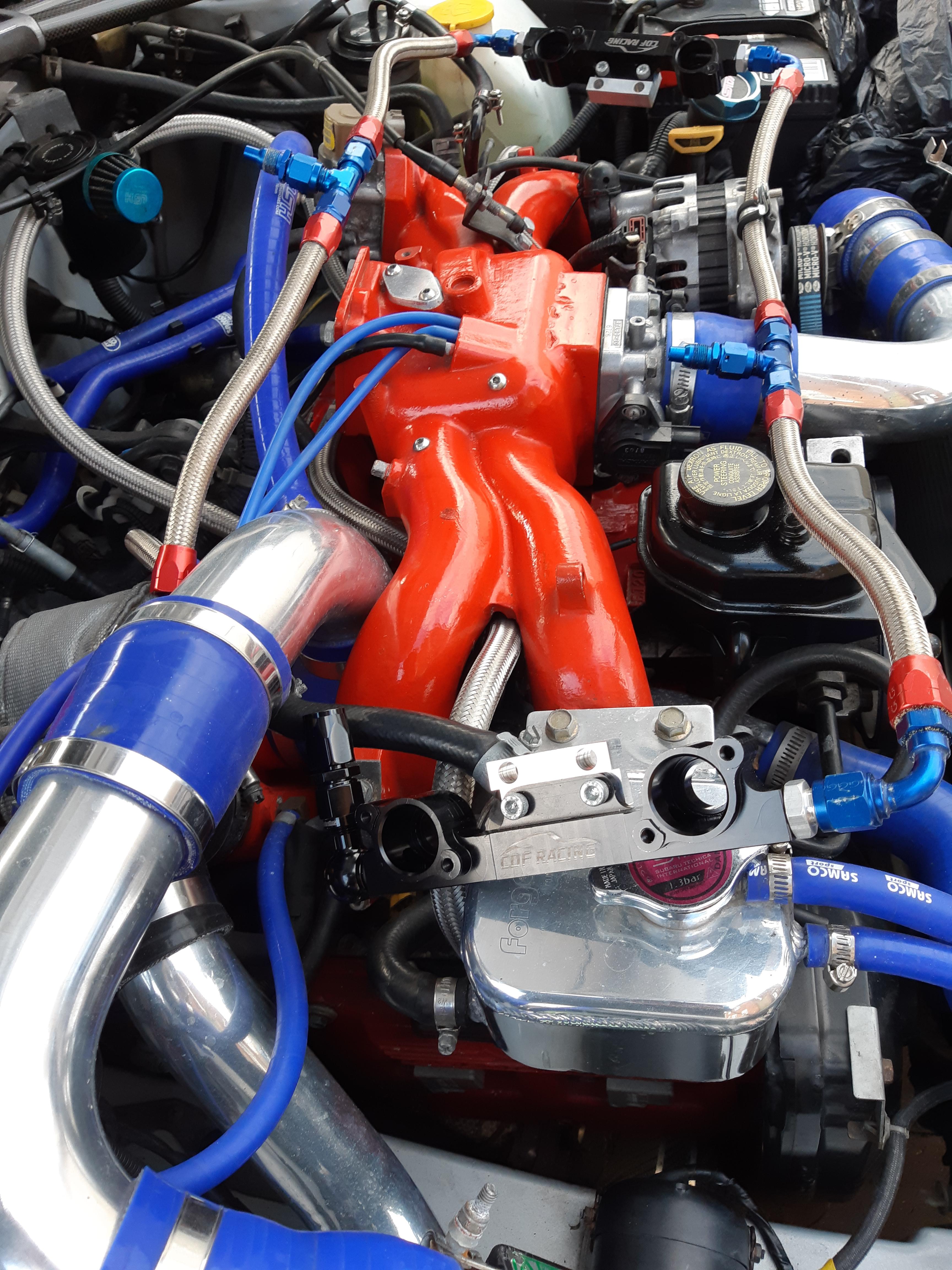

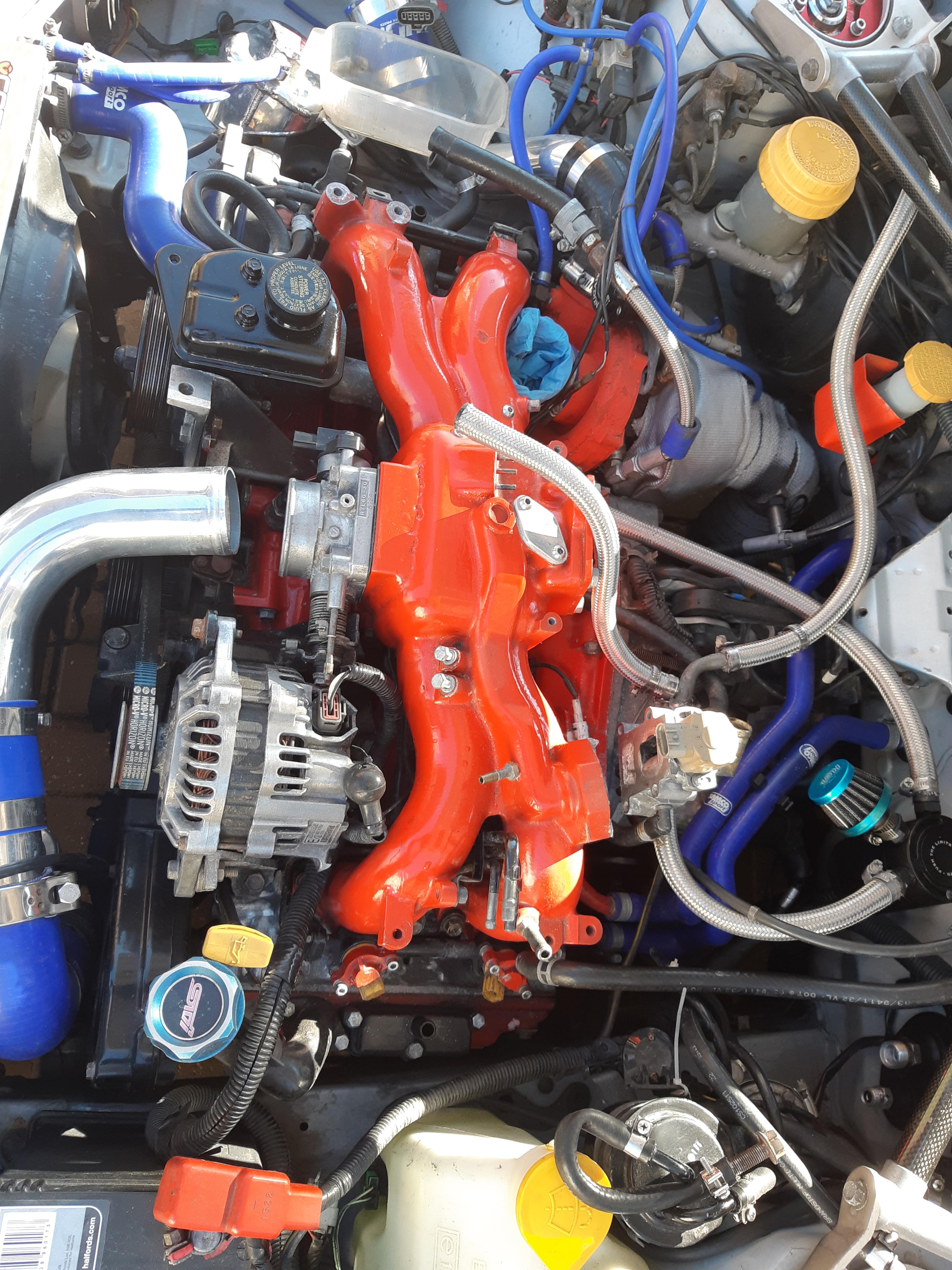

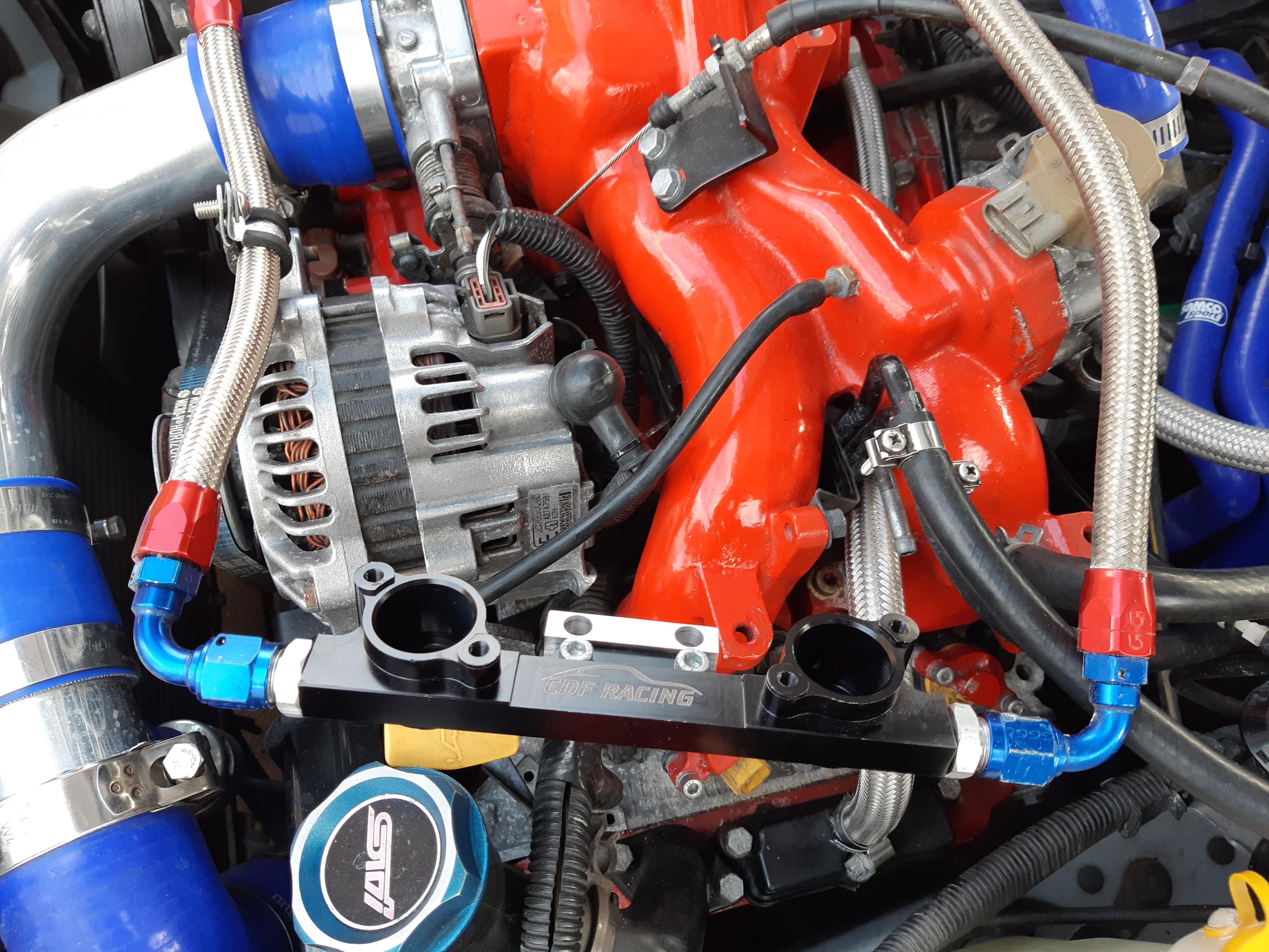

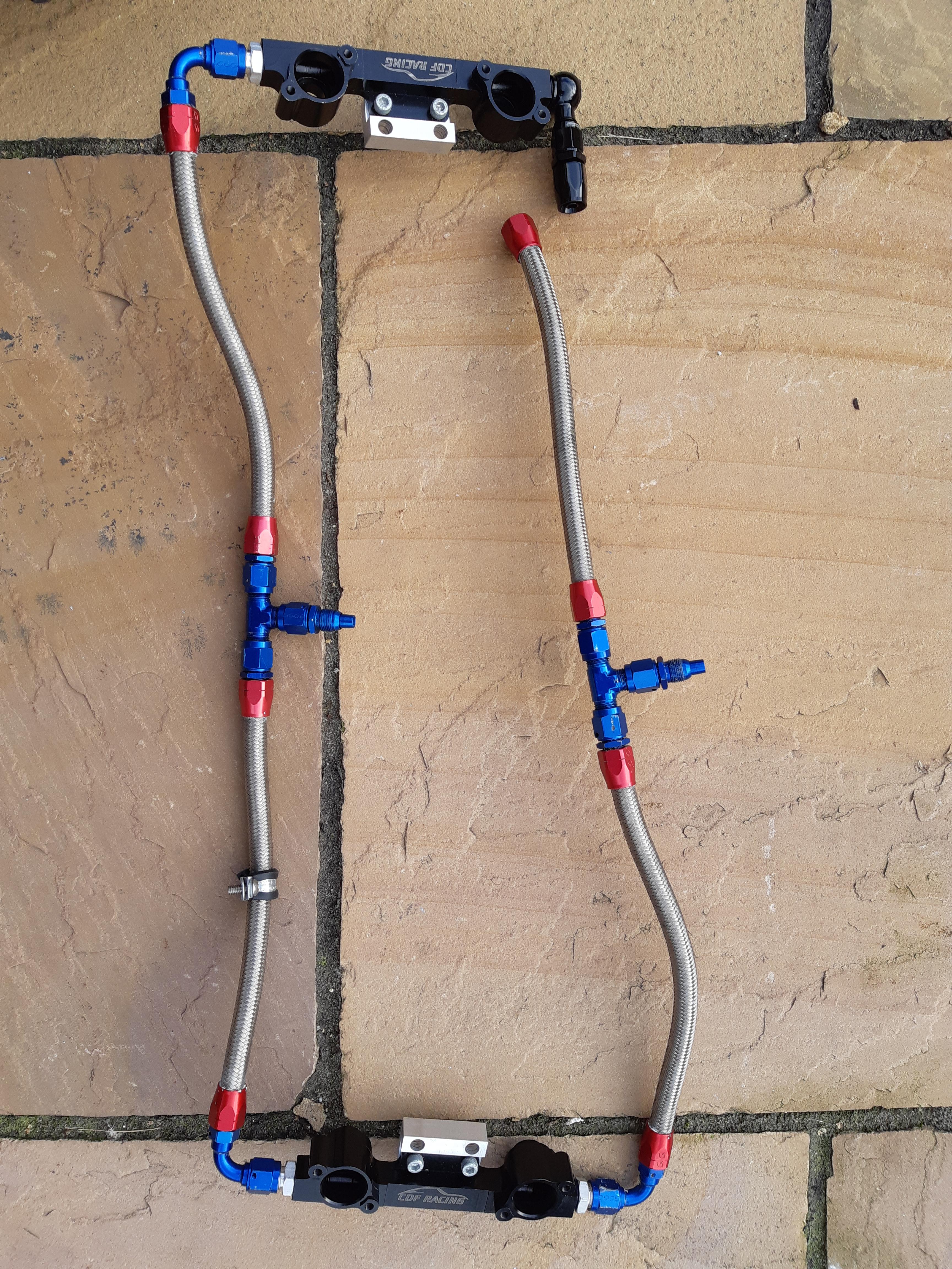

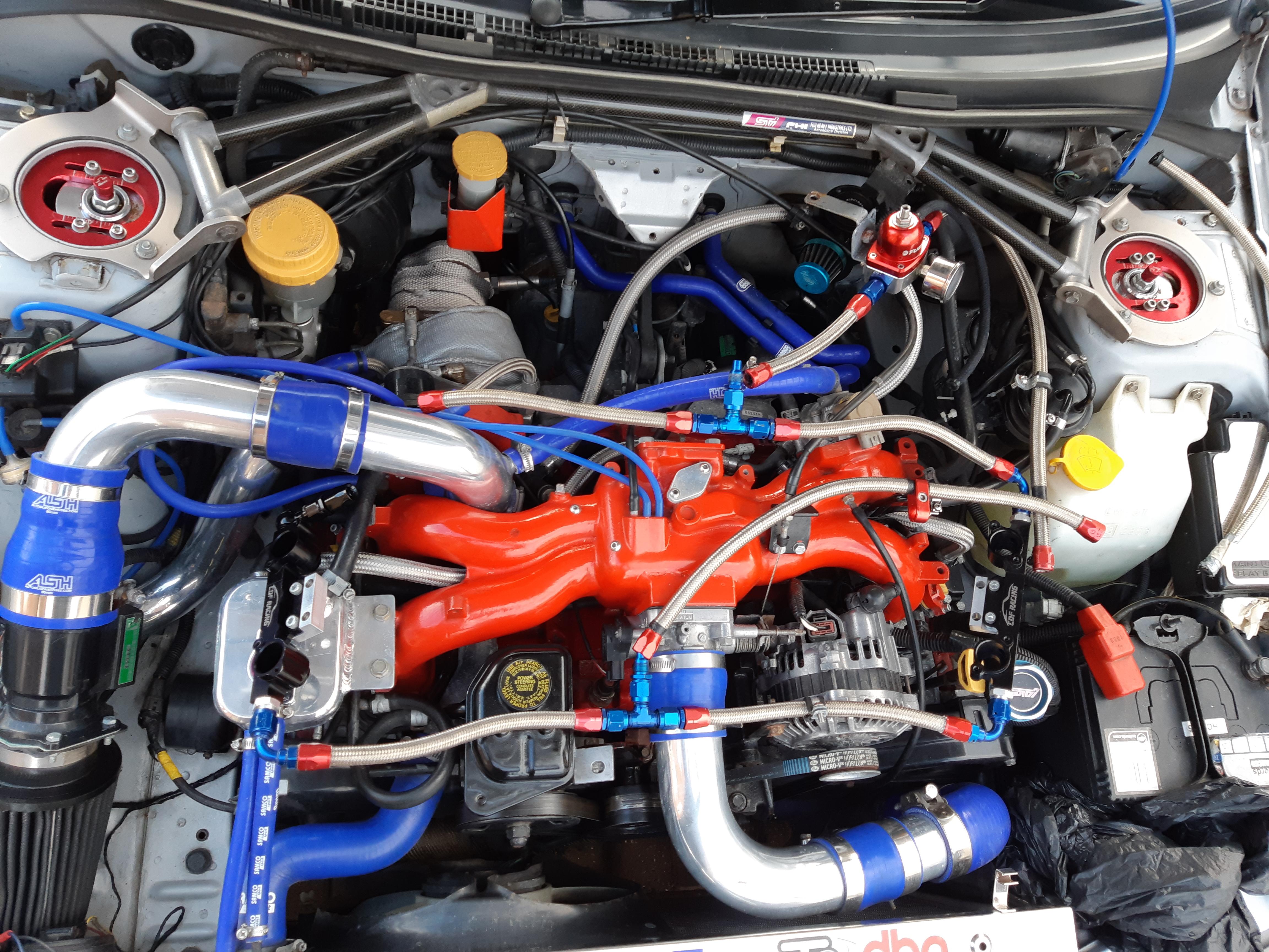

Doing a bit of research atm to try n find out if having a different fitting on the end of one rail will cause fuel flow /pressure differences between each bank . I needed to create extra clearance away from the clocked turbine housing , so fitted a racingline banjo bolt (black fitting in the fuel system pics)
Although at my level of power or type of usage, I don't really need to go "parallel" .
I've over thought and engineered most of the car , so why not the fuel lines too.

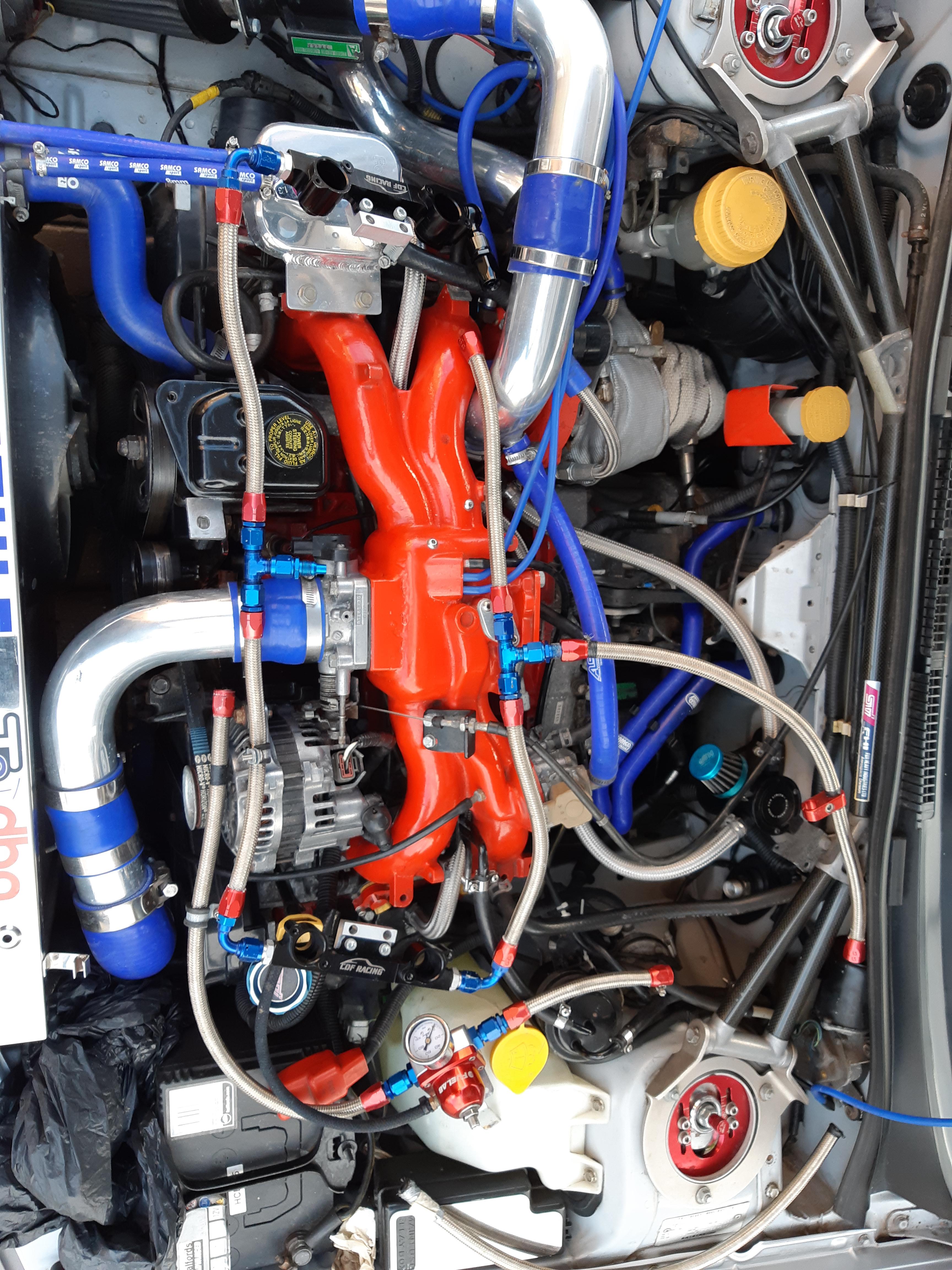

The oe fuel system runs a "series" set up , this means cylinder number 3 is the last in line to get fuel . a parallel fuel rail conversion allows the fuel to flow into the end of each "rail" and return out of the other end , so no particular injector is last in line to get fuel anymore.
A few pics of me trying to work out which lugs to remove off the inlet,  once the oe rails are gone and which way to flow and return the fuel lines.
Personally, I think a parallel set up is a good idea for anyone increasing your power on your engine.
99% of the time it’s that number 3 piston/rod/bearing that fails because of it running lean.
If you can do it yourself, it doesn’t need to be expensive as you can use the original parts with an aftermarket pressure regulator. That being said, a kit like @savage bulldogs is comparatively inexpensive compared to an engine rebuild.

Ross , I do like to do as much as possible myself but the fuel lab fpr made up lines and v3 /v4 modified rails came up cheap from a friend of mine .
He had them made up by a professional company and although I like a challenge,  cutting stainless steel overbraid lines ain't my favourite job . So I bought them off him and some billet phase 1 rails off cdf ,as the v3/v4 rails don't fit my phase 1 inlet 🙄.
I agree Sam,  cylinder 3 is normally the weak link, due to being last in the fuel feed and tucked up at the back of the bay next to the up pipe and turbo (hottest cylinder) .

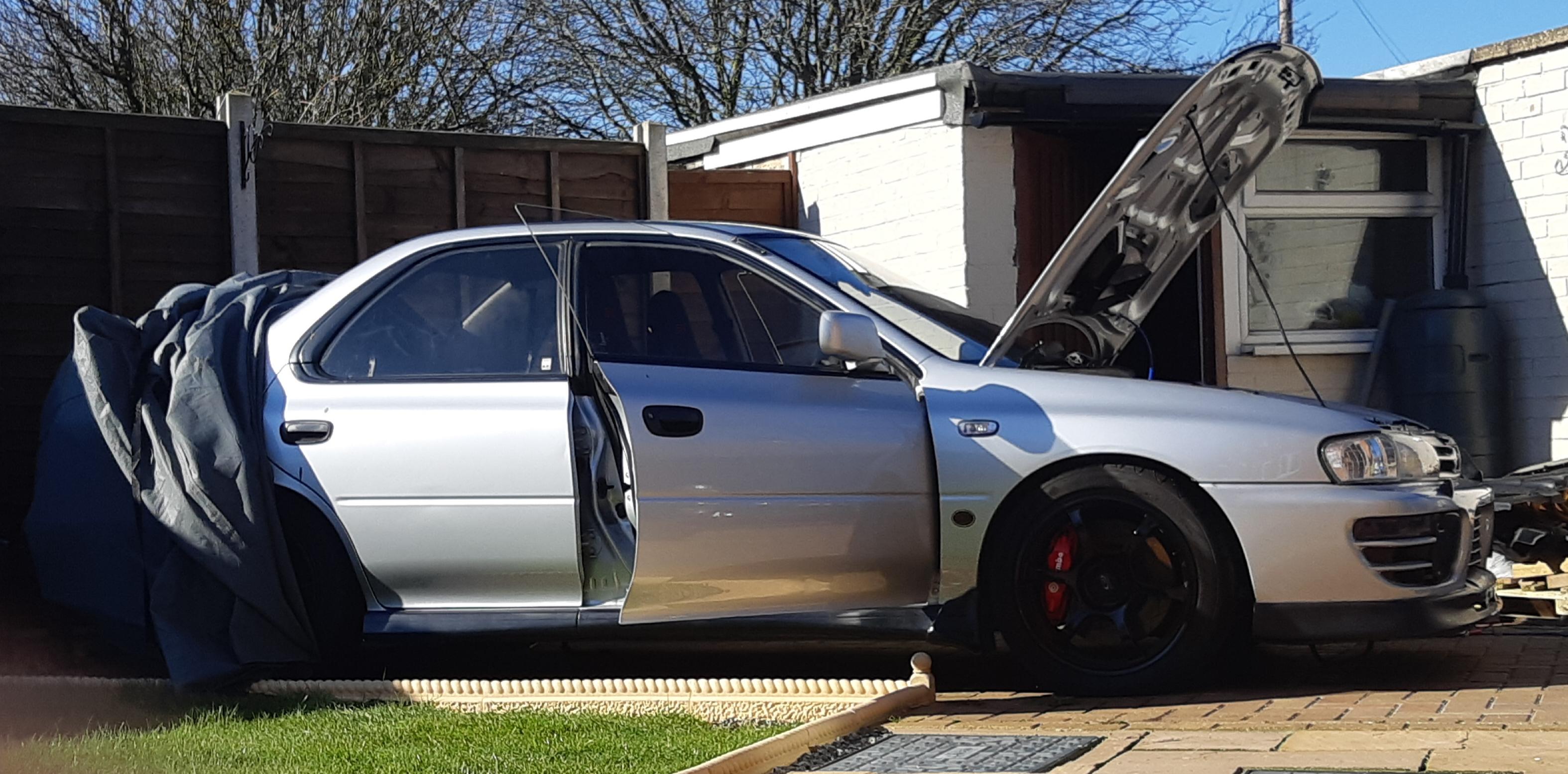

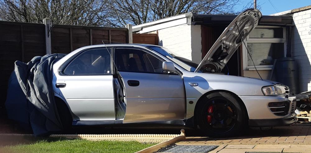

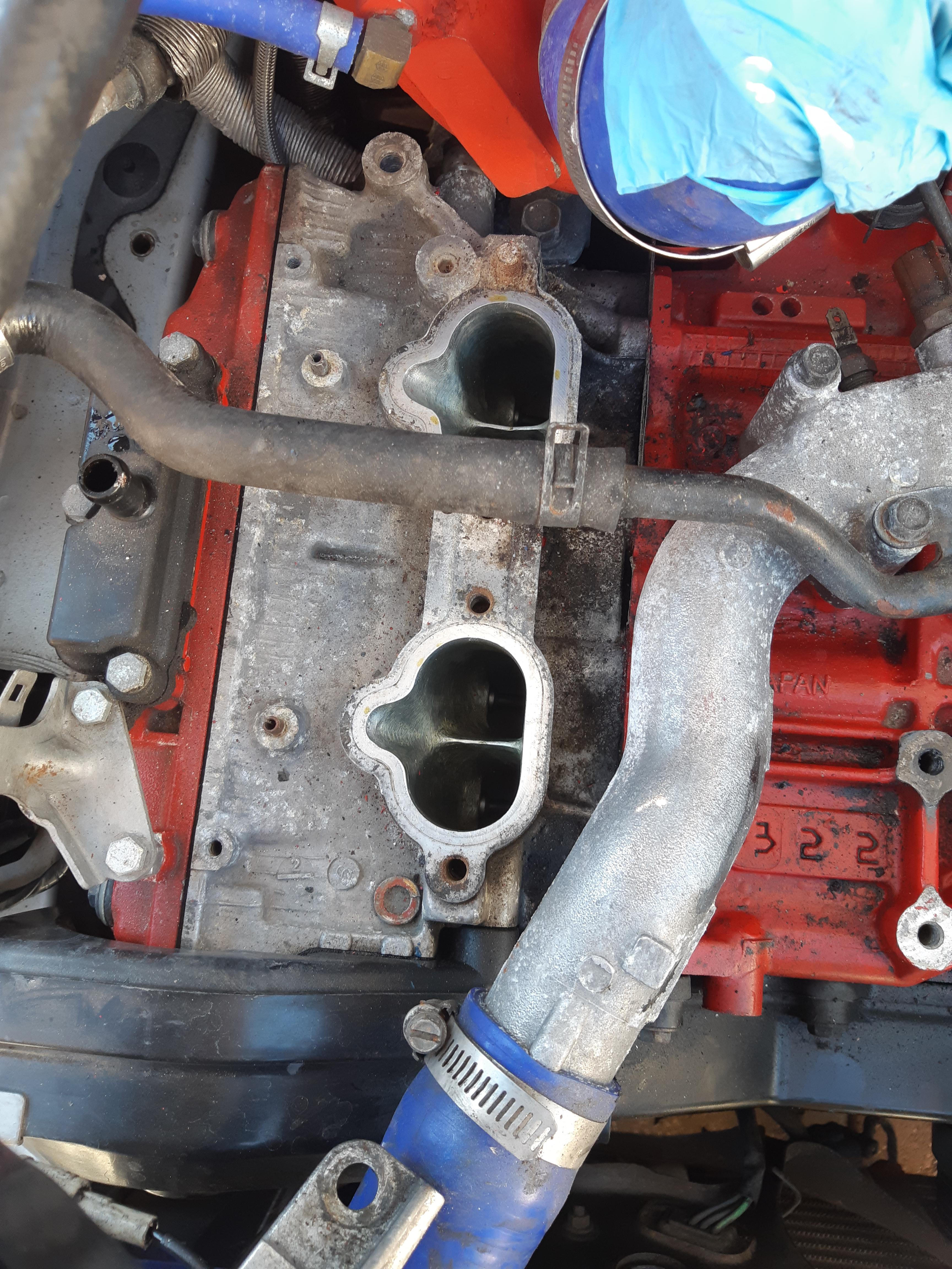

Made a start on stripping the inlet off ,so I can trial fit the fuel rails and work out what lugs I can cut off prior to powdercoating .
Seemed like a nice day for it , so I pulled the car cover right back to give the old girl a better airing. Everything has been on and off the car numerous times so didn't take too long , to get to the point of removing the inlet bolts .
Quick cuppa coffee whilst staring at her in the sun 😊
Then a bird dive bombed and shat on the drivers door and rear 1/4 ffs lol
I'd fitted some thermal inlet manifold spacers about 2 yrs ago and the kit came with longer "Allen/hex type bolts " to bolt the inlet to the heads . I built this engine about 5yrs ago and the only fluid on the block was a minor bit of power steering fluid ,leaking from the p.s pump 😎
Most of the bolts are showing a bit of tarnishing but the 2yr old thermal spacer kit bolts looked proppa rusty in comparison to the rest of the older bolts 😏
Then "snap" cylinder 3 outter inlet bolt (closest to thr turbo) snapped in the head 🤐😥😤🤬
Hopefully I'll be able to remove it without drilling and retapping it 🤔

There's about 30mm still sticking out,  so I've ordered a "cam type" extractor,  which will hopefully get it out . If not I'll pilot drill it, wind a old skool bolt extractor in and run a tap through it to clean the threads .
