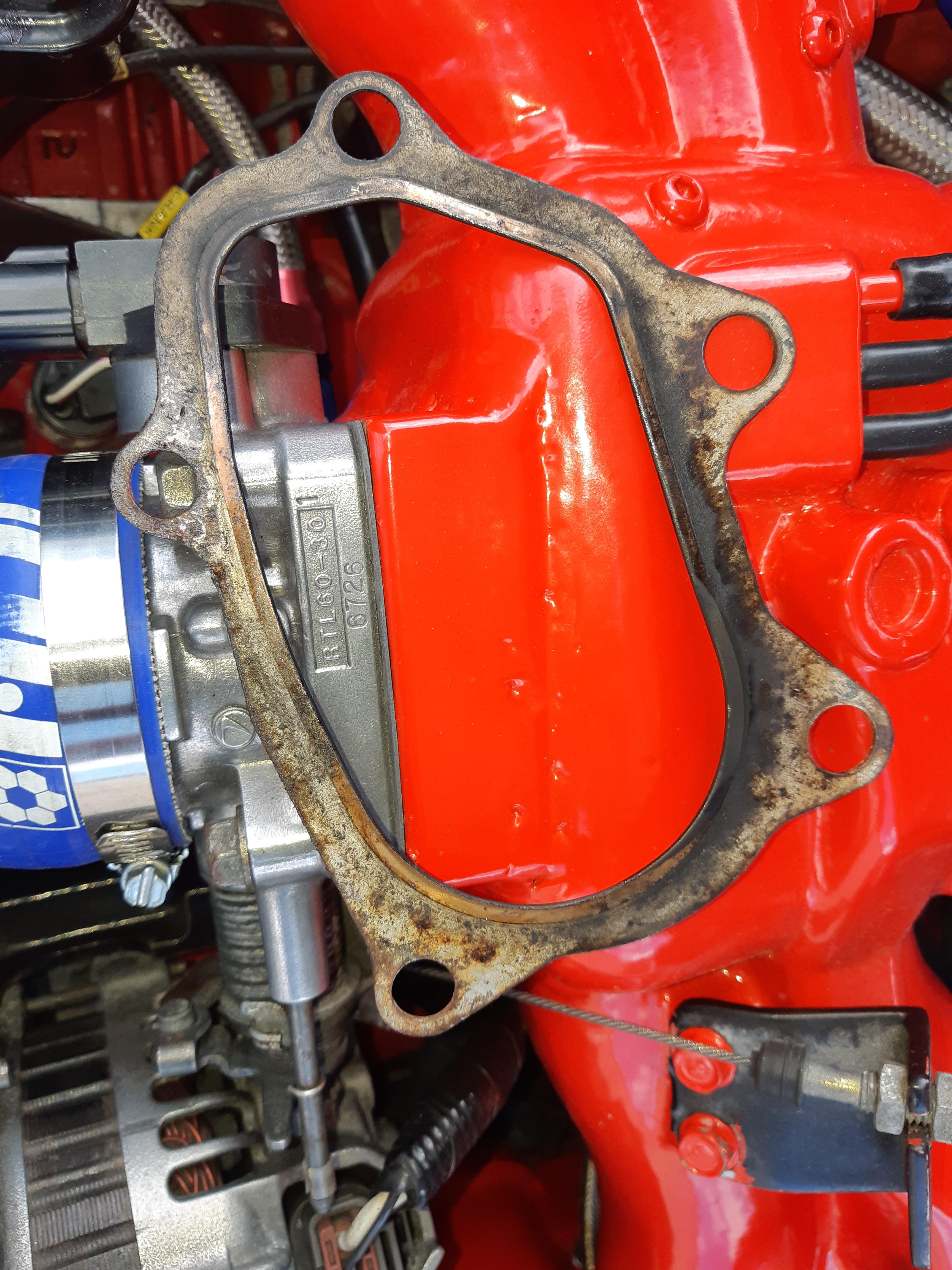

After cleaning maf ,icv and tps , then tracing and checking all voltages to sensors and harnesses..... I learnt a lot about how all these sensors work together but wasn't any closer to finding the high idle issue 🤔🙄
Vacuum or intake leaks normally cause a high idle but accompanied with lean afrs , hunting and rough running. I'd carefully sprayed brake n clutch cleaner around the inlet ports and most of the air intake/vacuum system,  so pretty much ruled out a leak .

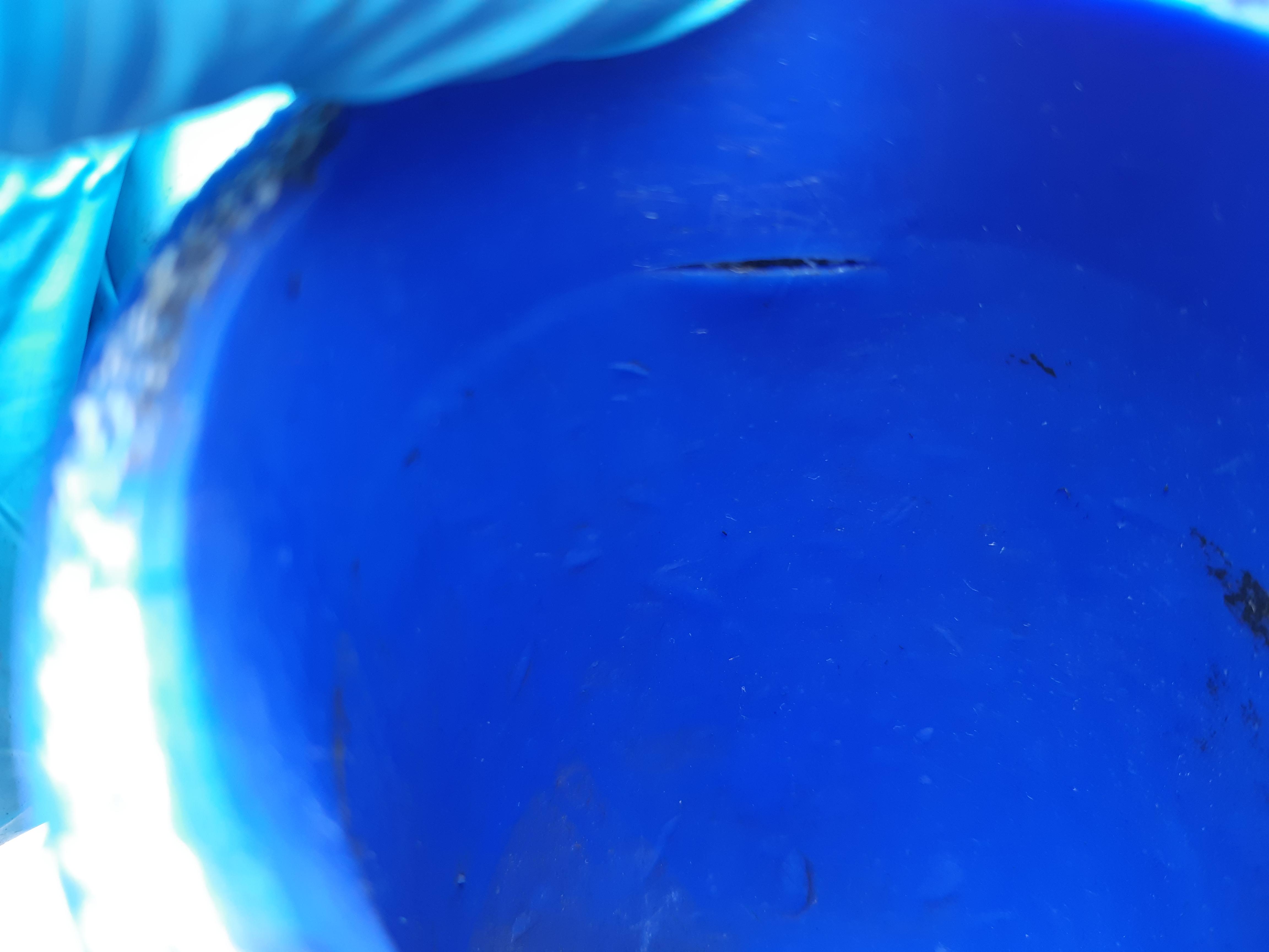

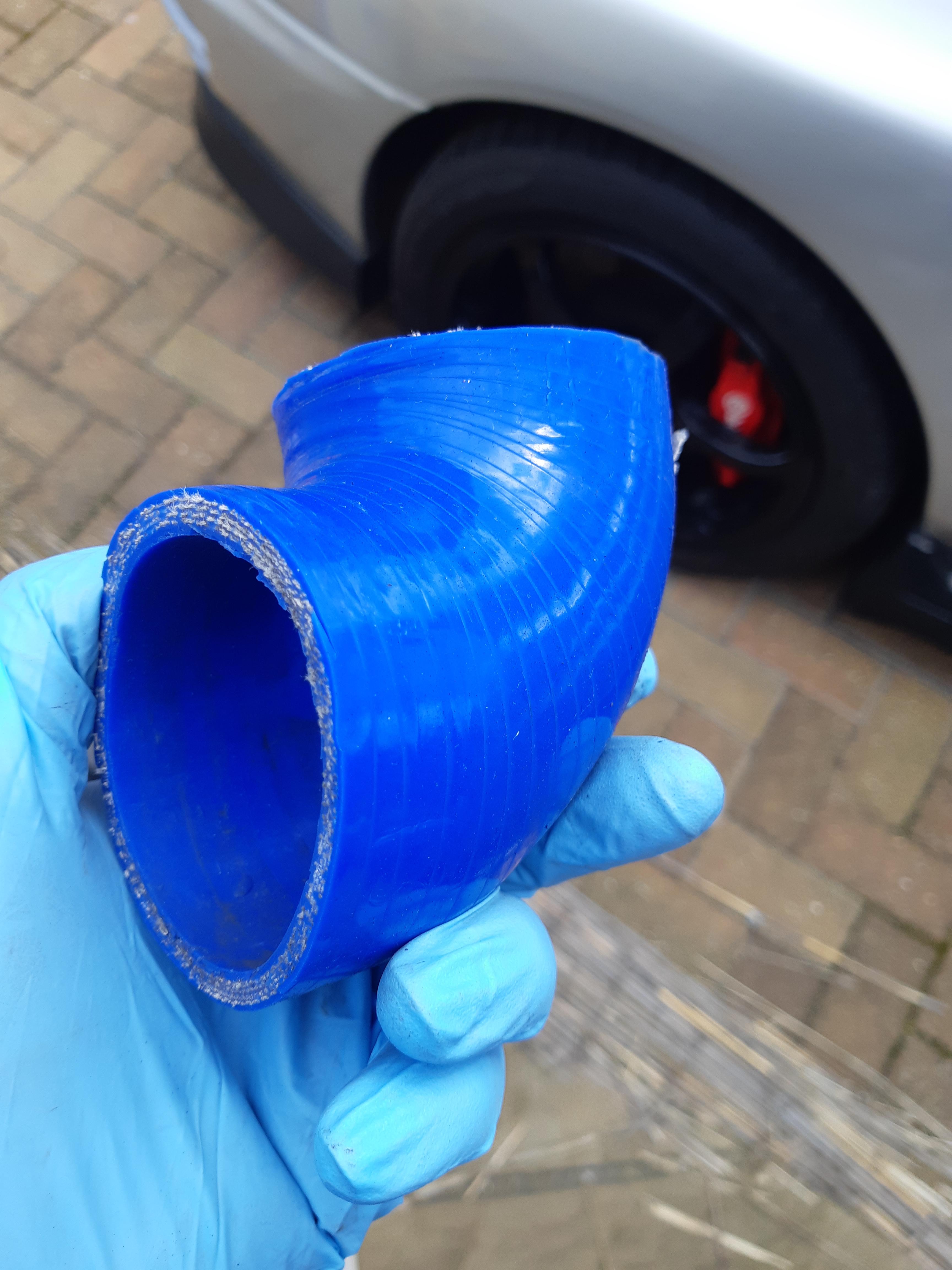

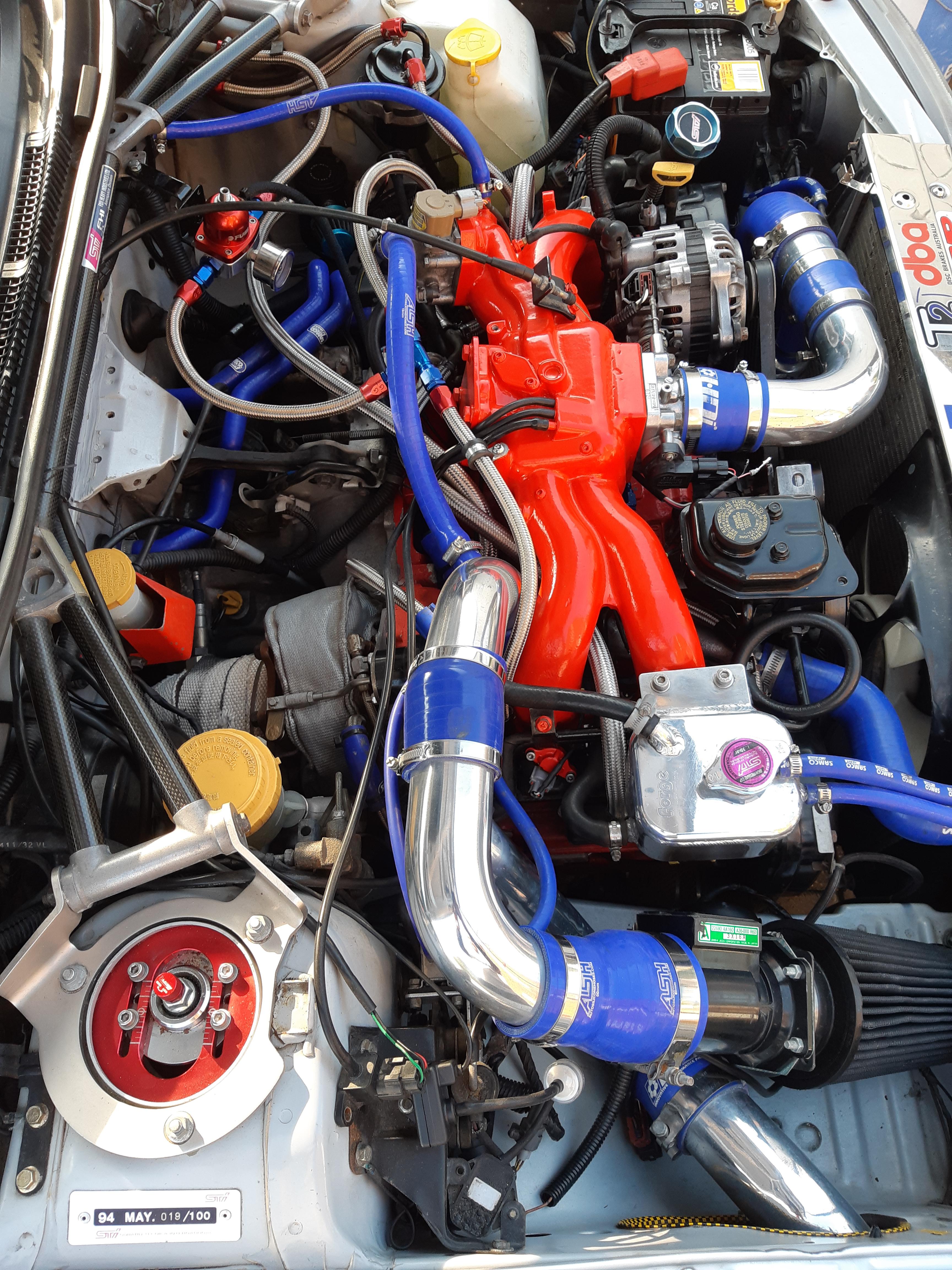

But I found a small hole in the silicone elbow, I cut to make the turbo to maf pipework (from a jubilee clip nipping it )
I also cleaned some of the powder coat from where the engine loom earths on the inlet , so not 100% sure which one fixed it but ... I fixed it 😊

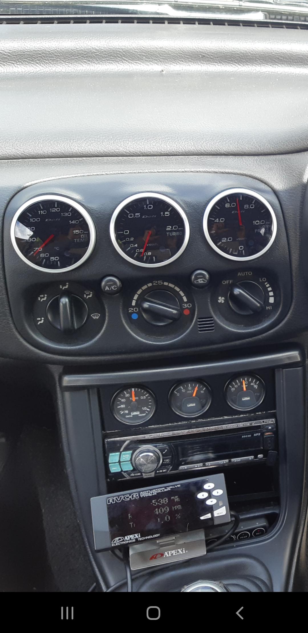

Also had the 3x 60mm custom preface center pod turn up and "south coast flocking " have made a lovely job of that.👍
So no more pics of the inlet , well until I've polished the alley  😋

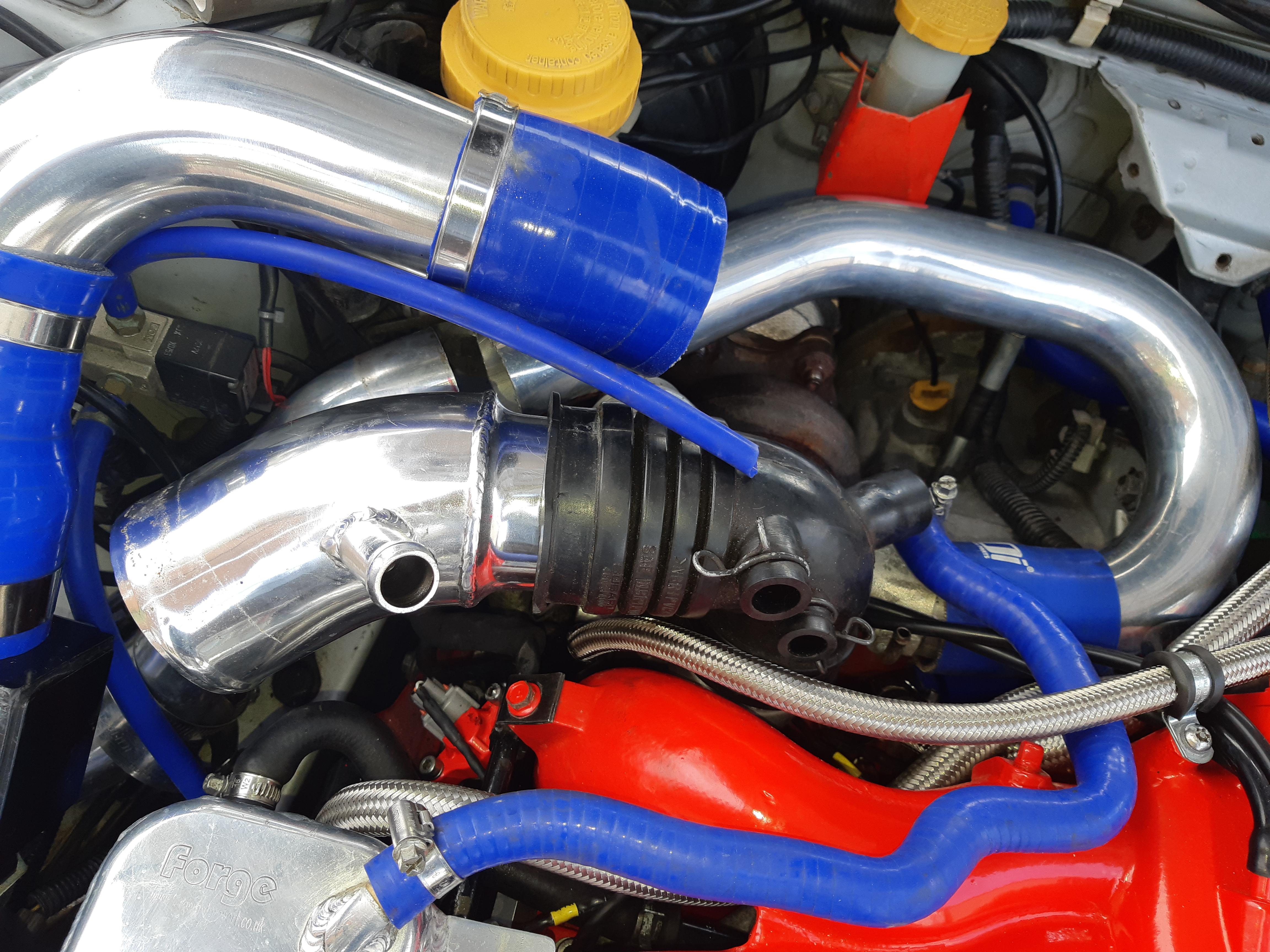

So here's a few of the offending elbow and defi pod fitted 😊
That pod looks sport on!

Managed to give the ally pipework a polish and give the defis a test run (well happy with them ) , so here's another pic of the finished bay, one of the scooby (to prove it does move lol) and one of the defis lit up .

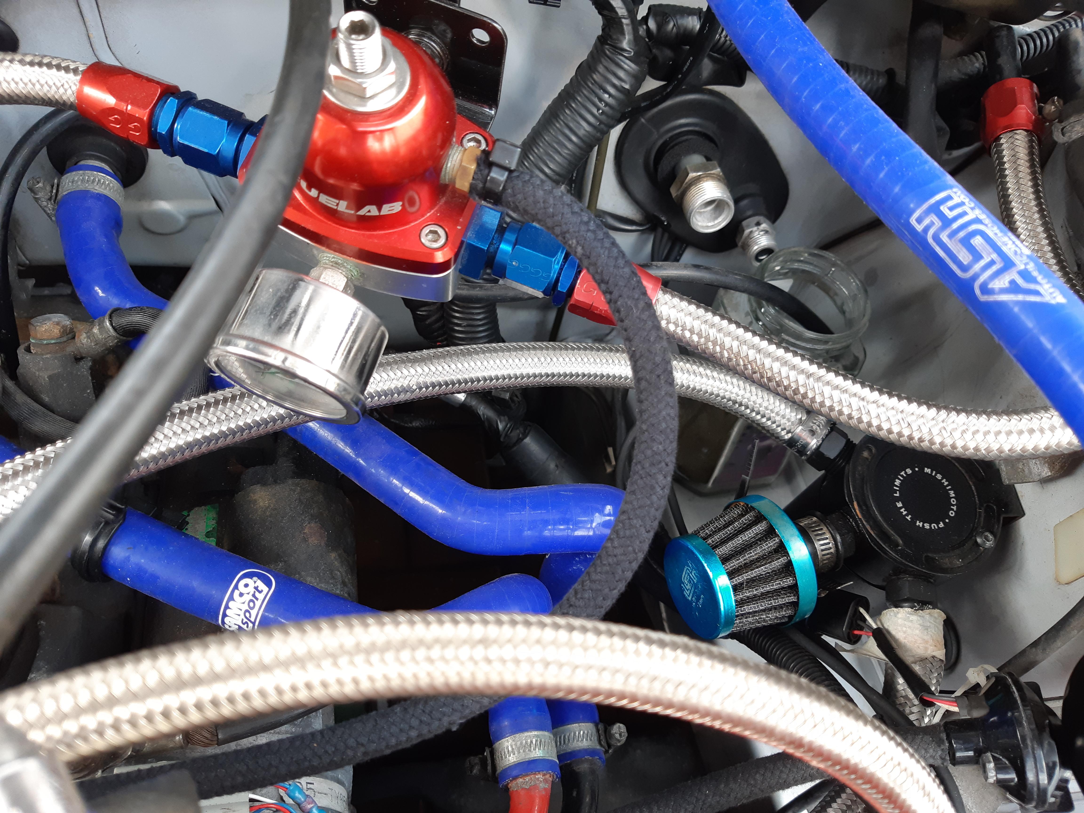

The old fpr didn't have a gauge , so I've just set the pressure at standard pressure . It seems to be running a bit rich , so I'll definitely get it checked over on attowe dyno at some point .

Still got a rich hot idle of 13.6 and I've been running it a lot at idle /cruise ,trying to locate the previous high idle issue .
Although I had set the pressure at standard rate I had no idea what the original adjustable fpr was running at , as it doesn't have a gauge (had no idea what pressure its been mapped on) . So I decided to wind open the fuel lab regulator and fit the old one next to it . That way the gauge on the fuel lab regulator would read the pressure on the old regulator. Then I set the fuel lab regulator to match 😉
This has improved the afr a bit and the rest could just be due to a increased flow from the bigger rails, new parallel lines and cleaned injectors.

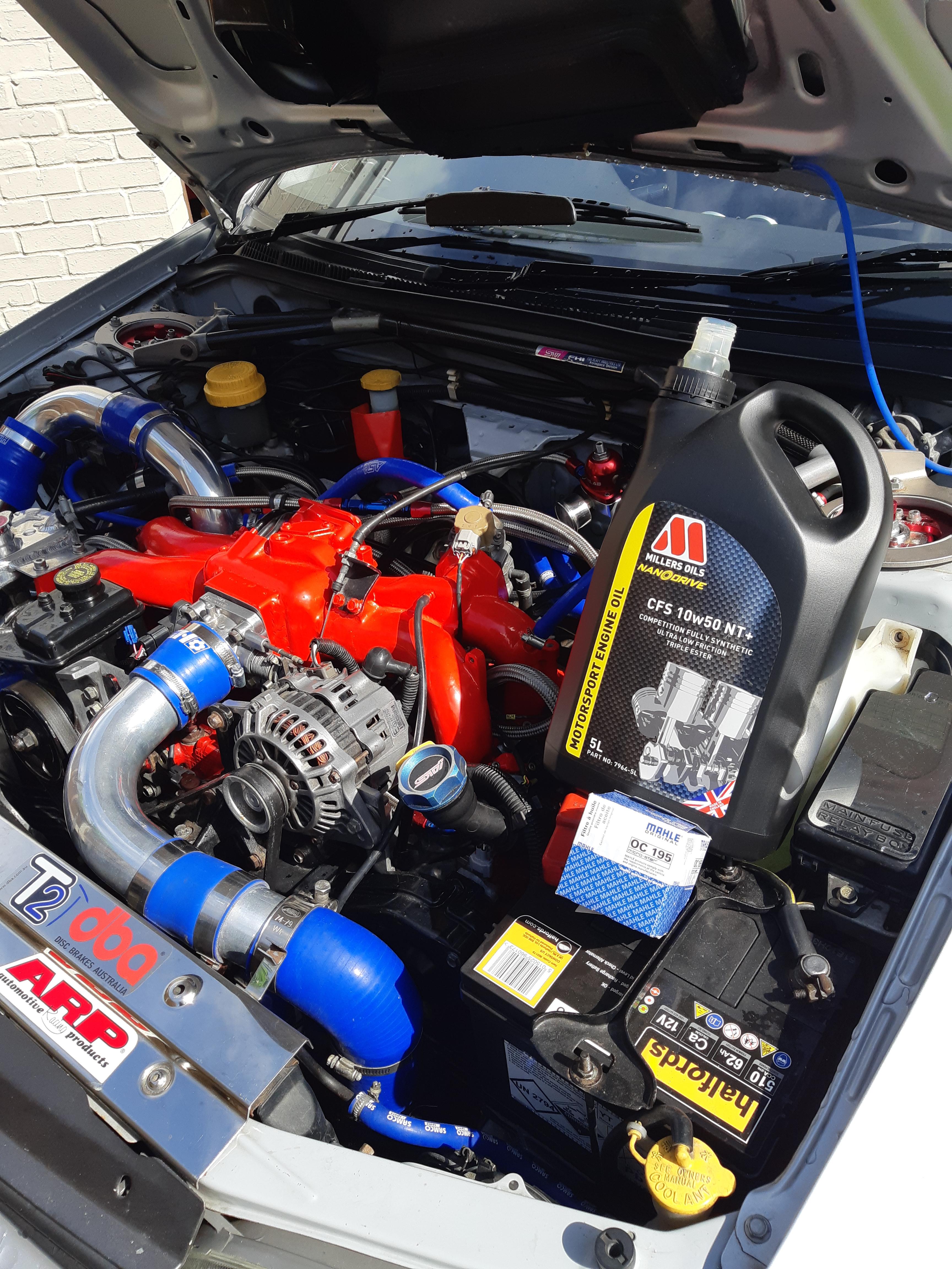

it's not excessively rich now and shes due a oil change in 1k , so I decided to change it earlier to lessen the chance of bore wash or the oil thinning.
Still  not 100% happy its running right but for now ,a repeat order from opie oils it is 😉

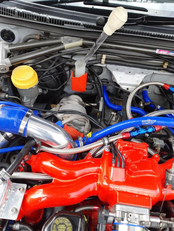

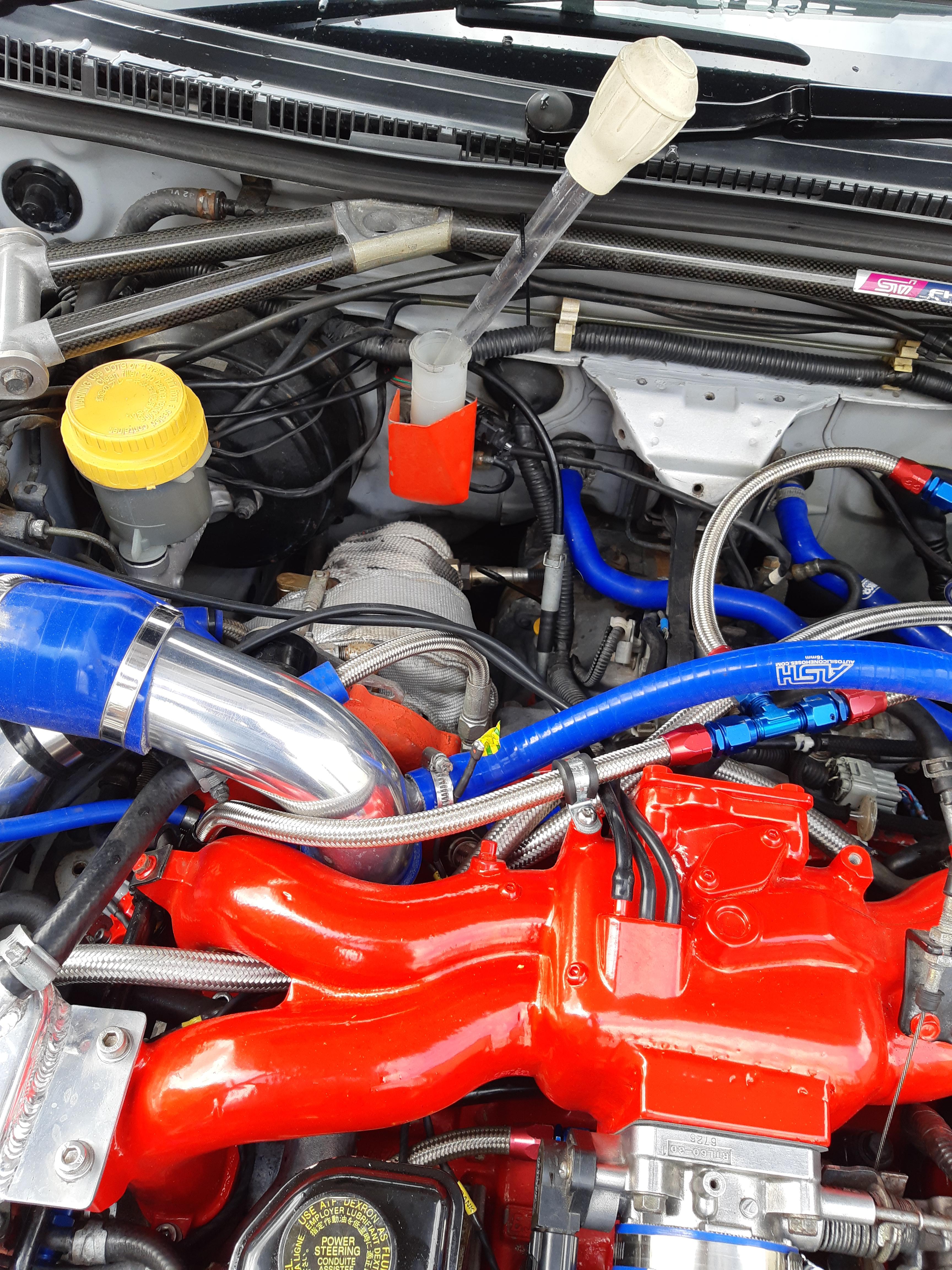

Started tidying up the scooby scraps shed and found a hel red braided clutch line 🤔 been a while since I refreshed the 6 speed clutch slave fluid , so looks like I found something scooby to do 😎
The clutch slave reservoir is located above the turbo hotside and although it has a heat shield,  it does degrade with the heat rising from the turbo .
So I took a couple of pics I'll post at the end to show my method of changing the fluid , using a Turkey baster to remove the main of the old fluid then flushing and bleeding the system into a glass jar (sat on the chassis leg) with a vac line .
Rain stopped play so I've still got to fit the new line and bleed it but you should get the jist,  just don't get brake fluid on your paintwork as it will strip the paint down to bare metal 😉

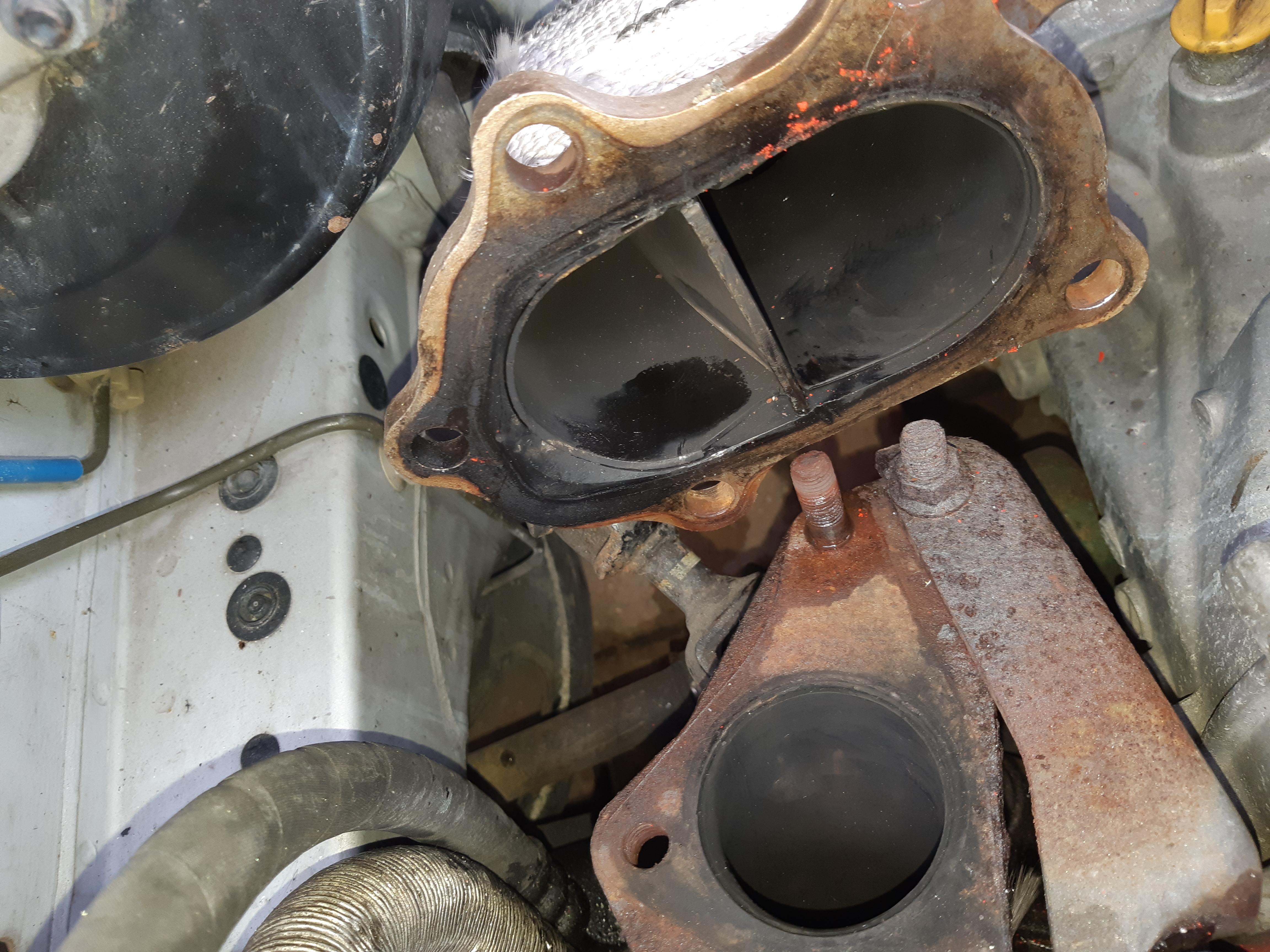

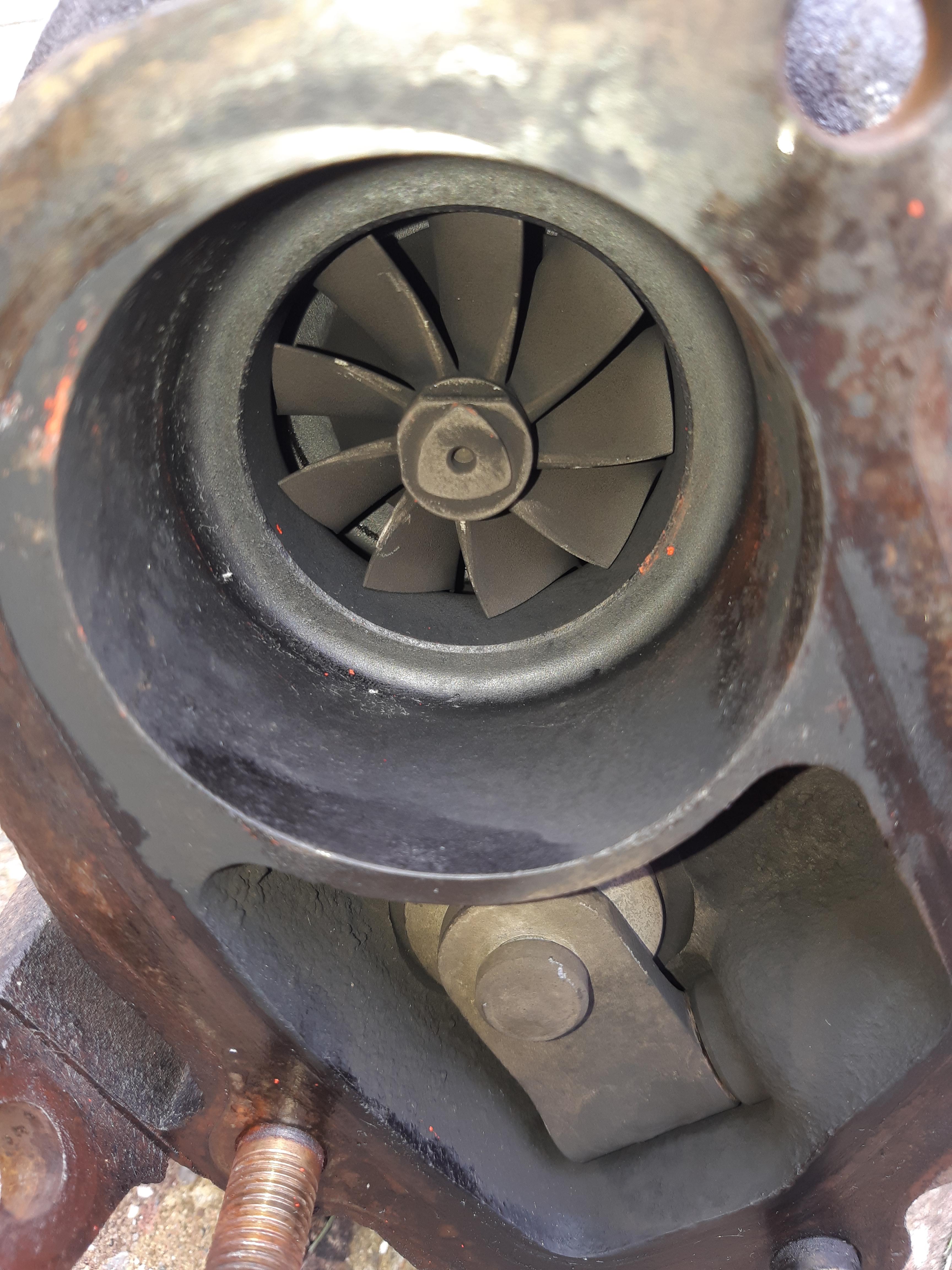

After the last few test drives I was getting a bit of white with a slight hint of blue smoke and feared the worst . That the Rings ,valves ,heads or head gasket were fubar 🥺
But compression was fine ,plugs were clean , no fluid loss or smell coming from the exhaust 🤔
I'd ruled out turbo seals , as there was no smoke on boost and in fact , the only time it did smoke was when pulling away from the lights . Didn't do it at cruise , idle or if the car hadn't been driven . So if it sat stationary I could rev ,idle for as long as i liked and it wouldn't smoke or have erratic afr 🤔🤔.
After resigning myself to letting Clive attowe look at it , cos hes not just a mapper , he does  diagnostic , maintenance, engine builds ect too .
I had some time to think and cast my searching further on the net .... never heard of it before but ..... apparently if the rear turbo seals go ,it can drip oil into the exhaust.  This means the oil is not burnt in the engine combustion, so you don't get blue oil smelling smoke .
You get white smoke with a tinge of blue  that doesn't smell oily ,as the oil evaporates from heat rather than burns 🤞
So .....
Out with the new'ish aps sr40 and in with the spare trusty 25 yr old tdo5.....
No smoke and a stable but slightly rich afr 😊😊😊
 fairly sure the oil "mist" was clouding the exhaust gasses in the down pipe and giving a erratic afr reading,  due to the wideband being positioned after the turbo . Confident that a map fuelling tweek is needed since fitting the better flowing rails and that will sort the afr now .
I'd already booked in a dyno at attowes Monday but wont get the v1sti tweeked yet , I'll wait until the bigger turbos fixed and refitted . So Monday  I'll take the bug sti to attowes for a health check and drop the aps sr40 off to Essex turbos for a rebuild instead .

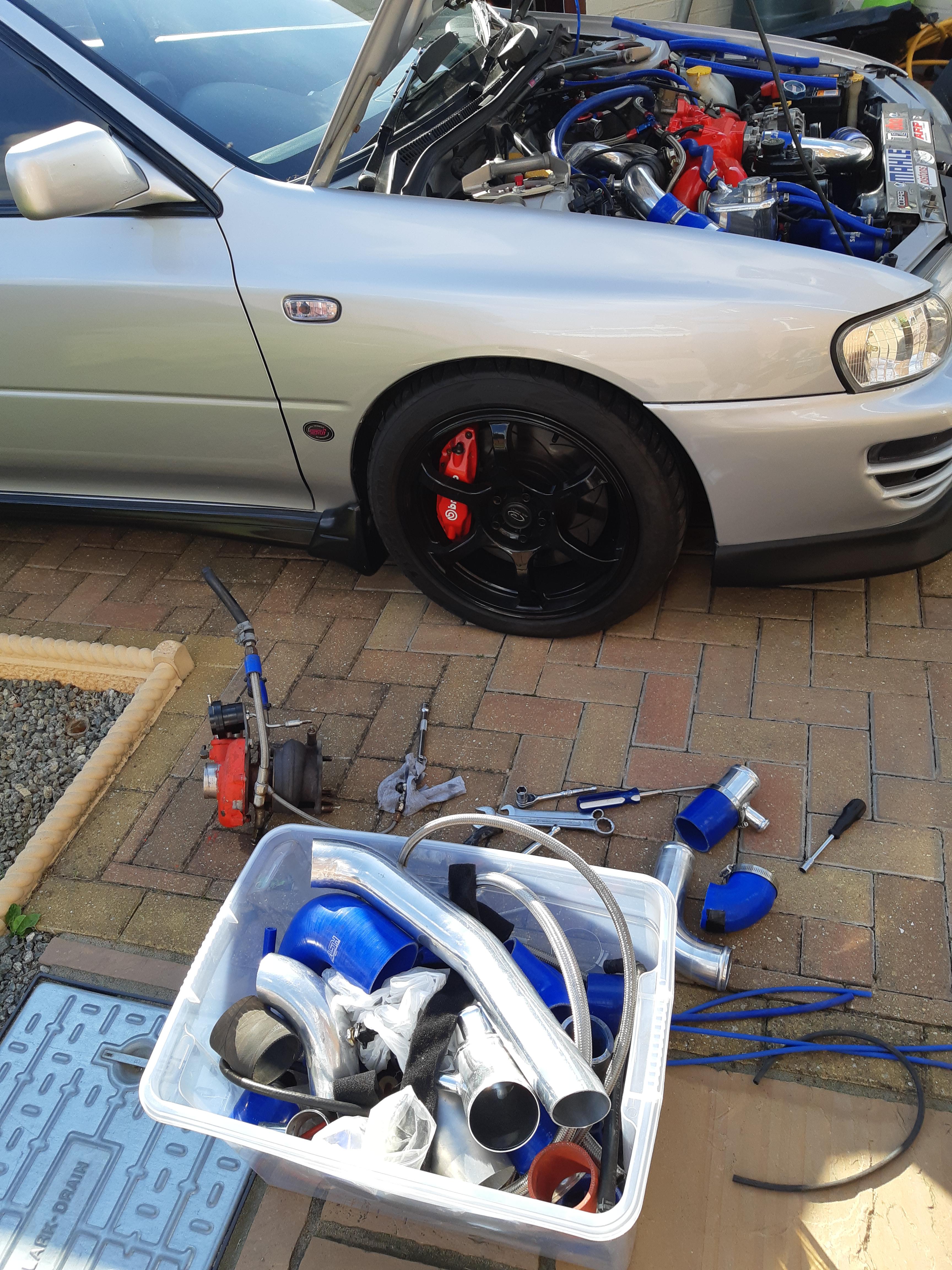

Few pics of the weeping turbo , my box of bits needed to refit a standard turbo and the tdo5 , albeit a bit botched but back in the bay 😋

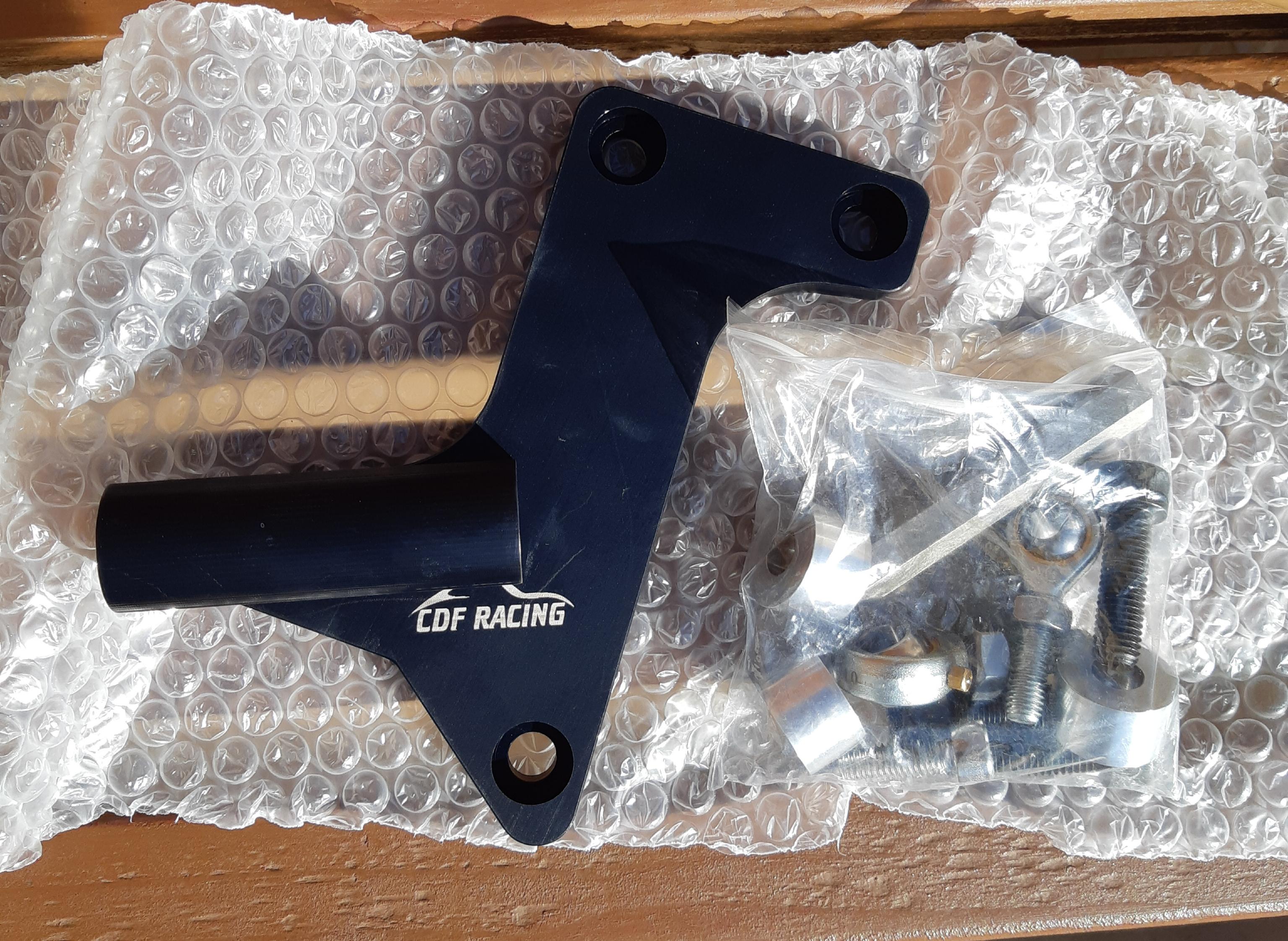

Since parking it up for the winter I seemed to have gained a alternator squeal on start up which lasts about a minute. I've tried , brake cleaner ,electrical contact cleaner and even wd40..... its still squealing 🤬
Trouble is ,that I had to hack my alternator about to get it to work with alternator relocation kit that come with my 2nd hand reversed inlet. Tbh  I don't fancy having to "convert " another alternator to fit again 🙄
 Don't get me wrong its working and has been for the past 4yrs or so but it's tweaking my ocd lol .
Alternator relocation kits used to be over £200 and the 2nd hand inlet kit ,throttle body and icv cost almost half that when I bought it 😋 . I have had my eye on a proppa relocation kit for a while and now they're more sensibly priced ,I decided to get one from Chris at cdf in anodized black to match the rails 😊
Got a few local meets next week and the week after , so doubt I'll find a alternator and clean it up or get the turbo back in time , so for now here's a pic of the kit.
