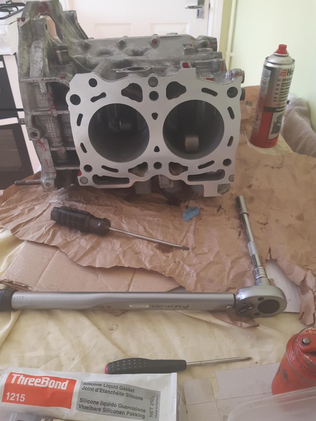

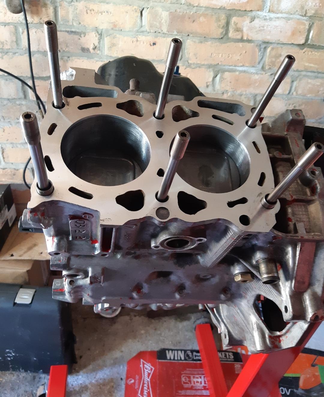

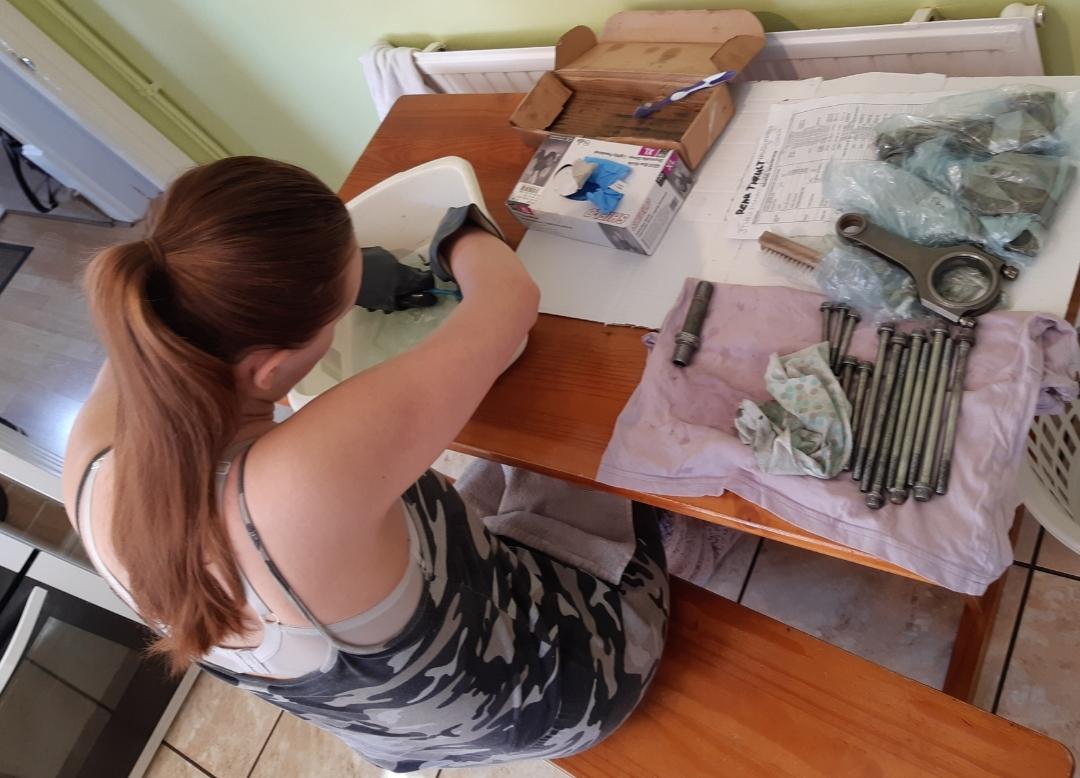

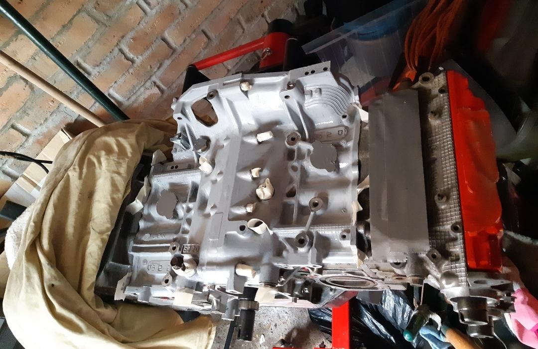

Spent a bit of time cleaning off the old three bond liquid gasket from all the mating surfaces with a Stanley blade, as the engineers hot wash doesn't break it down .Then cleaned up the timing  belt belt tensioner bracket and p.s pump bracket .

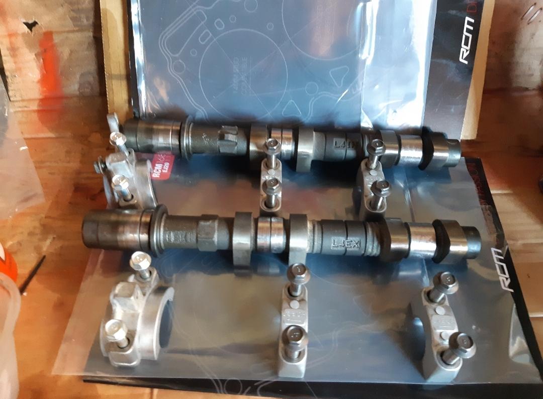

When stripping the v4sti heads down one of the spring seats (washer that stops the spring wearing the ally head casings) was slightly damaged , so I've removed one from the v1sti heads to replace it with once I'm ready to fit the heads .
I've got loads to do but until the new pistons arrive pat wont start work , as they run 3 thou (3 thousand'th of a inch) clearance. subaru have different A and B sized pistons from the factory.  So even though the mahle 2186 stroker pistons are well made , he wants to measure each one and machine the bore to suit .

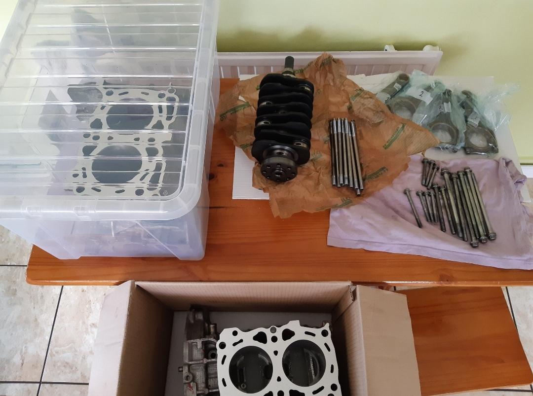

Hopefully by midweek the pistons, 2.5 nitrade crank ,king bearings ,bottom end gasket set ,oils ,filters and fluids should be here 🤞
Then I can drop the cdb ,pistons, crank and bearings off to pat and he can fit in the 93mm overbore, hone and thrust conversion.
Arashi have updated me on the new ball bearing tdo5 20g billet and they're waiting on some bearing cases too assemble it 😏. So it's still not been posted yet but they'll send me the tracking info once it's on it's way 😊.
I'm looking forward to seeing how well a bb 20g on a 2.1 ltr as I was impressed with the journal core version.... well right up to the point it started blowing smoke everywhere 🤐
Once the blocks in Pat's shop , I can then concentrate on cleaning all the threebond and oil off the sump , clean and inspect the oil cooler and teardown check ,clean and reassemble the rcm oil pump . I just hope the engineer can find the time too squeeze me in , so I can make a start on the rebuild soon  😊

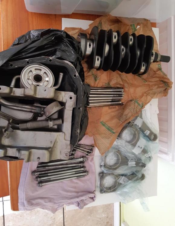

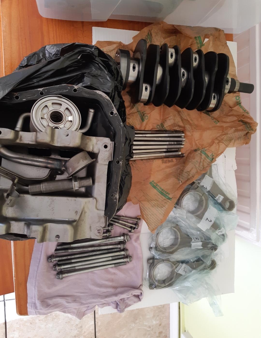

so I'm gonna find the time to drop the pistons, block ,bearings and crank off to Pat segar tomorrow . Then hope he can fit me in soon 🤞
2x millers running in oil .
Premixed coolant
Millers cfcs .
4 jdm black oil filters n sump washers.

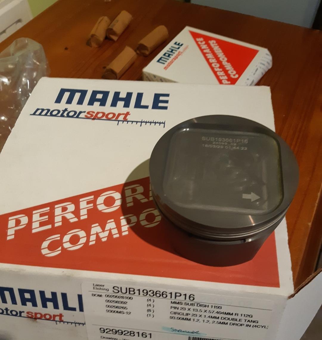

Mahle 2186 stroker pistons.
2.5 sti end thrust crank.
Full set of King race bearings.
New crank sprocket & key .

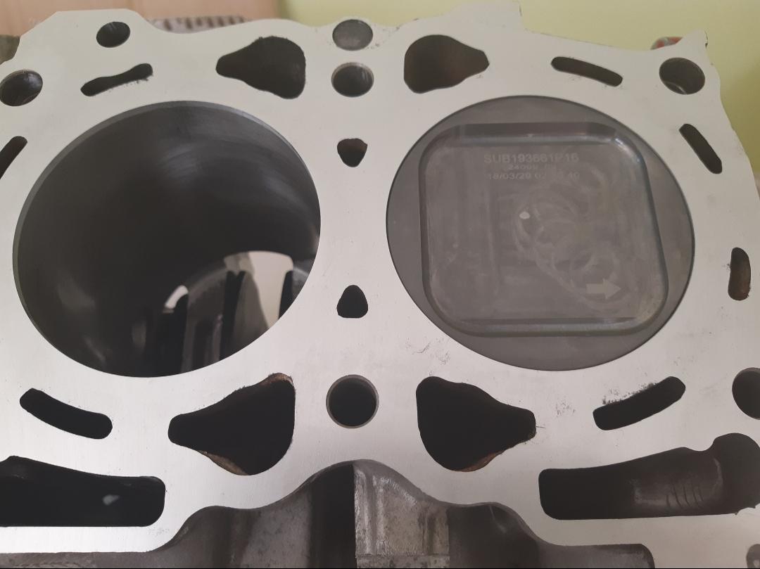

Although the previous mahle pistons had fresh scratches on them , they were recent and nothing to do with the pistons themselves and looking more like debris in the chamber being the cause of the marks.  So I'm still impressed with the quality and it looks like they've widened the bore of the piston ring oil feeds compared to the ones I bought 8 years ago .

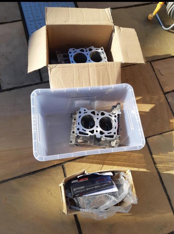

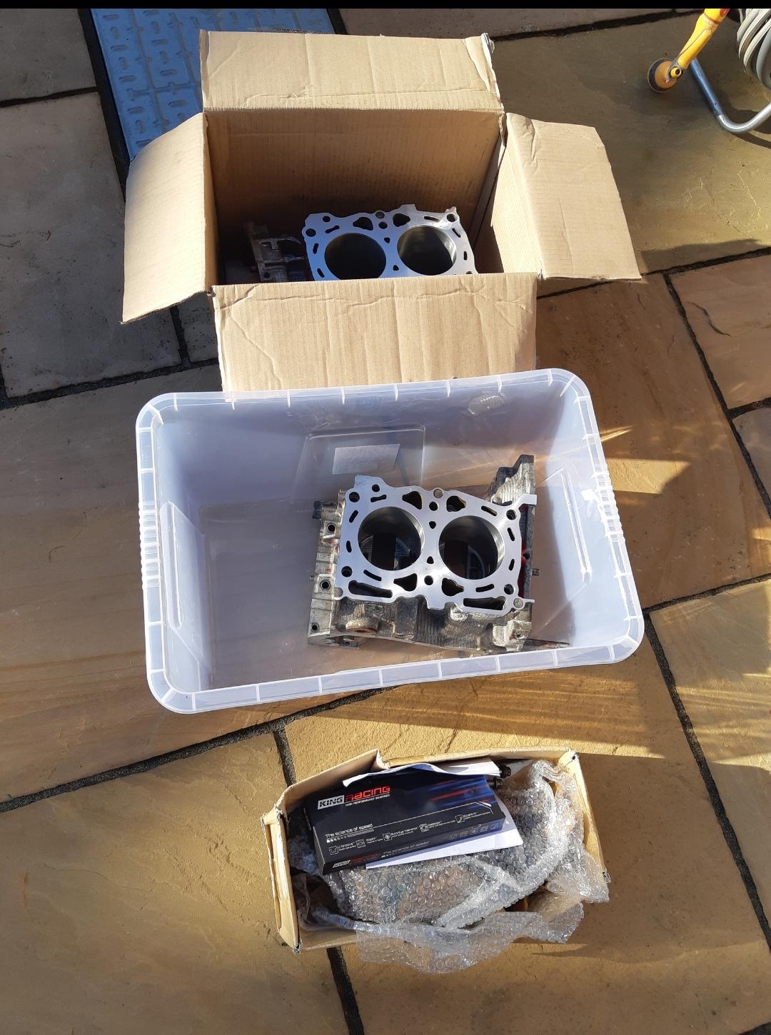

Dropped the cdb , 2.5 crank ,king bearings and pistons off at the engineers.  Hopefully he'll fit me in within a fortnight to complete the thrust conversion and 93mm overbore 🤞

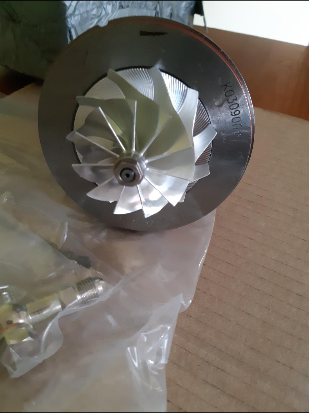

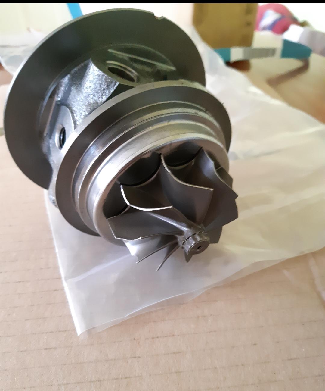

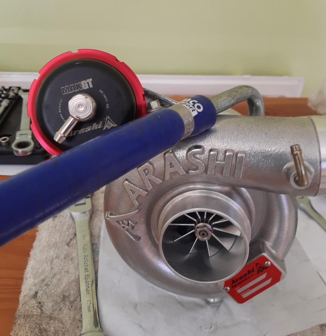

Had another parcel turn up yesterday with the arashi upgraded ball bearing 20g core 😊 seems to spin much more freely than the journal core .
On the journal core 20g they recommend a 11 blade hotside wheel , as this aids spool but looses a bit at top end . The ball bearing core has a 9blade hotside wheel to flow better at top end .

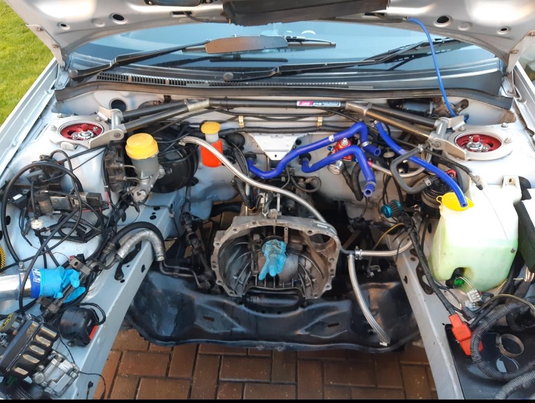

Seeing as the pubs are shut , I spent most of yesterday cleaning the bay with a toothbrush to keep myself occupied 🤪
Not exactly filthy in the first place but it looks good for a 26yr old car .
Still got the 6 speed bellhousing and sub frame to clean , then I'll probably prep and paint the cam covers  .

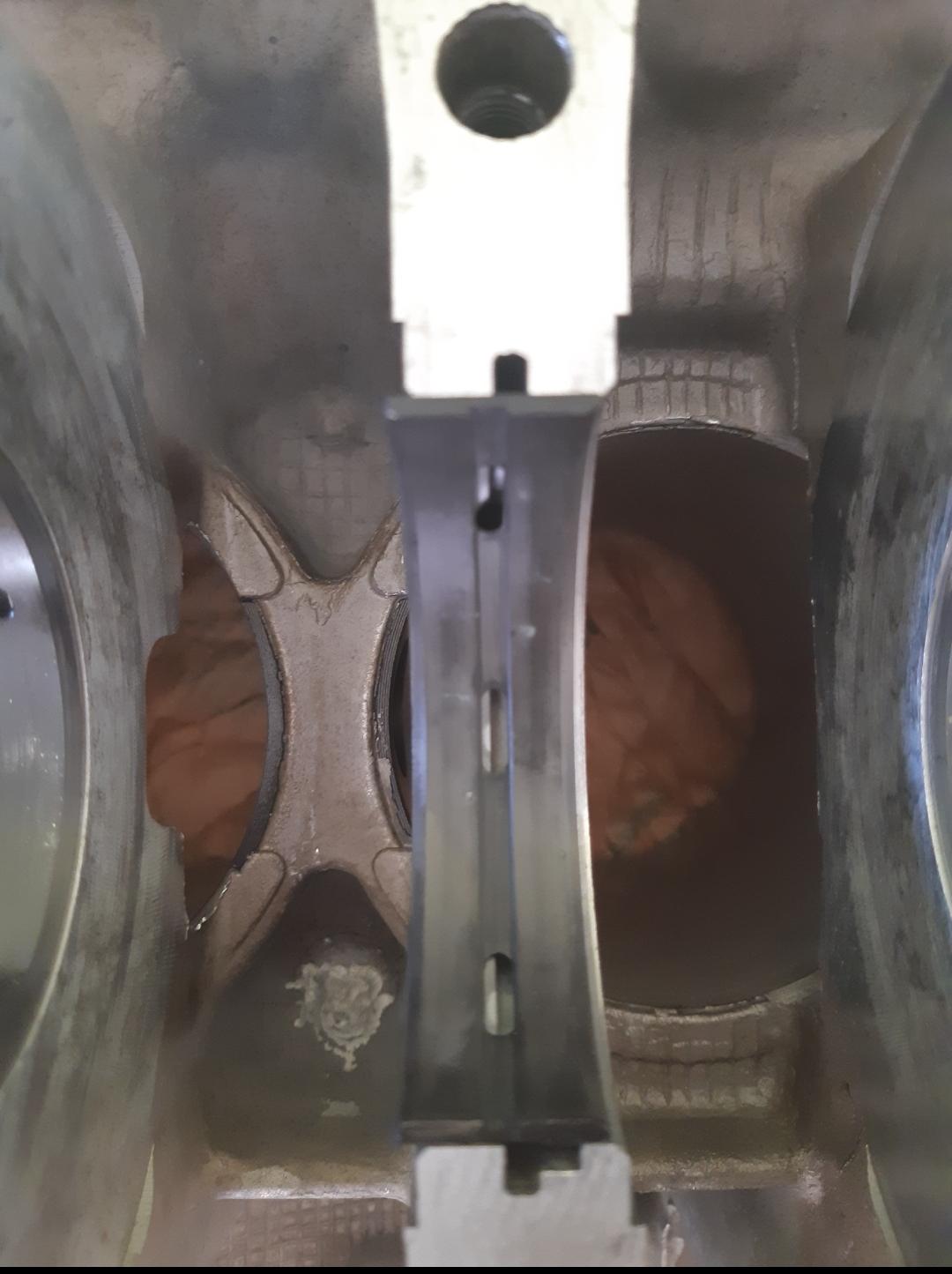

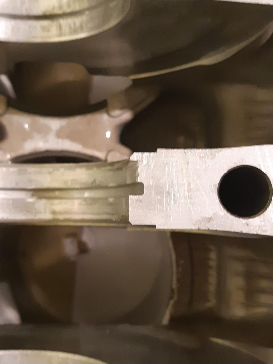

Well today didn't get off to a good start

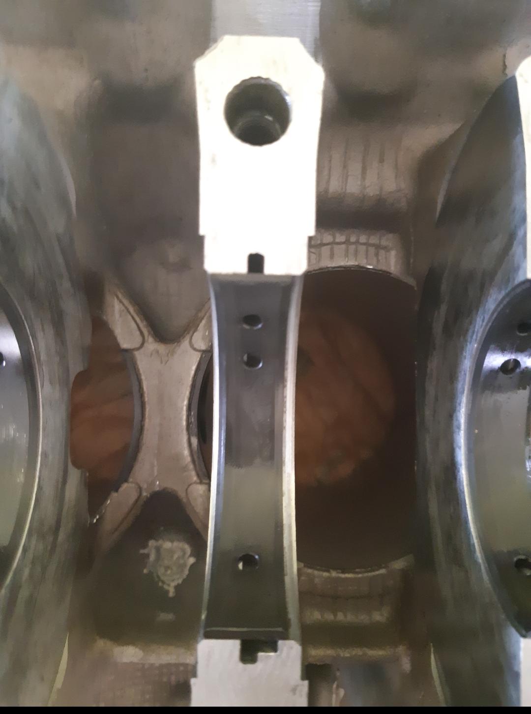

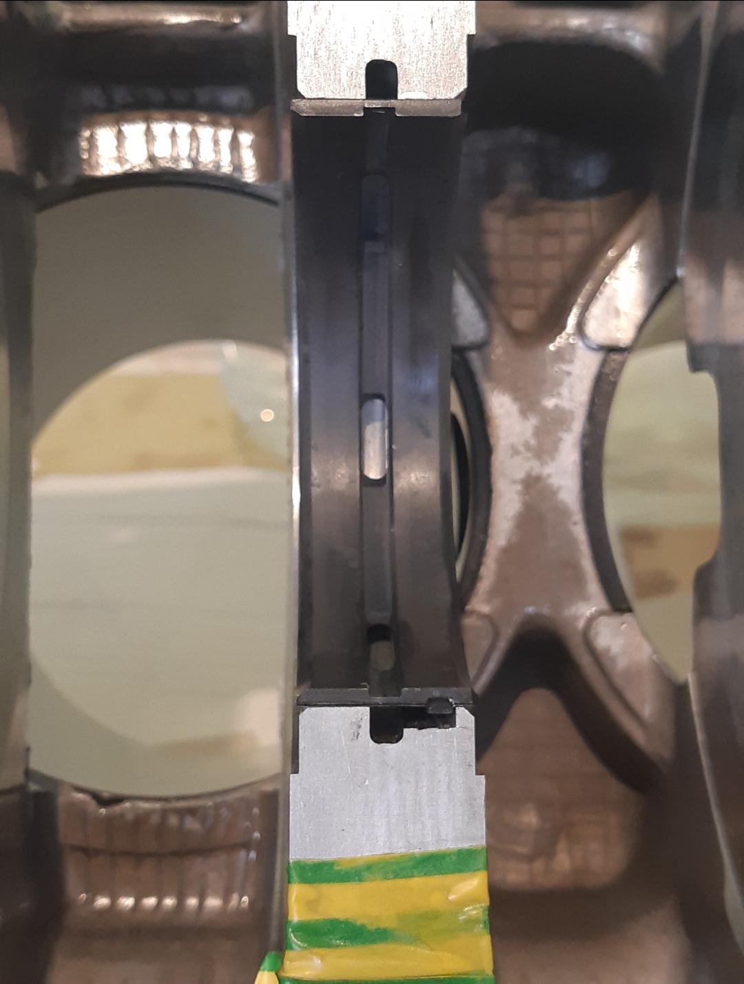

Unfortunately, a bit of miscommunication from me and lack of experience with boxer engines from my engineer, ment the tang hadn't been altered on the center bearing case .
I had asked him to do it and even shown him which bearing type needed to be fitted into number 3 main (old centre thrust position) but that didn't get told to the other machinist  .
This ment he'd used the wrong bearing type in the center main ,when checking everything over after doing the thrust conversion, overbore and hone .
Wrong bearing in centre main looks like it fits fine as the bearing tang holds it central. Screenshot_20200330-232609_Gallery.thumb.jpg.d1098576e618373232801035bee7f430.jpg
But the thrust type 1, 3 ,5 have the tang in a different position and you can see it pushes the bearing off centre
After chatting to him , I decided dust of my old metal working tools to measure up , scribe and file the casings myself to fit the tangs. Luckily enough I still have a few decent needle files ,so took a measurement off no1 main (to the right in the pic) then masked and marked up no3 .
It doesn't look perfect but it's not bad and measures up spot on
Correct bearing location tang now makes the bearing sit central

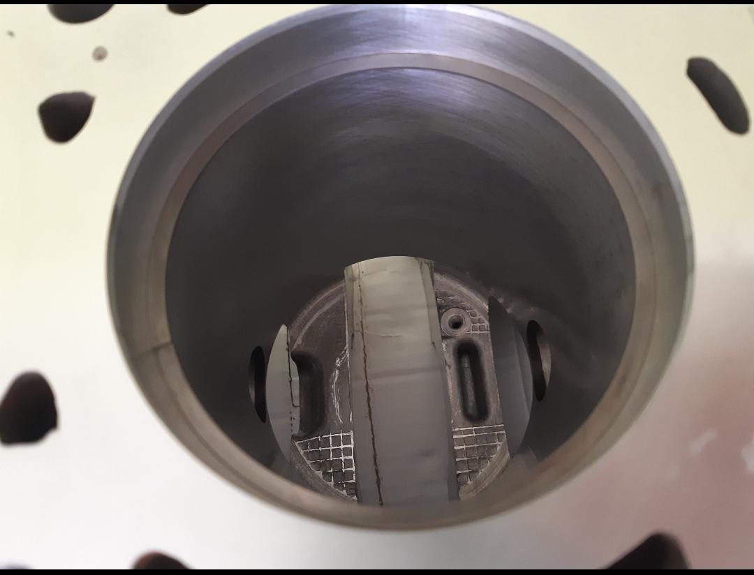

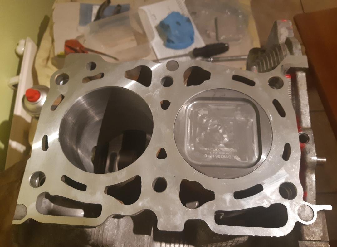

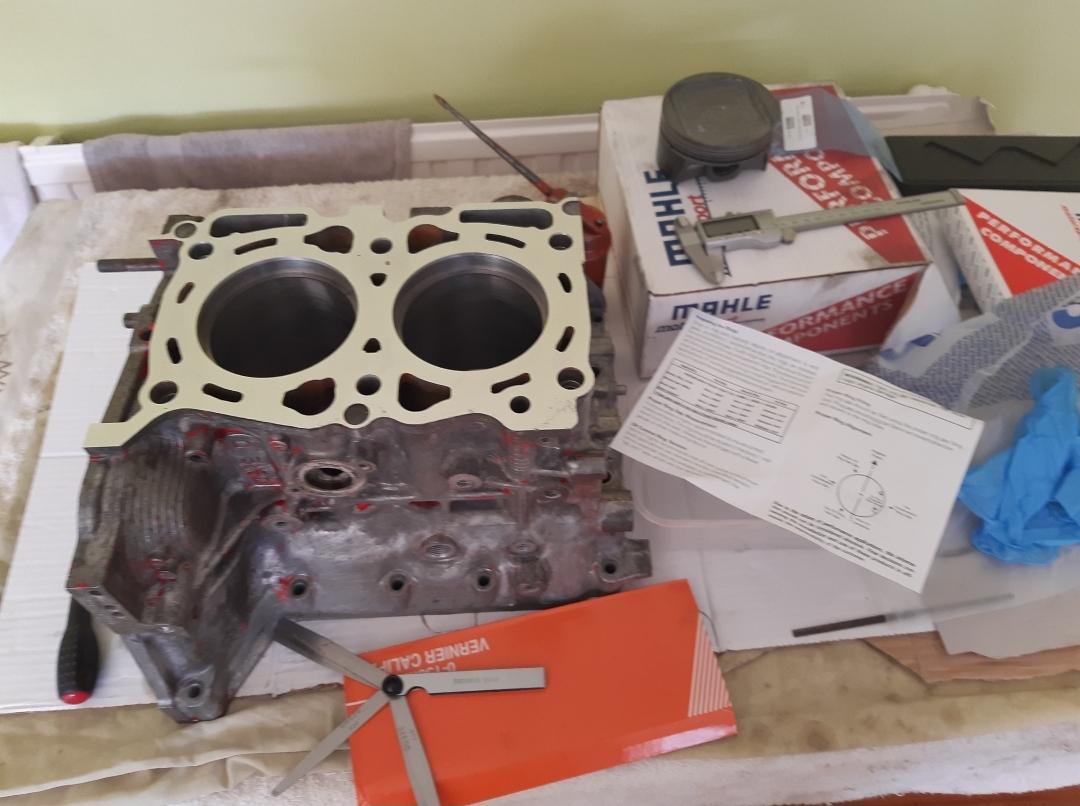

So that ate up a lot of my time  but I did still manage to check for piston skirt to oil squirter delete grub screw contact , plenty of room
A quick glance at deck height  .... not a wack a mole in sight (pistons don't poke out of the deck face ) Screenshot_20200330-232934_Gallery.thumb.jpg.760cb31de1e8d58d5a9e806f244010d0.jpg

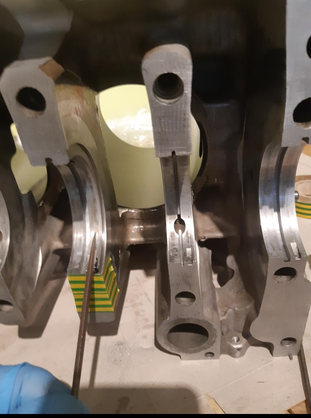

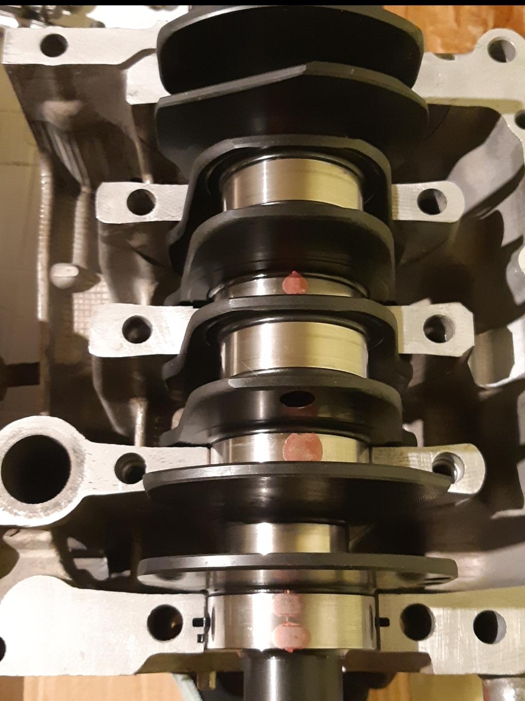

And plastigauge the crank mains , which are all mid to high on standard limit
I'll start tomorrow by gapping the rings and fitting them to each piston , then clean the crank ,bearings and bores before finally starting to assemble the bottom end
Found that I'd left a few of my better files around the farther in laws ,while working on his old skool 60's mini :oops: so progress has been painfully slow setting the ring gaps
For those who don't know , you do this by pushing the rings down squarely in the bore with a piston crown and measuring the gap with feelers gauges.
Then widen the gap , refit in the bore and measure again ... normally and again and again in my case :blush: as I always worry that I'll take too much off and make the gap too big .
I also remembered I no longer own a piston ring compressor :oops: so had borrowed one of a mate for the last 2 builds , unfortunately he has no spleen and is on the high risk list for the virus :eek:
So I won't be popping round to see him anytime soon . The one I ordered off ebay this morning was dispatched this afternoon , so hopefully it will get here soon .

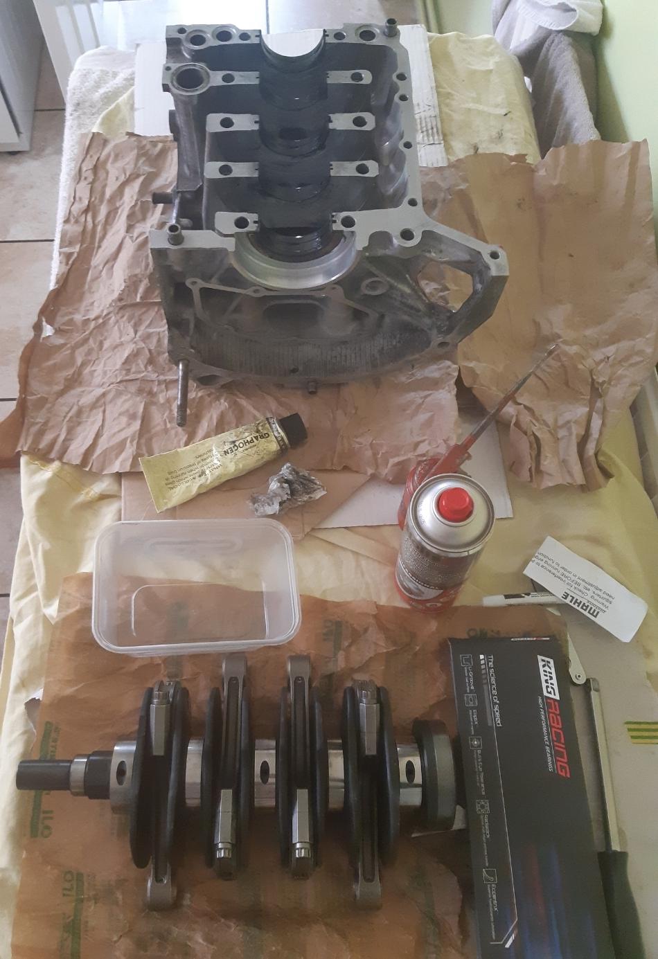

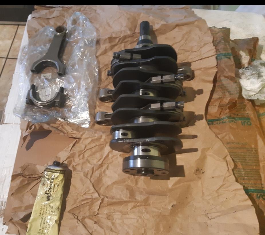

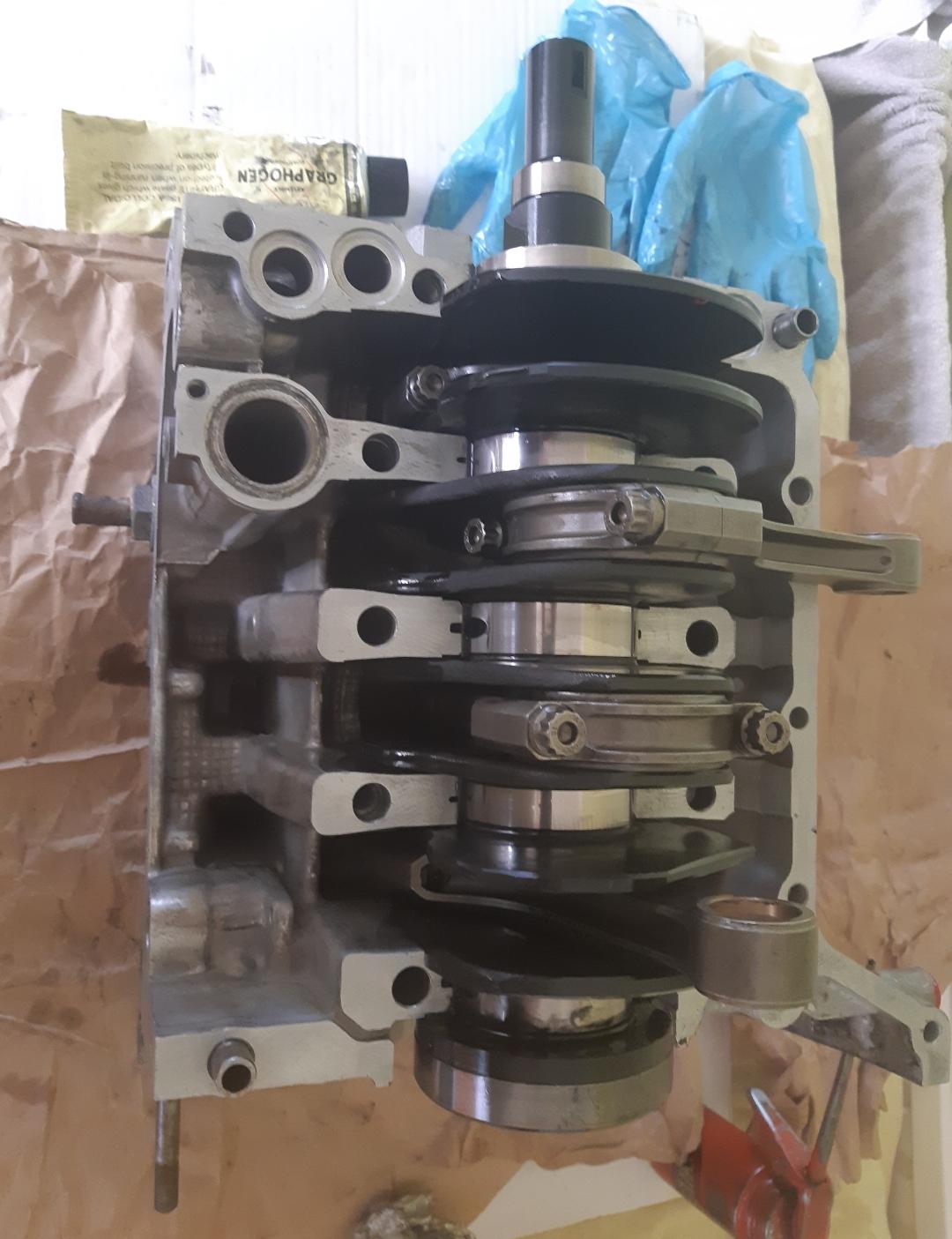

cleaned plastiguage off the crank and coated the king bearings in graphgen builders paste , then fitted those to the rods and end caps .
coated the arp end cap bolts and torqued them down onto the crank
Cleaned the bores in one bank and that's sat in a sealed box but will wait until the piston ring compressor is here before before fitting the crank into the block halves . As I don't want the case assembly left open (no pistons in the bores ) for too long ,even in doors and in the dry 😉
Ring compressor turned up 😎 so I cleaned up the bores and mating surfaces of the other block half and fitted the king main bearings in both casings. Screenshot_20200404-173255_Gallery.thumb.jpg.1f75c8e94b1588e67dcaa21ffe7fe3fd.jpg

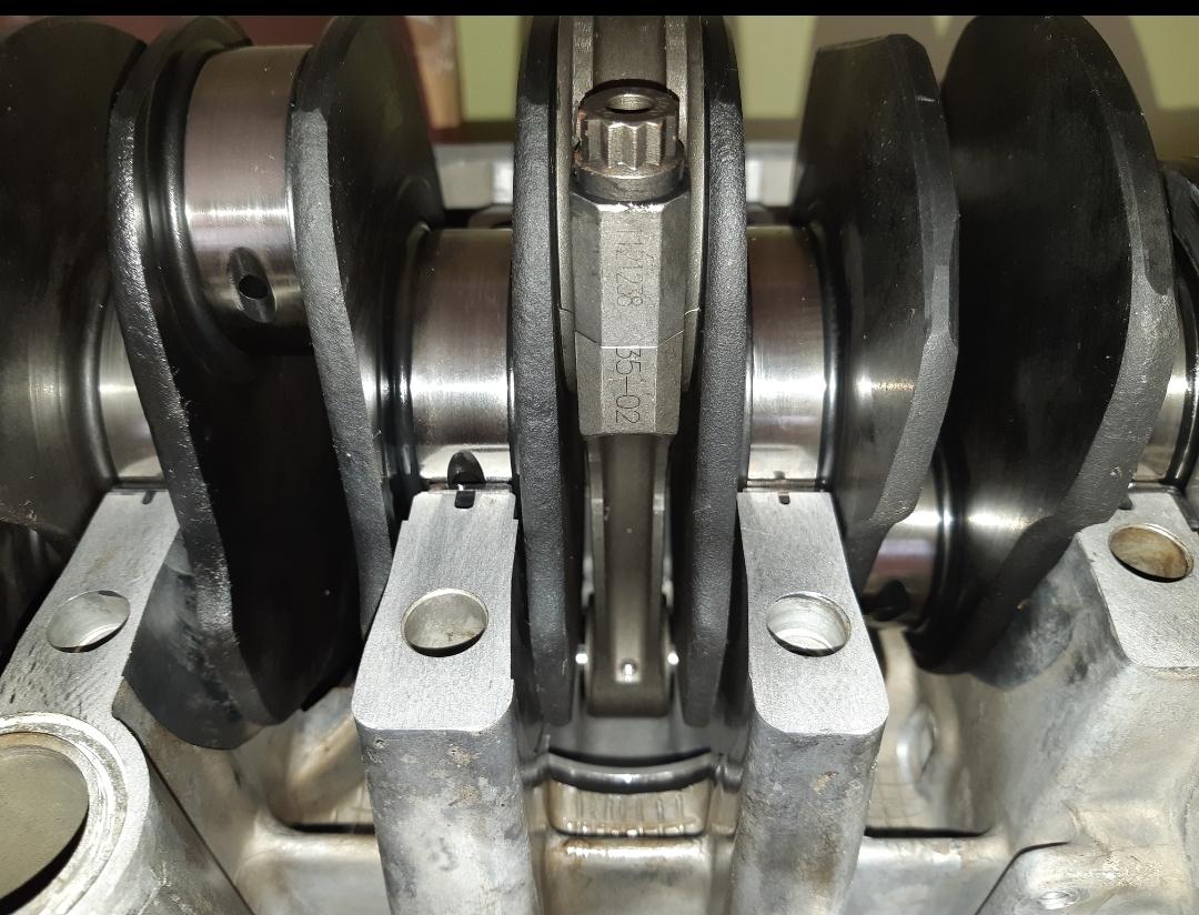

Coated the bearings with graphgeon paste and lowered the crank in position. Screenshot_20200404-173318_Gallery.thumb.jpg.4ccf1f5a79550fbbd1c703595c80cc79.jpg

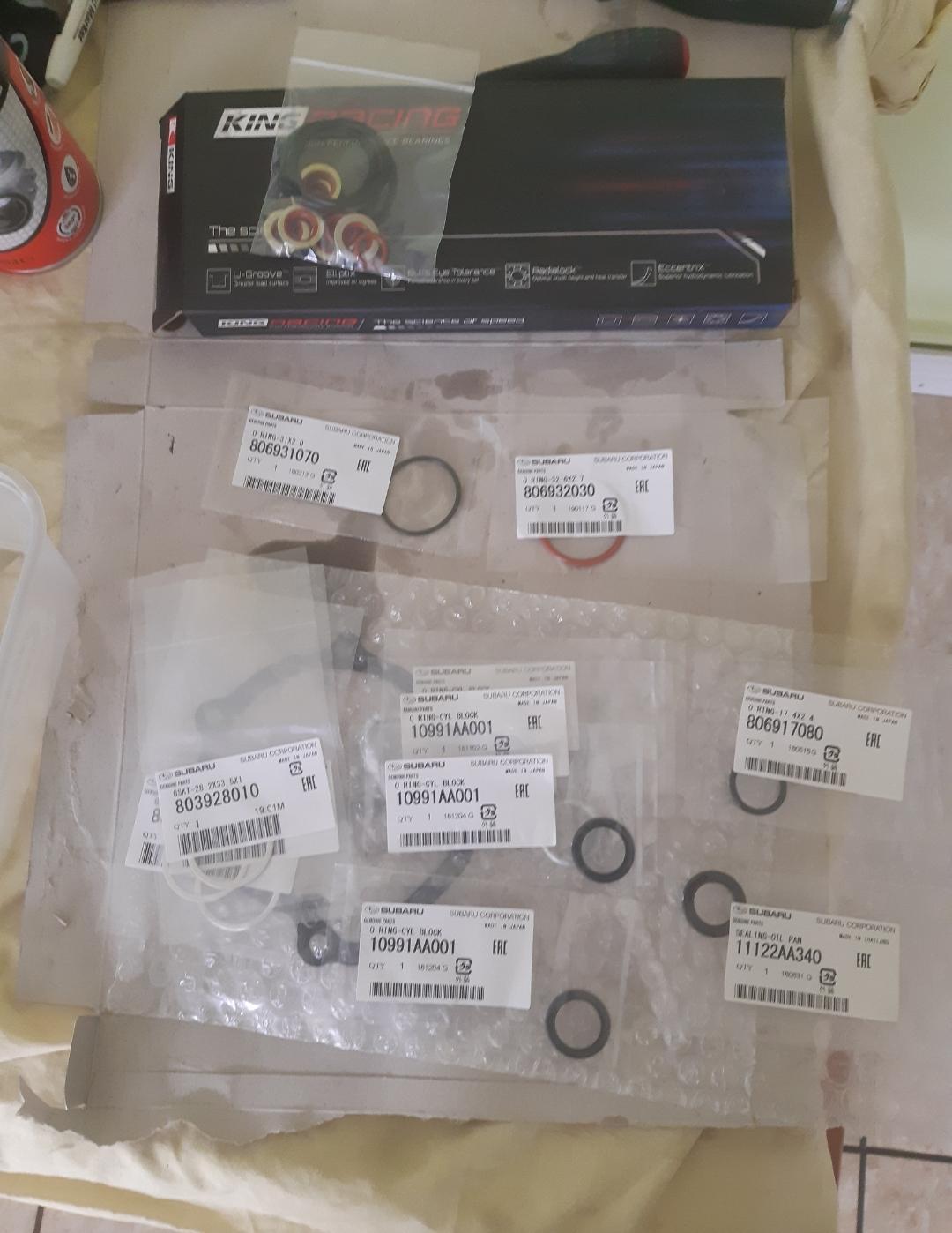

Sorted through the big box of gaskets and found the new block o rings and put threebond on the mating  surfaces case halves Screenshot_20200404-173338_Gallery.thumb.jpg.a94f555af10e7a68895c4c6de9559128.jpg
Soaked the threads of the block bolts in oil and torqued the half's together Screenshot_20200404-173353_Gallery.thumb.jpg.d655b0e517b9084608743abe9791adf6.jpg

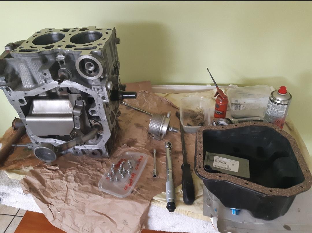

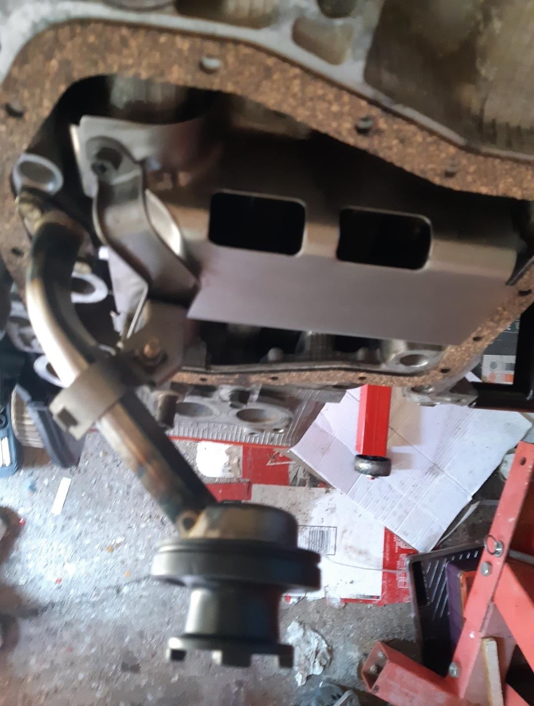

Fitted the splash guard , oil pick and loosely bolted on the sump
Still got a fair bit to do but the short block is almost complete,  so I finally feel like I'm getting somewhere 😎
I'm certainly glad I got most of parts I needed before lockdown,  I've certainly had plenty of time on my hands lately so have been putting it to good use 😉

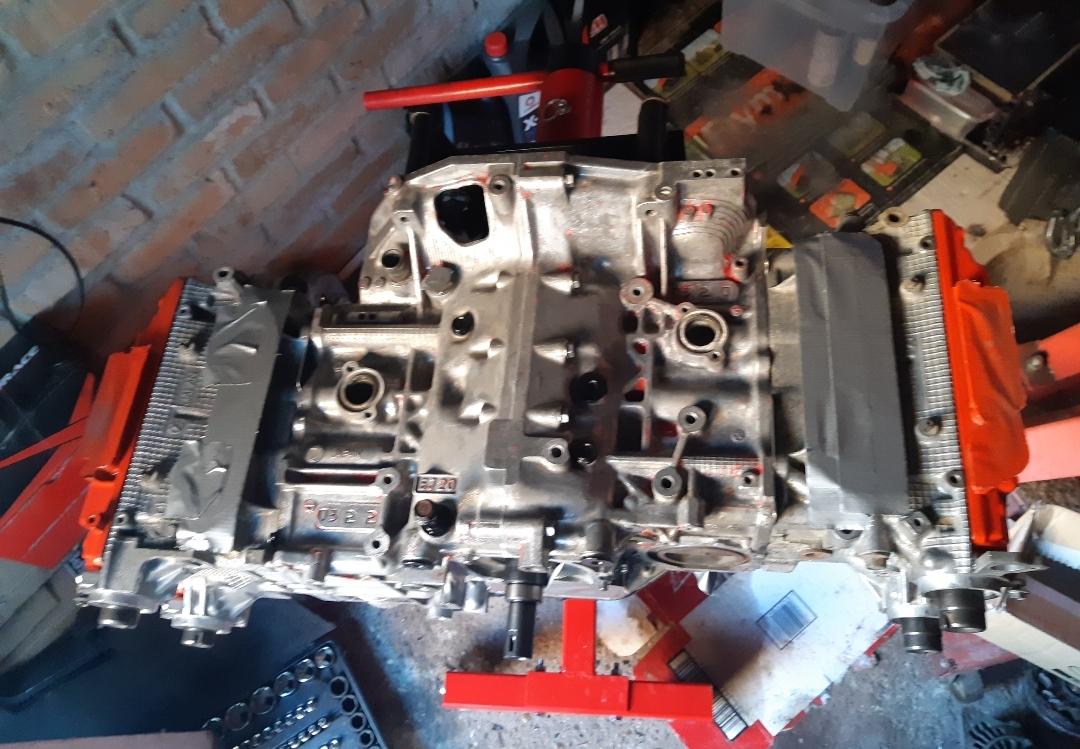

Cleaned up the shed (again),carried the short block in and fitted it onto the stand ,then lubed the arp headstuds and cleaned the oil off the deck face.

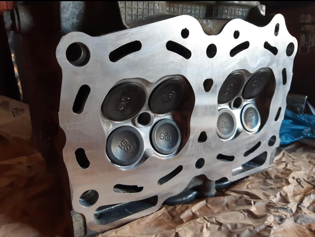

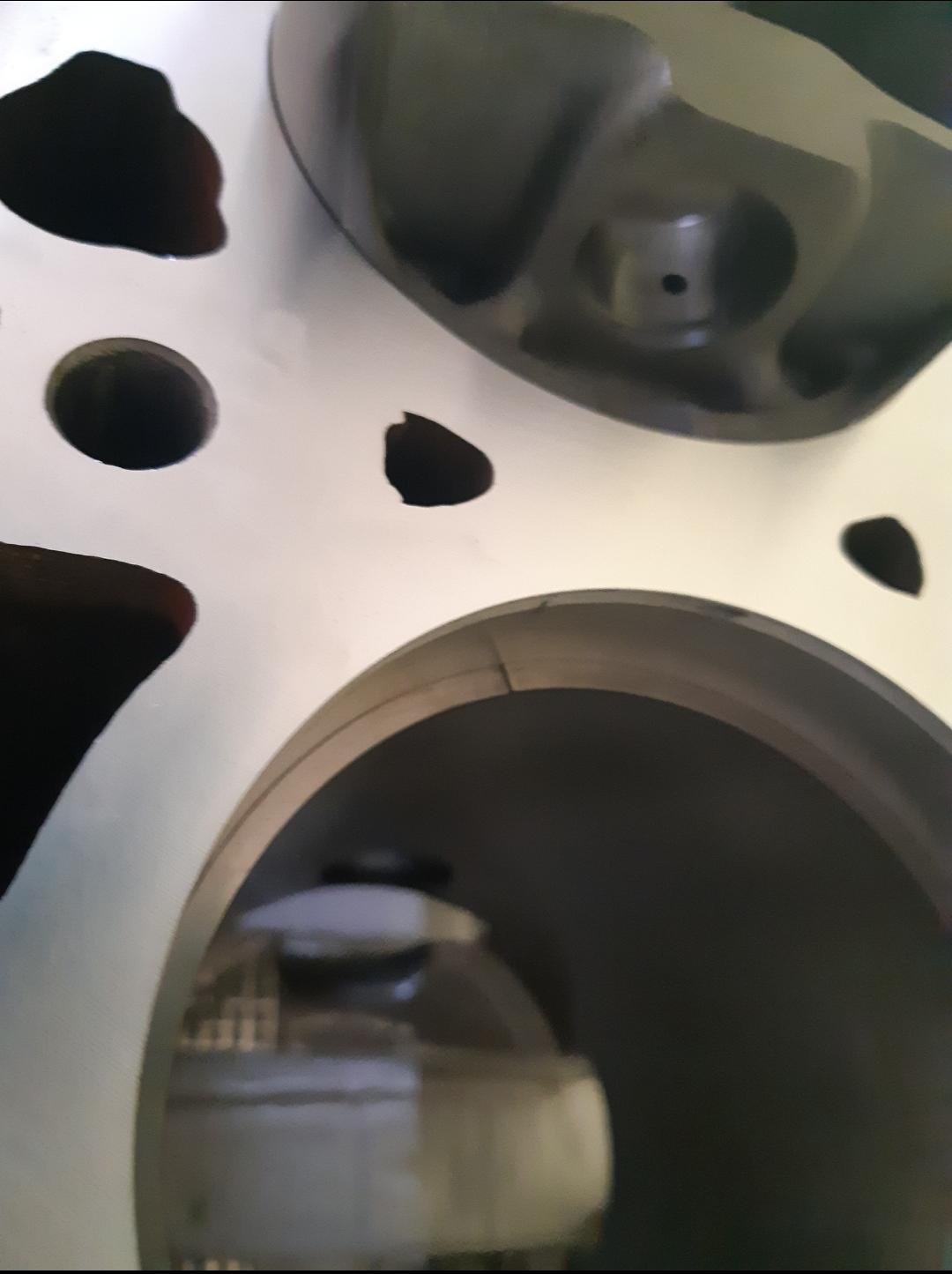

 Got one of the v4sti heads out of the boxes, removed the cams and cleaned the mating surfaces on those too

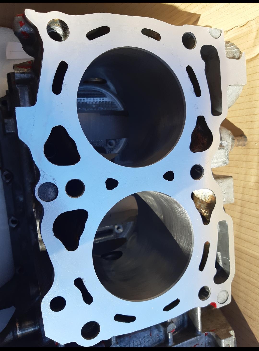

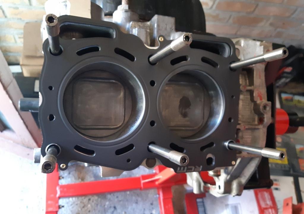

Seeing as I'll hopefully not be seeing the rcm headgaskets again , I took a pic of those fitted too 🤞Screenshot_20200405-190815_Gallery.thumb.jpg.38ed7ee7f89656a71abc7cb658d323a7.jpg

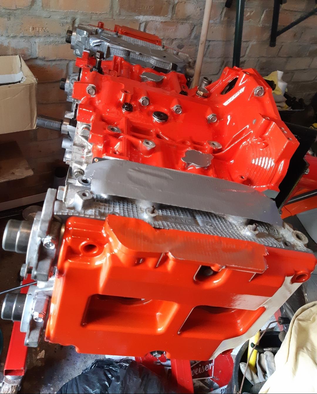

Lubed the apr headstud washers and nuts ,torqued the heads down ,temporarily fitted both cam covers and masked up all openings and access bungs

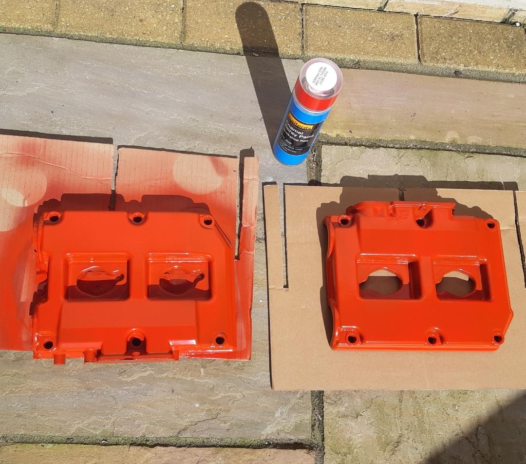

Couple of Coats of ally etch primer .Screenshot_20200406-201104_Gallery.thumb.jpg.3aae05701f7ade253c6c6f0c4e2ecf1f.jpg
 hi temp engine paint dried off with a heat gun in between coats , cos I got fed up with watching paint dry lol .
Double checked the arp headstud torque after letting them settle overnight , then lubed the cams ,fitted the new cam seals and cam cover gaskets .

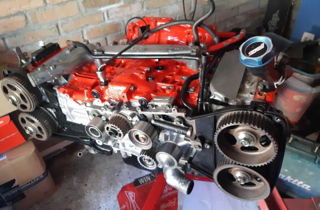

With the extender ,gasket ,sump and oil modine fitted , I made a start on fitting the timing gear and water pump .Screenshot_20200409-193102_Gallery.thumb.jpg.022d413760c034593f6ec200d0e8c92d.jpg
After torque'ing these down I could finally fit the kevlar belt and timing belt cover 😎

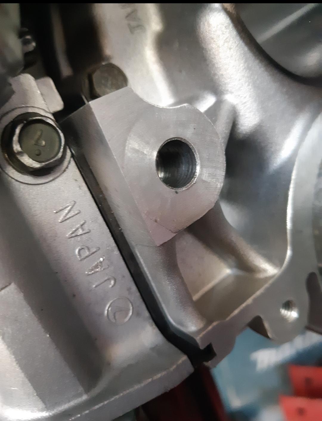

But there was a new bolt in the timing belt kit and it didn't look very good quality (no stamp or markings)  so I cleaned and  used all the original bolts .
Unfortunately this new bolt is about 20mm longer than the original toothed idler pulley bolt , so when tightened the original bolt it kindly pulled the thread outta the water pump 🤐😏Screenshot_20200409-193410_Gallery.thumb.jpg.8c7ec67fbfa27e690bdb8e0faa3cbbf7.jpg
Luckily enough pat Seager is still open and he collected the water pump today, will helicoil the thread and drop it off at some point . So it's no big deal , will be stronger than it was in the first place and will only cost me a couple of days and £20 (and a bit of shame lol)
But I thought I'd post my mistake on here just in case someone else buys the same kit so ...  .....
IF YOUR TIMING BELT &WATER PUMP KIT HAS A EXTRA BOLT IN IT FIT IT TO THE TOOTHED IDLER PULLEY 😊

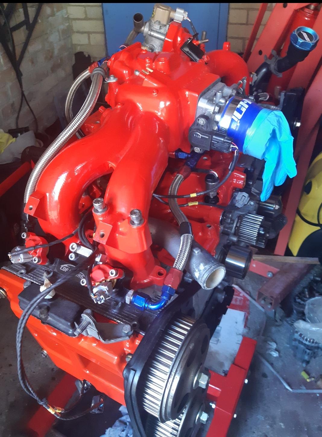

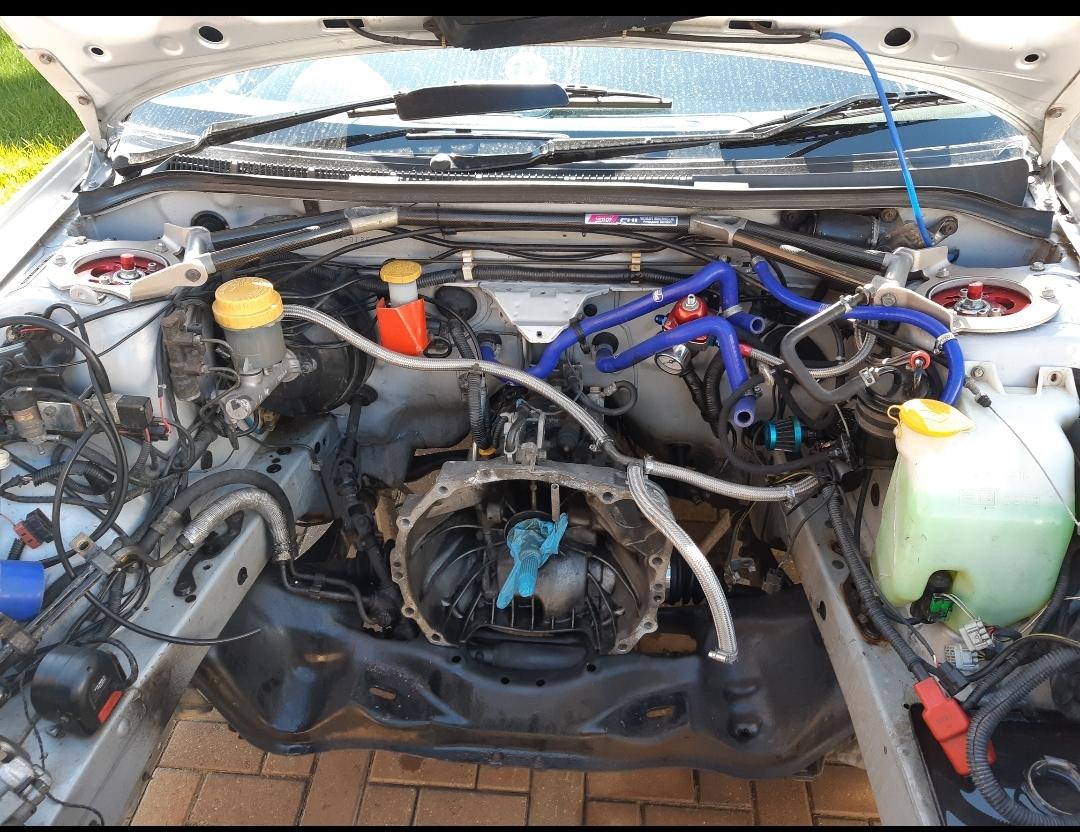

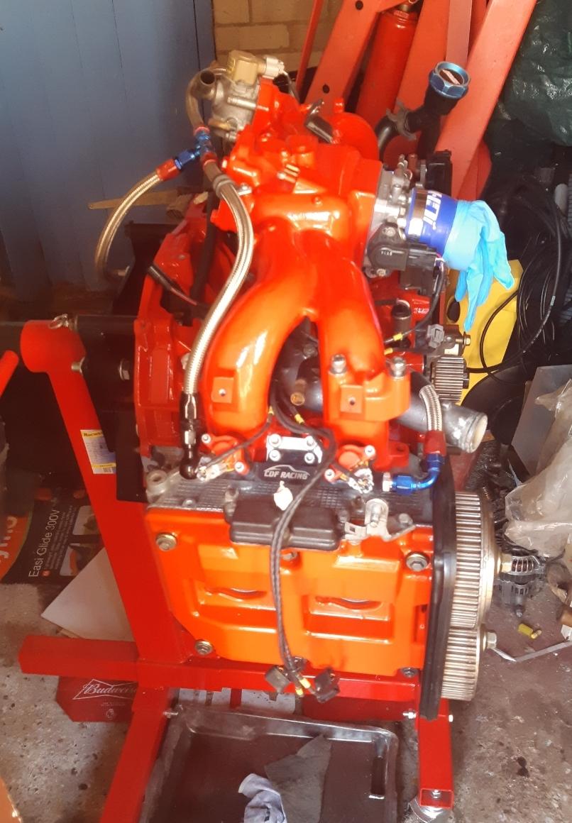

So I pulled the inlet manifold outta the box in the boot and sat it ontop of the engine,  to get a idea of the finished block .
Screenshot_20200408-151235_Gallery.thumb.jpg.b51e8d5cacc8d4dff622d0b44e98ab83.jpgScreenshot_20200408-151213_Gallery.thumb.jpg.427b7b97a2fe180f178c2a59cc2ab1bc.jpg
Yep looks pretty much the same as when I removed it 😂 apart from being cleaner and having rcm wrote on the headgaskets instead of cossie lol .
Still got the turbo core to swap into the housings and exhaust to clean up , so hopefully enough to keep me busy till Pat's dropped the pump off 🤞

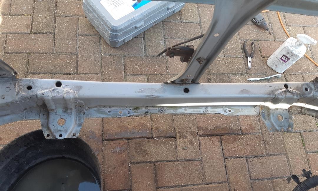

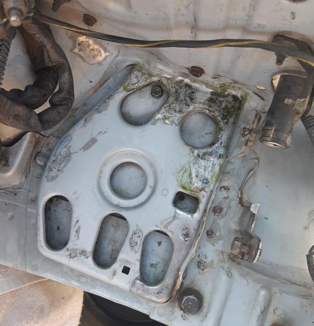

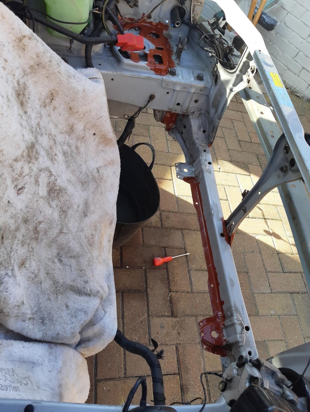

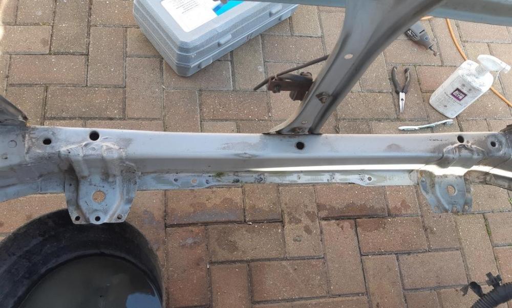

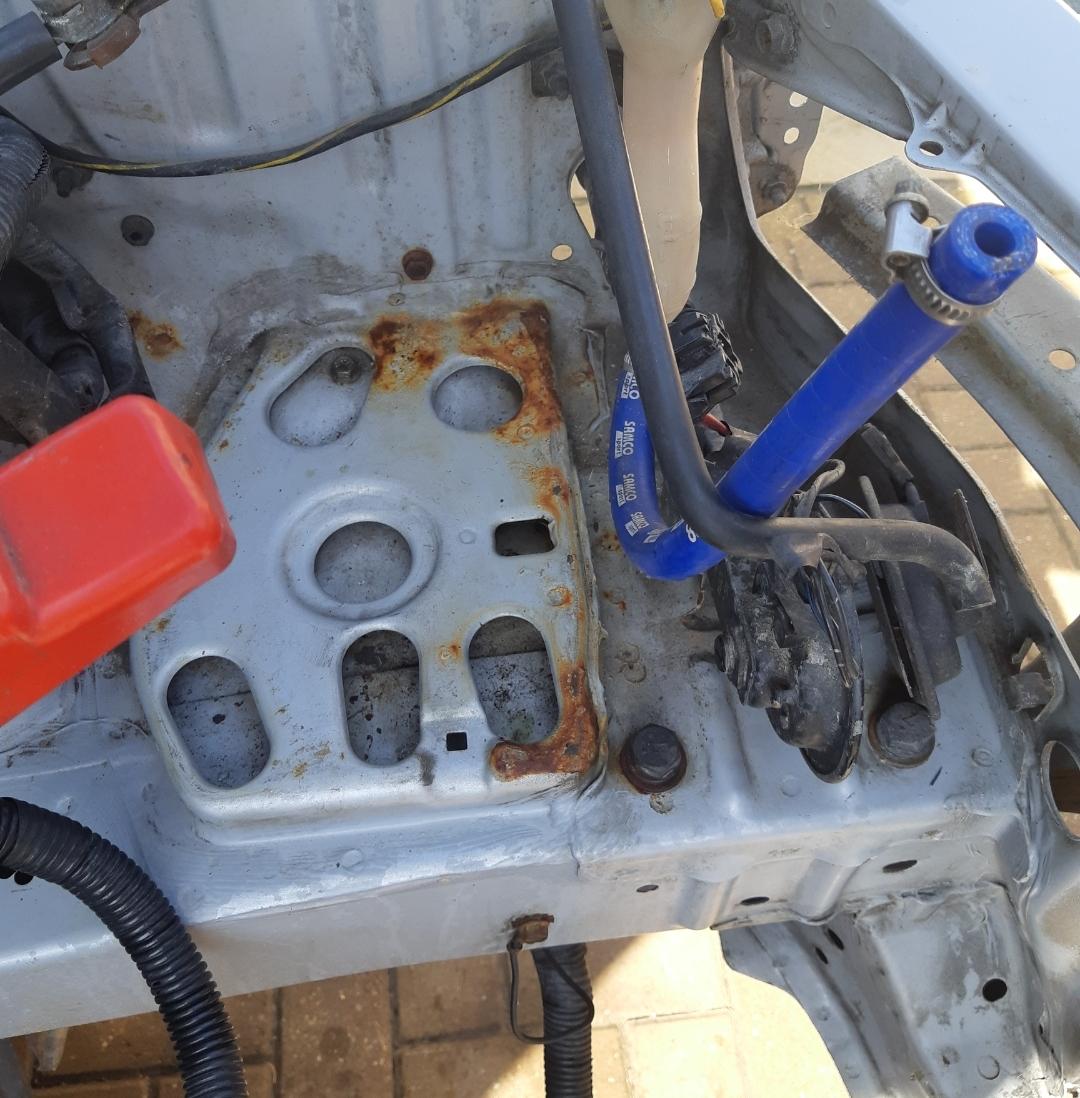

Found a spot of rust hiding under the battery tray 😲 it's only surface stuff and looks worse in the pic tbh .

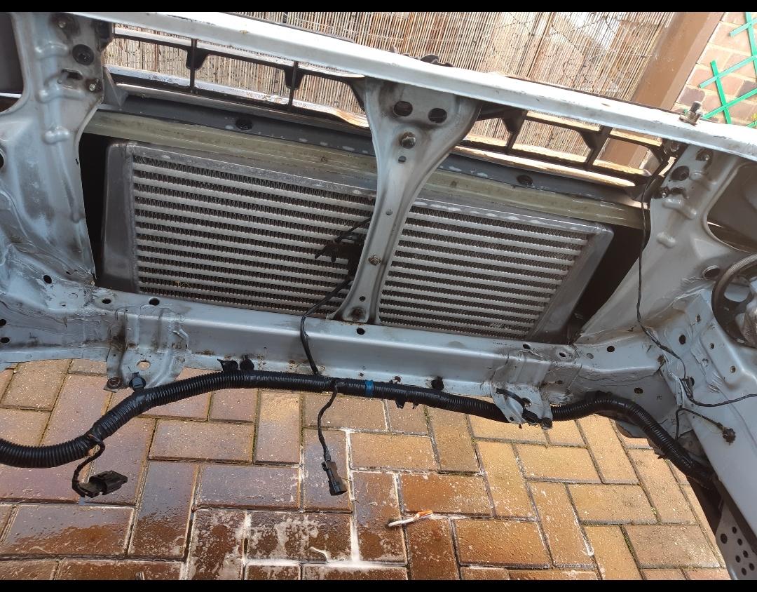

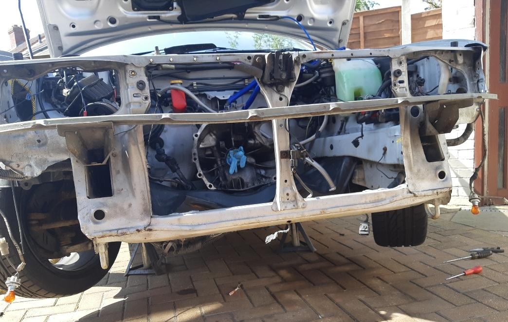

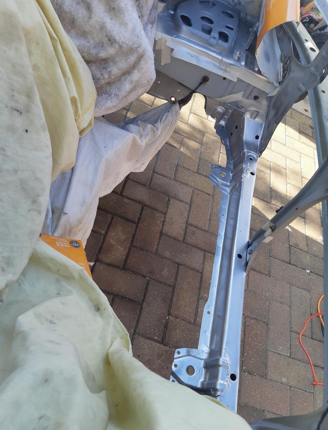

So needing something to do and making the most of the dry weather.... front end off and it still looks clean for a 26 yr old car 😎
Everything wire brushed back to clean metal and rust treated
Coat of old skool red oxide isn't drying quick enough, even with a heat gun in the sun 😏
Bay masked off ,Zinc heavy primer and a sliver topcoat to seal it .
battery tray area is still a bit wet but once dry will get a coat of silver too .
Still got clutch ,bellhousing and exhaust system to de oil from the turbo seals going 😏

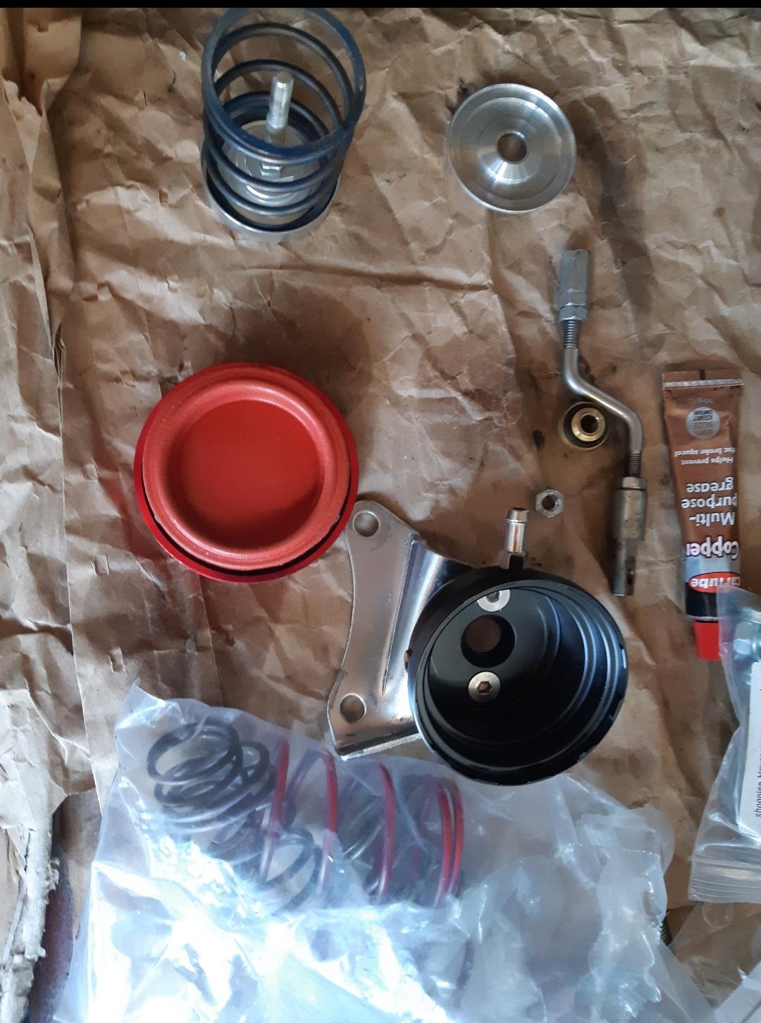

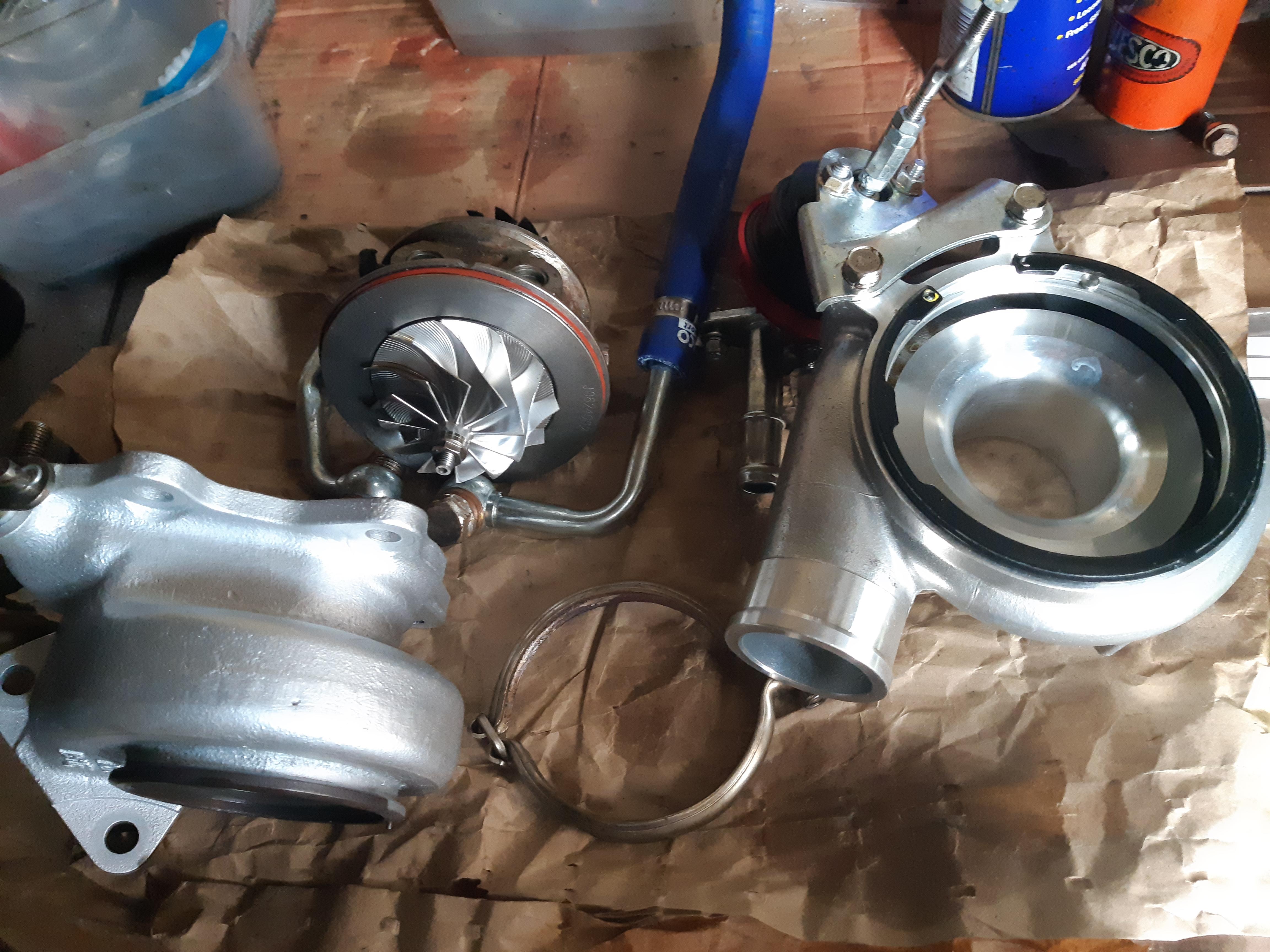

Also got to fit the new uprated ball bearing 20g core to the housings once they're clean too , so hopefully enough to keep me busy still 😊Screenshot_20200411-162949_Gallery.thumb.jpg.8aba06c78977a7812650b964e7f0ff22.jpg
Well I've had a busy fortnight but have done everything I can do ,till I get the helicoiled water pump and exhaust manifold studs /nuts turn up .

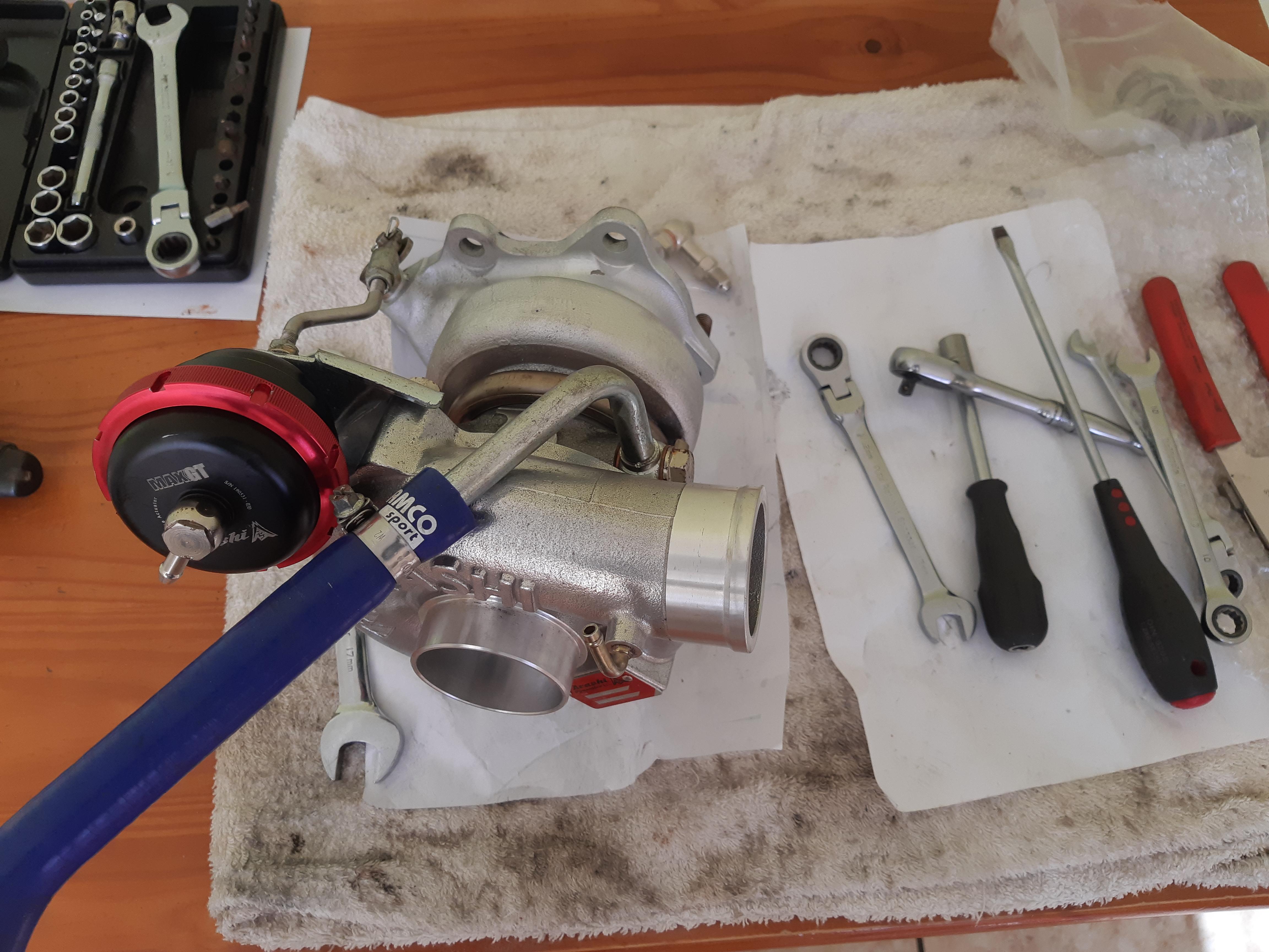

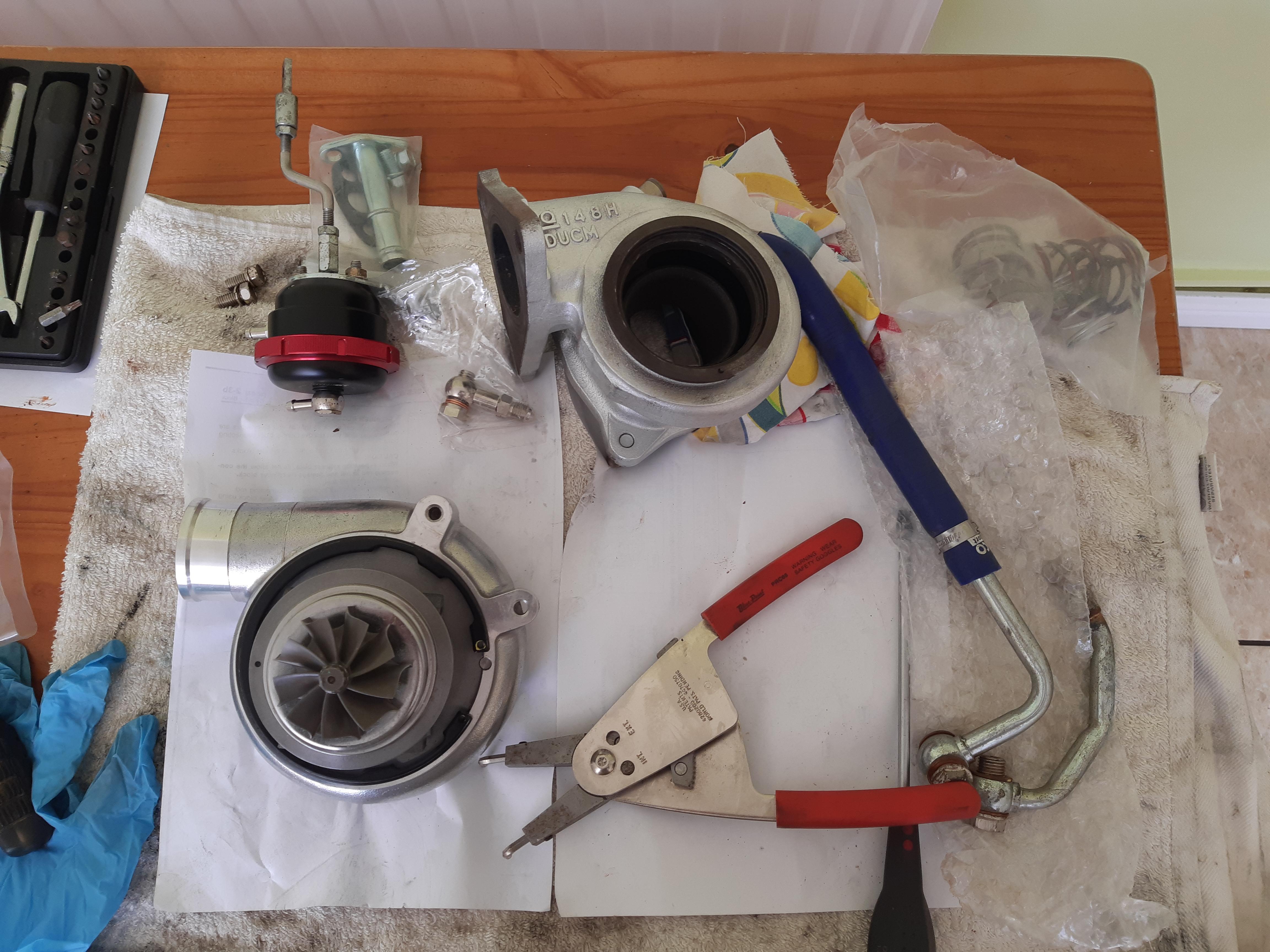

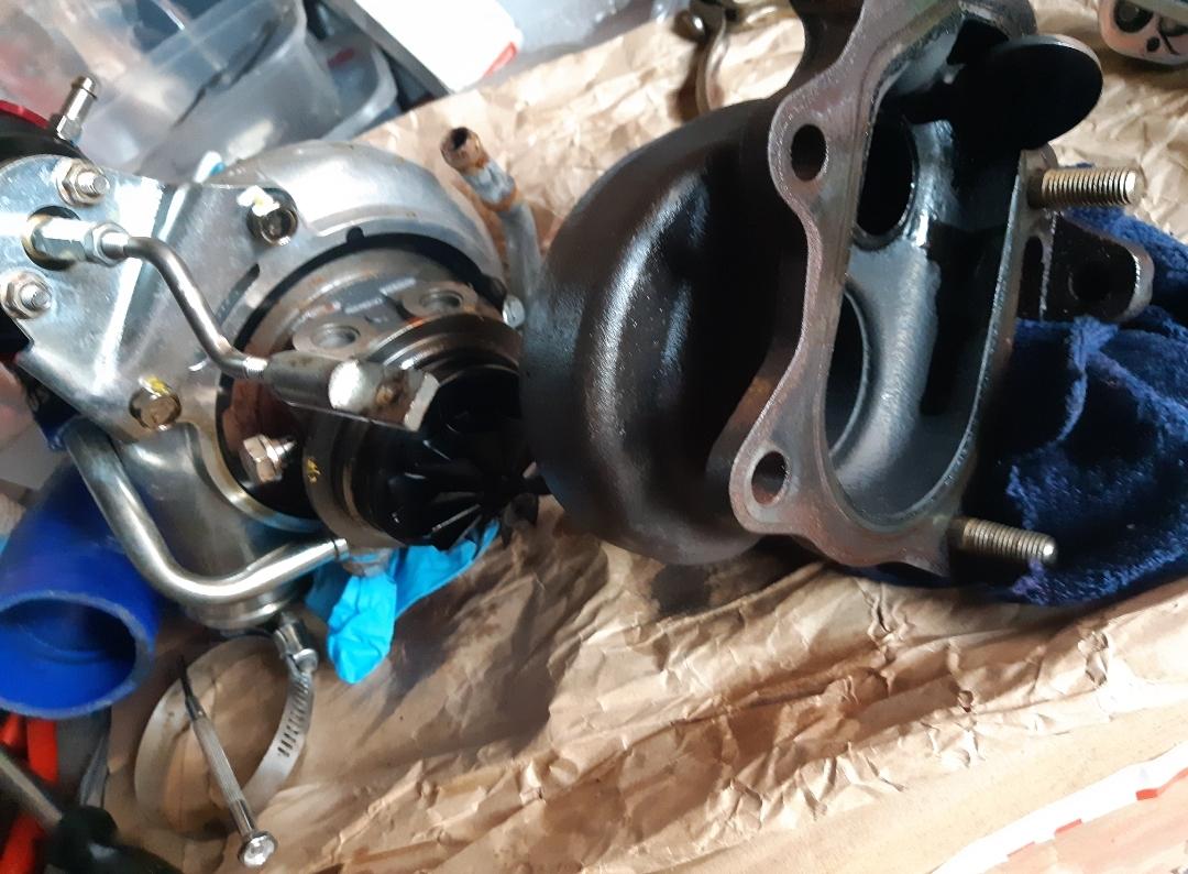

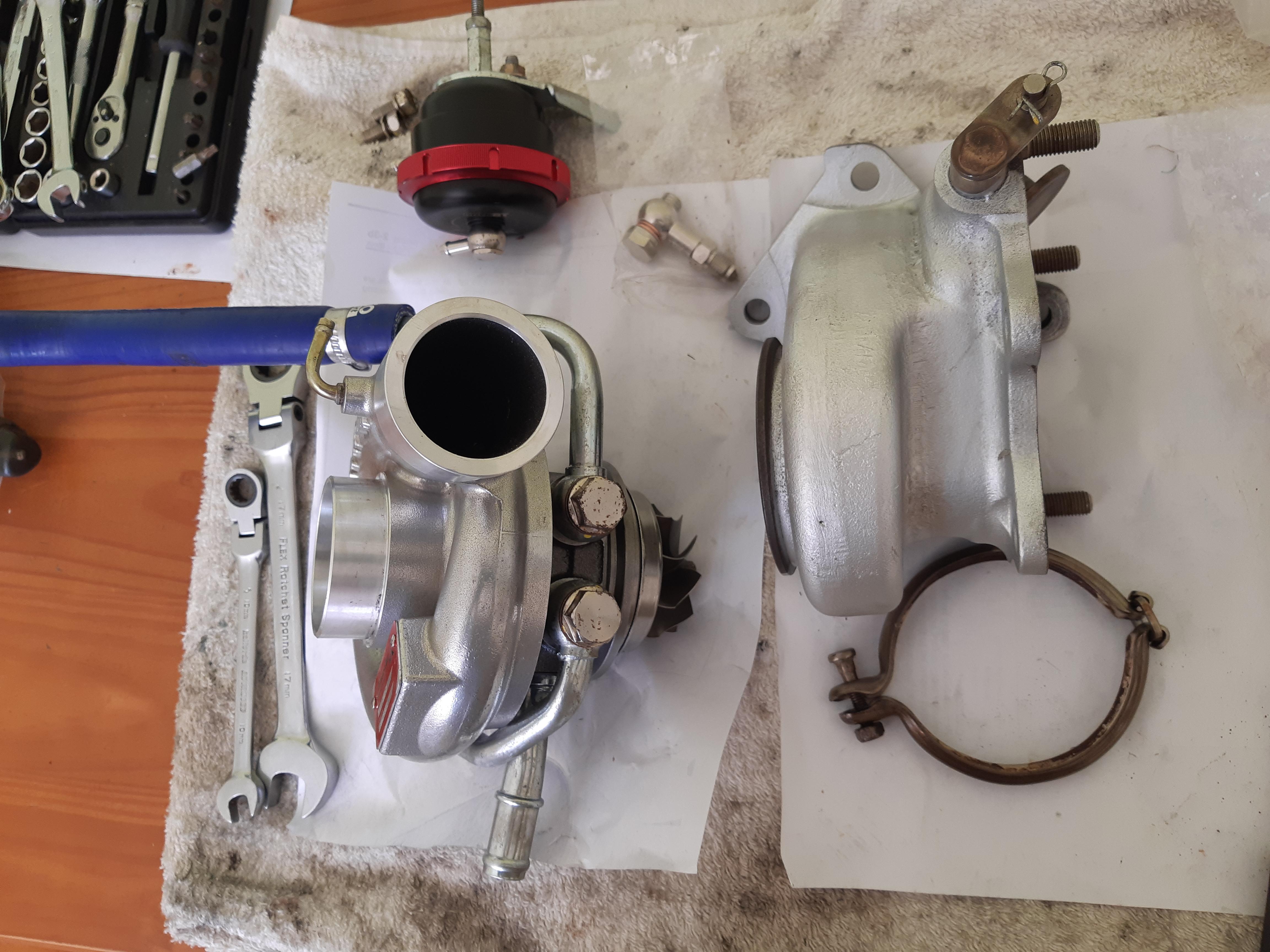

Everything is cleaned,  prepped and ready to fit , so just the turbo core to sort  . Obviously you can't go unbolting the turbine wheels from the shaft ,the expect to just simply bolt them back on and be balanced correctly but the cores come pre balanced , so this is simply me swapping the balanced cores over .
After undoing the vband and actuator,  I removed the hotside ,soaked it in white Sprit, then petrol and finally brake cleaner to remove the oil . once oil free I gave the exterior of the hotside a few coats of hi temp paint ,then removed the oil /water feeds and undid the circlip to remove the compressor housing.
As I'd badly fitted a 0.6 bar spring with hardly any pre tension,  I decided to fit a 1.1 bar spring with a bit more pre tension (properly ) this time but will back off the boost target and duty before I drive it anywhere 😉
once everything was clean , I brought it indoors and started assembly by fitting the compressor housing to the core . I Made sure the alignment Mark's were correct and fitted the compressor housing retaining circlip (very strongly sprung)20200414_143710.thumb.jpg.aba0b817339ad12d2406fcad226f67d1.jpg
Refitted the water feed /return hard pipes and banjo bolts , then the oil drain pipe with a new gasket . I aligned the painted hotside Mark's and fitted that to the other side of the core with the vband connector. 20200414_150246.thumb.jpg.8e7f43141b401b856d3111c9a6b57f1b.jpg
Actuator on and job done , one tdo5 20g billet wheeled turbo with a upgraded ball bearing core 😎20200414_151206.thumb.jpg.ef3edec4f0157c809013984bc44e6458.jpg
