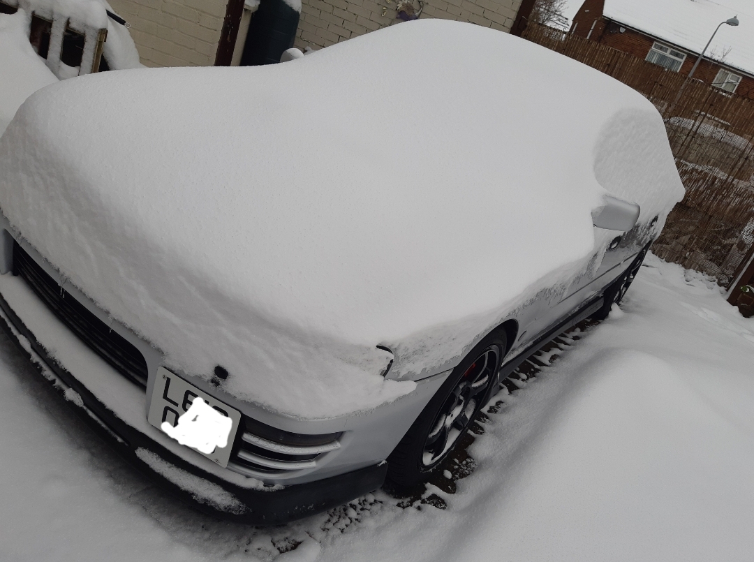

Had plenty of snow on the Suffolk coast in the end  😎
 I've played in the snow in the scooby plenty of times over the years .So I didn't bother going out in it, mainly due to salt but also not wanting some ken block wannabe in a fwd slamming into me either 🤐
Ended up looking like a fugly Tesla cyber truck 😥
Started to melt now , hopefully a few days rain to wash the salt off the roads and I can use it for something essential 🤔
Soon as the snow was gone I decided to give it a quick rinse over and take it for a essential "spin dry " ;)

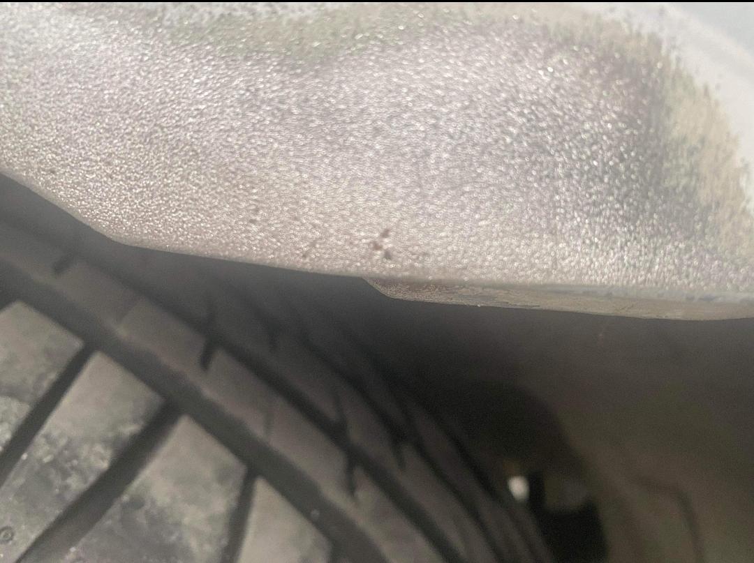

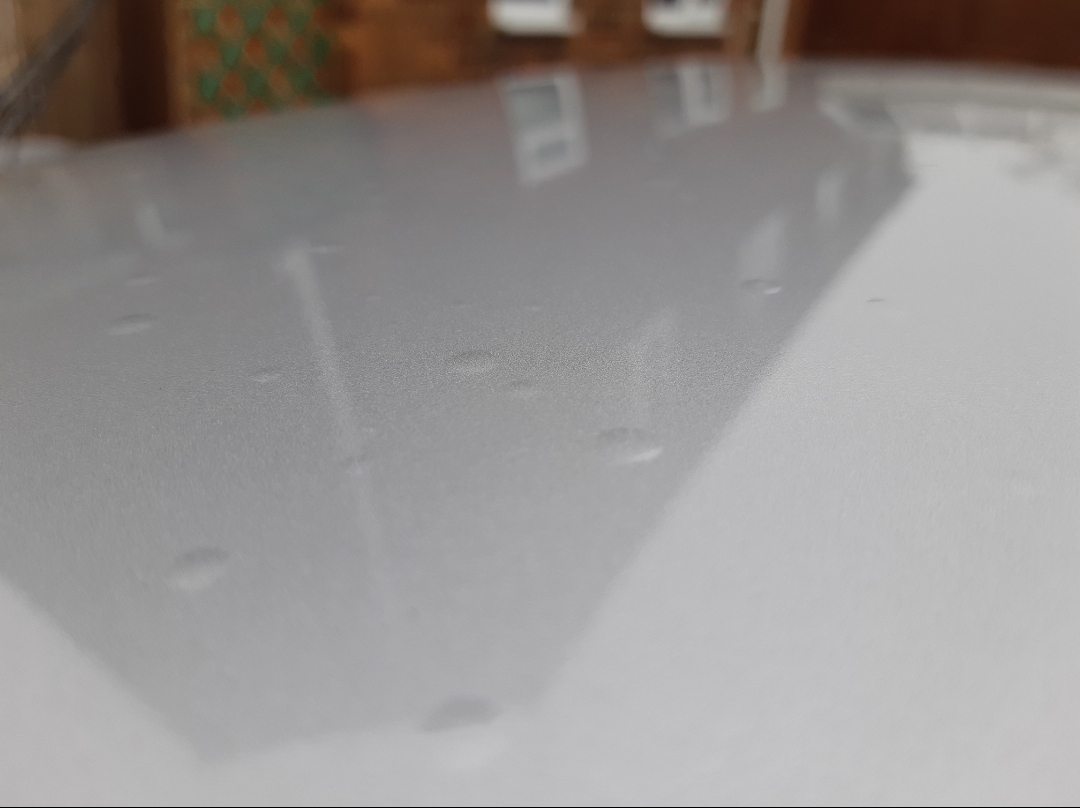

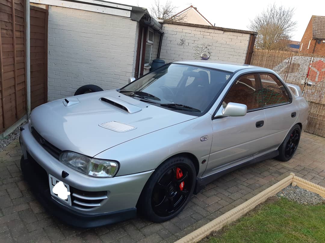

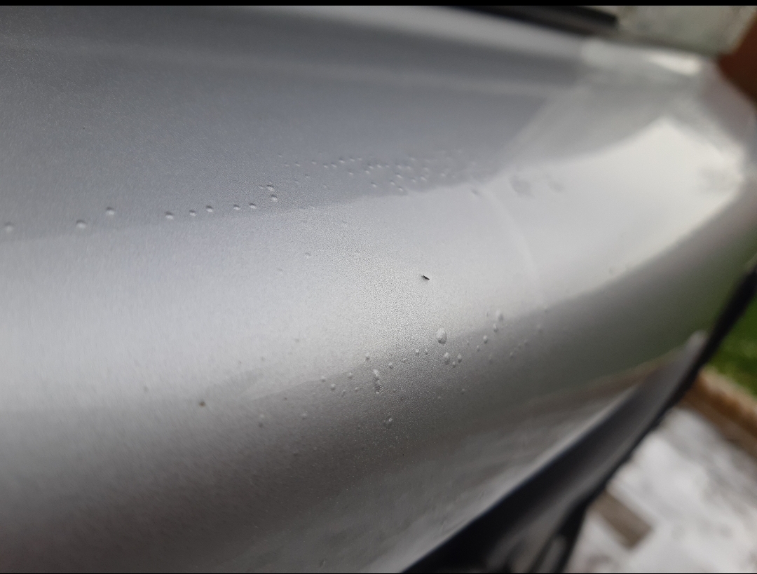

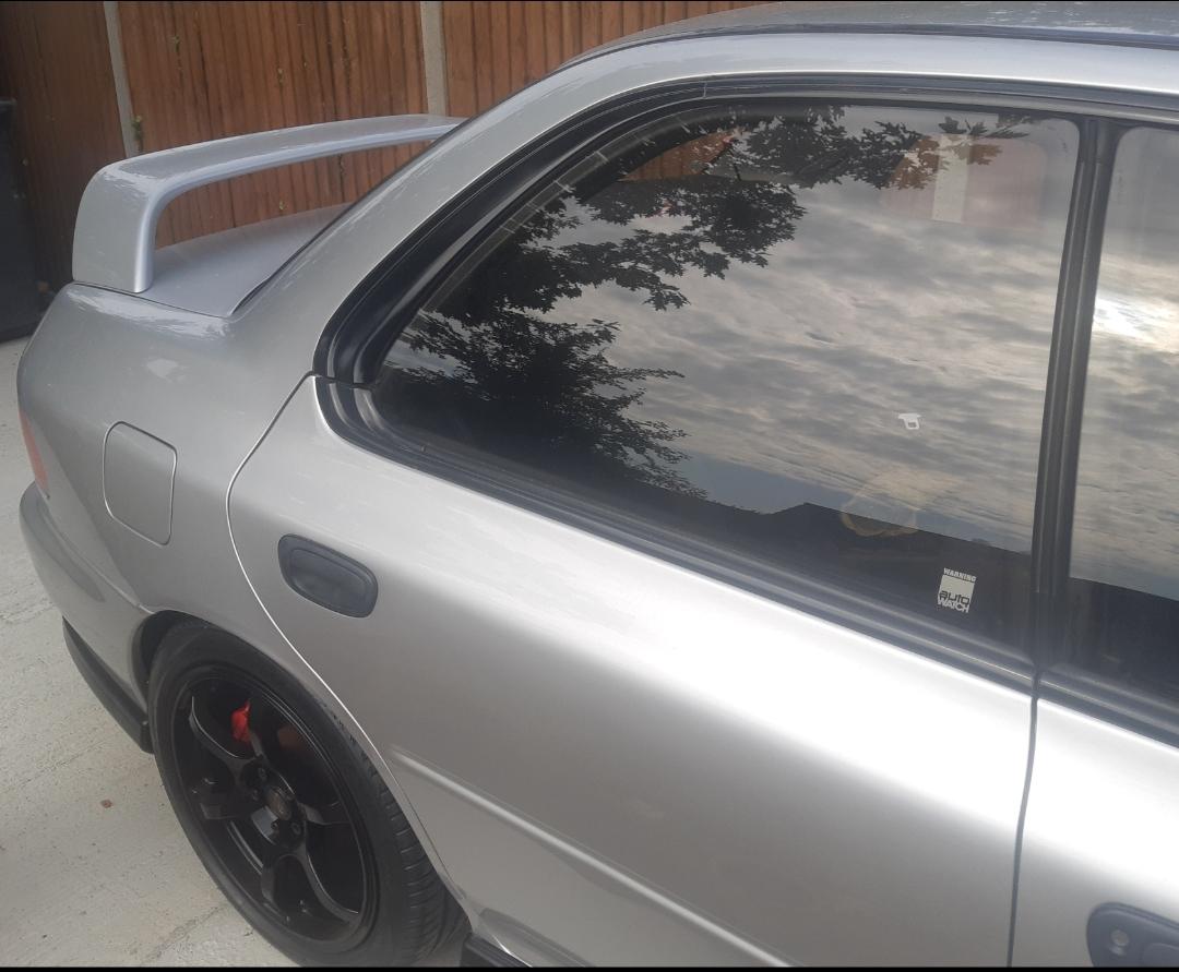

Started to dry it off by hand a bit and soon noticed blisters in the paint ,about 30 on the roof alone :eek::cry:
Some down the drivers side rear 1/4 and on the front bumper :worried:
It was painted by a reputable company that does bmw main stealer paintwork 3 years ago this april . So thought I'd take it to the body shop that carried out the paintwork , just to see if he had any idea why this happened and how much to put it right .:sweating:
The paint shop is owned by Rick Kerry (ex btcc driver) and he's been painting for over 30 years , so knows what he's doing and has a love of cars (hence why I chose him in the first place ) .
We both think the reaction was kick started by the first ever contact with snow , as it was left 6 months to dry before putting it under cover the first winter and this was the first time it had actually seen snow in past 3 winters .
He said "that in the 30 years plus he's been painting cars , hes only ever seen it about 8 times" (fml) .
He said if it's what I think it is .... it's moisture trapped in between his coats of paint . Basically even though it's done in a oven , the first "pass" skins over due to heat and pushes moisture to the surface.  Then the second pass seals the moisture between the coats before the moisture dries .
Then to my surprise,  he said if that's the case and it's a paint defect , he'll put it right for free :happy::cool:
When he originally painted it , the only panels that weren't painted were rear bumper ,wing mirrors and bootlid . I've always regretted not getting the whole car done ,as the wing mirrors have paint fade and the rear bumper has a few Mark's.
So seeing as he had been so kind after nearly 3 years , I asked him to quote and paint the bits he didn't do first time around . To at least cover the materials for the paint correction,  so it wasn't a total loss for him too  .
I dropped it off friday and Saturday morning he said it's definitely his paint at faults ,as the original coat was sound . Then sends me this pic :eek::sweating:....
Apparently he doesn't do things by half and all affected panels will be taken back to bear metal , primed and re painted :cool:

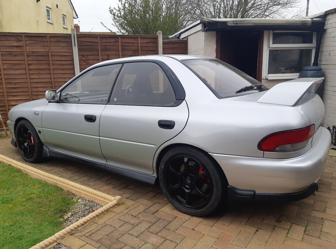

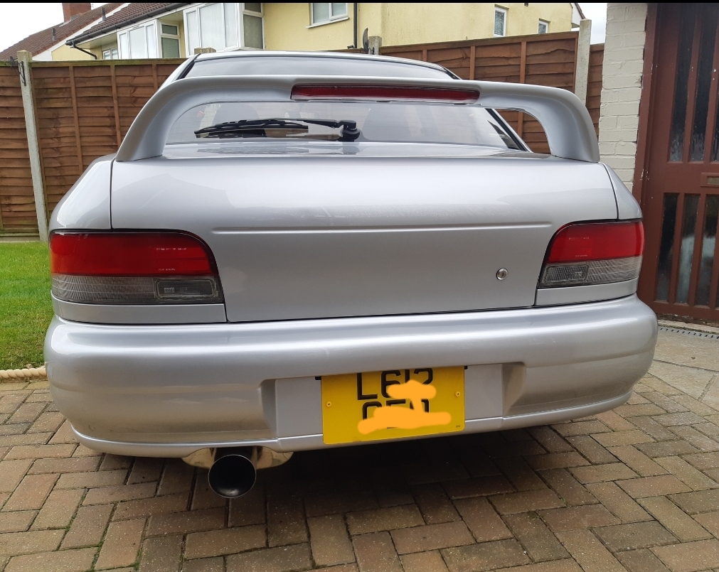

But shes home and pimple free 😎
had the rear bumper and faded wing mirrors painted too , so shes not looking fairly fresh for a 27 year old car 😊
Not too keen on the naked backside ra look .

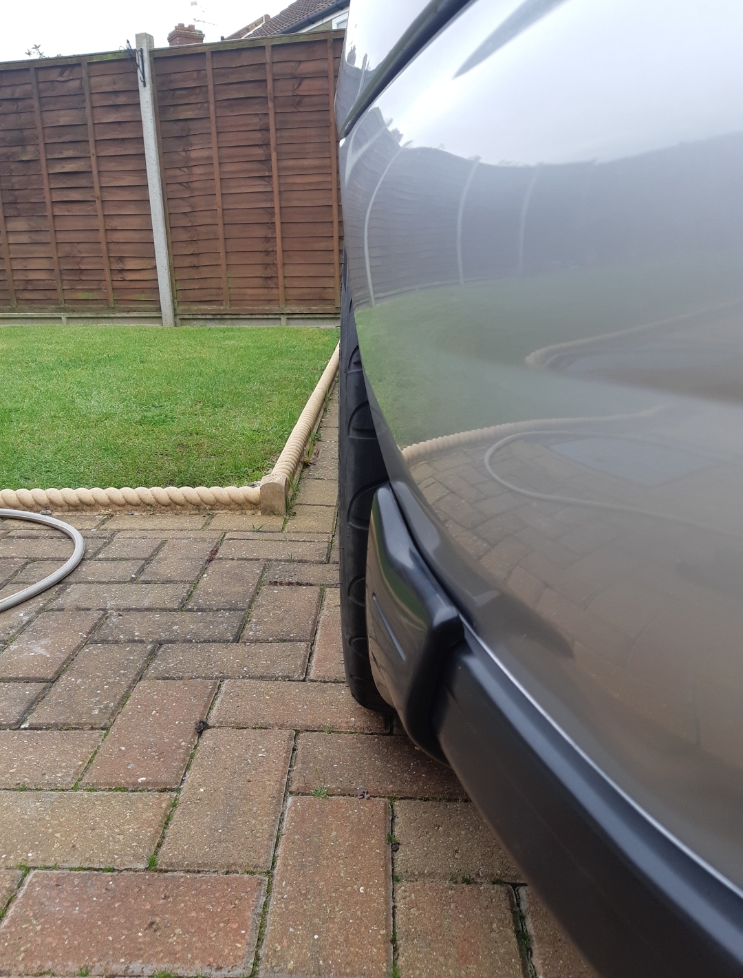

Got a bit carried away with cleaning before refitting the rear bumper 🙄 but she's still looking fairly rust free for a 27 year old car 😎
Finally got the rear hockey sticks /splash guards fitted , you can see they stop a lot of road debris flicking up the rear bumper .
but wasn't happy with the firmness of the oe fixings for the areoguards ,so removed the areoguards and will refit them with some 3m tape at a later date

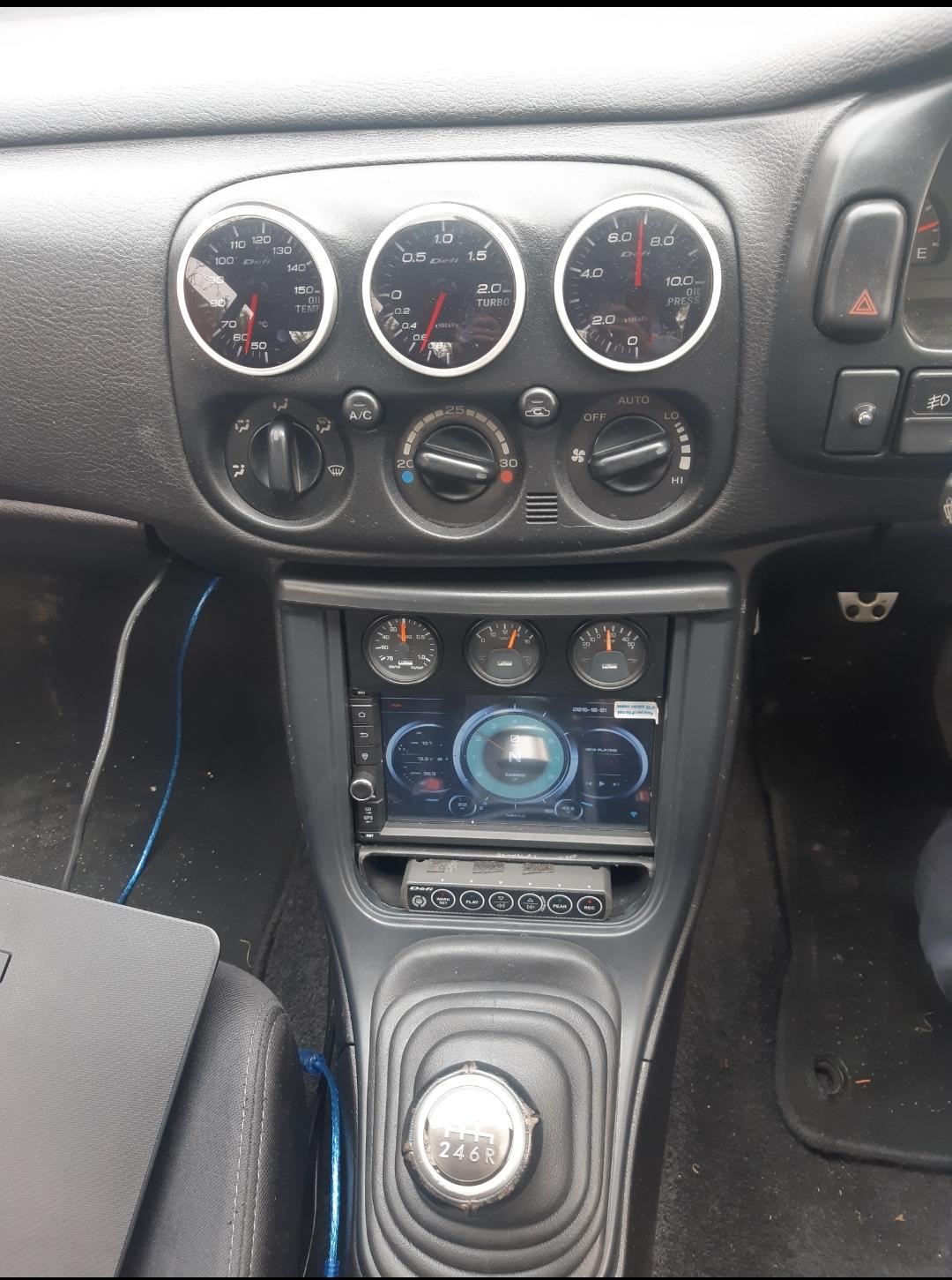

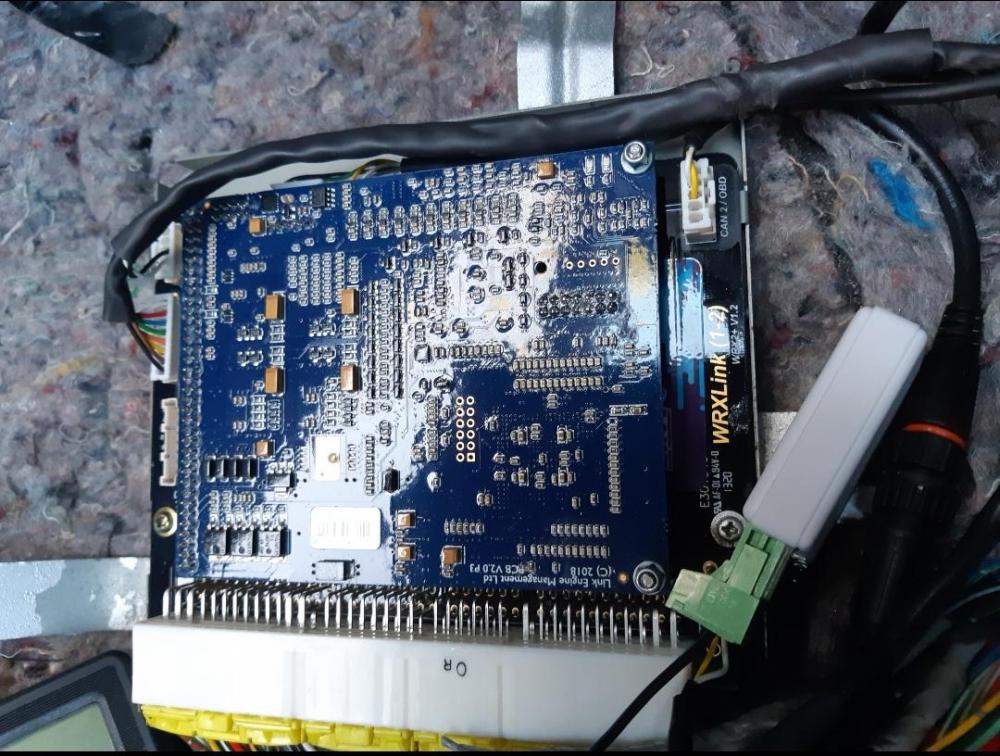

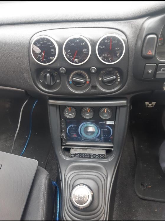

The old skool alpine headunit had started play up ,Once I actually started to investigate why it wasn't working properly .... I soon found that 2 of the speakers were fubar too 🙄
I've always missed the old apexi hand controller and being able to see a few more ECU parameters on the fly but I'm far too tight to buy s toucan monitor (£500+) . So after a bit of research , I found a android app that will work with the link ECU and started to look at cheap compatible headunits . Finally decided on a (£145) extrons headunit , as a few people have given them good reviews for the price range and managed to get them to work with the realdash app .
Along with Some new front n rear vibe slick speakers .

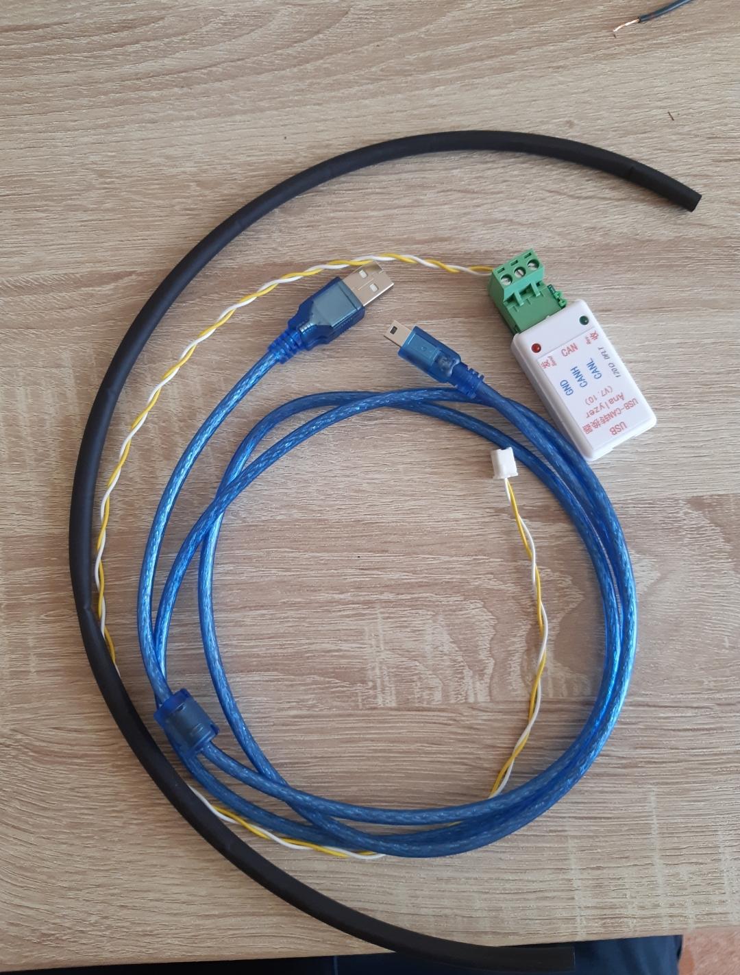

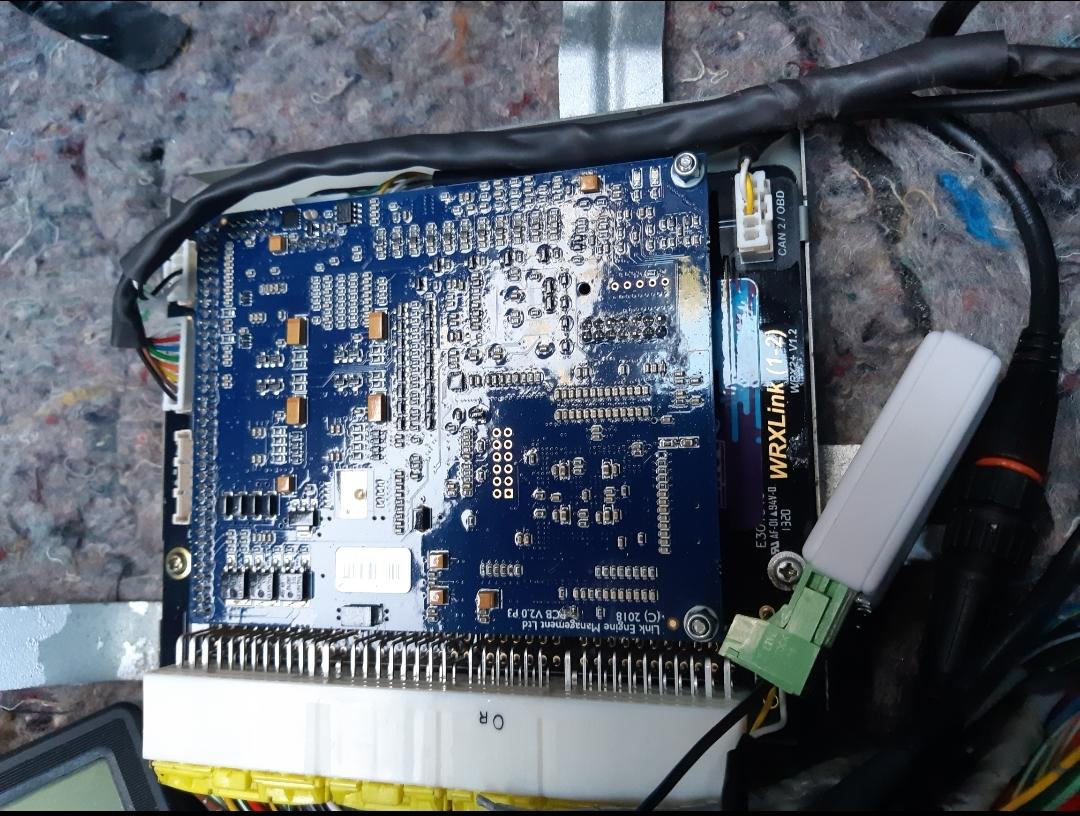

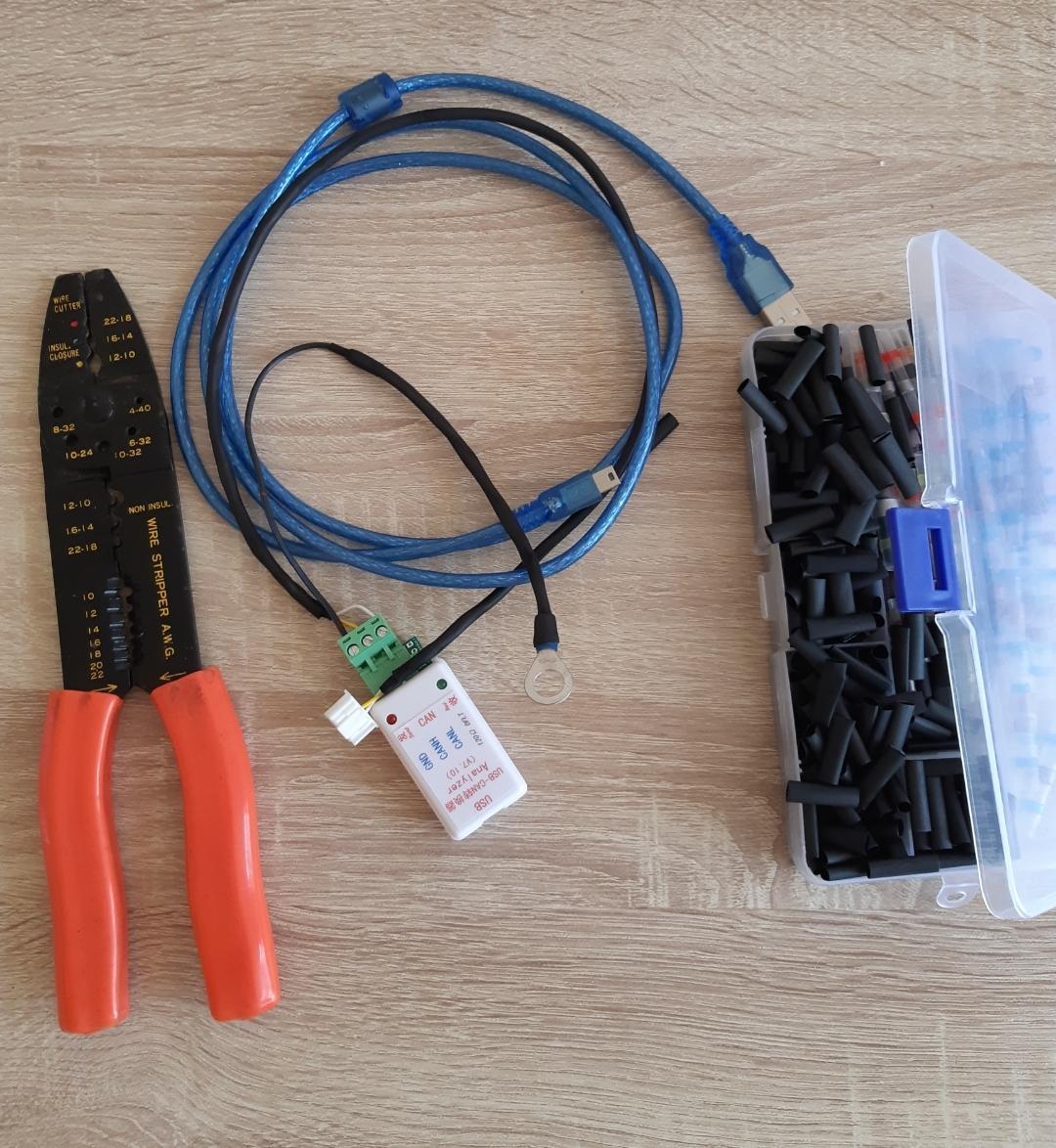

Next up was the fact that the g4x usb output isn't compatible with a "dash " input , so the connection needs to be linkg4x canbus , to canbus converter then to android usb input ....so no plug n play for me today 🙃
Martyn at enginetuner was nice enough to supply me another canbus plug and I bought a compatible can analyser for £30 .
Wired the analyser to the canbus ,added a ground connection and insulated pigtail.
Case removed and pigtail plugged into can 2 header plug .
 there is quite a few settings to go through on p.c link to set up canbus but I had done the original installation and wideband canbus connection.
Now have ecu data streaming to a 7" touchscreen bluetooth headunit for under £200 , speakers not included 😉
There's still a little syncing to do (boost doesn't show ) but temps , throttle position, rpm , afr and a few other streams are working.
Nice to have bluetooth too .
Think a few use tablets and a windows based system with aftermarket ecus but I liked the fact it's a bluetooth headunit as well , for hands free ect .
Tbh in a bug onwards all you need is a bluetooth android headunit,  torque , or realdash app and a obd2 bluetooth adapter.  Then you can get this up n running but classics are odb1 and linkg4x usb isn't compatible atm .
Not sure on syvecs compatibility but it works from p.c software to android software and 2001 onwards obd2 Subaru ecus (through bluetooth adapter)

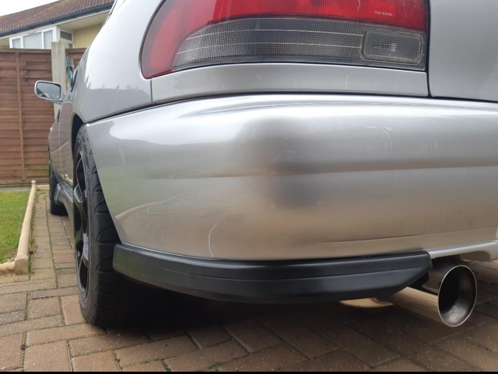

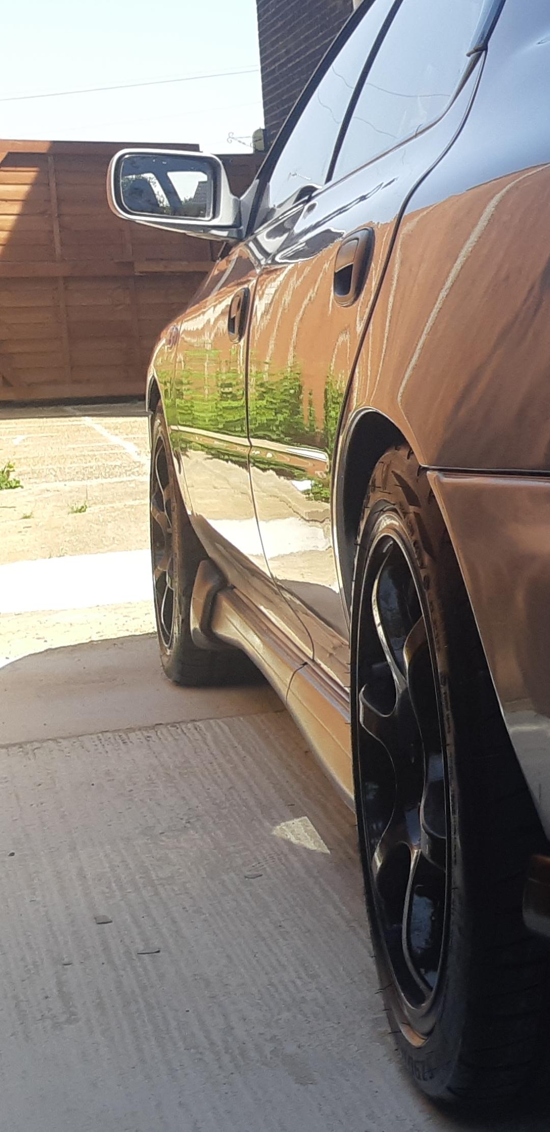

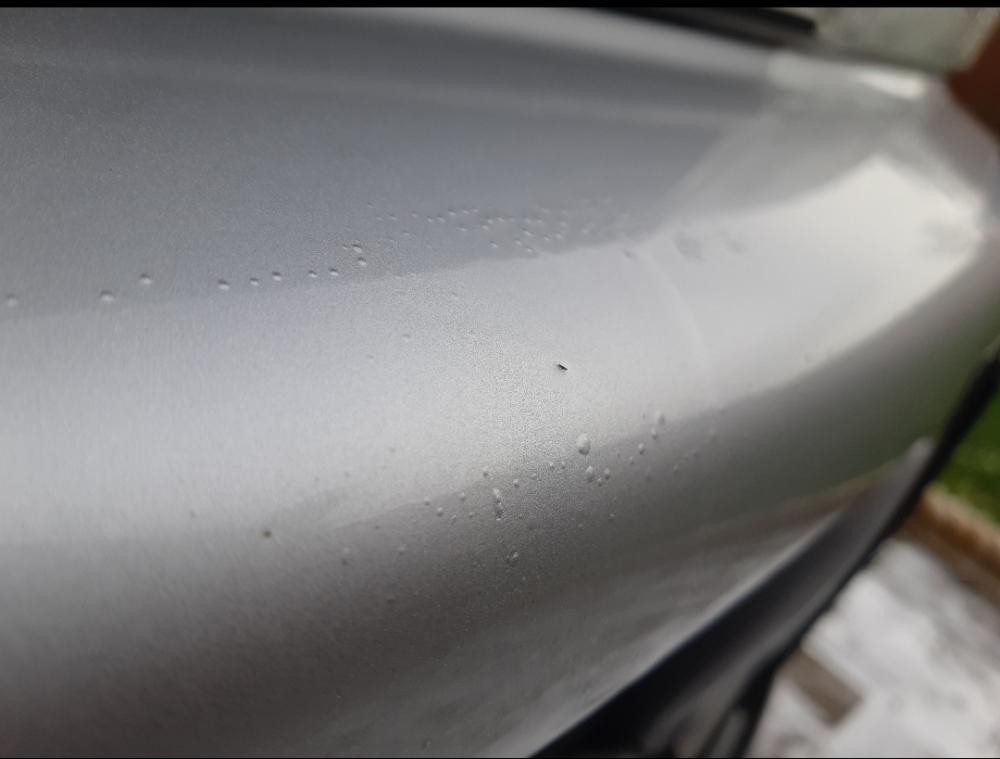

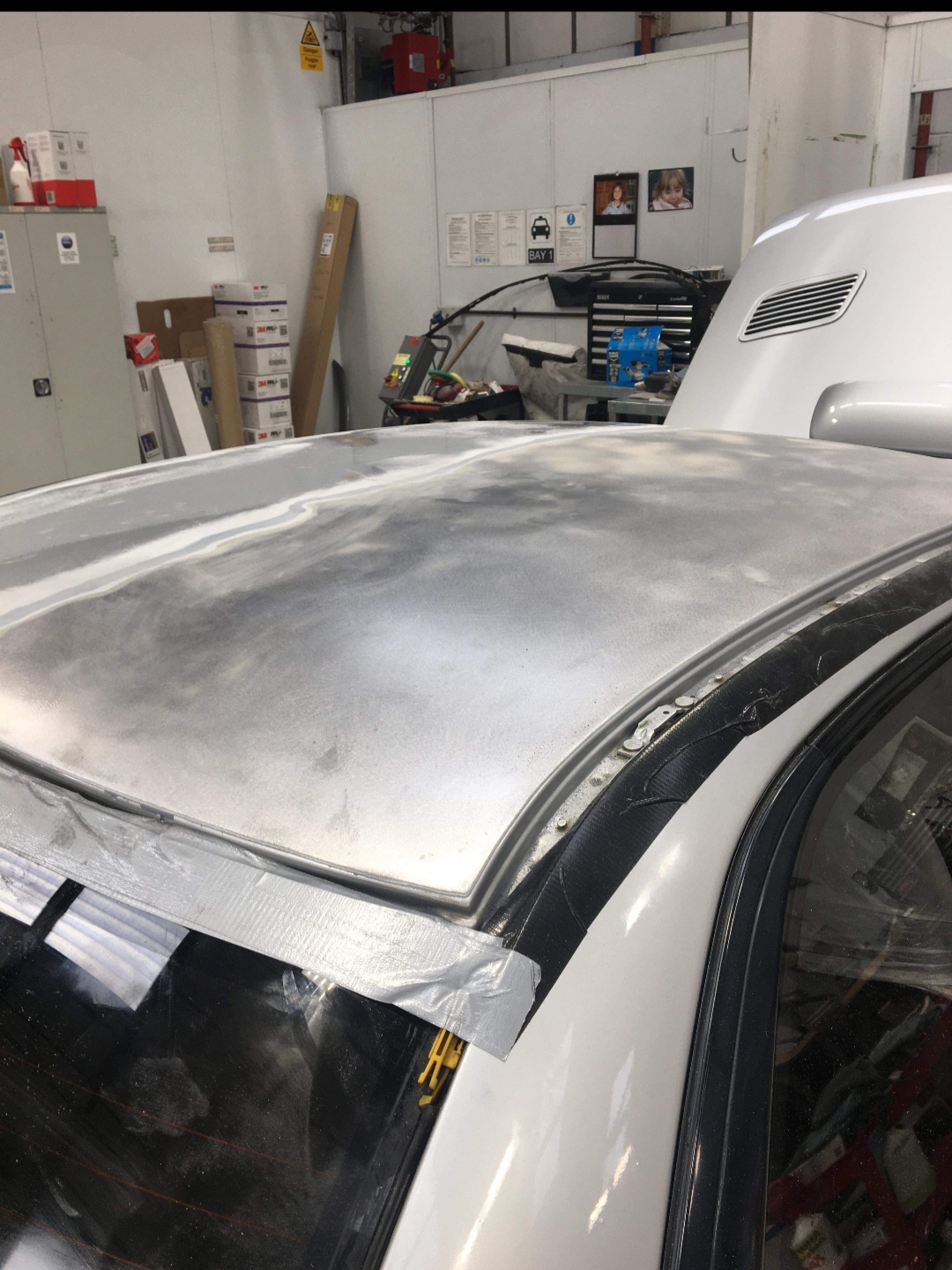

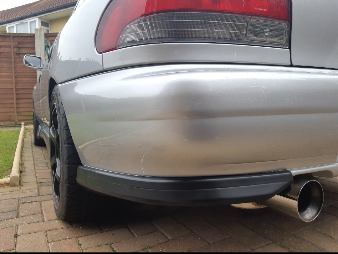

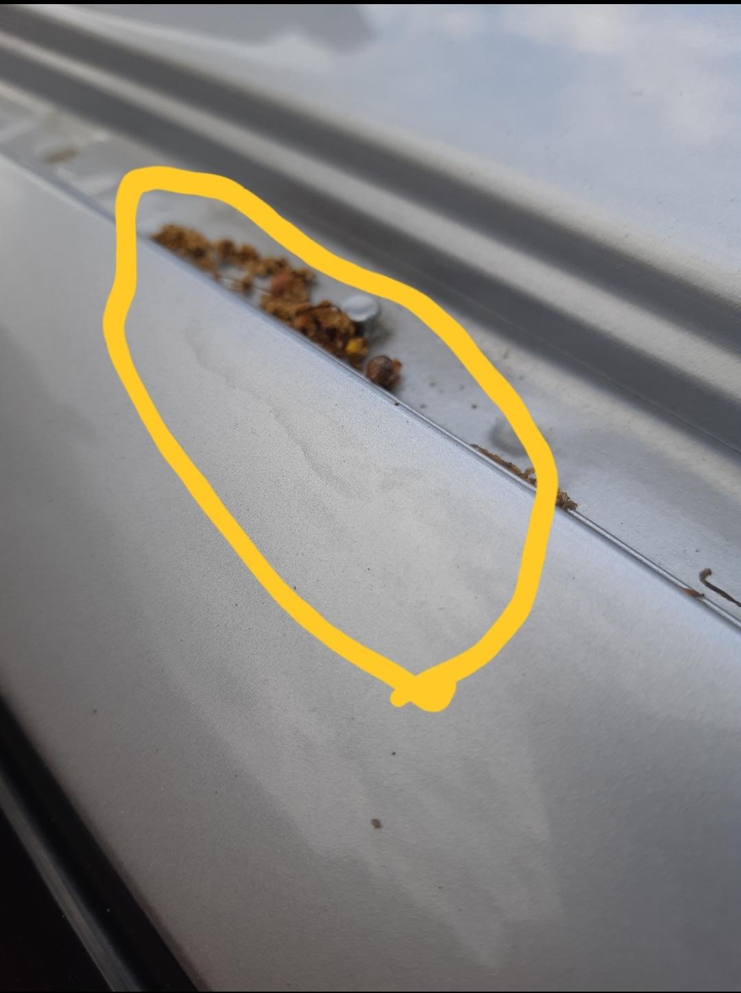

Had a few more moisture trapped bubbles appear on the roof line and  rear 1/4 , that was originally painted nearly 4 years ago (not the side that was repainted a couple of years back ) 😏
I bumped into Rick Kerry (ex bttc driver) that owns Ipswich accident repair at a local retro car meet and sheepishly pointed out the gremlins back near the roof gutter and a few pin pricks near the rear arch 🤔
"That big blister is definitely moisture again , so I'll repaint it under guarantee for free  but if those tiny pin pricks on the arch are rust ... it would make sense to cut it out and replace the affected areas "
Tbh I didn't expect to see any rust , as it's quite clean underneath but he sent me this pic "mid hack" .Screenshot_20220709-170531_Messenger.thumb.jpg.af62114647c1d84f39e453f3bf2ad62d.jpg
Even the inner arch had a little bit,  so that was cut out after this pic and replaced with fresh metal too .
So just I paid for the rust repair and asked him to paint the faded rear door trims satin black , as they had shiny silver showing through since I bought it nearly 10 years ago .
Yet again I'm happy with the finish and gobsmacked at his outstanding customer service, 🤩
Hopefully it will stay rust n bubble free for a few years to come now 😎

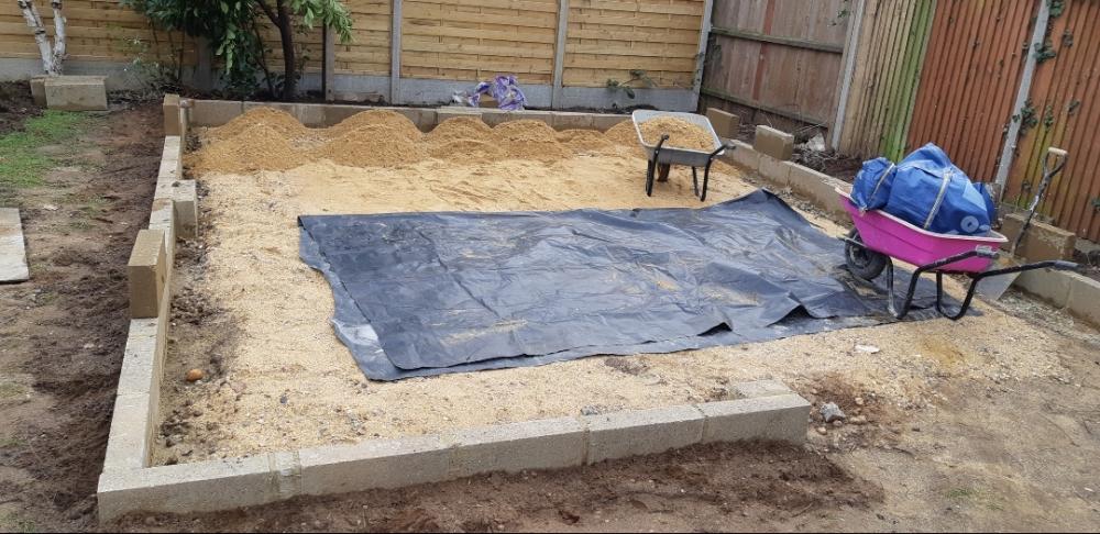

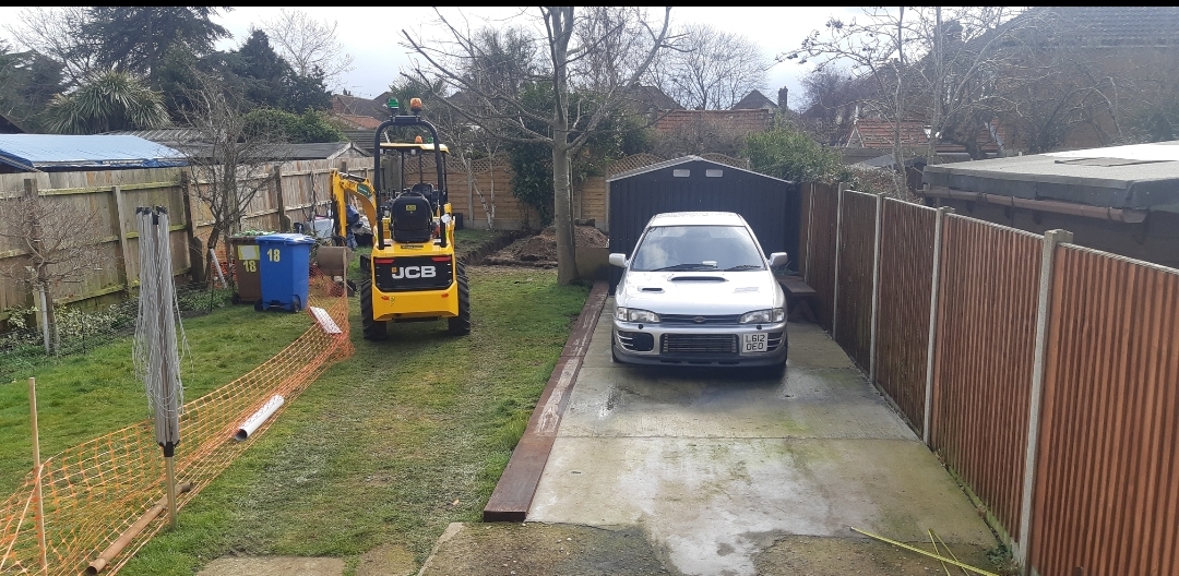

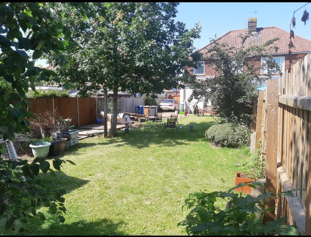

After over a decade I finally made a start on building a 30m2 workshop 😎
2 days and footings were dug out and skip loaded 😎
Then British spring weather kicked in 🙄Screenshot_20230317-121913_Gallery.thumb.jpg.cf348f0928af9f75ff7d3ed9ea88dc07.jpg
after the snow died off 1st course up to damp and sub base ballast in , ready to pour the base /floor Screenshot_20230317-121846_Gallery.thumb.jpg.9f485a28770c8f949f07c3f19c0add23.jpg
I'll give it a break for a month,  then start brickwork,  hopefully it will be roofed in by the end of the summer 😋
