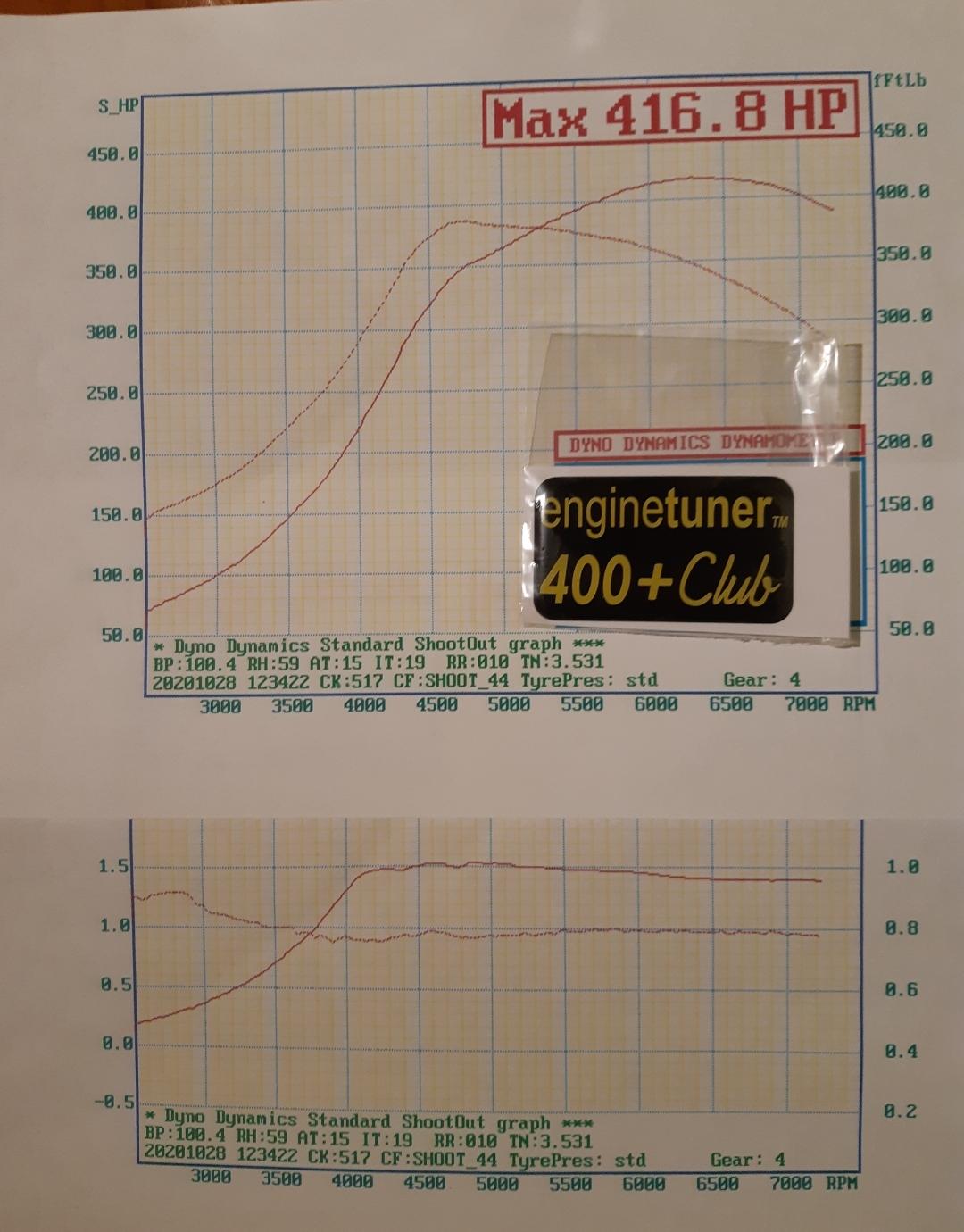

So a 2.30 am start yesterday to drive off boost to Plymouth to see Martyn @Enginetuner 🤪😥
5hrs , 330 miles and one tank of fuel later I arrived and he got to work fitting the link knock sensor he supplied,  then showed me round his workshop /premises 😎
Then got stuck in with a fresh base map and started to add boost , quick vid of him working his magic on my old girl .
With the maf deleted and the ramair filter, she sounds pretty epic imo ,as for anti lag and launch... that just sounds pure filth 😍
I'll take a vid of that at some point too but was the 630 mile round trip worth it .....
Hell yeah 😂
The drive home was much more fun with 416.8 hp/ 388flbs and anti lag and launch control 😲😎
He said the engine was quiet in the det cans and nice n strong , the arashi tdo5 20g had more to give if I'd fitted a stronger actuator spring but we left it as is .
As it hits 1.5 bar at about 3.8k and I'm more than happy with how it performs 😎

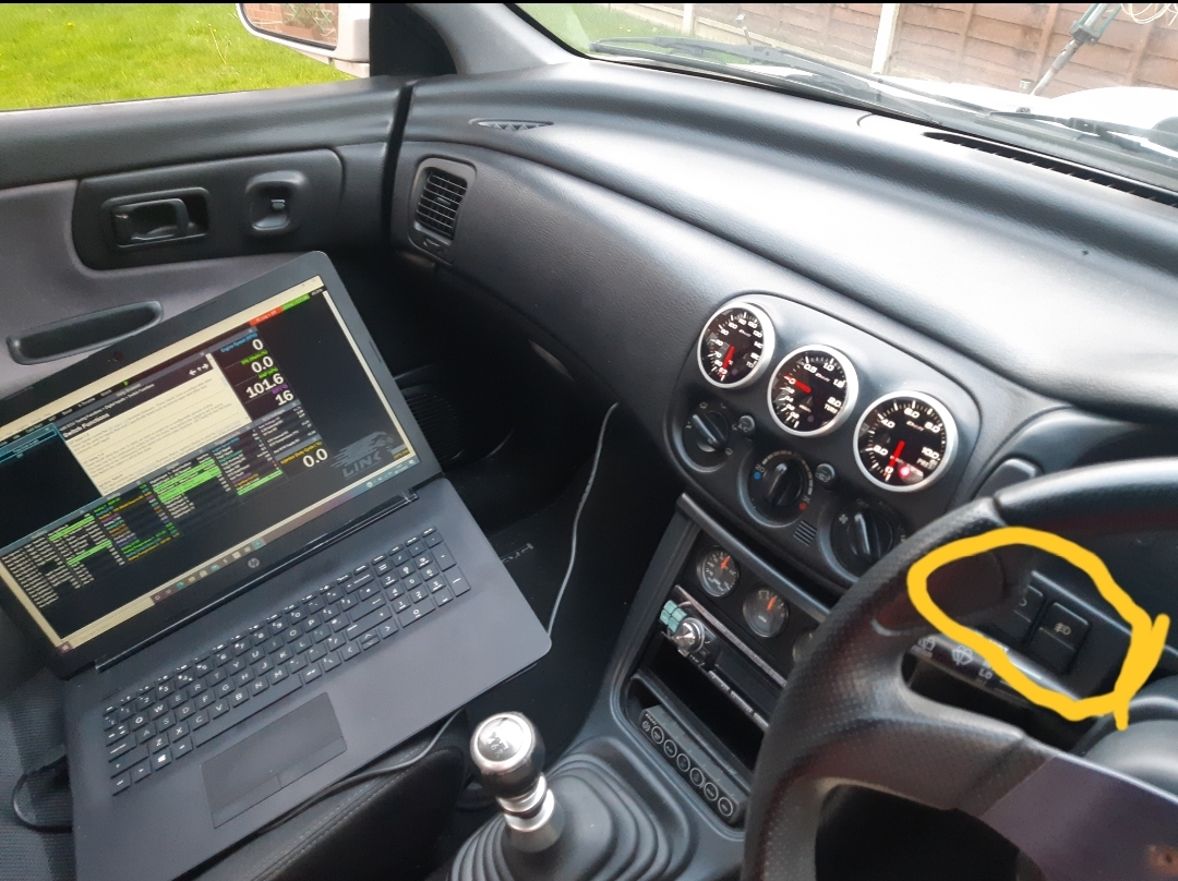

After Hermes delivered the first switches I bought to Scotland 🤔

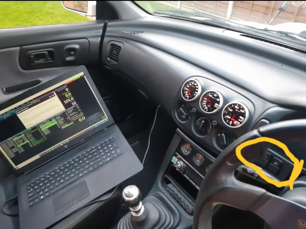

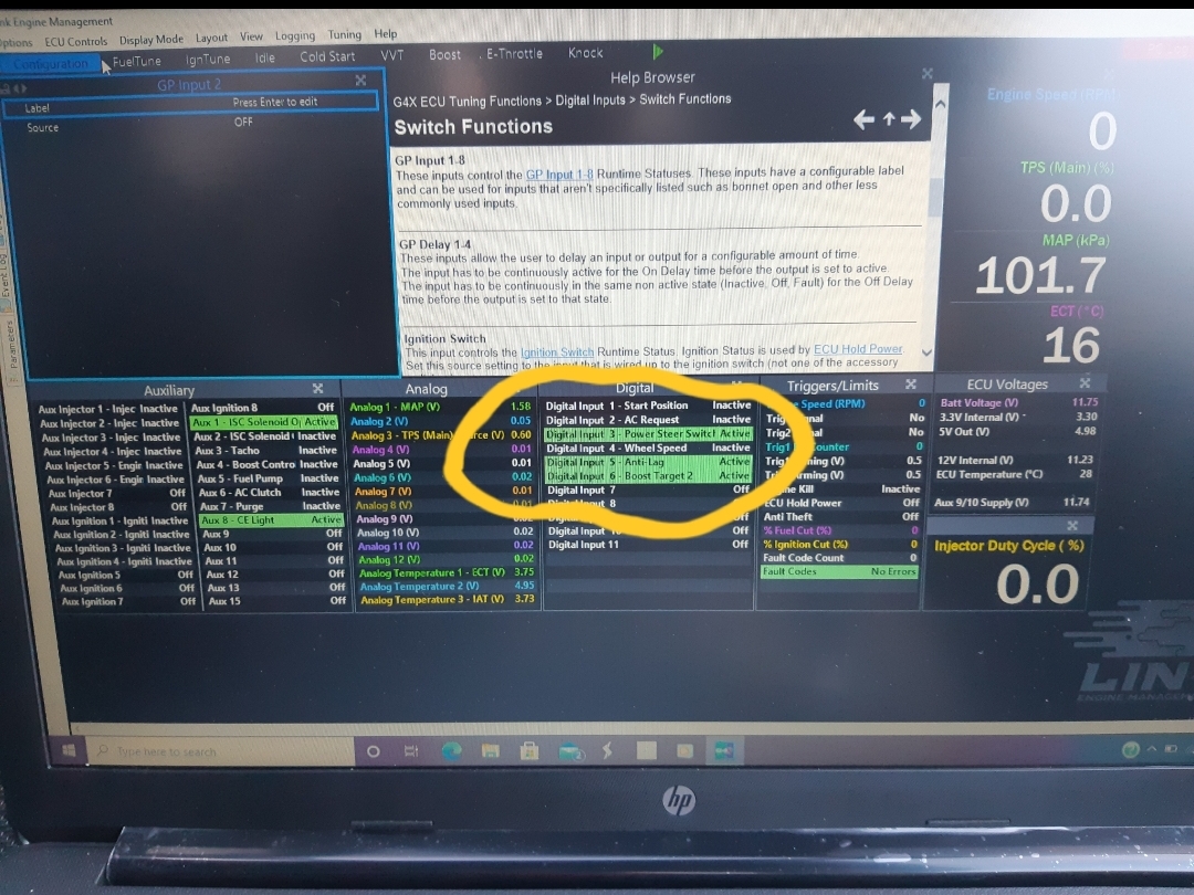

I finally got round to fitting both oe foglight switches that I'm going to use for anti lag and 2 boost targets. Think I'll eventually like the ,newer style switches and find out how to wire them up so the "foglight led on bulb " lights up when switch is armed . For now I'm happy with the oe look and didn't fancy big red covered "missile switches"
I'd already ran both di wires from the link expansion board , so it was just a case of fitting a earth to one pin on the back of the switch and the di wire (from the digital input pin) to the other side of the switch .
Then setting up what you want to use the "di pin " for in ECU settings (anti lag ,boost target ect ) and then selecting a pull up resistor on that di pin . This basically sends 5v down the di pin wire and when switch is pressed it, senses the voltage drop and activates that function on the ECU 😉
Martyn had set low boost to 1 bar while it was sat on his dyno  , I asked what sort of hp that was and he did a pull .... bang on 350 hp 330flbs  . Which tbh is enough in a 1230kg awd car anyways 😉
but it's nice to know there's another 70hp /flbs and anti lag a oe switch away 😎
I do miss the f.c peak display more than I thought I would , so guess I'll be looking into linkg4x compatible tablets or a toucan at some point 😊
