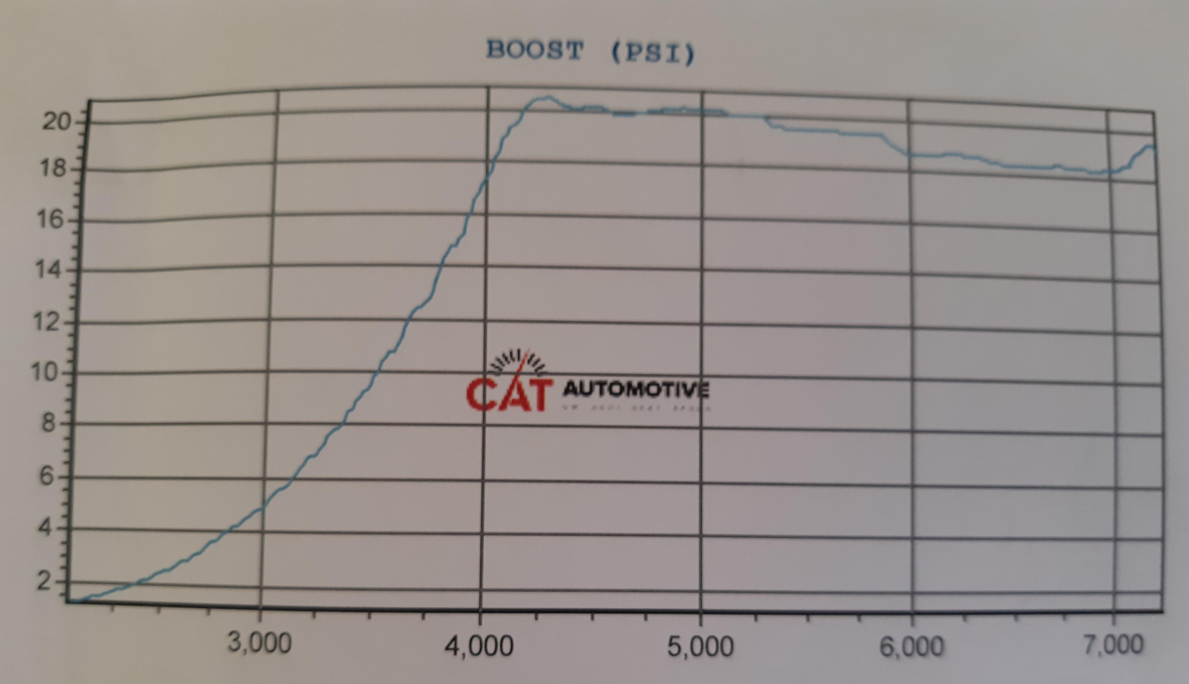

Had a issue with the actuator not holding boost and causing issues controlling it but I did bring a few spares n tools ....
Its getting hot after all the part throttle pulls ,so spot of lunch and let it cool down a bit before tweaking for power🙄

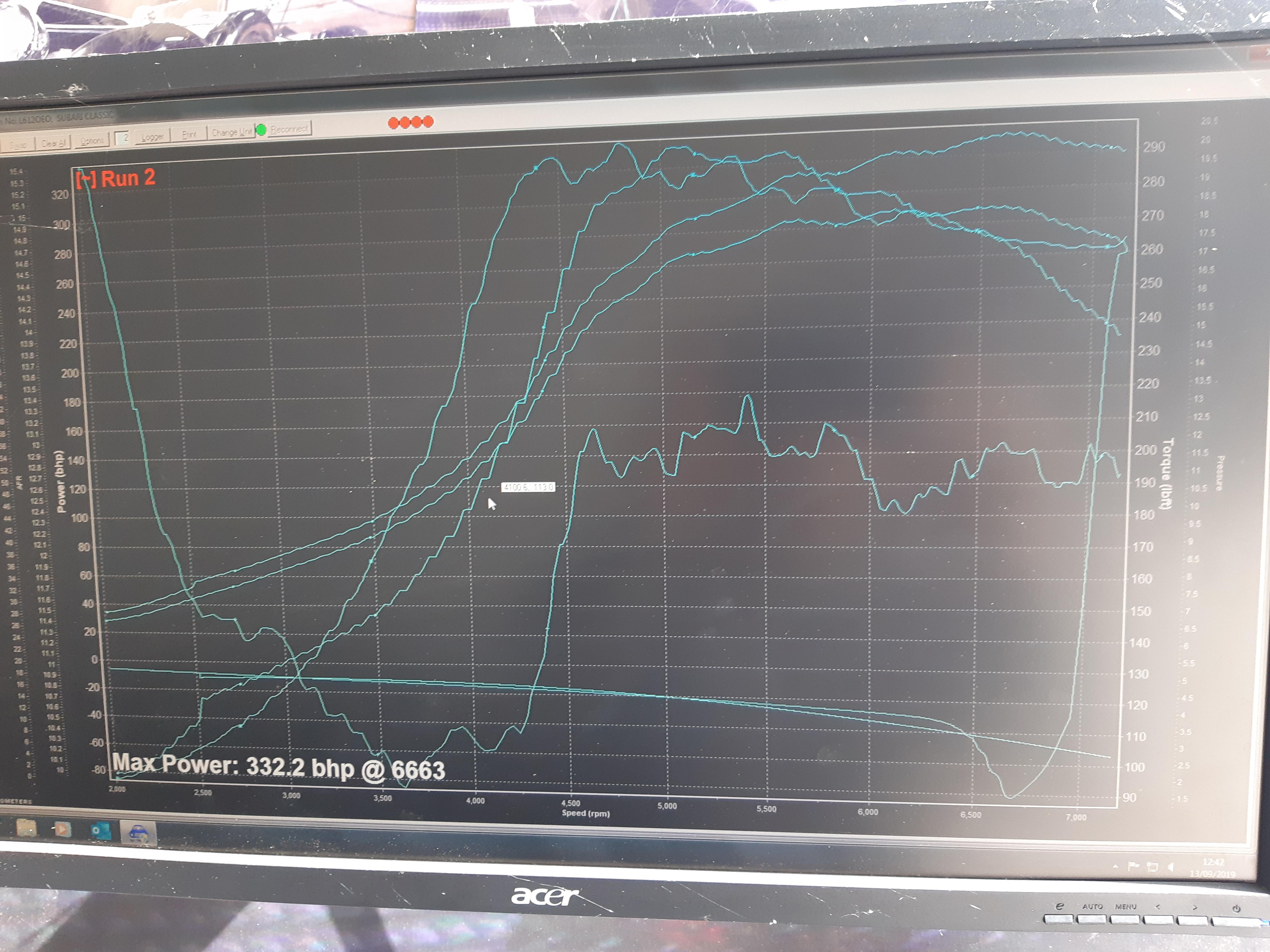

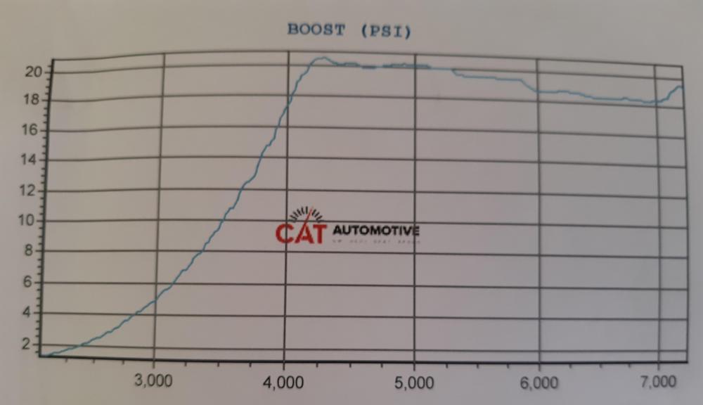

He did do one pull at 19 psi and it seems that this turbo is gonna out perform the old one 🤞 full boost just after 4k, 332.2 hp at the flywheel  and just over 290hp at the wheels . Seems to spool well for a 20g so far 😉
  • Replies 831
  • Views 212.2k
Well the actuator and time stopped play at 332.2hp at 1.4 bar 🙄.
Well impressed with the turbo and with a stronger spring fitted , we're confident it will make more boost and power 😎.
After fitting a weaker 0.6 bar spring mid map we found out I'd put too much pre tension on the actuator arm ,first time around which made it very difficult for the avcr to control boost .
So hands up , it was my fault 🤐.
Attowe did manage to control the boost fine up to 19 psi (just under 1.4bar) so the boost curve is much cleaner now than the previous graph . I will eventually fit a stronger spring but can't see the point in getting just that tweeked in, so will wait until the new year once the heads are fitted and get it all done at once . For now its running safely and pulls cleanly,  for a big billet wheeled 20g it spools fairly good imo too .
Right I've drunk all the milk ,so I'm off to take the scoob for a blatt...  I mean get some more milk 😊

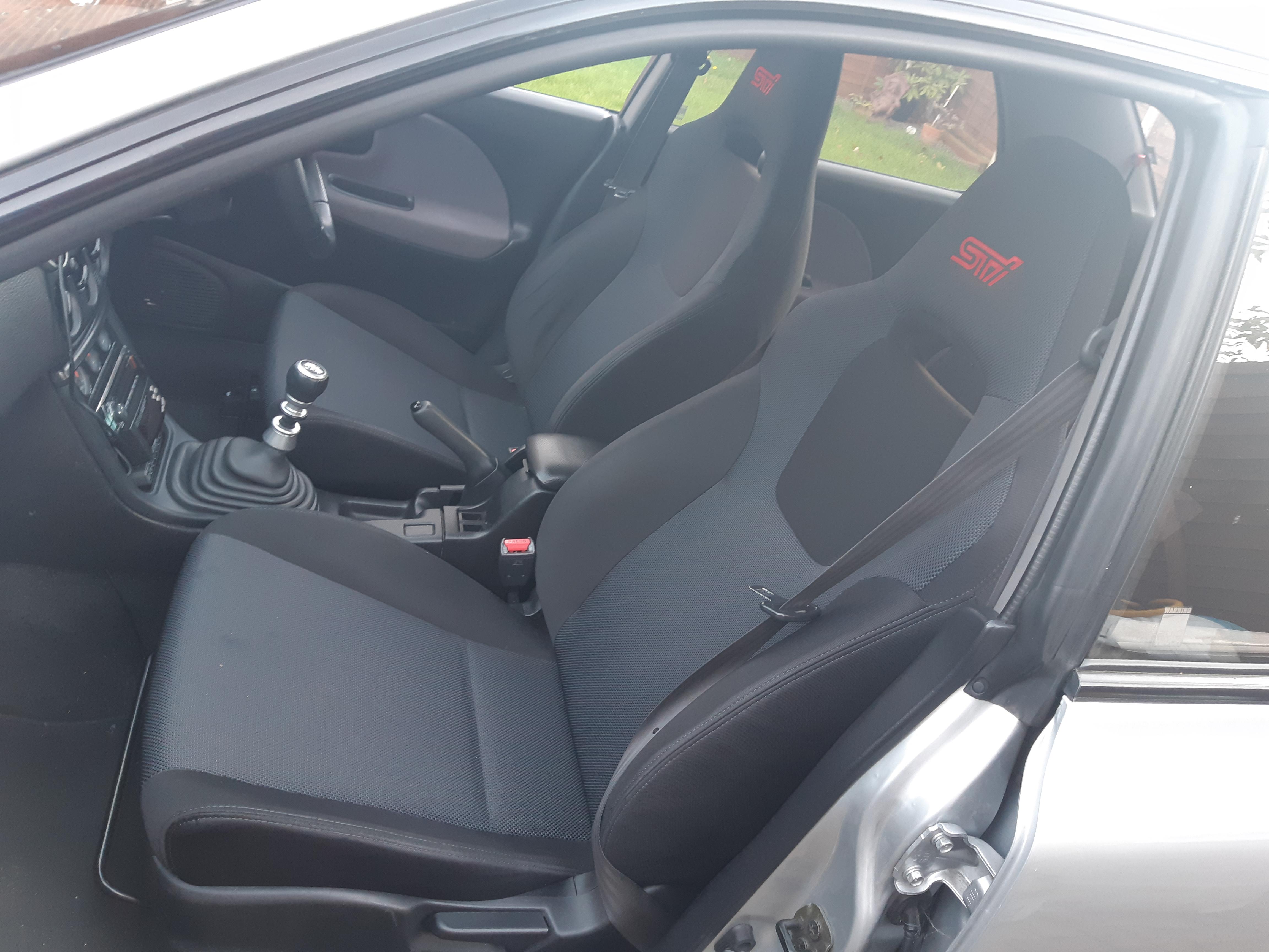

So seeing as I won't be driving it for a while , I took some pics of the inside for a change lol

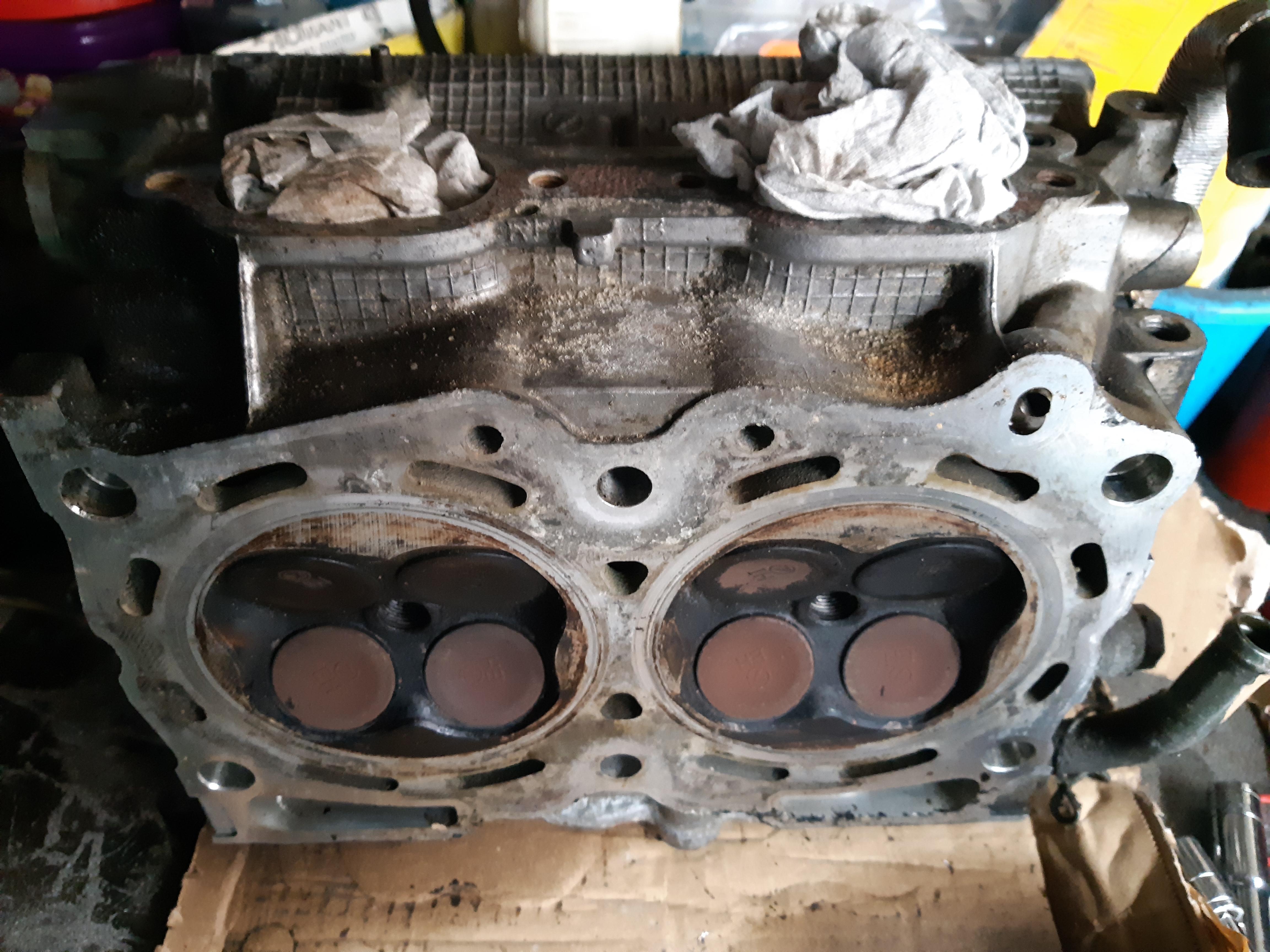

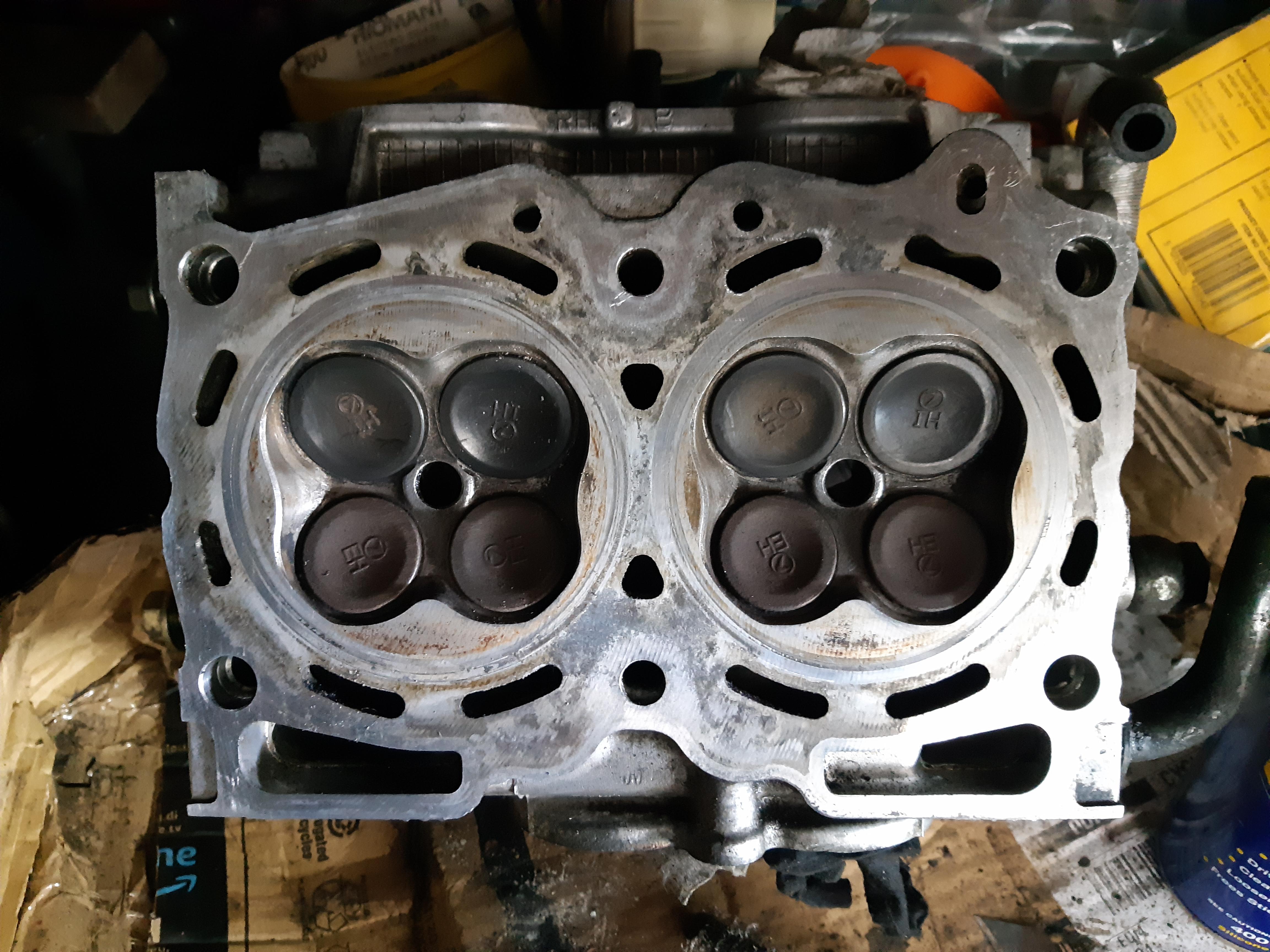

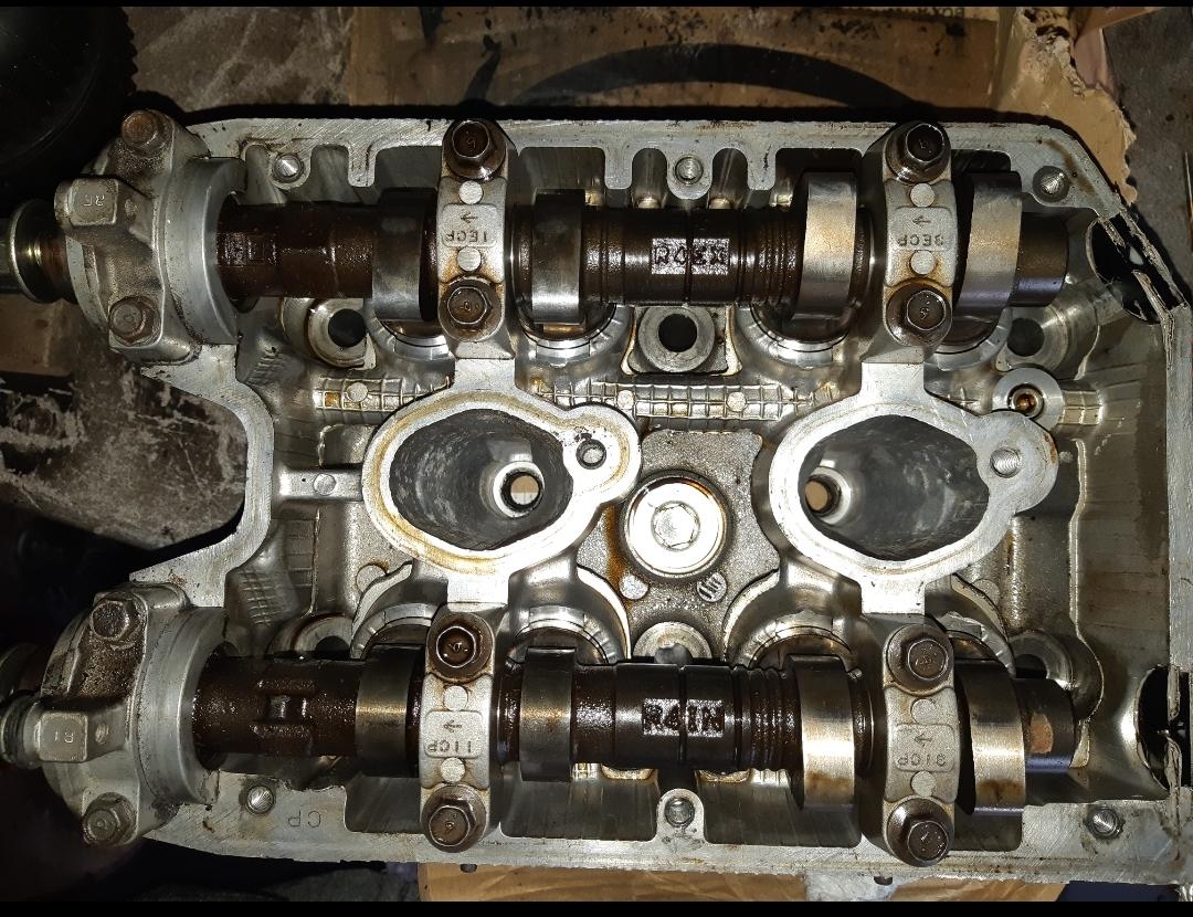

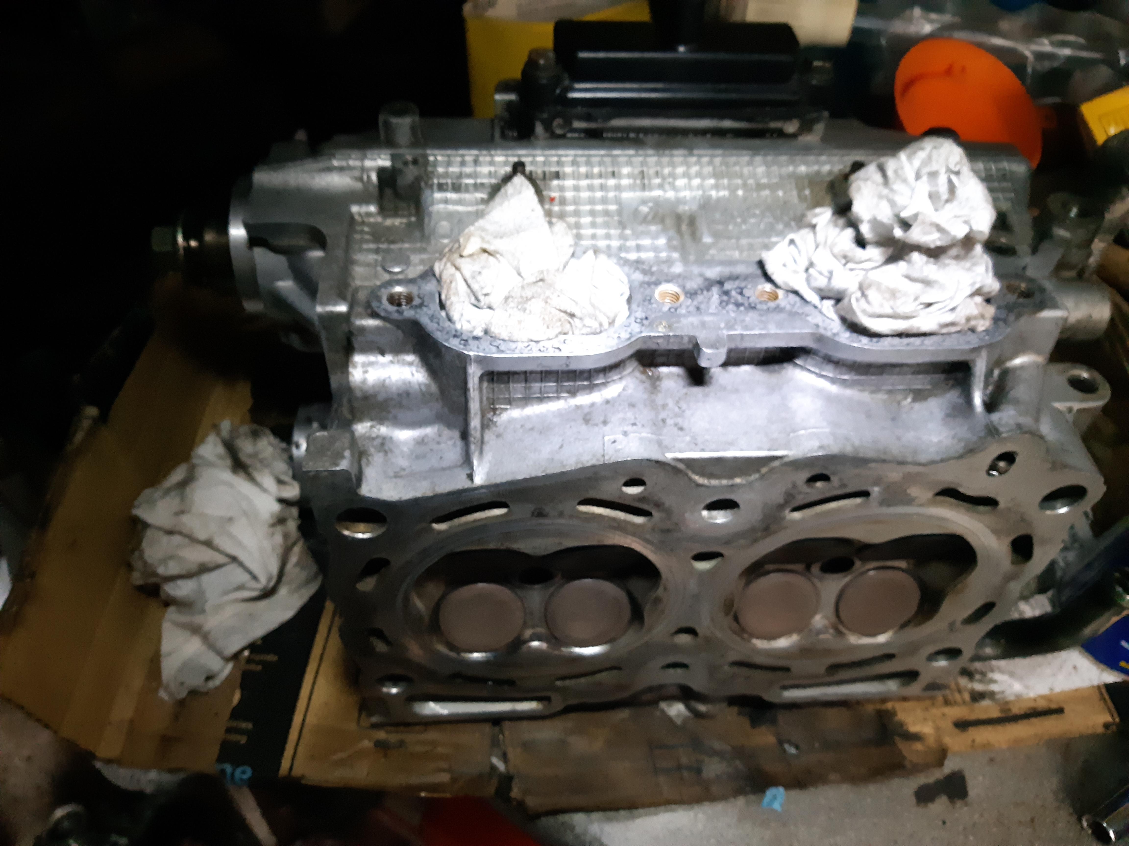

Had a bit of a tidy up to create some space to start on the v4sti heads .Found 3 x 10mm sockets too ,so I'm gonna buy a scratch card later (cos I feel lucky lol )
Started on one head by checking the current valve clearances and although they're at the top of factory spec , I think that's a good thing . As hopefully when I relap the valves in ,it will bring the valve tips in closer , closing the gap by a thou or so 😉 . Not that it matters too much , as I can change the under bucket shims for the correct size when assembling, anyways .
The bottom end had gone on the v4 sti type r , so the chambers looked a bit oily.Other than that they look in good order 😎
Knowing that I can't bring oily "scooby scraps " into the kitchen, I removed the pulleys ,re fitted the cam covers and started to give them a clean with a tooth brush and some wd40. Obviously once I've stripped them they'll go to Pat segar (my trusty engineer ) for a pressure check ,face skim and hot wash before reassembly.
So just a couple of pics of the pre kitchen prep ,for now 😊

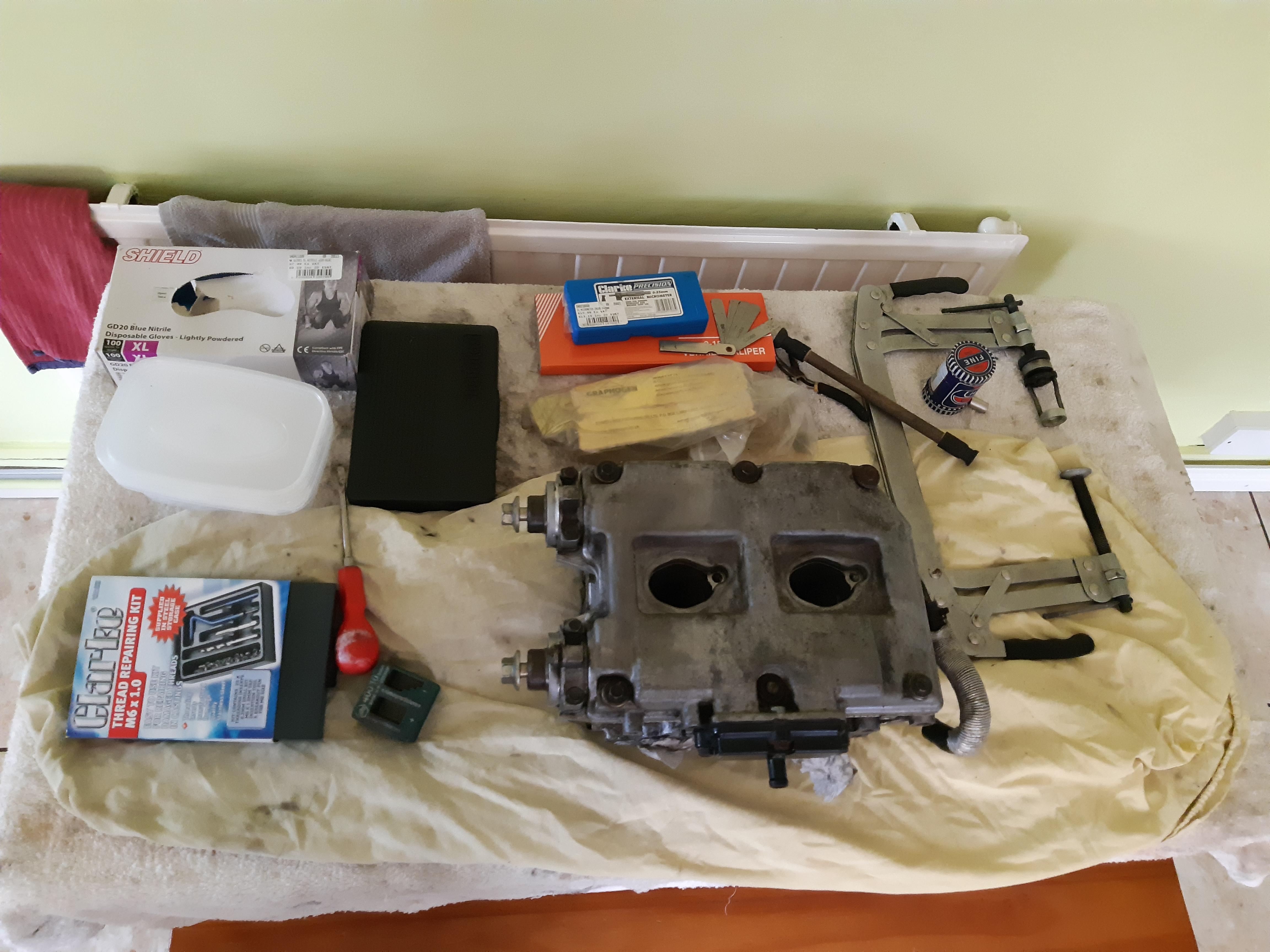

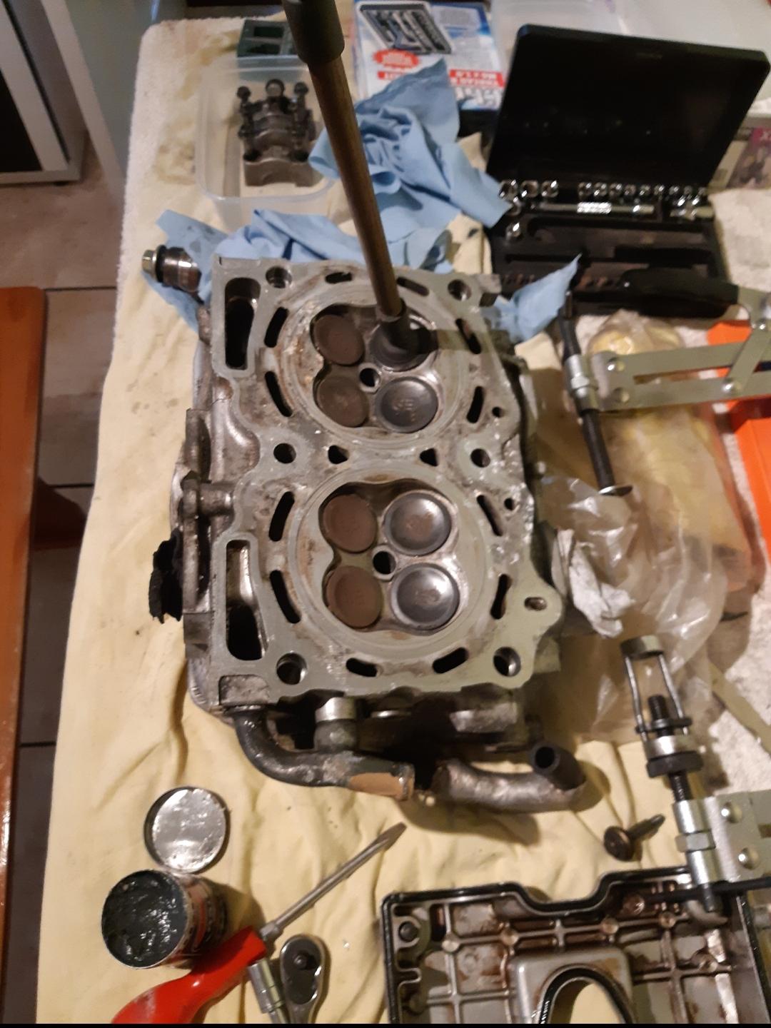

I  finished cleaning the v4sti heads , to a standard that the wife will allow them into her kitchen 😋. Covered the trusty dinner (engine building) table and started off by checking the current valve clearances. Happy to find that they're all within factory  spec, I made a start on the right hand head inlet valves .
Unfortunately,  I didn't manage to achieve a great deal and only removed the right hand intake cam , retainers, collets, springs and valves .😏
But I did check the valve and valve seats over and although they're also within factory spec , I did re seat them by lapping them .
So not too much progress but hopefully tomorrow I'll do the same to the exhaust side and at least I'll have one of the heads ready for pat (my trusty engineer) to pressure test and skim 😊
Few pics of Saturdays lunchtime preparation and me "lapping " up some tasty v4sti heads for lunch  🙄😂
I made a start on the exhaust valve side today and I'm not happy with the amount of contact area on the valve seal . So if I'm going to get the right hand exhaust valves re cut ...  I might as well get them all recut .
In which case the lapping in of the 4 x R.H inlet valves , was a bit pointless  but at least I didn't do many out of the 16 valves before I noticed  that some would need a re cut .😏
Also found out my preferred earlier style cam covers with "twin cam 16v" wont seal around the v3/v4 head spark plug channel . So I'm gonna drop the v3/v4 cam covers off at the powdercoaters instead ,probably along with a few other bits as well 😉

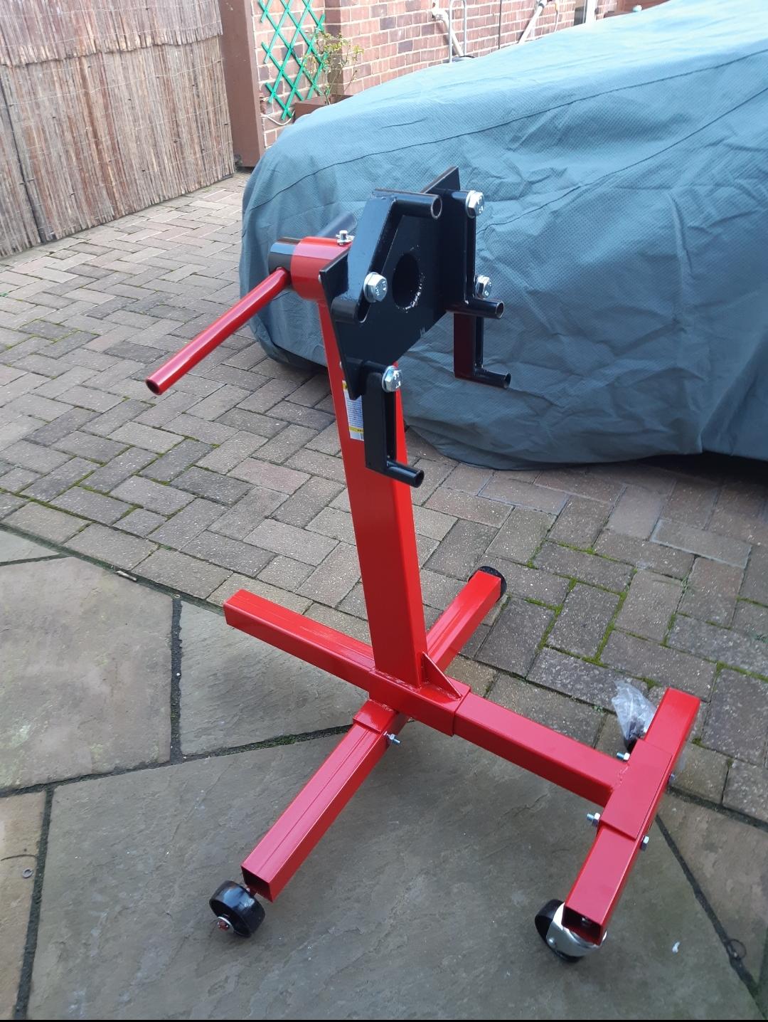

Still not got the heads back ,as the engineer is well busy but I did finally unwrap a xmas present.
It was for the wife .... so I dont have to keep using the kitchen table when working on engines 😊

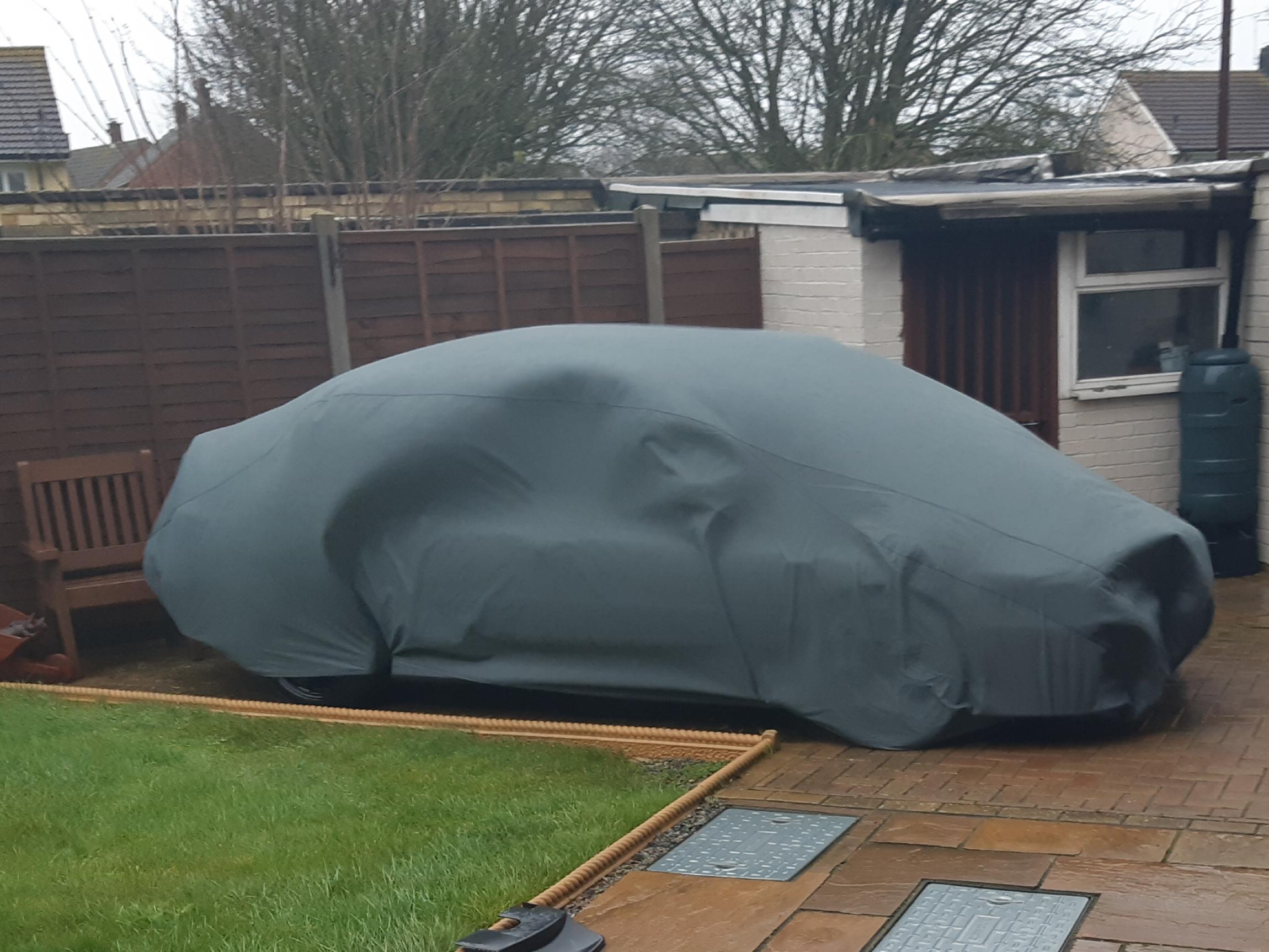

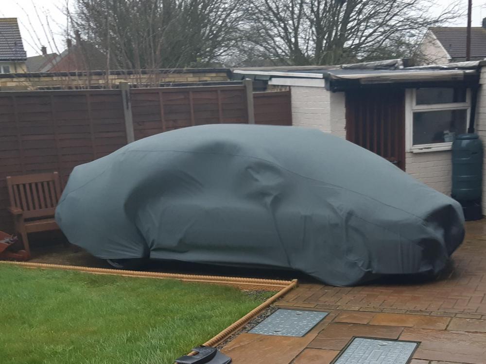

Collected a hoist I'm borrowing this evening and was hoping to pull the engine this sunday but apparently we've got another storm at the weekend 🙄
893075649_Screenshot_20200211-191122_SamsungInternet.thumb.jpg.966809f314f75fc32b1bb1a9661f9723.jpg
Hopefully they'll be a gap in the bad weather soon , as the 70mph winds gave the car cover a proppa battering this week already 🙁
