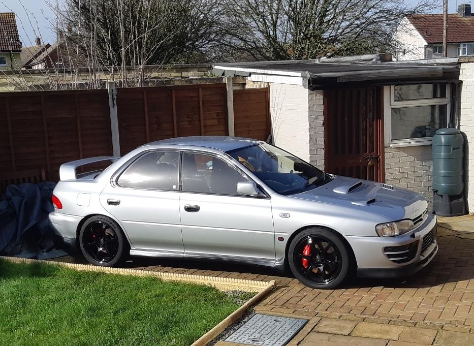

I'd like to say that with being close to better weather season , I'd think about getting the scooby uncovered but two storms in two weeks and the cars uncovering itself ..   well car cover is now completely fubared 😥.

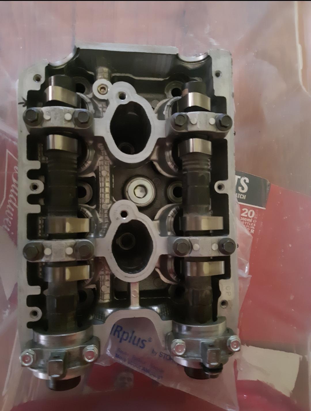

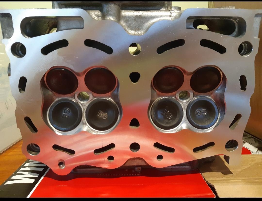

Difficult to see in the pics ,due to the light coat of oil but the heads look sweet with a near mirror finish on the face work .

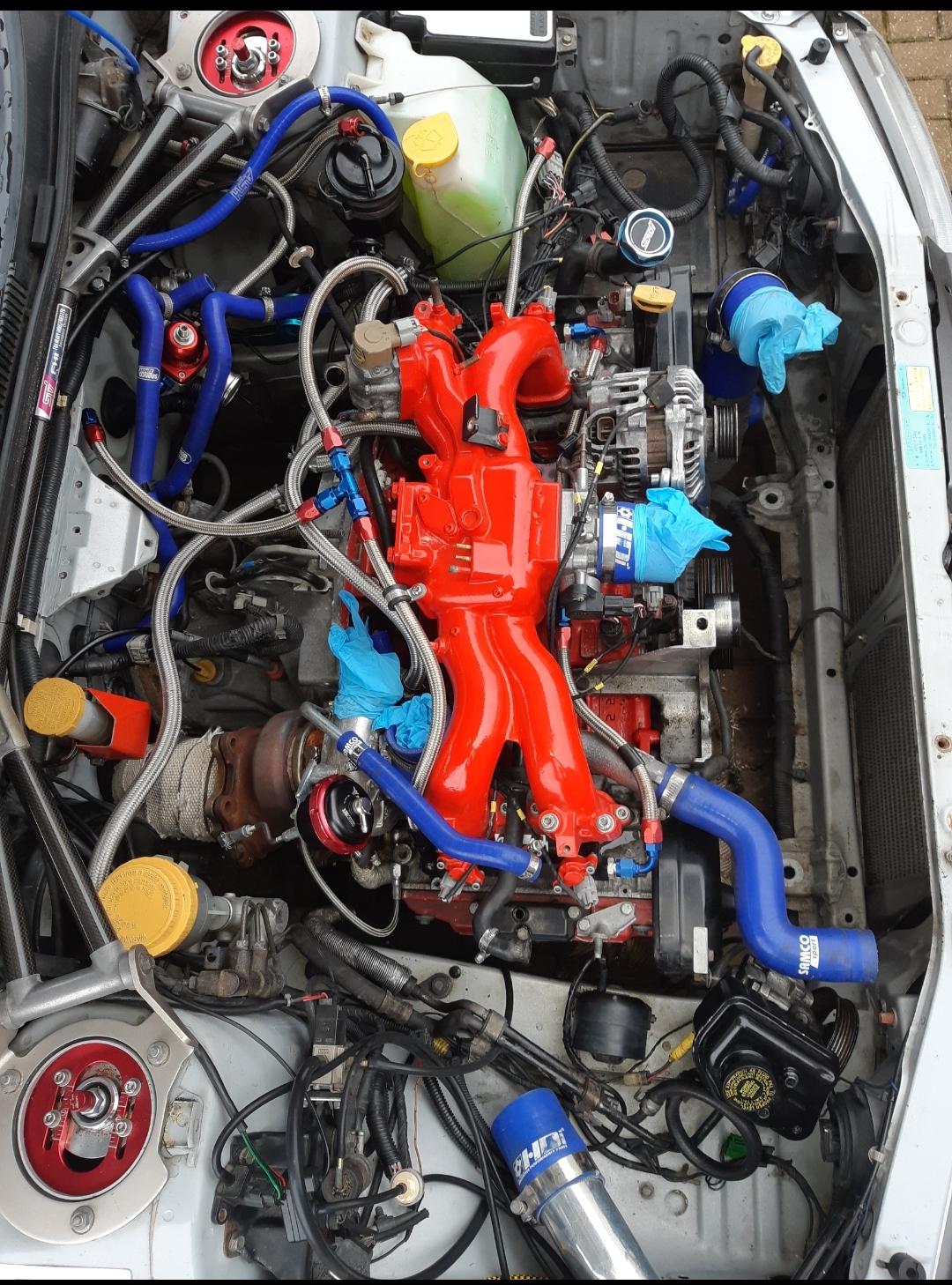

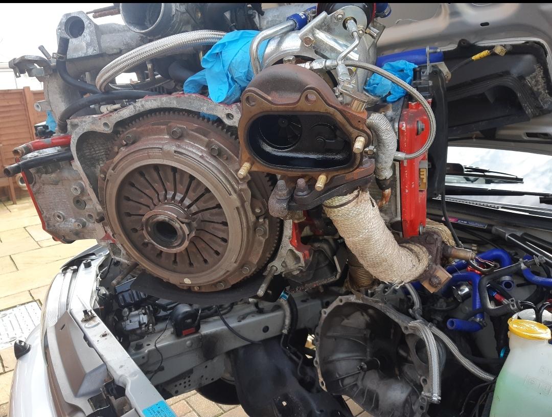

It's ready to pull apart from engine mount nuts and downpipe to center section . I'd normally have the engine out by now but I've disconnected everything between inlet manifold and engine too . As I will fit a spare bare old inlet to pull the engine out with ,so I dont scratch the shiny one 😉
Hopefully I'll be left to it tomorrow, get the engine out ,on the stand in the shed and start the teardown 🤞
As I'm hopefully not refurbishing the bottom end  , plan A is to fit the v4sti heads with new rcm headgaskets ,using the existing arp studs.

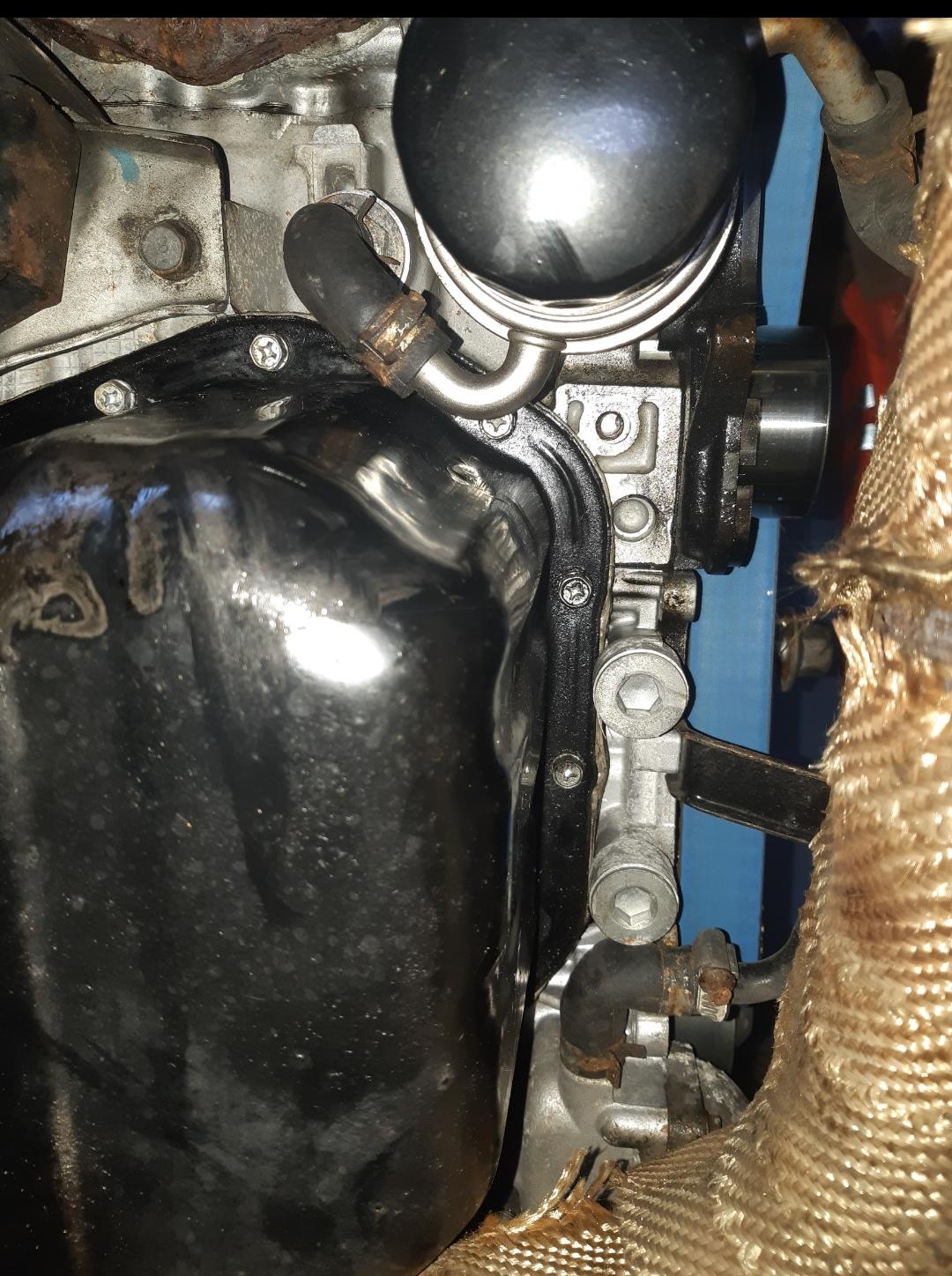

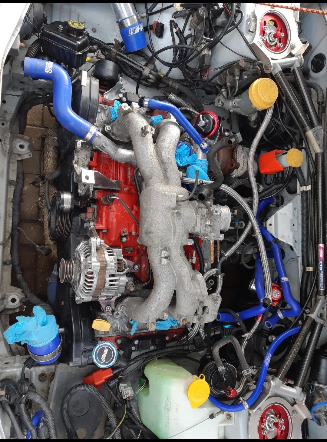

Removed the downpipe and any other remaining bolts on the underside of the scoob  .  Removed the reversed inlet ,fuel lines and engine loom , as I didn't want to contaminate the almost new fuel system or scratch the shiny red powdercoat .I fitted a old spare inlet to pull the engine with and keep the engine "sealed" ,while I strip and prep it in the shed this time .Screenshot_20200222-200714_Gallery.thumb.jpg.a66173b8ebb4bea1bd155ff987532de4.jpg

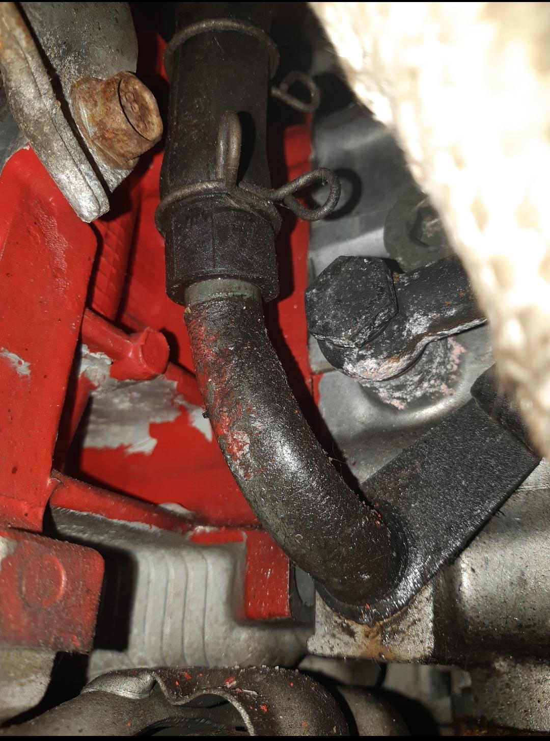

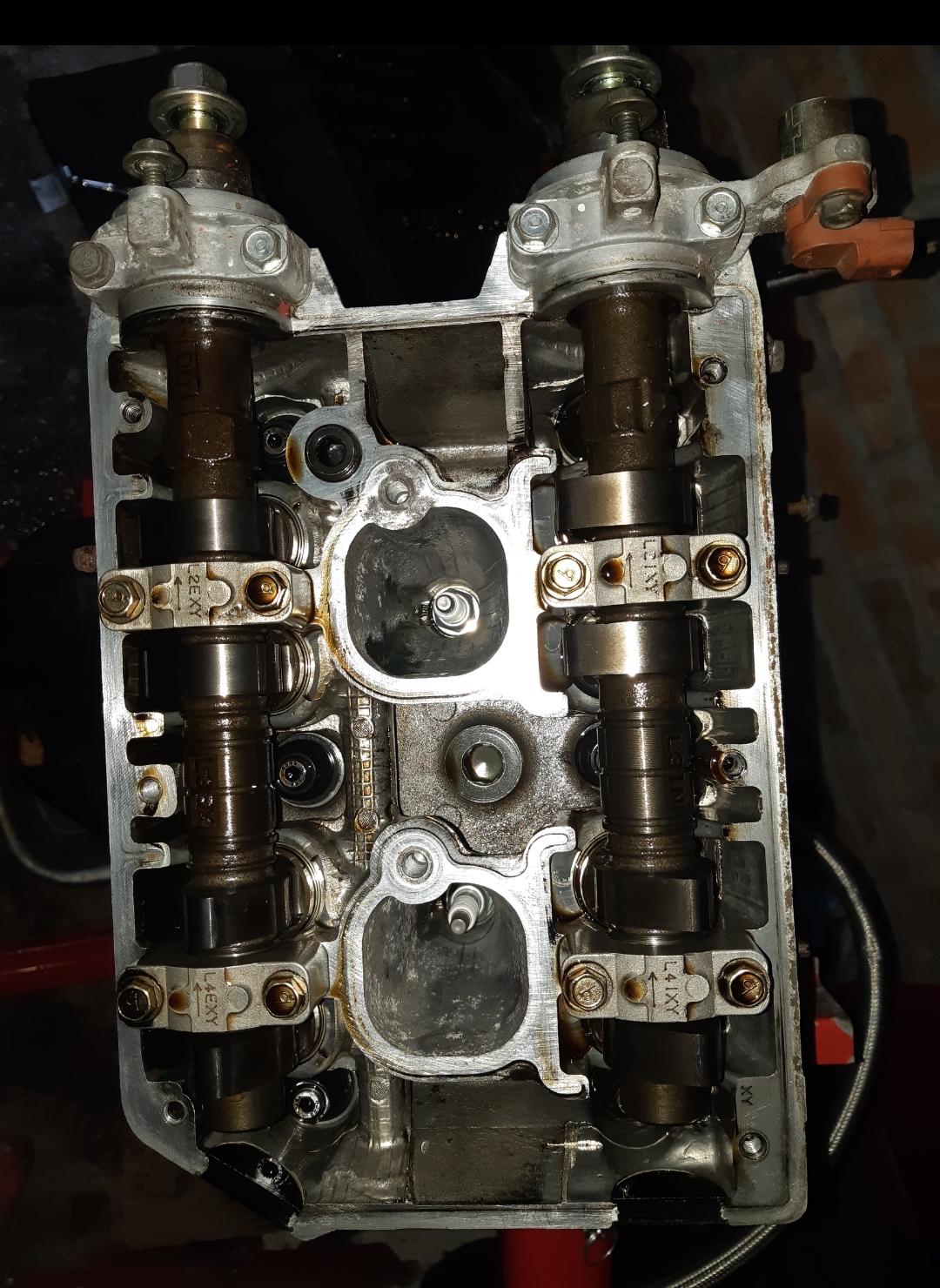

after 8yrs and 60k everything looks good with the cam cover off and the only oily bit seems to have come from the power steering pump or reservoir .
A couple of the head exhaust manifold nuts look like they're gonna be a mare to get off (well rusty) but they've been on there 5 hrs or so . The block paintwork has held up fairly well but well see if I get chance to tidy that up , once I've popped the heads off and know how much I've got to do internally.

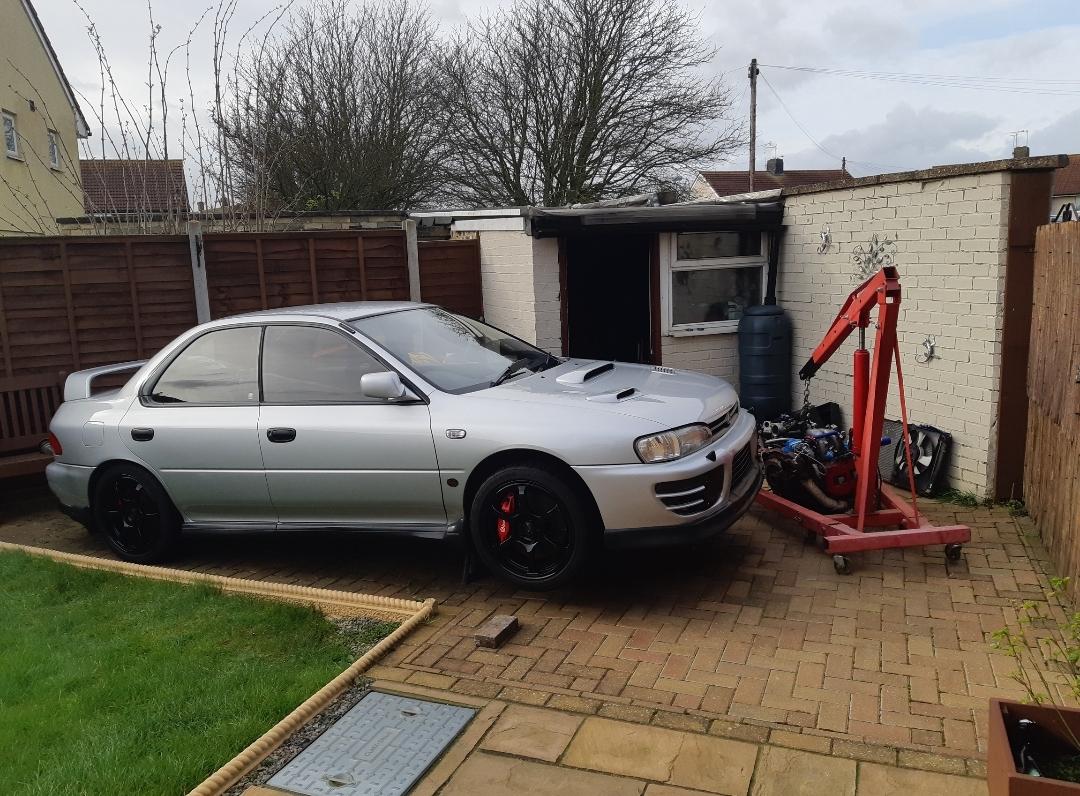

Seeing as I'm hopefully not touching the bottom end I'm gonna be stripping the engine down in the scooby scraps shed.
So I don't want to have inlet and oilways open for long , as the shed is nowhere near as clean as the wifes kitchen table 😊
First impressions is that it's not got any major leaks ,just a p.s fluid leak and small amount of cam cover weapage,  which isn't bad for 8yrs and 60k miles 😎

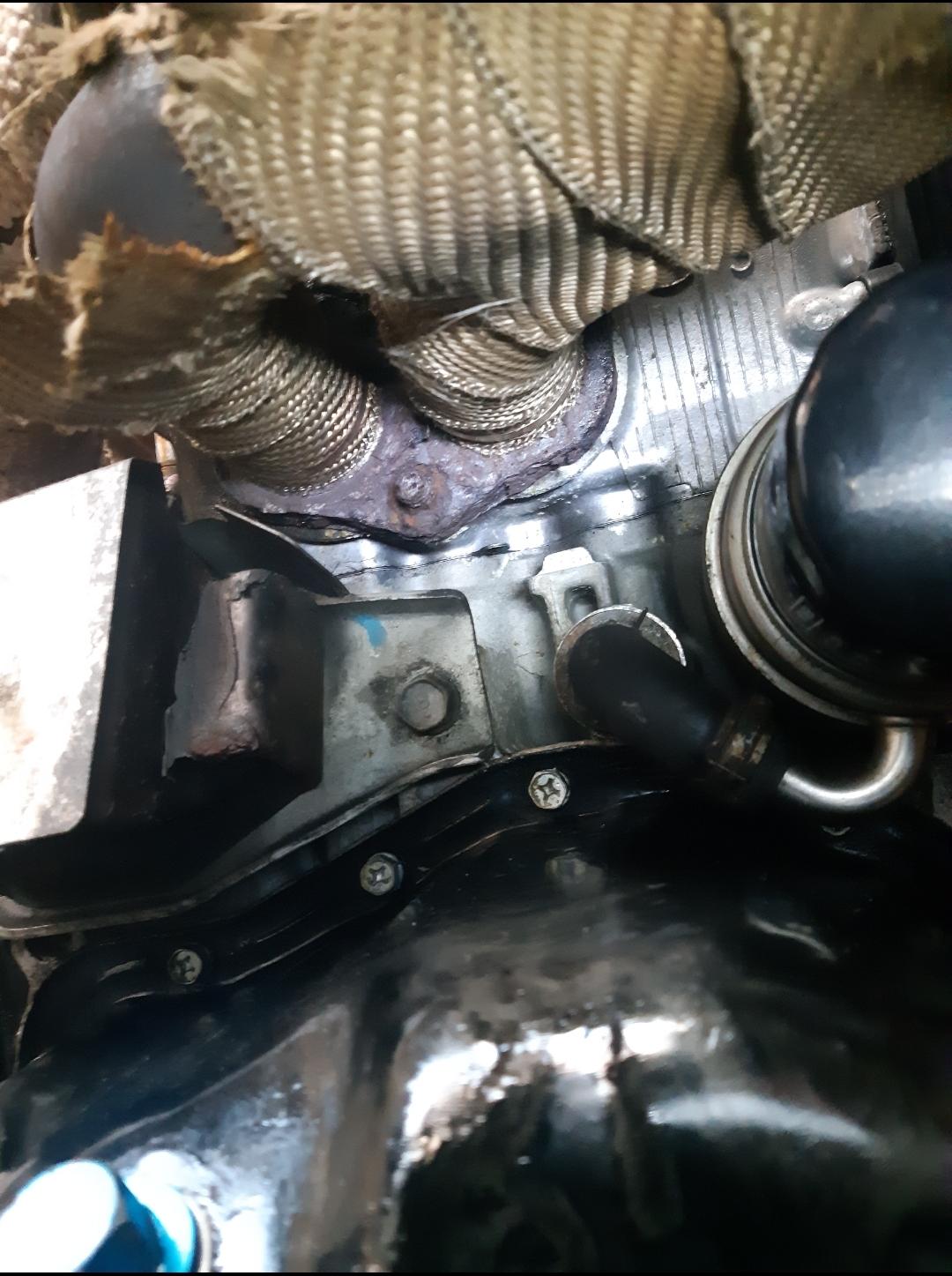

It took a good 3 hrs to remove the inner 2 exhaust manifold nuts but the grouppe headers were second hand when my brother fitted them 9 years ago , so hopefully they'll clean up with a grinder .

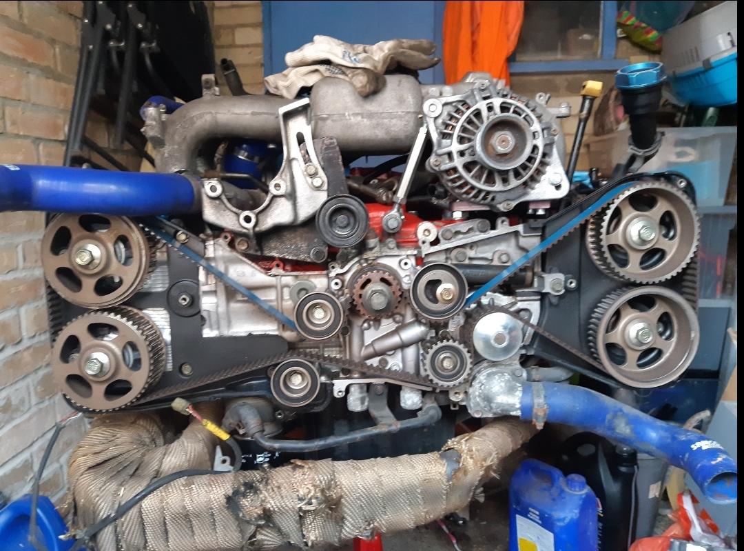

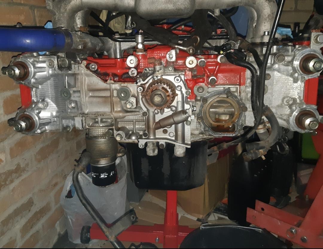

I'll be using the original v1 metal cam pulleys on the v4sti heads and fitting them with rcm headgaskets, full early timing belt kit (hydraulic tensioner), new water pump and new oe gaskets. So I stripped the long block back but have left the old inlet manifold on to keep the engine sealed , which left it looking like this at sunday lunchtime .

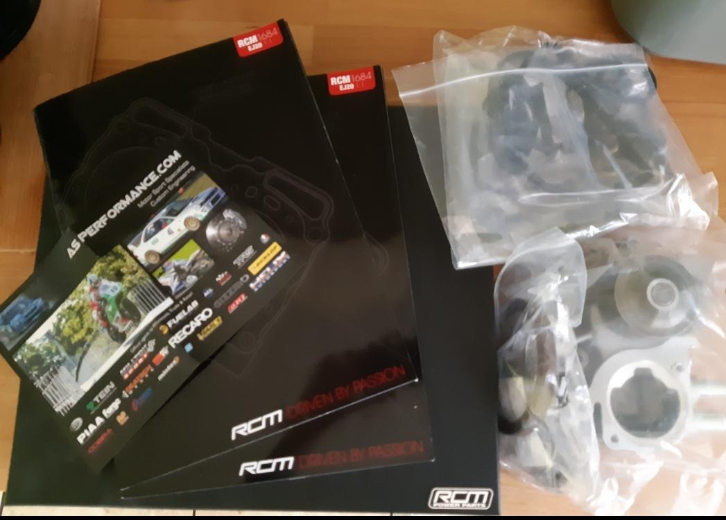

Had a big box of oe and rcm goodies turn up today ,  big thanks to Alyn at Asperformance for taking the time to go through my order on the phone and posting it all out so quickly 👍

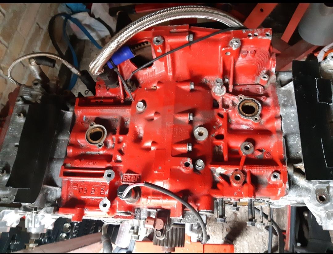

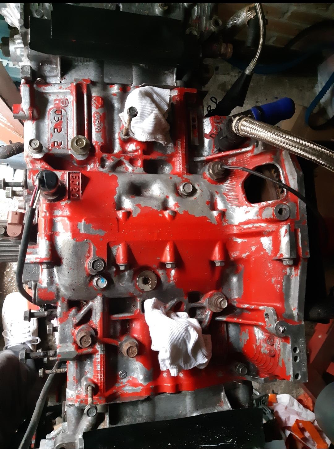

Made a bit more progress with the engine this week , stripped the old inlet , watercrossover pipe ect off the long block . Although the brush on etch primer /hi temp paint has lasted well , it has chipped/flaked in places and it makes sense to clean it up with the old heads still on 😉
About a hr later I'm starting to think ...
I did about another hour with the wire wheel after this pic but after cleaning the dust off the block , I'm pretty much gonna have to repaint the whole thing 🙄

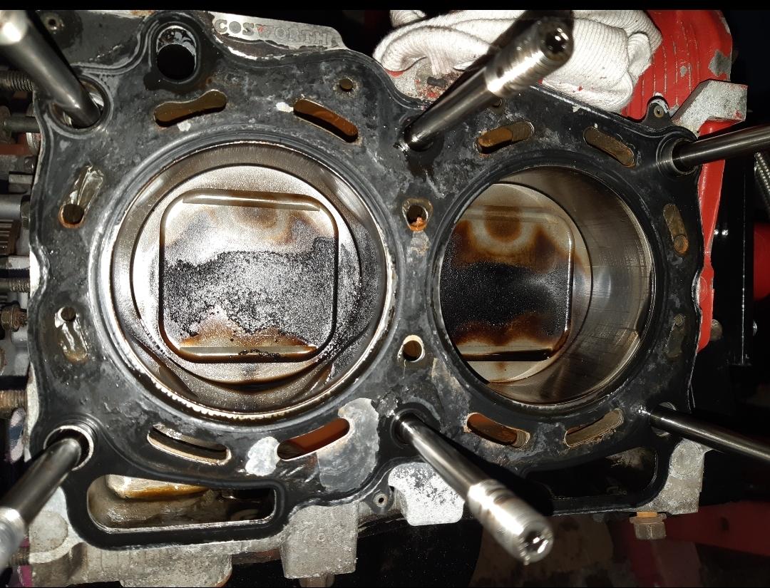

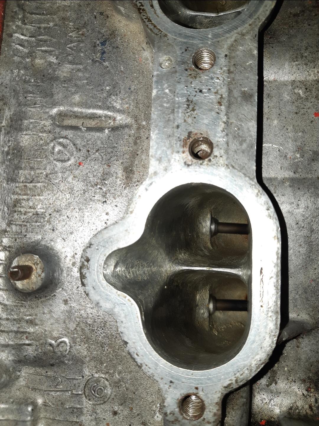

Once I was happy the block and shed was as dust free as possible I decided to pop one of the heads off and see how well the bores looked :tmi:
And .....although the scratches in the bore walls look bad the worst ones you can only just feel with your finger nail . I do try to keep costs down but dont do "corner cutting " so will now completely strip the short block , mic up the mahles and bores to see if I can get away with  a hone and new rings 🤞

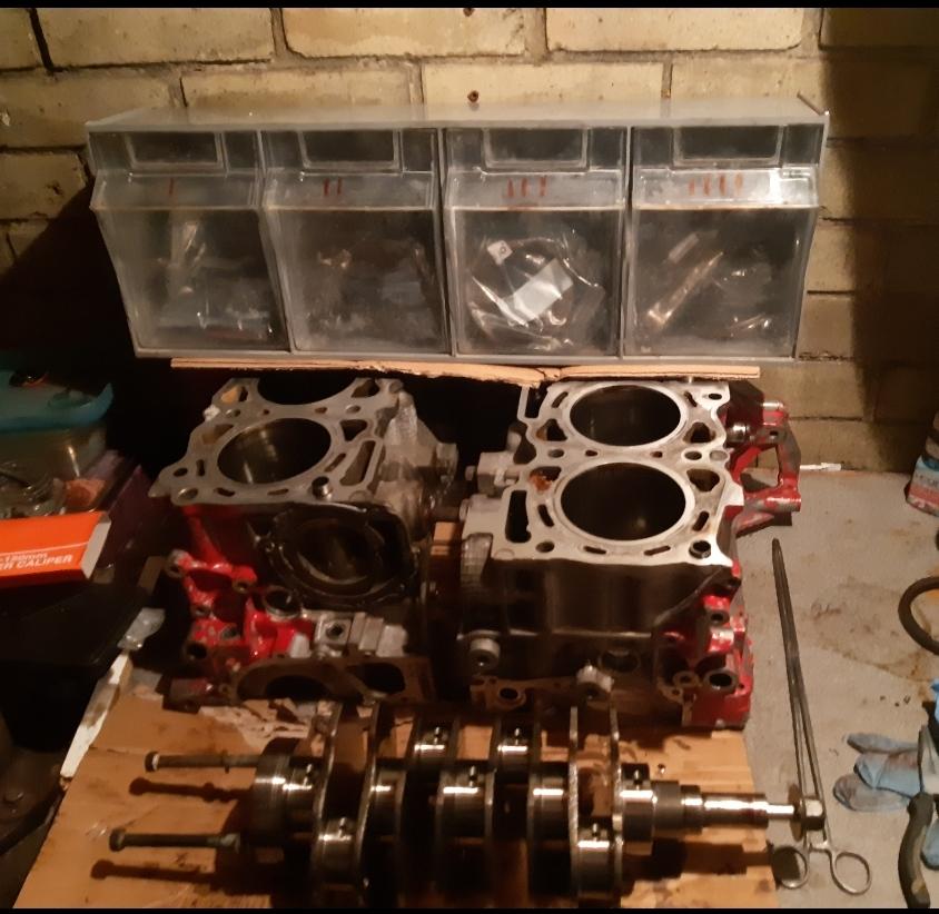

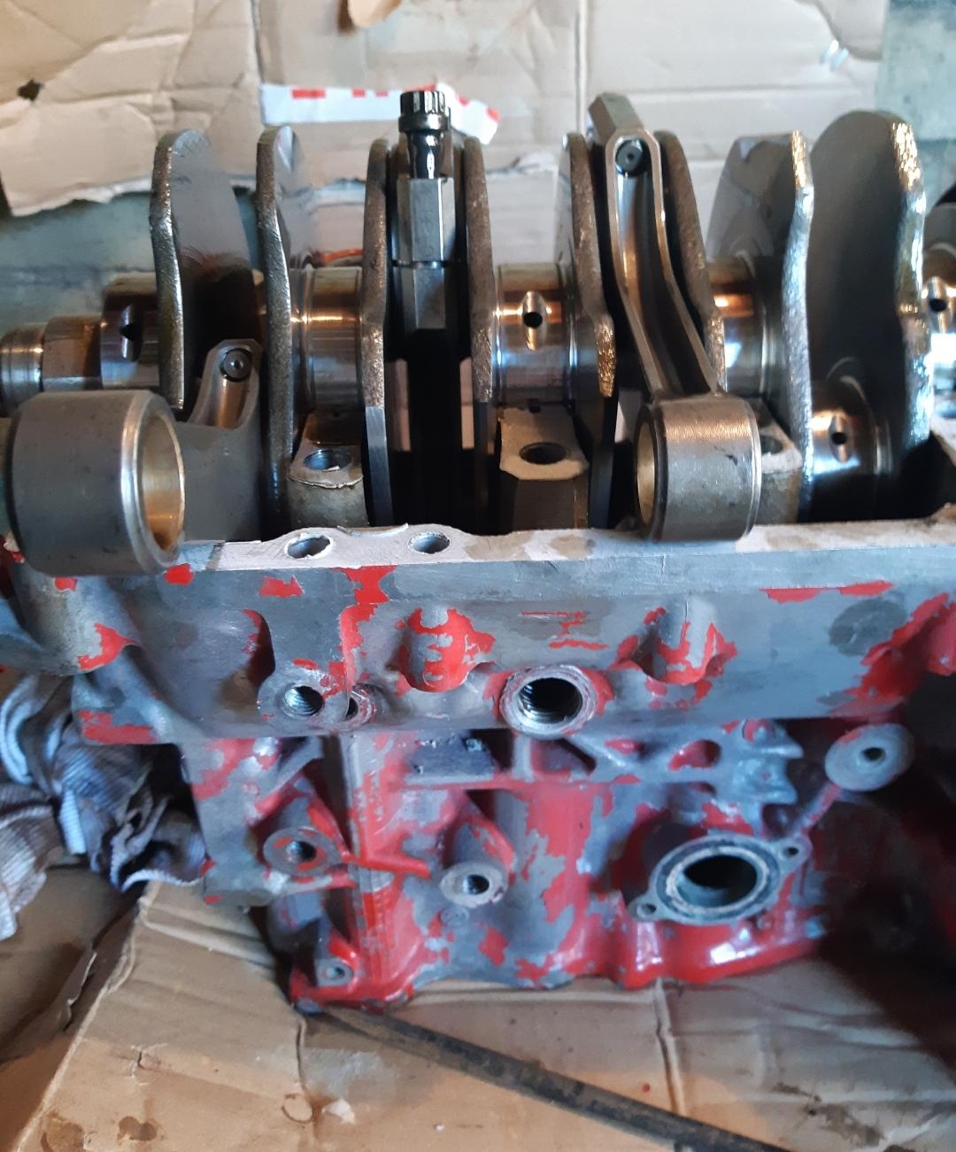

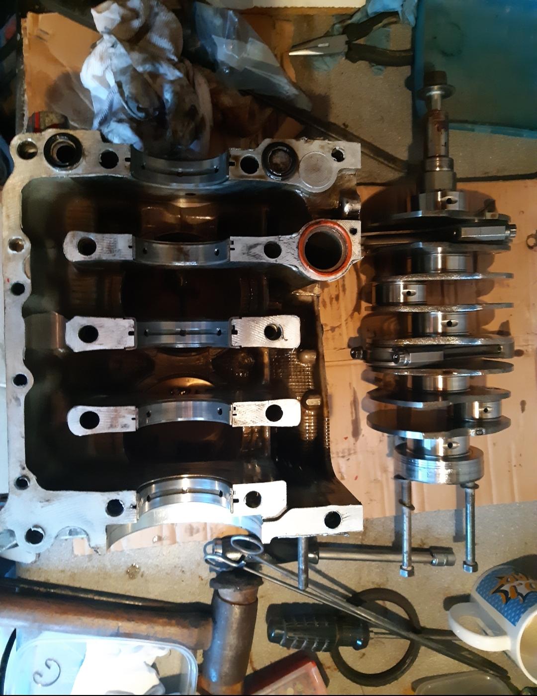

I tend to only use the wrist pin access holes for one bank ,then unbolt the end caps off the crank for the two pistons that are still attached . So block split and one half removed .
Crank ,mains and big end bearings all look good by I will be replacing the 26 year old crank this time .
 it's all ready to take to pat tomorrow for a check over . I'll bring it back and remove all the three bond though .I'll take it back again once I have the new pistons, so we can measure them and know what size bore we need with clearance added .
Well the bores might clean up but the piston crown edges have a few heavy scores , the original honing Marks are all there ,without any sign of uneven wear or excessive wear .
 it looks like it was running well then maybe debris ,from drilling out the snapped inlet manifold stud last year  or a recent drop in oil pressure (at the  top of the pistons) is to blame .
As oil pressure readings and levels haven't changed and the car was running well but hey every cloud and all that ....
