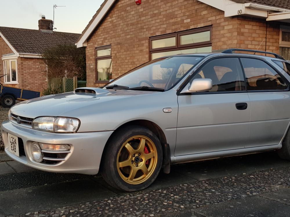

Cheers , center caps are a bit faded but the wheels are fairly mint otherwise , the mate i bought the bug off said they were fairly rare ?
Not that it matters , cos they do suit the car well imo

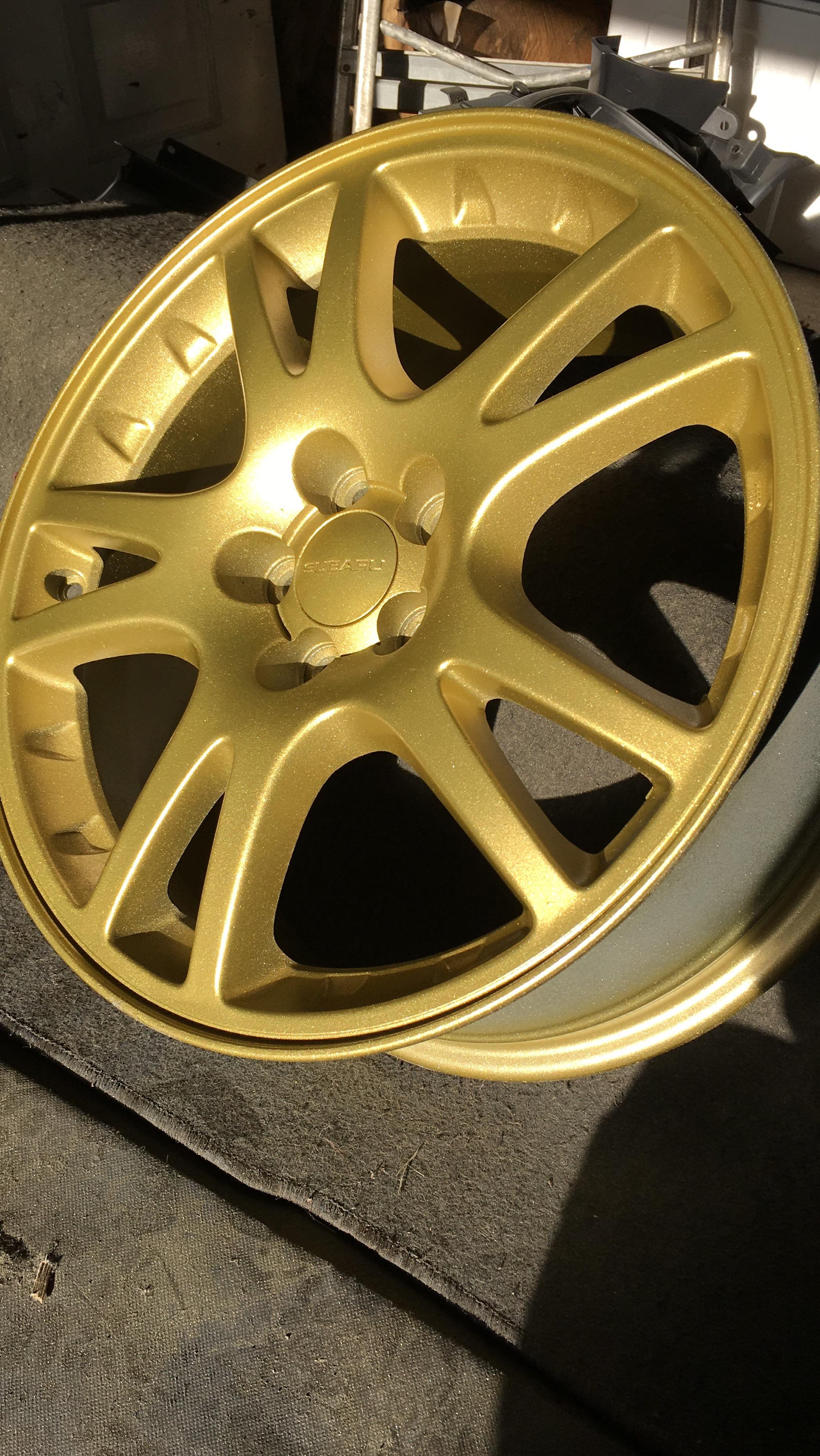

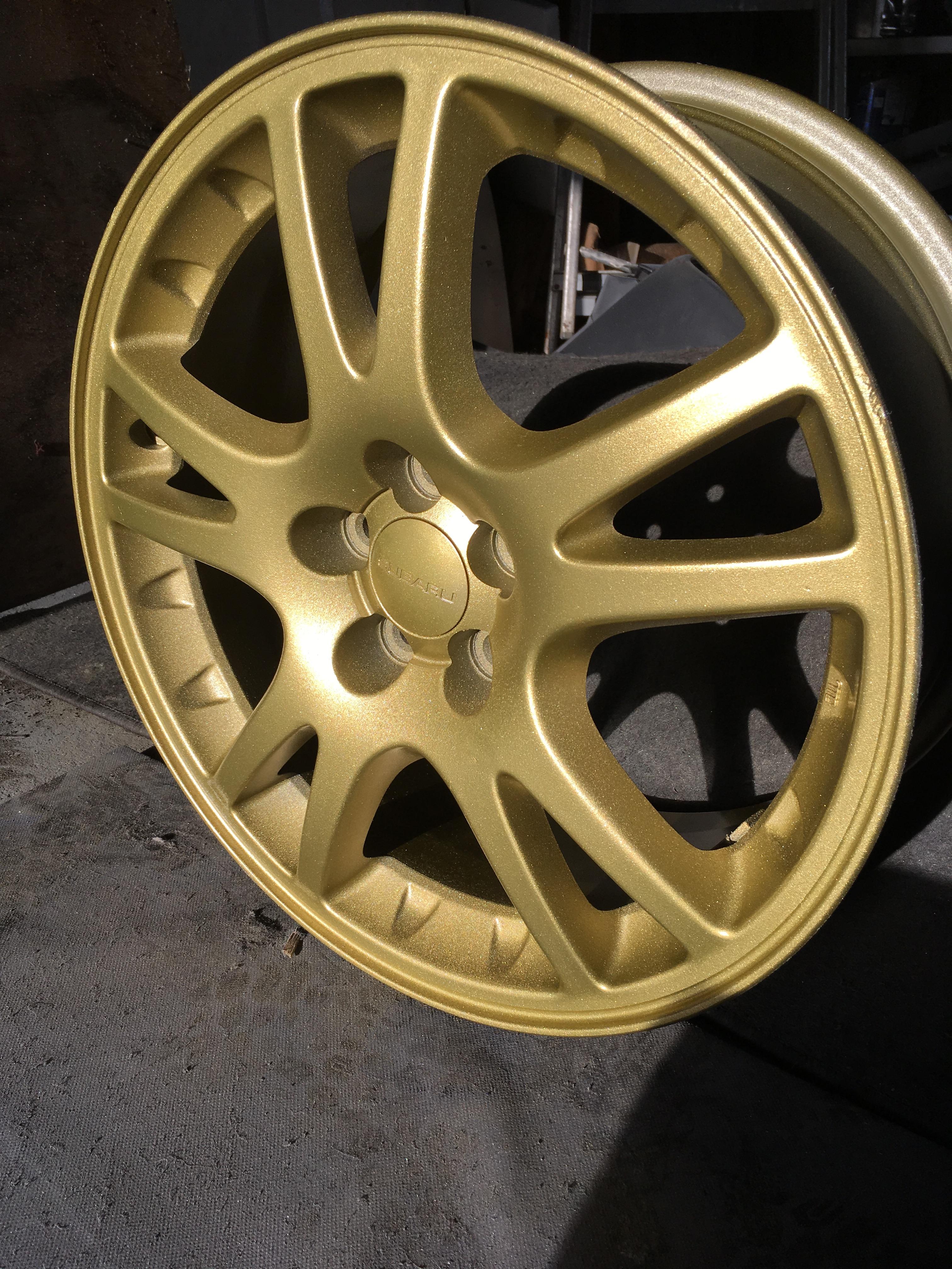

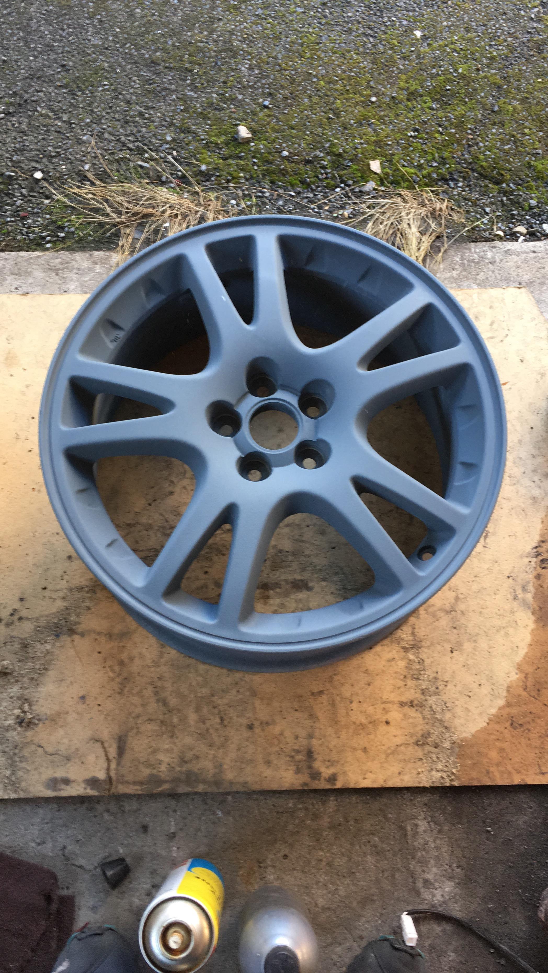

Did these wheels myself. Bought them for £150 with chips and marks all over.
Acid dipped, sanded and smoothed the kerb marks out. Bought some GTpro alloy primer and GTpro gold paint and GTpro laquer.
3 coats of primer, 3 of gold and 4 laquer.
