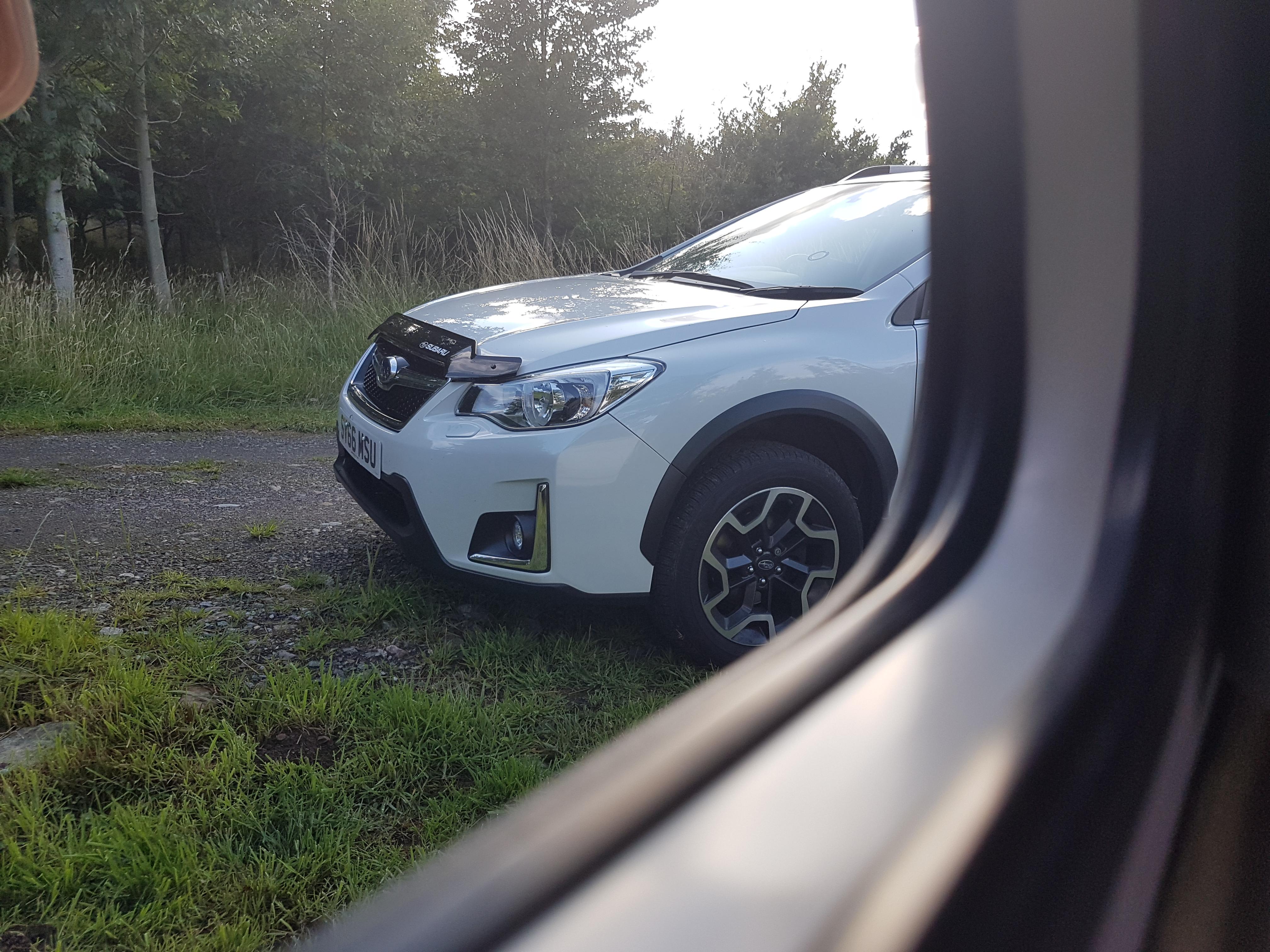

Seems to be helping so far, and we've def less bug splats!
Threw me then, I thought found my car! 😂
it does help protect the bonnet from bug splats

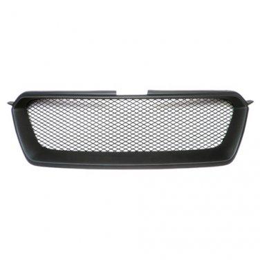

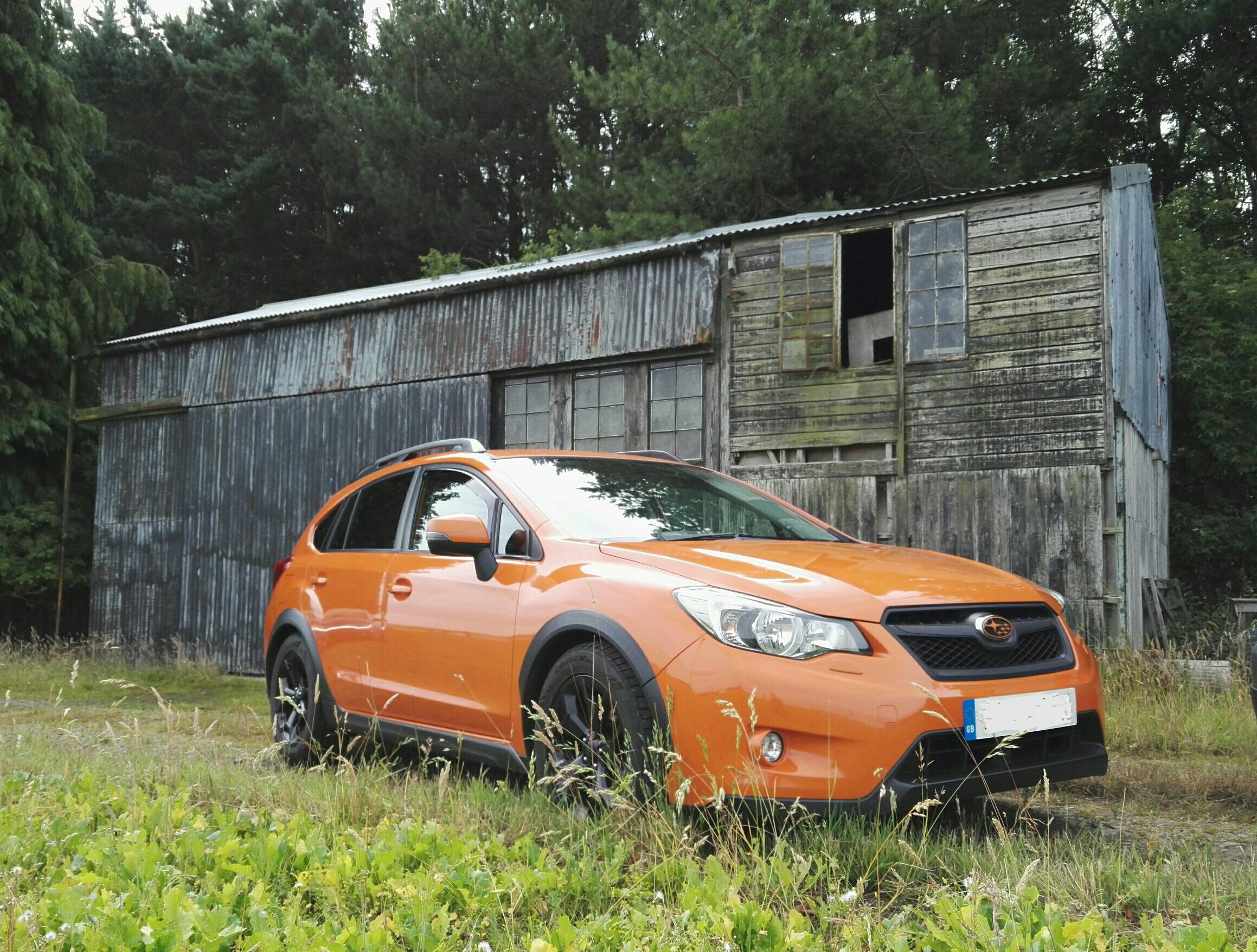

Looks even better if you dechome it 😉
Yes it does look better without so much chrome, I agree.
Maybe I will do something with that, but it's a couple of weeks since I fixed the paint chips, so Scoob will meet the rupes big foot polisher now the paint will have hardened enough first. There is a grill which is all black, and quite sporty looking 543875ea25cce_67110n.jpg.023a2c3943016d9eabf5b92b2e7a2e34.jpg
And bonnet to match .
I'm sure we could have much fun with the XV.
I was even thinking a water spray on the turbo intercooler like the old sti/wrx had would cool the air more and increase its mass, thus could be a fun hidden mod too...TB2vsmSXV6AQeBjSZFFXXaiFpXa_!!412962909.jpg.43ecfda02b268655c8c03058695add66.jpg

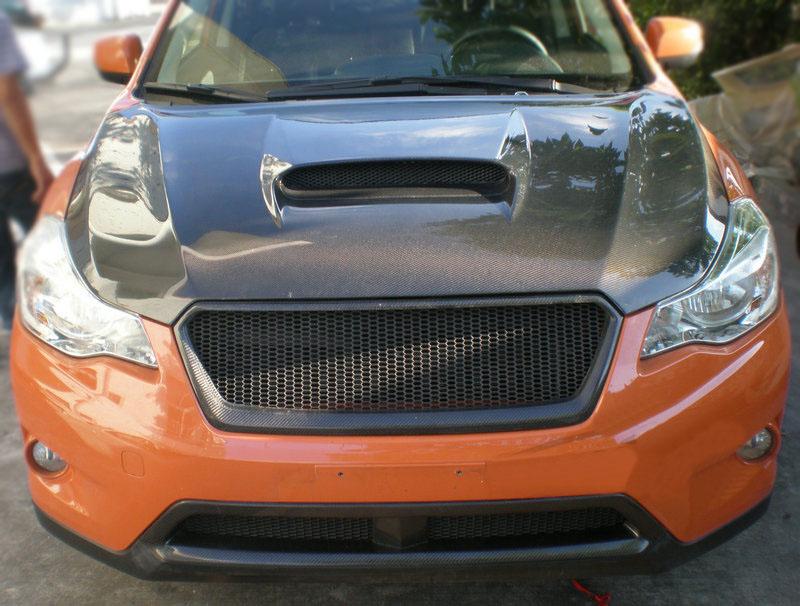

Aberdeen Chris,
I've been eyeing this grill bonnet combo for ages now, i just feel like its a shame to have a top TMIC and not have a scoop!
If i did buy it i'd be getting it painted orange to match the car though. not a fan of random Carbon panels.
Biggest issue stopping me from buying one is that I can only find it from China / Alibaba type stores and that I cant be 100% sure the scoop actually goes through or if its just a gimic with no airpath behind it!
If anyone feels like getting one of these maybe we could club together and get a group buy?
@Aberdeen Chris if you want to loose a few days of your life looking at diesel mods.... then click the link...
http://www.cardomain.com/ride/3998684/2010-subaru-impreza/
Lol,
Maybe. Although the airflow to the intercooler may not be as good with the mesh grill, and if the bonnet has the scoop does have the open airflow, I wonder how that would integrate with the ducting already in place under the bonnet.
However the XV's bonnet is heavier than on any of my previous subaru, which may have been made not from steel... Also I think it is quite a structural component in the event of a frontal impact, so an alternative one may not have the same strength...
But a scoop does suit the car 😁

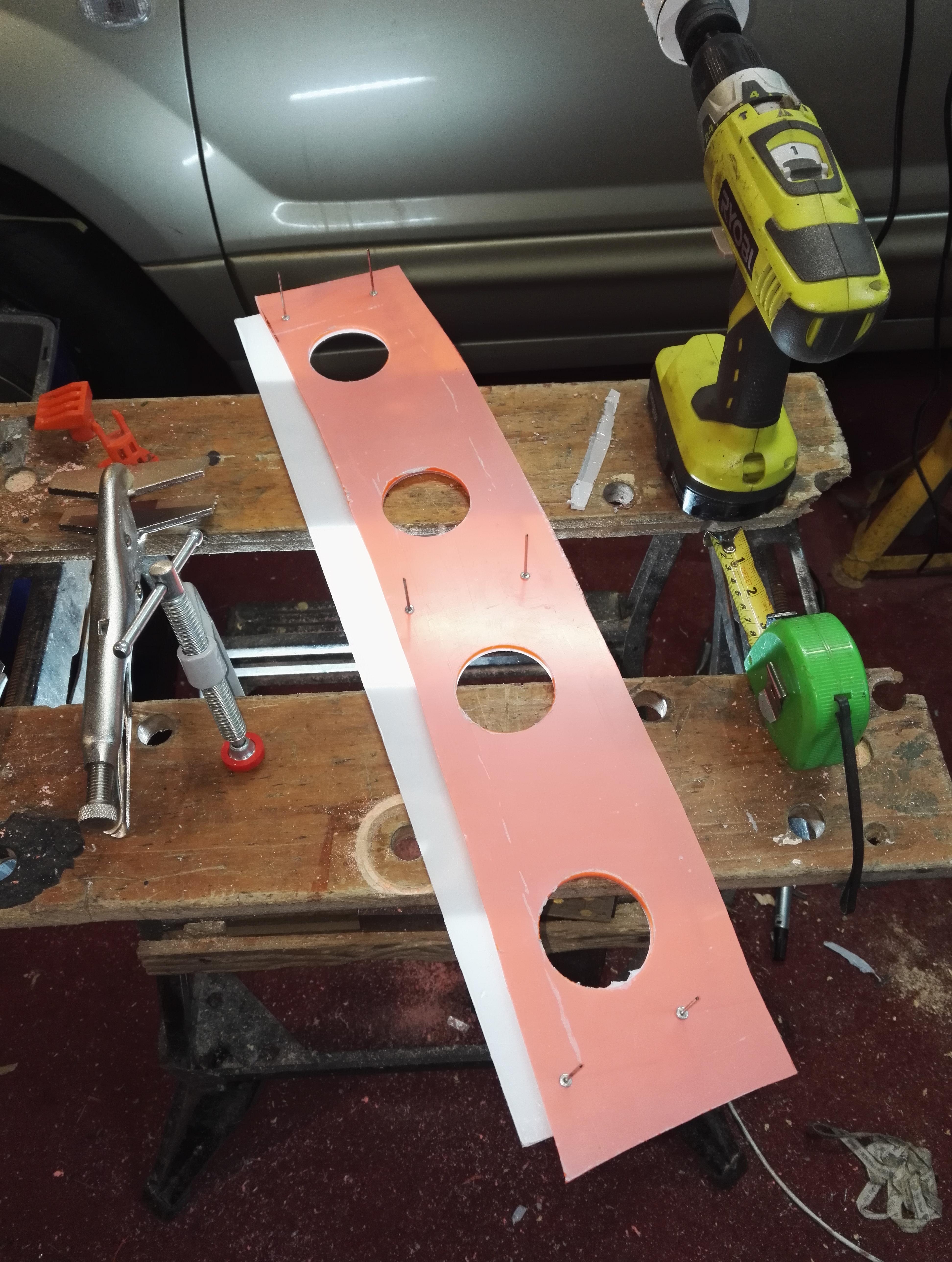

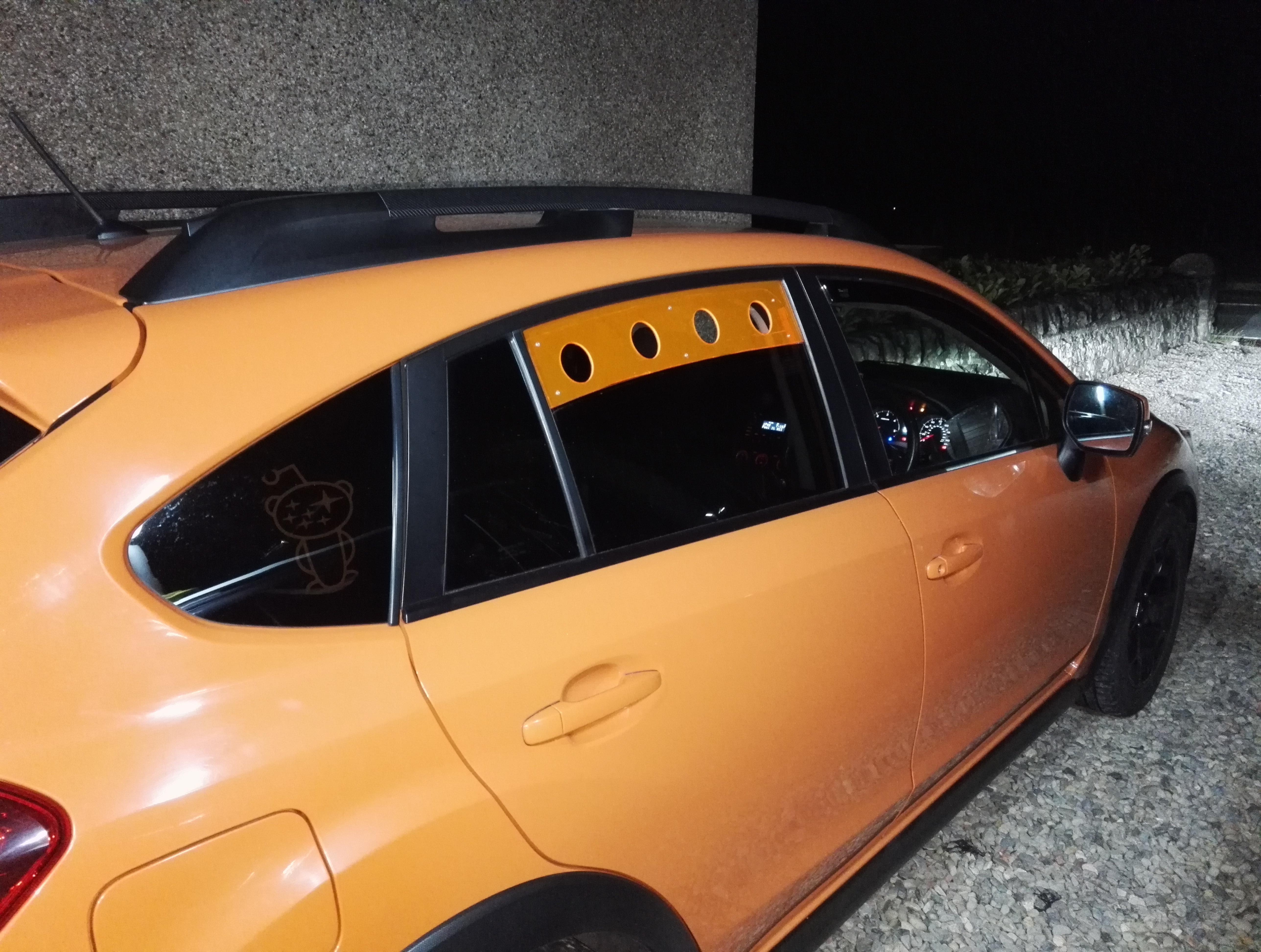

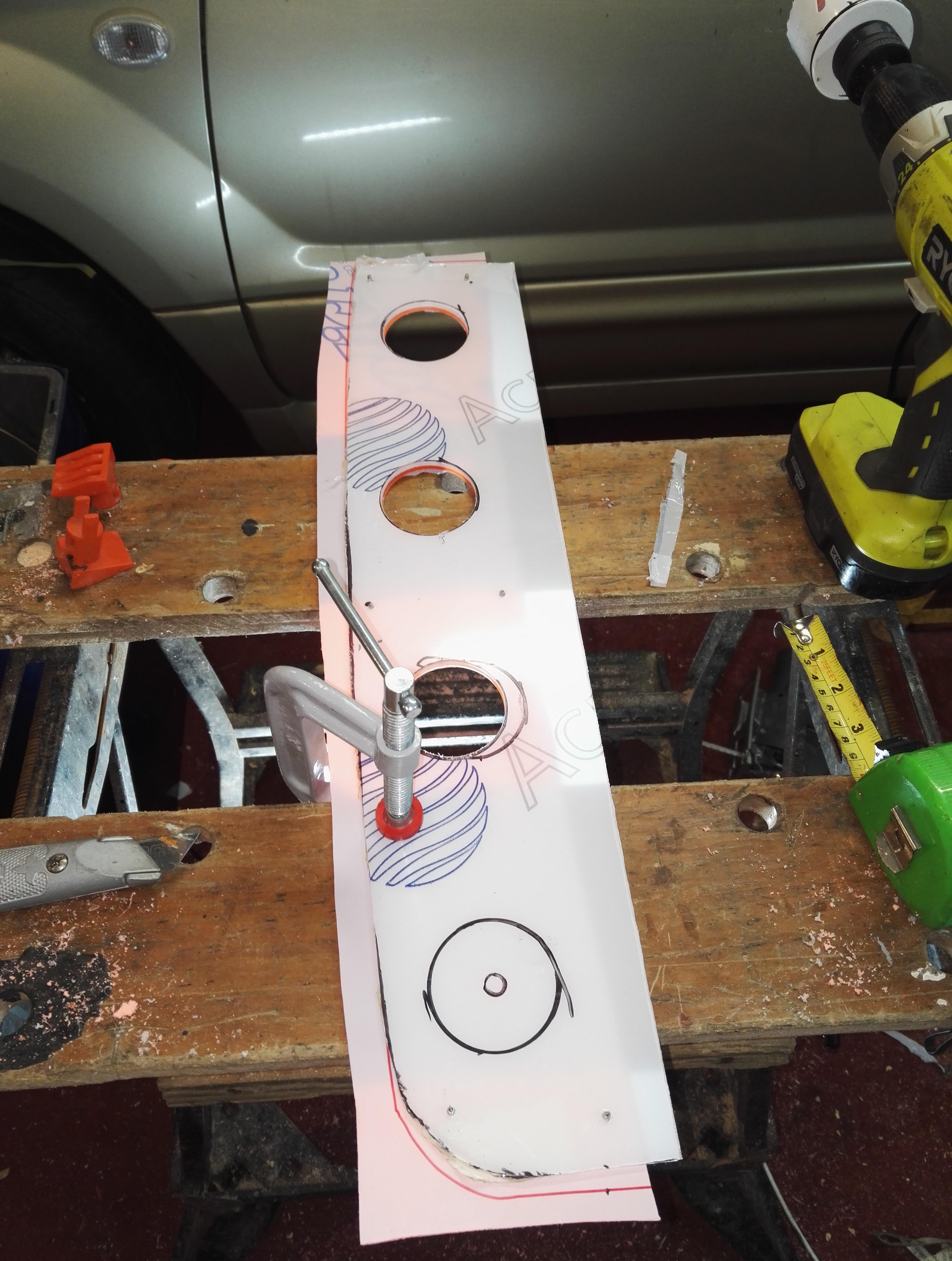

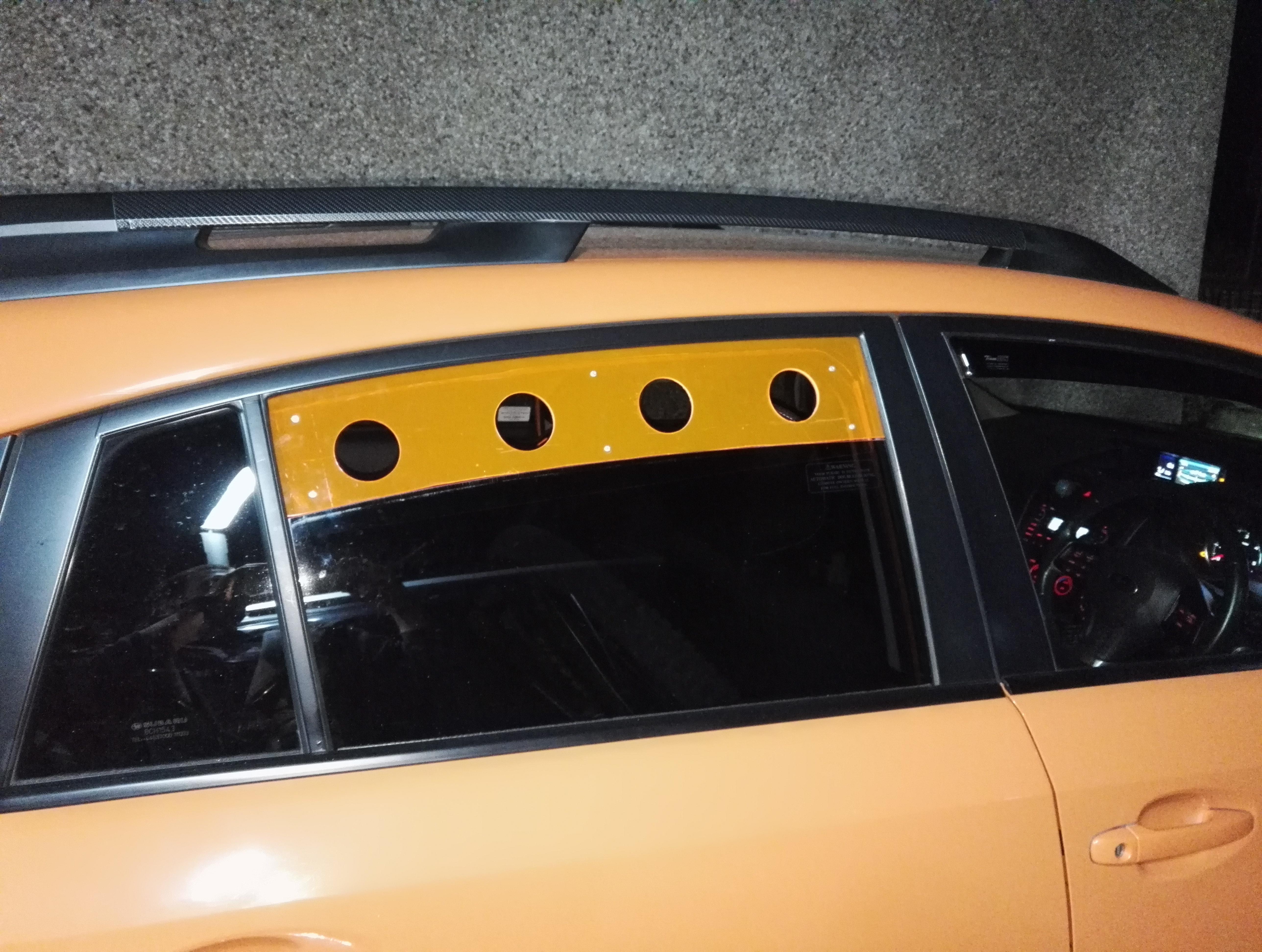

I built myself a rally window hole thing.
Always liked how these looked on Foresters , but couldn't see any in Europe to buy and didn't want to spend $$$ to get them from America. These are definitely form over function but could be useful if i were to put a piece of insect mesh between the layers, for camping ventilation if you were sleeping in the car.
I was also considering putting in a 12V fan and connecting it to the Auxiliary to get some airflow through the car.
This one turned out OK, but there are a few cracks and chips from cutting, and the pressure from the rivets caused one of the holes to generate a crack, so some other fixing might be better.
Think i'm going to see if i can get a trace of the shape and get one cut on a laser cutter/etcher so its smoother and neater than my Jigsaw job. IMG_20180806_221425.thumb.jpg.adf8ca8aa5bd777d7d4ae450a01b33a0.jpgIMG_20180806_221915.thumb.jpg.5954220961659203b2e0eb48cad0ad46.jpgIMG_20180806_224545.thumb.jpg.8810564974b6815d8c5d78c027c9cb10.jpgIMG_20180806_224647.thumb.jpg.0cb6e1c2723d5a7308d2c173a8bcf789.jpg

I’m not sure I’d go with the orange, i reckon black or clear might be more my taste. You might be best bonding it rather than riveting, as you say rivets creat a lot of stress on the plastic.
have you been out with them fitted becayse I have a sneaky suspicion that they will howl like a banshee 😂
you’ll have to let us know how you get on.

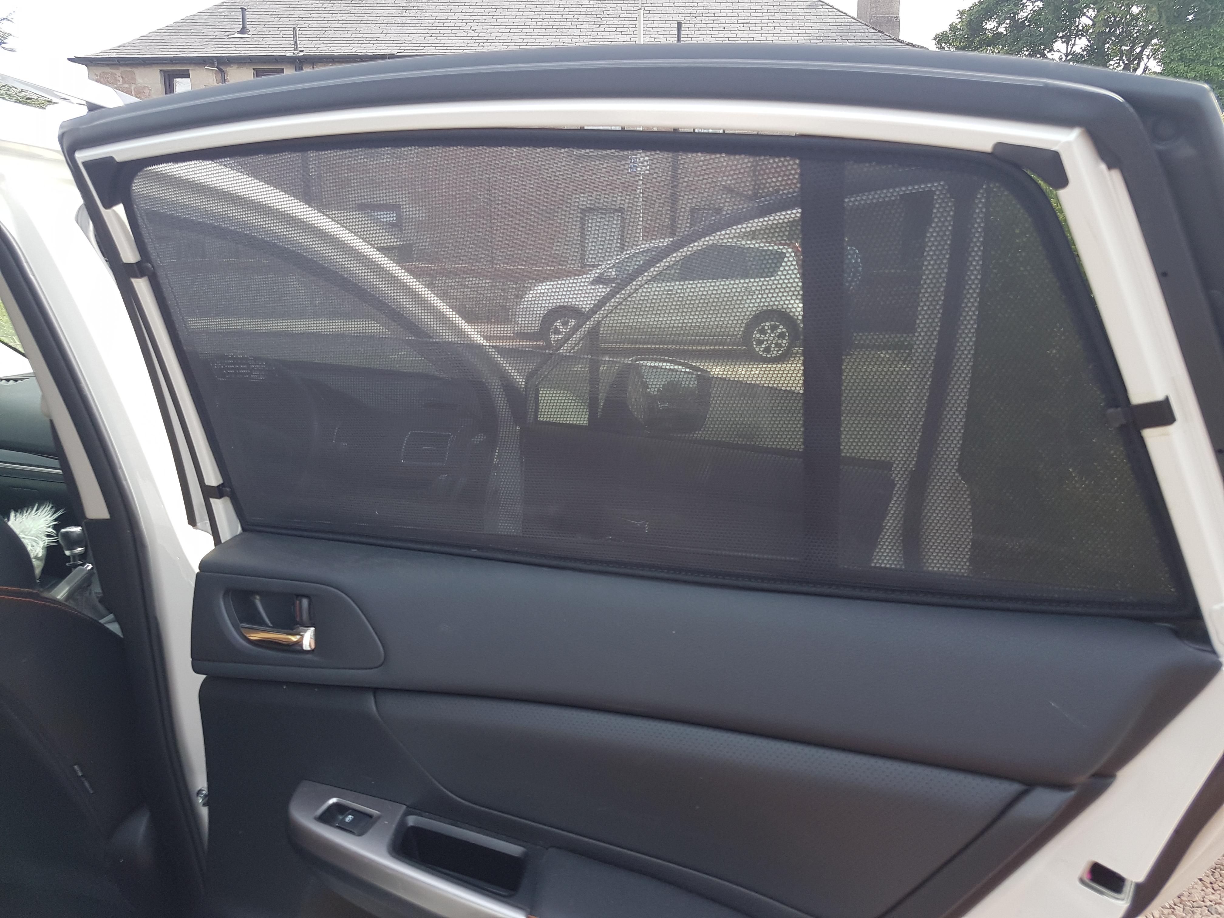

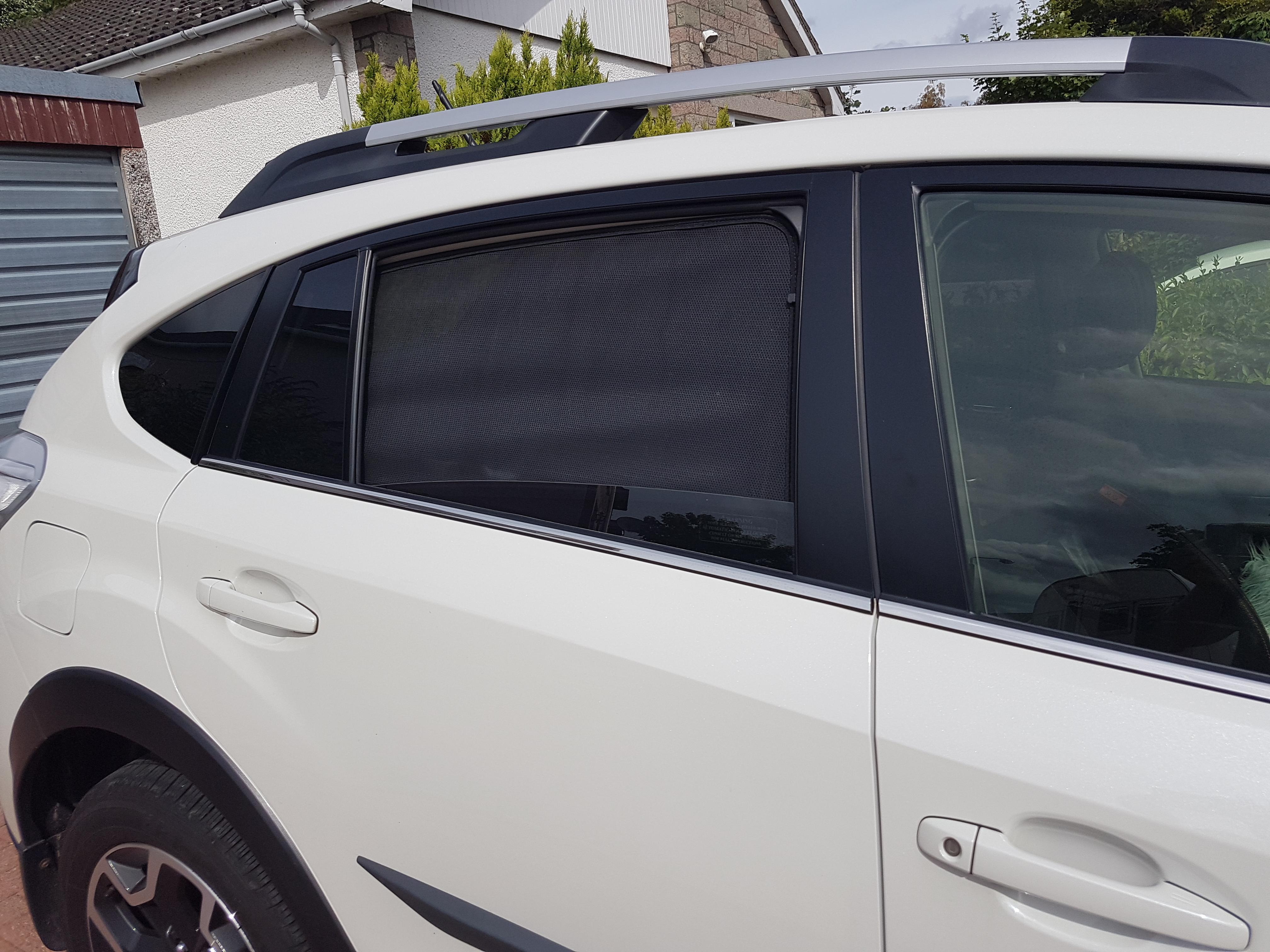

15336508776228975034721850605988.thumb.jpg.84f134bc3ef4febad8bca16674259a11.jpgI got these, negotiated when buying the car.
After a couple of years use and offer windows fully open, they have not even sagged. They keep besties oot too.

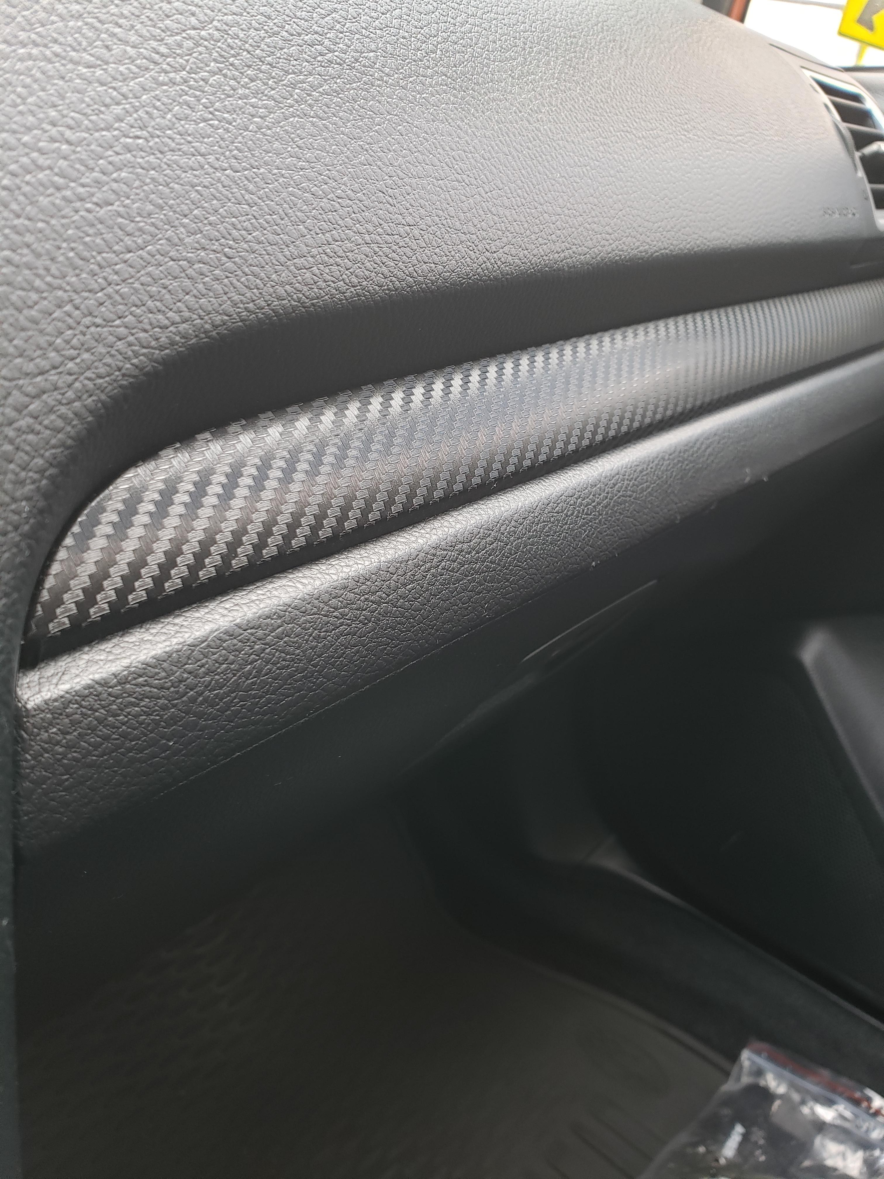

Doing some interior work.  Decided to wrap the aluminum look trim pieces in my XV.  Its pretty easy and looks much better.
