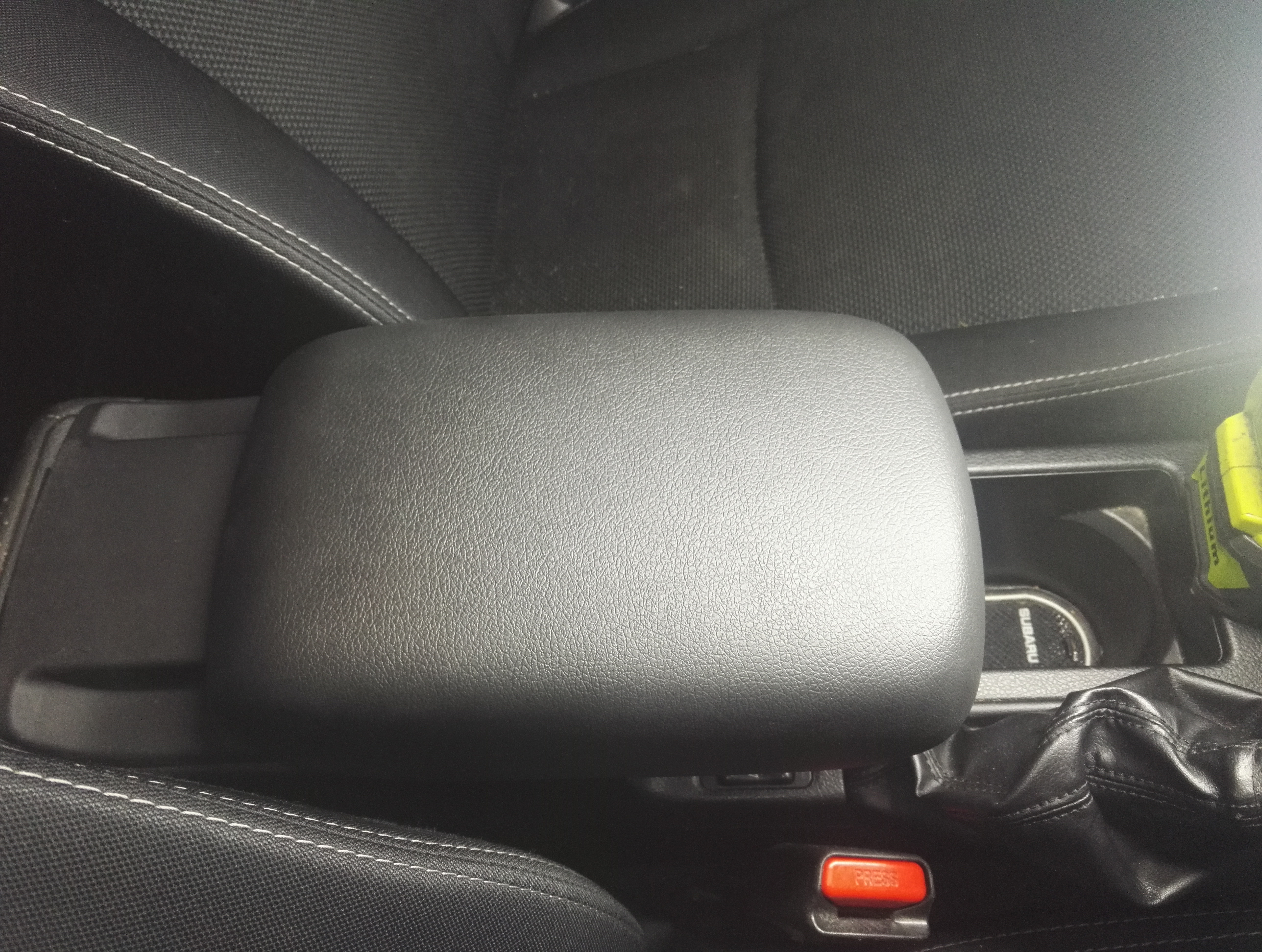

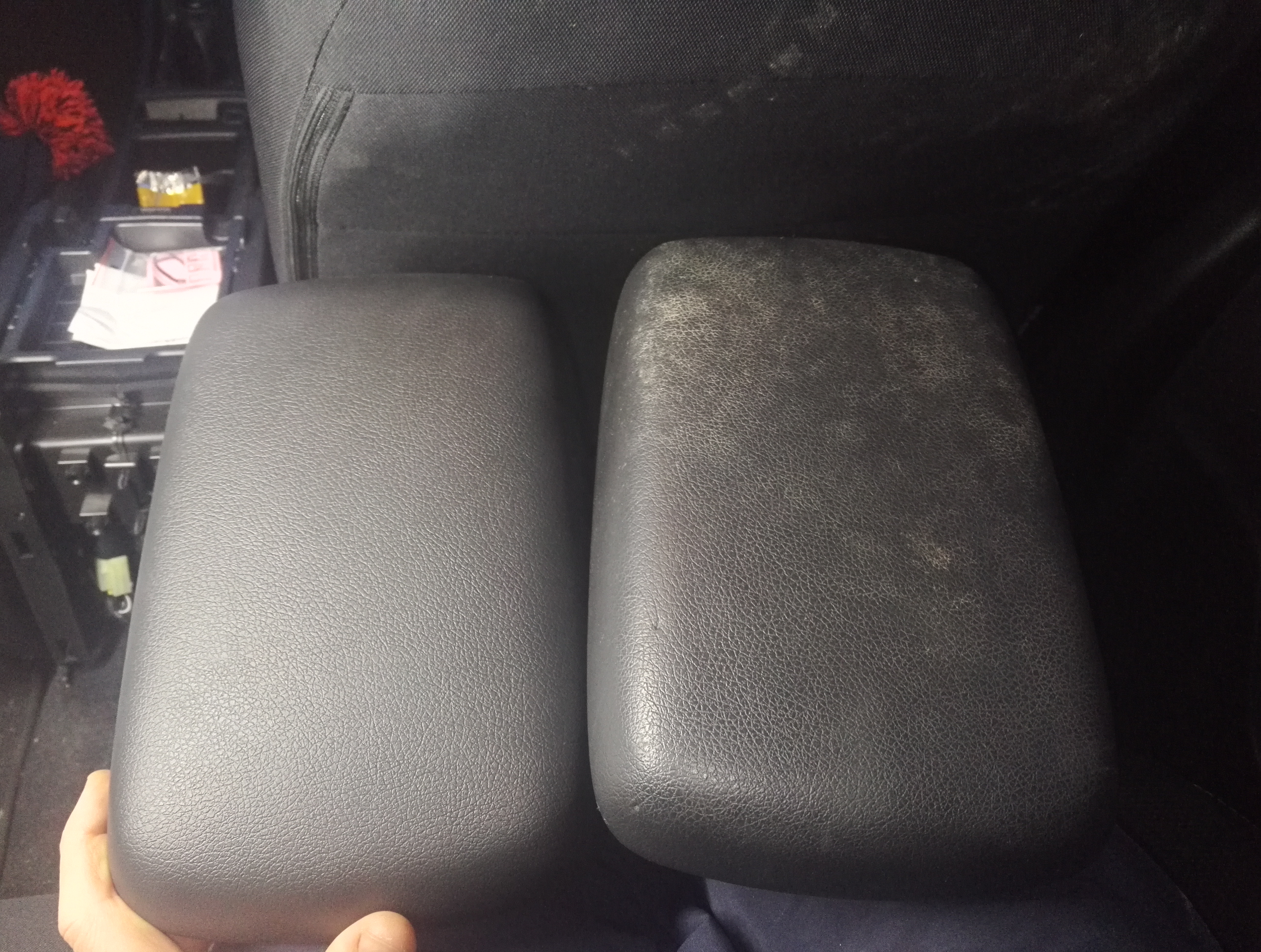

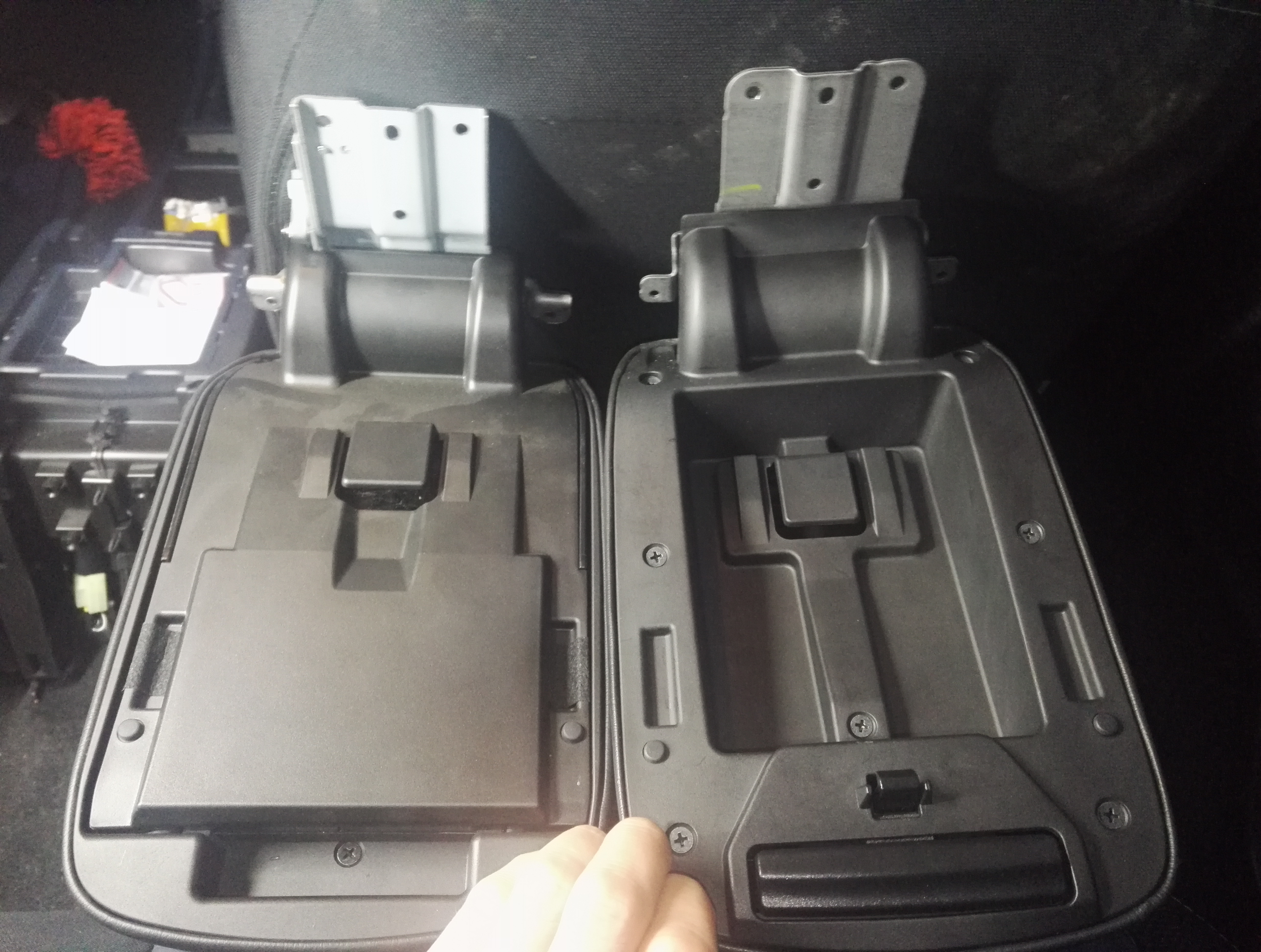

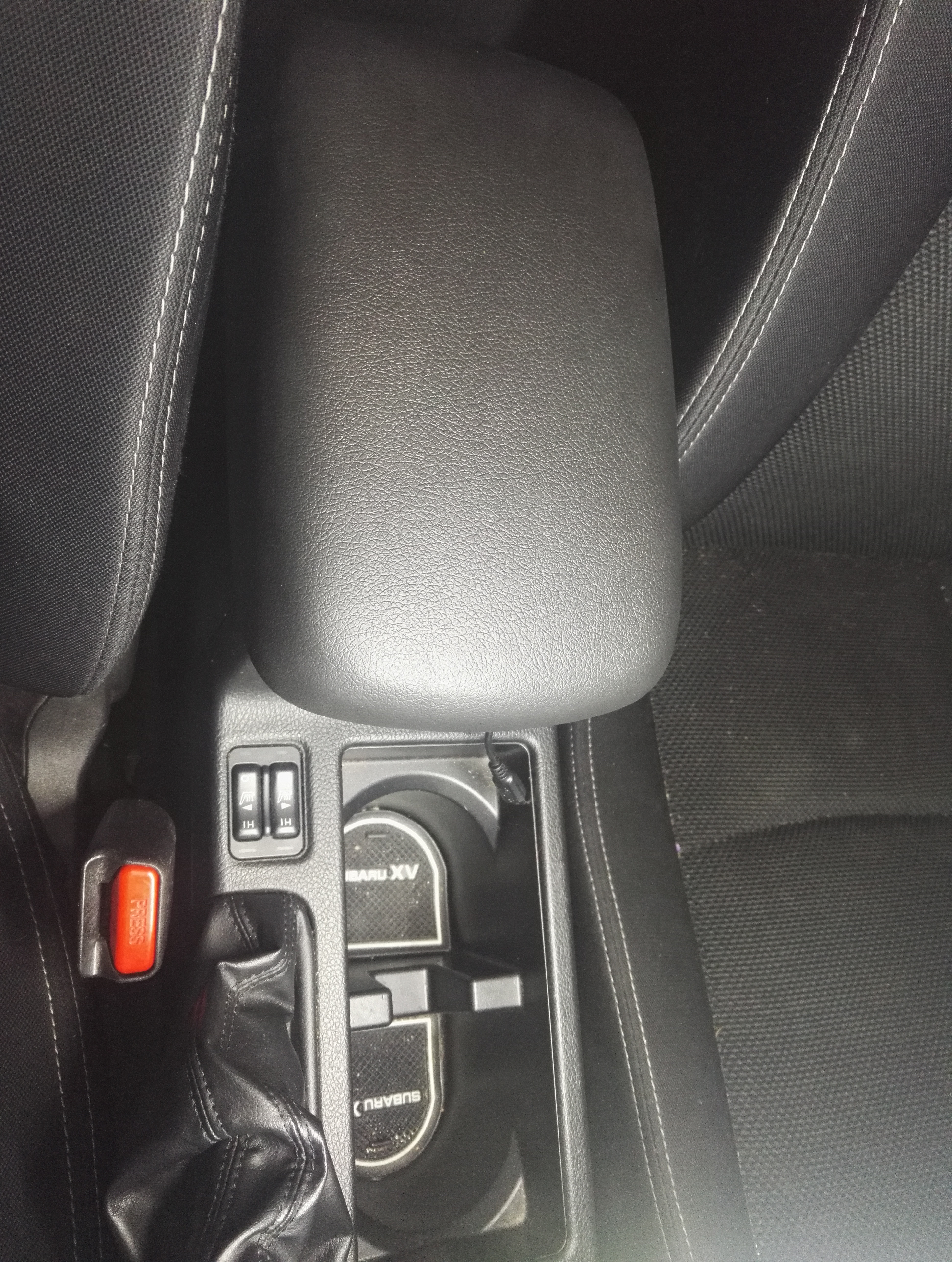

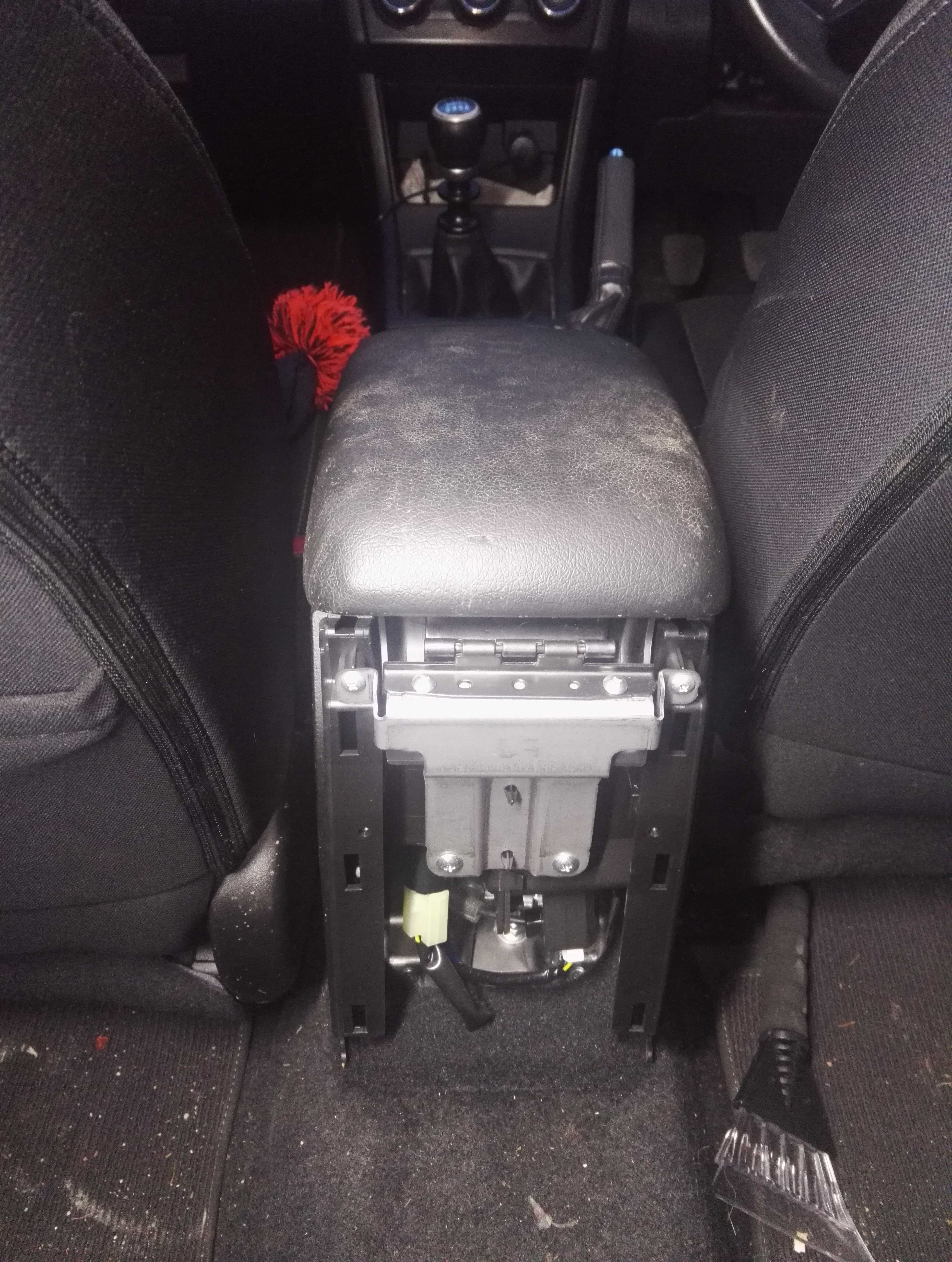

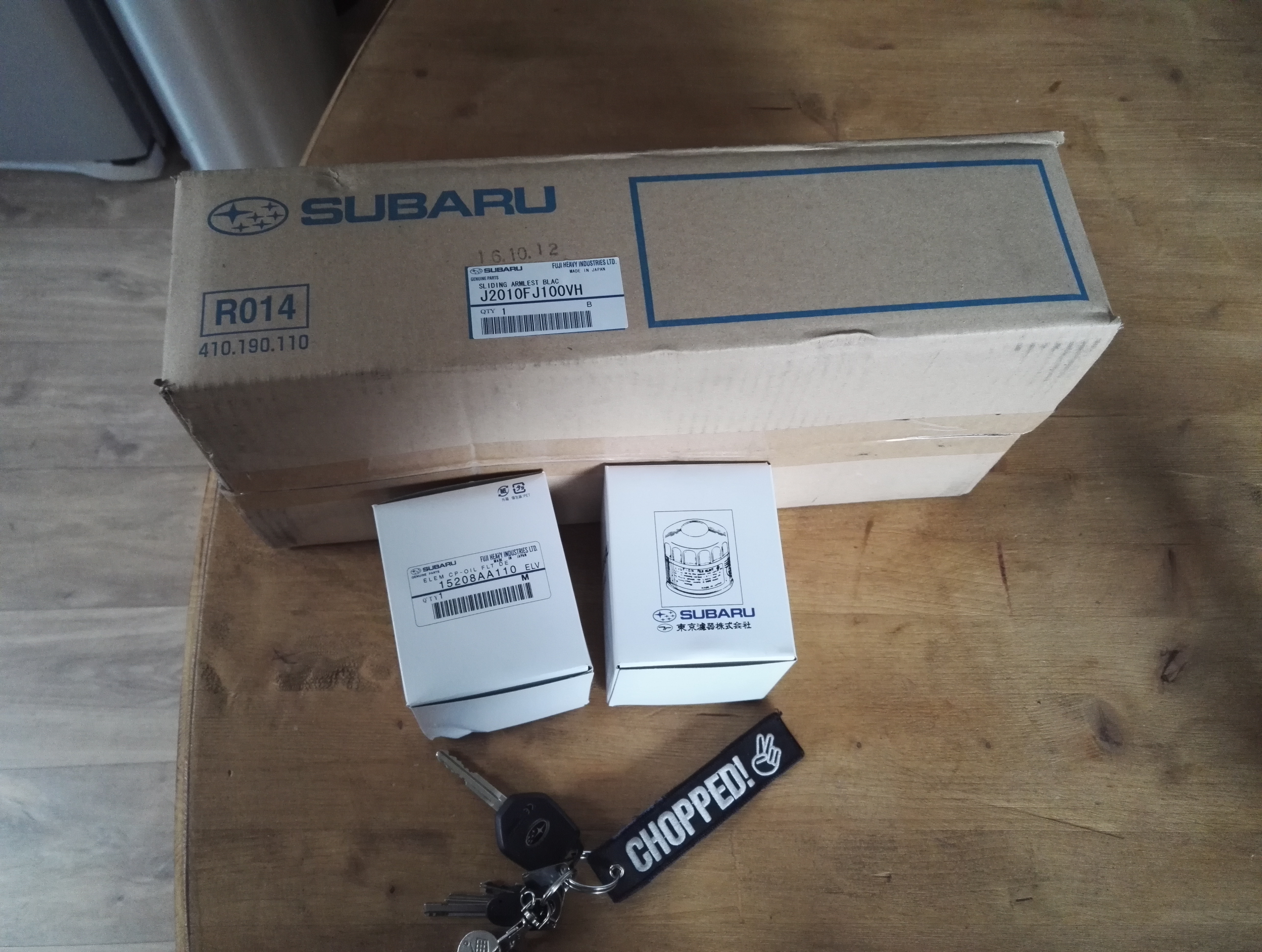

So an exciting box arrived for my XV today! While shopping for oil filters I noticed you can get a sliding arm rest, coming from a forester with captains chairs I always wanted a bit more left arm lean so I bought it!
Super easy to install, the panel at the back pulls off from the bottom then straight out at the top. 4 screws hold the arm rest on. As you can see from the pictures it's physically the same size as the fixed one, with the exception of the hollowed out section.
The armrest slides forward over the centre cup holder about half way. Hopefully it won't disrupt my morning coffee! Tomorrow will be the test. (Apologies for the muck! Probably should have wiped the dog prints off it before taking the pictures!)
That's really nice, I think it would be a big improvement. Was is expensive and where may I get one please
I got it from subaru-parts.co.uk and it was £75, however I think it might have been the last one they had as its now showing out of stock :(
https://subaru-parts.co.uk/product/genuine-subaru-sliding-arm-rest-impreza-xv/
The Part number is J2010FJ100VH
Nice improvement, I like it, and as its OEM it matches the interior properly and fitted easily.

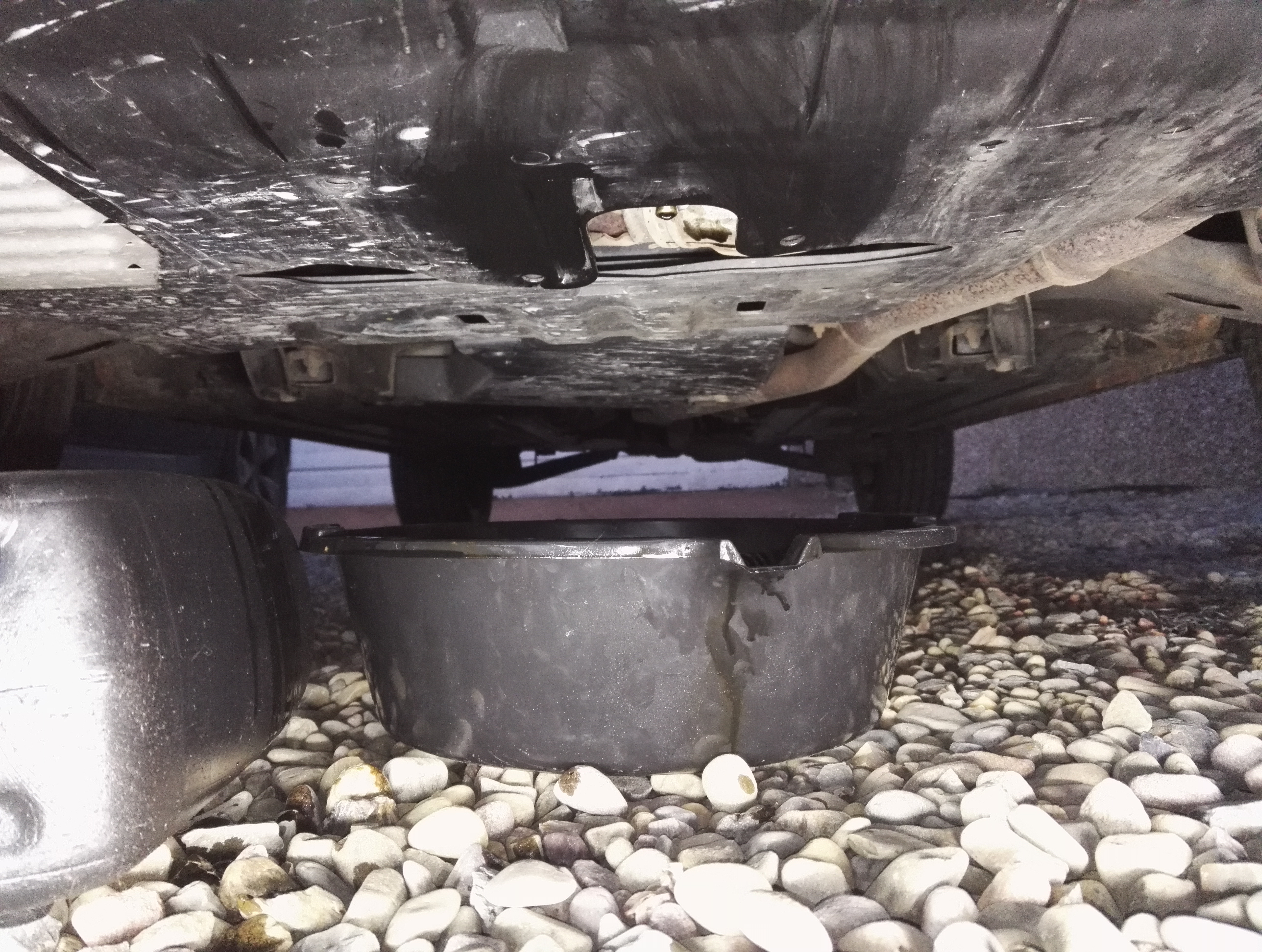

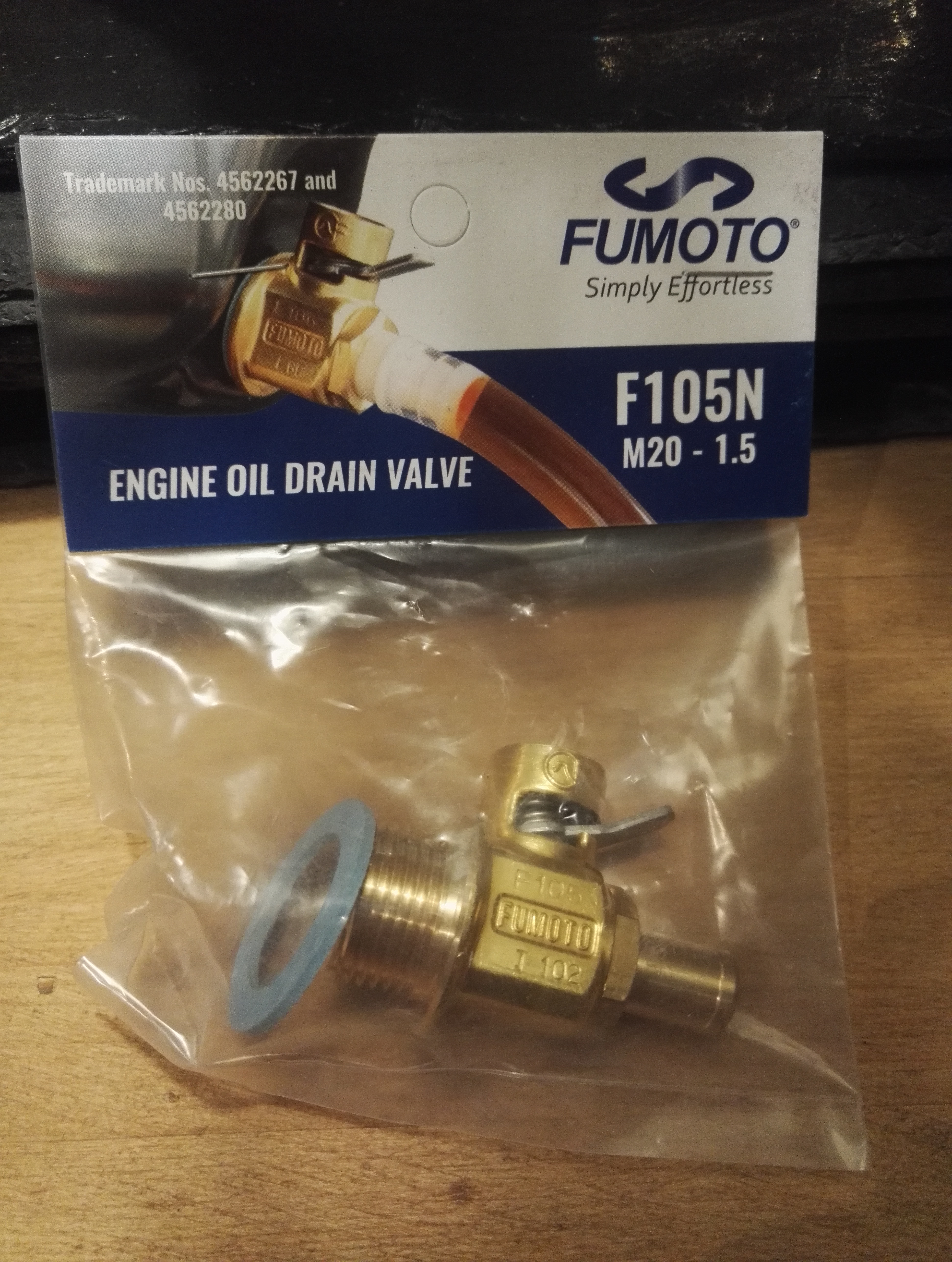

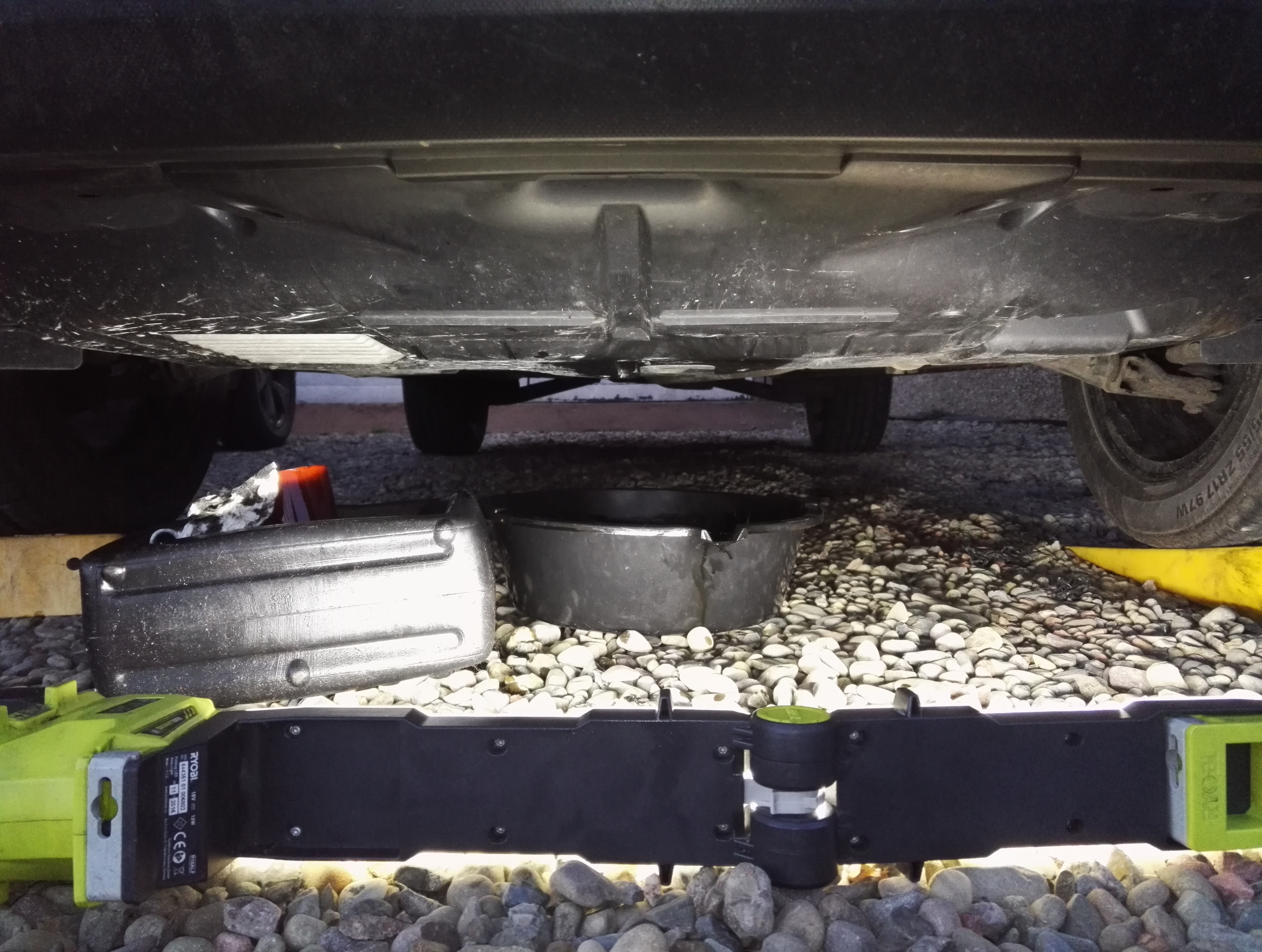

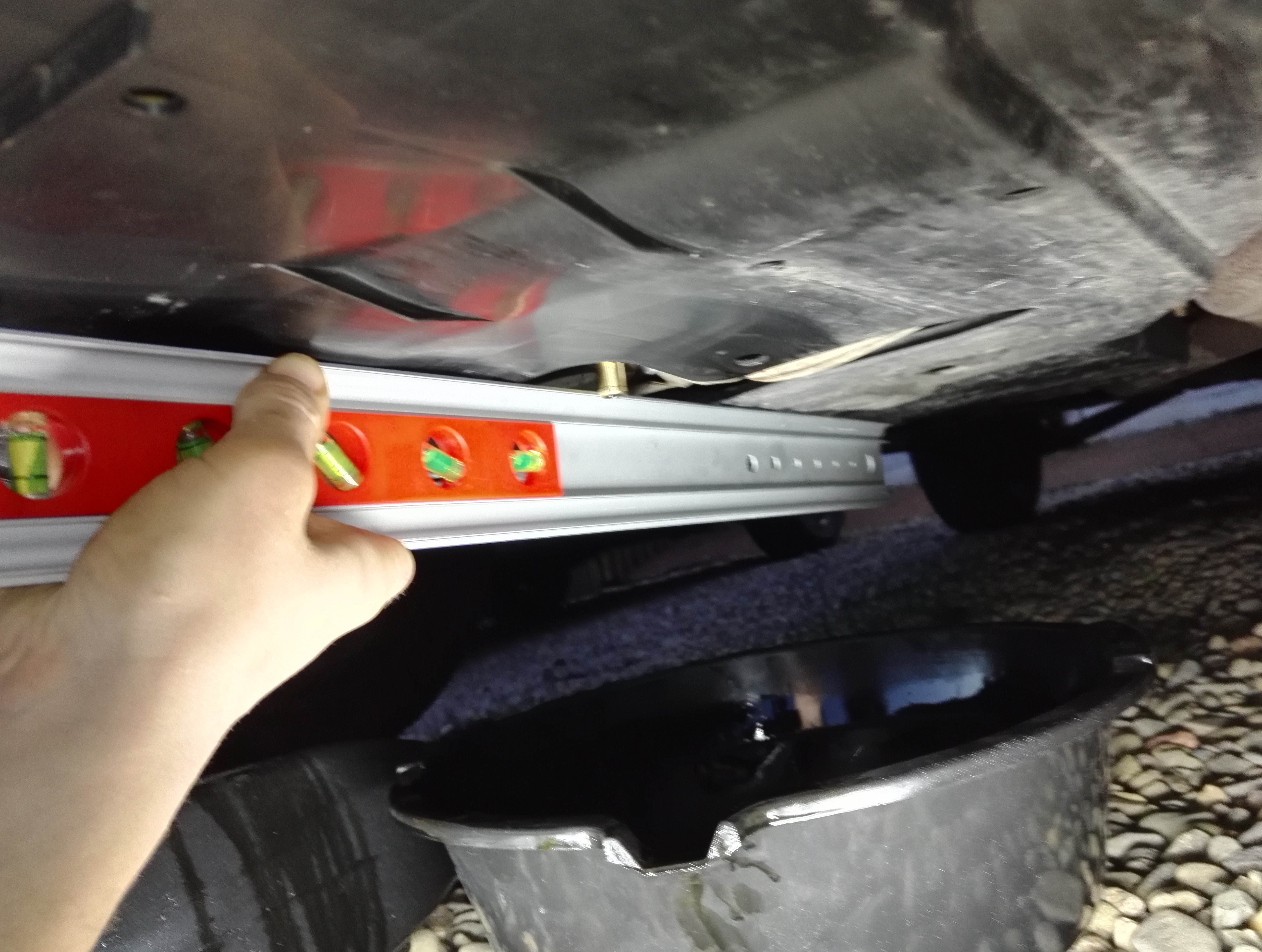

Another 6,000 miles, another oil change. This time it was a little different. Installed my Fumoto valve (F105N M20-1.5) *edit that's for the diesel, not sure if the petrol is the same.
Couple pictures showing how low it hangs out the bottom, I think if I were buying another I wouldn't get the long nipple.
One thing I did note was that the length of the thread on the valve was maybe 5mm longer than the oil pan is thick, so it will protrude into the pan preventing a complete drain of the old oil. Take from that what you will.
I pushed the plastic up with a spirit level and the lowest metal on the underside sits about halfway down the nipple, so you'd have to be sliding the belly of the car along the ground to have a problem... But I've done that before in my old forester.

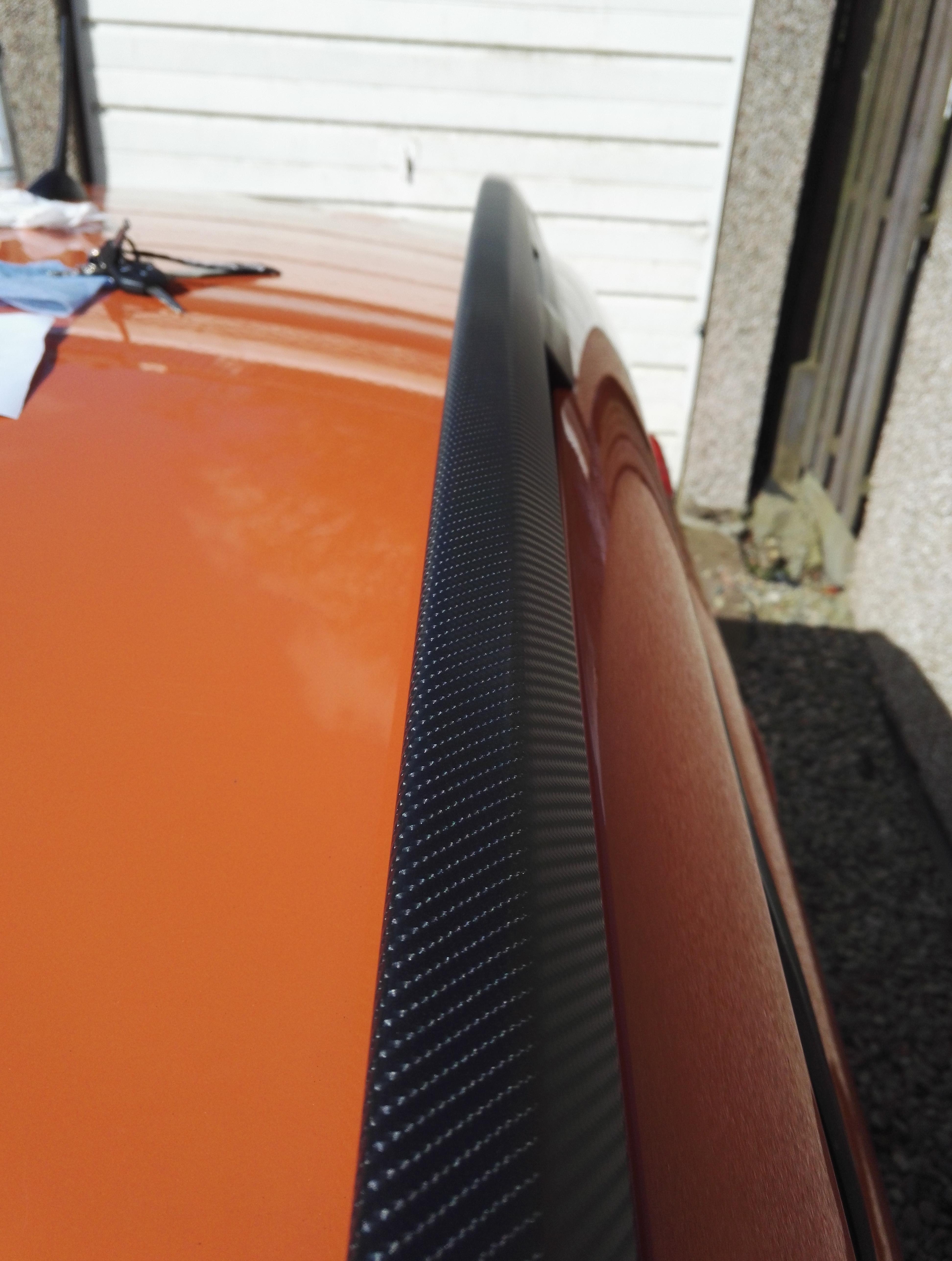

Washed the cars, then decided to wrap the roof bars as the plastidip wasn't so good. Its pretty rough, but looks ok from afar!
That looks OK from the photo's.  What wrap did you use?

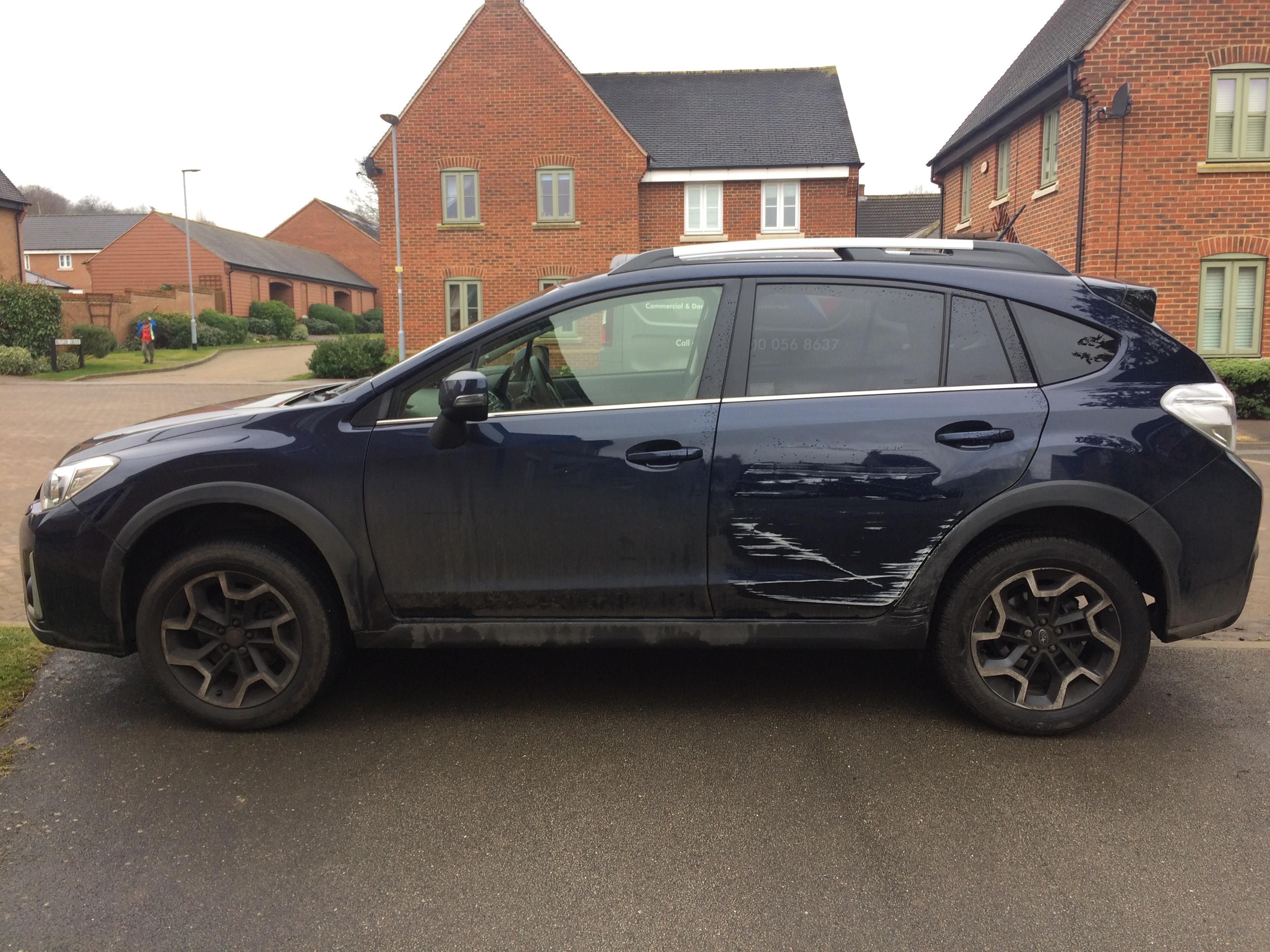

Got this "polished" out of the Mrs's car on Monday...
The gatepost at her mum's suddenly decided to leap out as she was turning in. Damn thing hadn't moved at all in the previous 28 years!
Still, it came up nicely, with a new door, sill and wheel-arch trim😣
Ouch 🤕
As they say sh*t happens, these gate posts are not what they used to be, now in my day............... 😀
