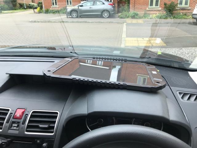

I've just checked the current draw with the charger connected. Even though there is full cloud cover today it was reassuring to see that it was providing enough juice to overcome the 80 mA drain and give a net charge of 3 mA!
Thanks for the link. Would the cable length be long enough to connect from the back window shelf. It’s the way I park the car and the sun direction?

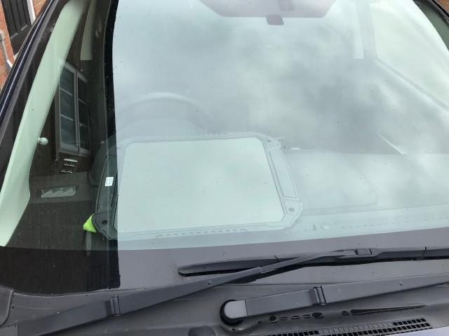

The cable is 4 m long (3 m on the panel and 1 m on the OBD connector), so more than ample. I've just tried the panel on the parcel shelf, routing the cable loosely along the sill, and the cable on the panel reached the driver's footwell.
The rear window is quite heavily tinted, so it would probably lose a lot of efficiency through the glass. I'll give it a try and let you know how it performs.
Thanks appreciate the info and the offer of giving the system a test through the rear window, appreciate that.
No problem! I've enjoyed pottering about outside testing various configurations. Note that it is now more overcast than earlier so the performance of the panel has diminished somewhat.
The drive runs approximately NE - SW, and it is usually reversed in with the bonnet pointing SW (215o according to the compass on the phone.) The net current draw results are:
Panel disconnected - 71 mA (I've found the "average" function on the meter so revised down the 80 mA, which was an earlier estimate from the current fluctuations.)
Panel on parcel shelf (Boot SW, panel propped up on centre headrest) - 70 mA.
Panel under sunroof (it just fits between the shade and glass, directed slightly NE as the drive is on a slope) - 66 mA.
Panel on dash (bonnet NE) - 40 mA
Panel on dash (bonnet SW) - 40 mA
My initial interpretations are that the panel, in these fairly overcast conditions, can provide 30 mA when placed on the dashboard, which will reduce the battery drain by approx. 40%. But placing the panel on the parcel shelf, facing through the privacy glass, makes practically no difference to the battery drain. And through the sunroof is not much better.
I'd check how much light your car gets on the dashboard before purchasing one of these, as I doubt putting it on the parcel shelf is worthwhile unless it is a very bright day. (It is supposed to be nice on Thursday, and I have the day off, so I will check again in (hopefully) full sun.)
Thanks again for the effort. I usually drive onto my drive and reverse off. The rear of the car facing SW and has a clear view of the sky until late into the day, In fact the front garden and the house is very hot on even just a bright day. These panels are meant to work with light rather than specifically the  sun so in theory should function quite well.
Not sure I follow your conclusion as you say that the panel produces 70ma on the parcel shelf so based on your estimate of a need to recover 80ma this would be reasonably good and boost the current when the cloud lifts. Your car orientation is similar to mine so would probably work well enough.

Ahh, sorry for the confusion. I'd been playing all day so it had become second nature but I realise now how the results could be misunderstood. I was recocrding the current draw, not the current provided by the panel. Please accept my apologies. I'll present them again to highlight the (calculated) current that the panel produced in the aforementioned locations:
Panel disconnected - 71 mA draw. (This is the (revised down from 80 mA due to finding a better setting on the ammeter) current draw when the car is parked and locked, no charger connected. Anything less than this value indicates charge; the lower the number the greater the charge.)
Panel on parcel shelf (Boot SW, panel propped up on centre headrest) - 70 mA, draw, so only 1 mA produced from panel.
Panel under sunroof (it just fits between the shade and glass, directed slightly NE as the drive is on a slope) - 66 mA, so 5 mA produced from panel.
Panel on dash (bonnet NE) - 40 mA, so 31 mA produced from panel.
Panel on dash (bonnet SW) - 40 mA, so 31 mA produced from panel.
When I checked the current draw earlier in the day, with the cloud thinner and the sun higher, the reading on the ammeter was -3 mA, indicating that the panel was charging the battery at a (revised) current of 74 mA.
So in the conditions here this afternoon the panel only produced 1 mA when placed on the parcel shelf. The tint is quite dark (I could barely see the panel once I'd shut the boot) and the sun obsured by reasonably thick cloud so the fact it produced anything was a bonus!
Once again, sorry for any confusion. I'll try and rig-up a set of leads to put in the circuit before it gets to the battery so I can measure the output from the panel and get a definitive reading. This will also save a lot of time by negating the need to disconnect the battery negative lead each time and therefore resetting the time / date / auto-window, so probably worthwhile!
It's funny you mentioned the dealers, as my wife informed me that she'd received an e-mail from ours on Saturday regarding the service and MOT on the XV. Apparently they're hoping to open, with safe "SD" measures, on the 11th, which is handy as I booked it in for the 15th when we went to the Subaru openday that they held in August, thus getting £75 off!
Thanks for the explanation, fully understand now. It’s so easy when your locked in your own bubble to record what you see, we all do that. I just appreciate the effort. I looked through my rear screen today and agree it’s looks pretty dark. However, after I’d shopped and was home I was opening the boot and looked at the carrier bags through the glass in the boot, cover not extended, and was surprised how bright and clear they looked.
I've cobbled up a patch lead to monitor the current output from the panel. This way it's easier to see the amount of charge the panel is providing without having to worry about how much the car is drawing.
I pointed the boot of the car (I used the Levorg as the XV is covered in bunting!) and propped up the panel to face the sun. The output with the boot open was 270 mA. When I closed the boot (I had to move the panel slightly to keep it in full sun, but kept the angle the same) the output dropped to 65 mA through the privacy glass. This was at about 12:30, so the sun was nearly at its zenith.
It's not worth getting one of these for the parcel shelf as the glass blocks too much light. The output drops off depending on both the angle of the sun's height and direction, so if it barely provides enough at noon it will be worthless for the rest of the day.

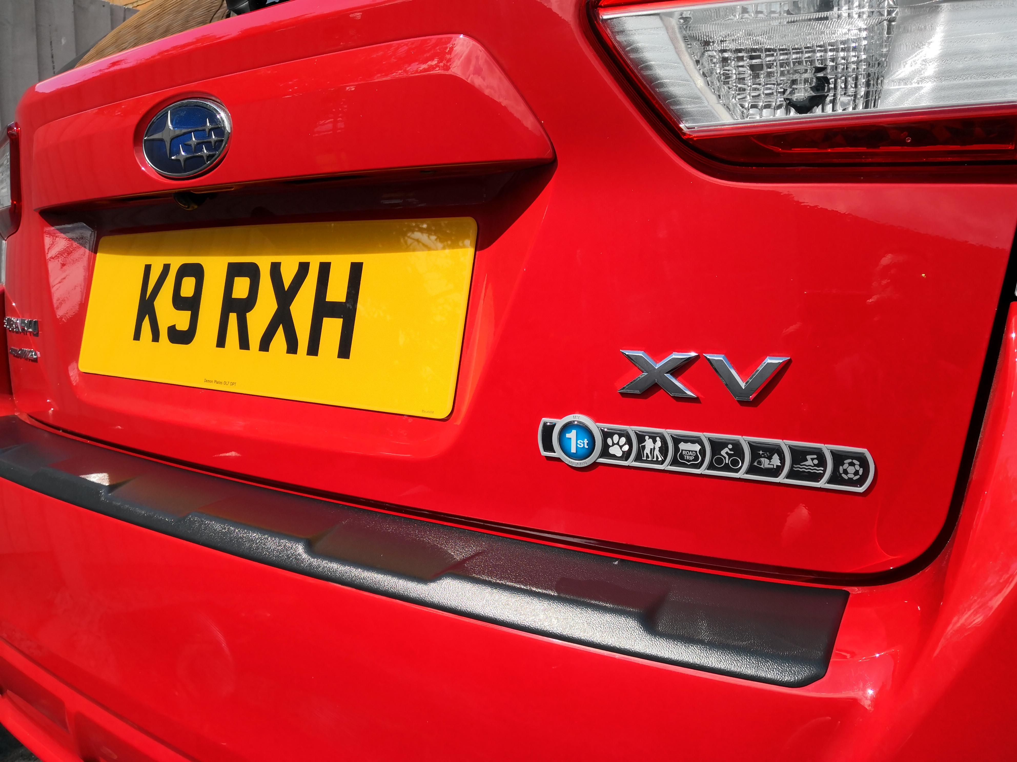

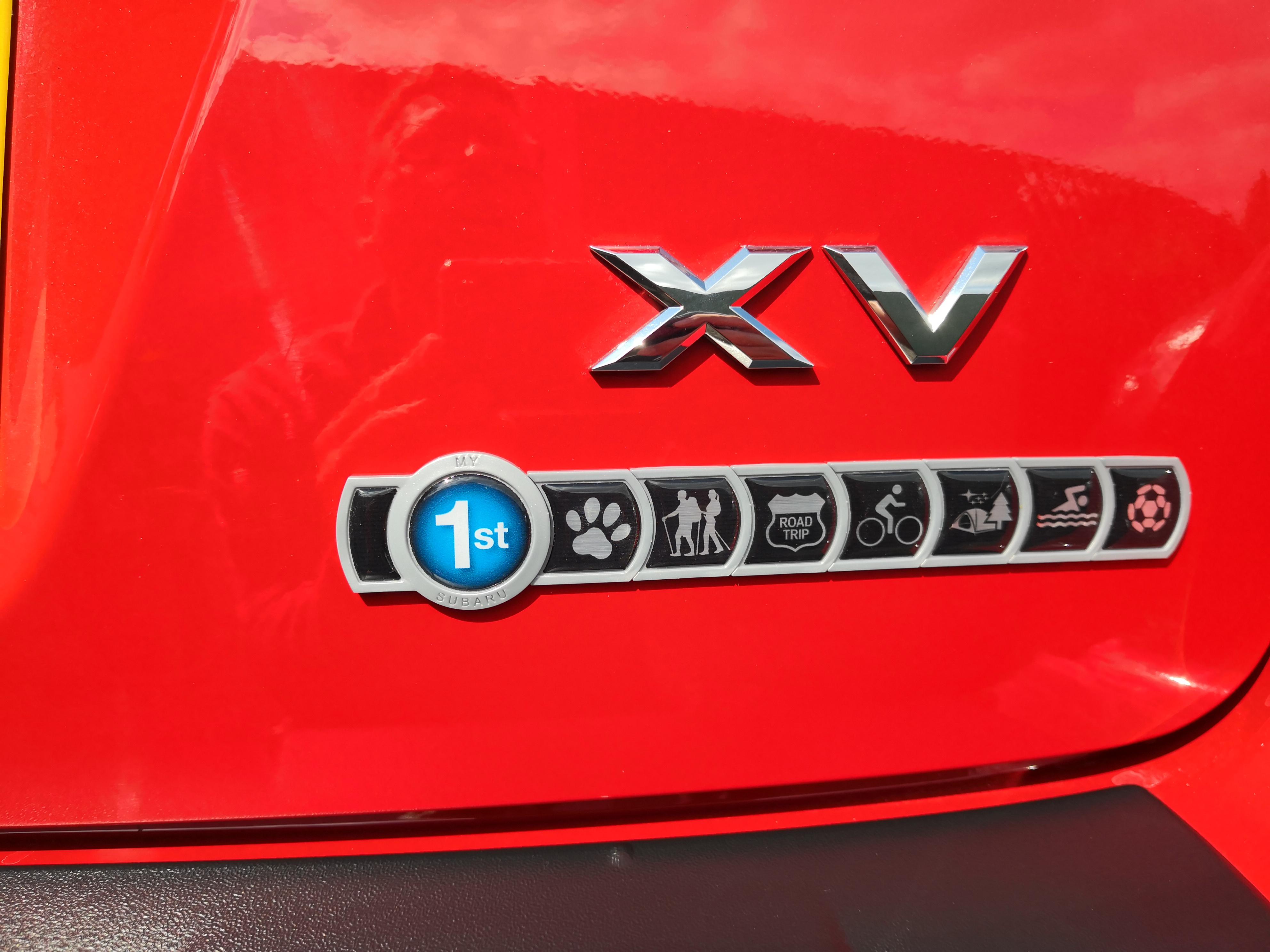

Managed to obtain a set of Subaru ownership badges from a good friend in Canada and received and fitted them today.
Very pleased with them,it's a shame Subaru UK don't have the same scheme running here.
What is the scheme?
2 hours ago, ernieb said:
What is the scheme?
Basically,you send your vin number to Subaru on a application together with the activity badges you are interested in and the number of subaru's you have owned and they send you out the set of badges for free.
I'm a Subaru noob so I asked my friend in the states to order me the my first Subaru badge together with the activity badges you can see.
Unfortunately they won't accept European vin numbers,hence the convoluted way I had to go about it,using my anerican friends vin number.
Interesting concept and I can see the appeal. I’m on my third Subaru the previous two being Forresters. Thanks.
Yeah,it's just a bit of fun which encourages brand loyalty I suppose
