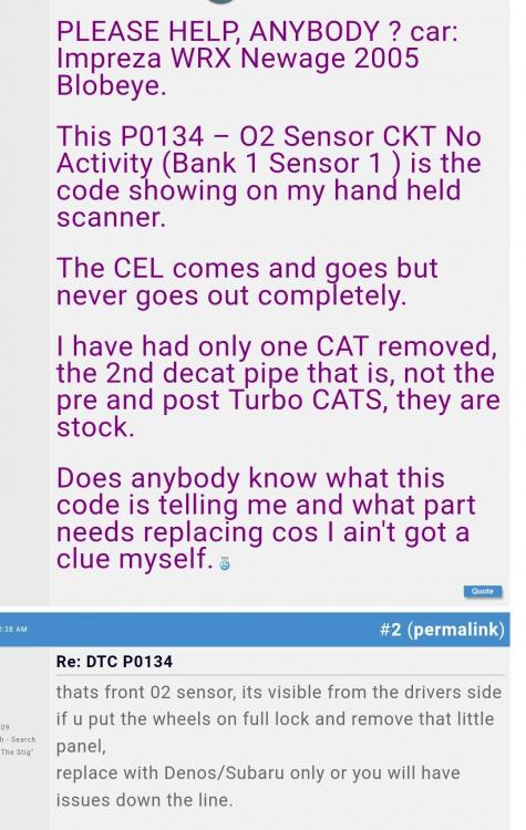

I gave the code a quick google , as it wasn't making sense that it applied to 1 bank if it was a o2 issue.
As I said before when a bank code come up its normally Tgv's or if accompanied by a misfire code , its coilpacks, plugs or injectors.
I only checked 3 of the googled results but they all said the same thing , which still makes no sense as its nothing to do with a particular side or bank of the engine lol .
So your mechanic could well be right by saying if there's a hole in a bit of the exhaust it could cause a o2  reading fault . As the sensor readings might not be the same ,due to gasses escaping through a hole .
 heres a screenshot of one of the posts that came up with a google but I'd suggest replacing exhaust section first before changing a sensor .
Best of luck getting it sorted ,bud

Just in case he replaces the exhaust section and the code comes back , the google results said it was a o2 sensor fault .
I've always just unplugged the sensor from the loom and used a open ended spanner (possibly 22mm) to undo the o2 sensor (so the sensor wire doesn't get in the way)

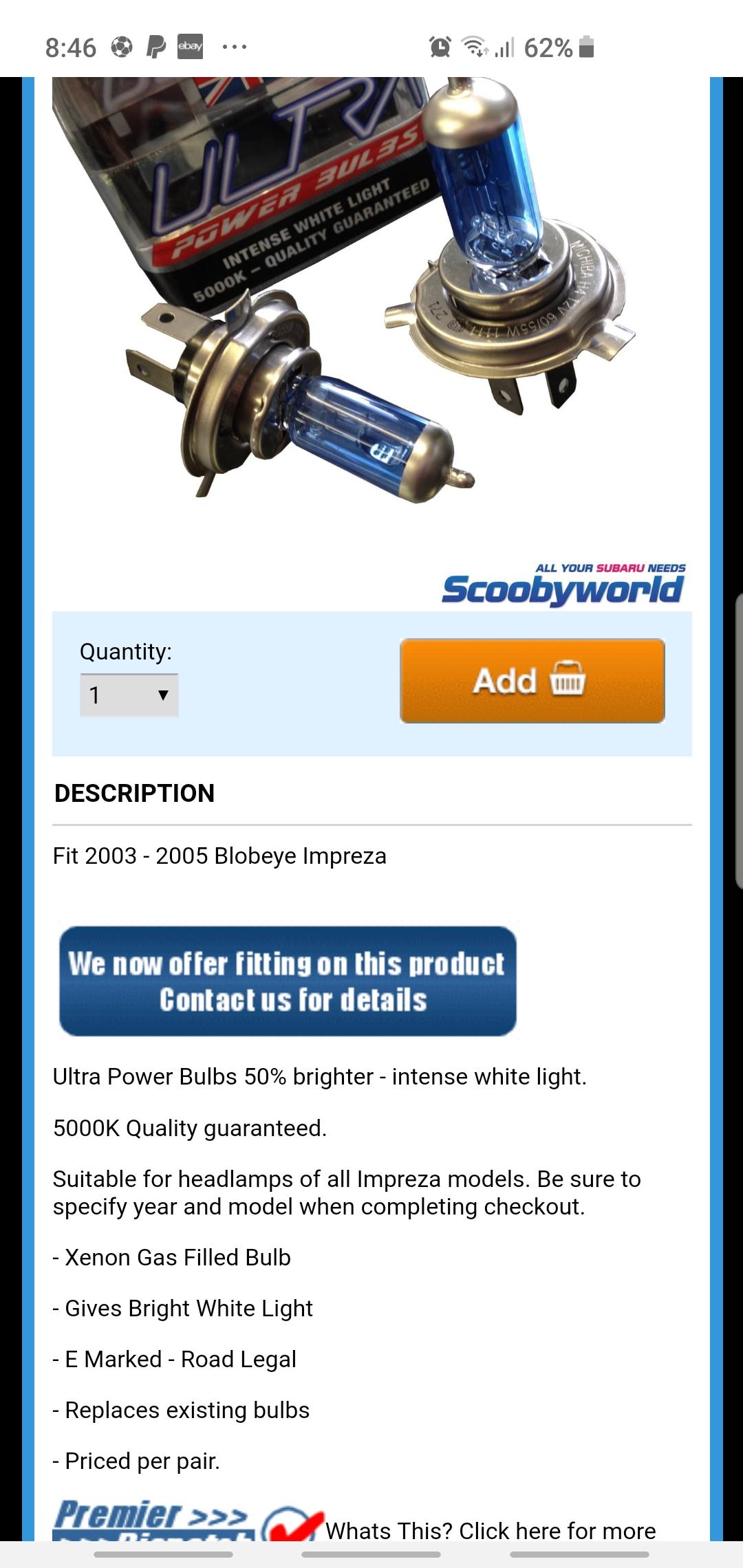

Been lookin at headlight bulbs today an ended up gettin some white head light bulbs from scoobyworld an some side lights I've heard their a bit of a **** to do. What are these HID conversion kits all about? Are they that much better than what I've bought?
Yeah mate they are a pain i had to take my light off to get at them properly not too hard just a bit annoying just to replace a bulb lol was well easier on the bugeye
Mental int it, ive gone for the whole lot in white fogs heads an sides, call me a !Removed! but think I've just found out the high beams a different bulb? I always thought the full.beam an.dipped ran off the same bulb?
