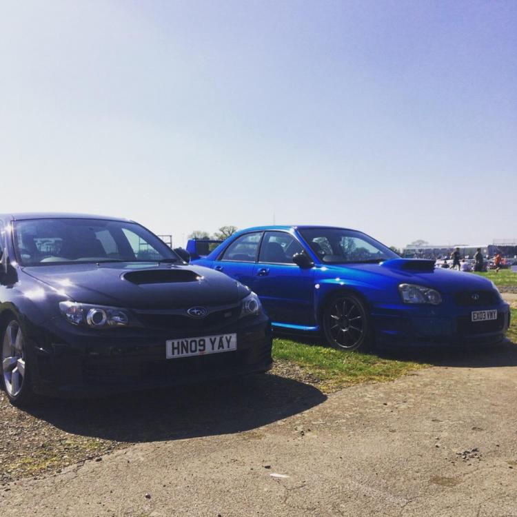

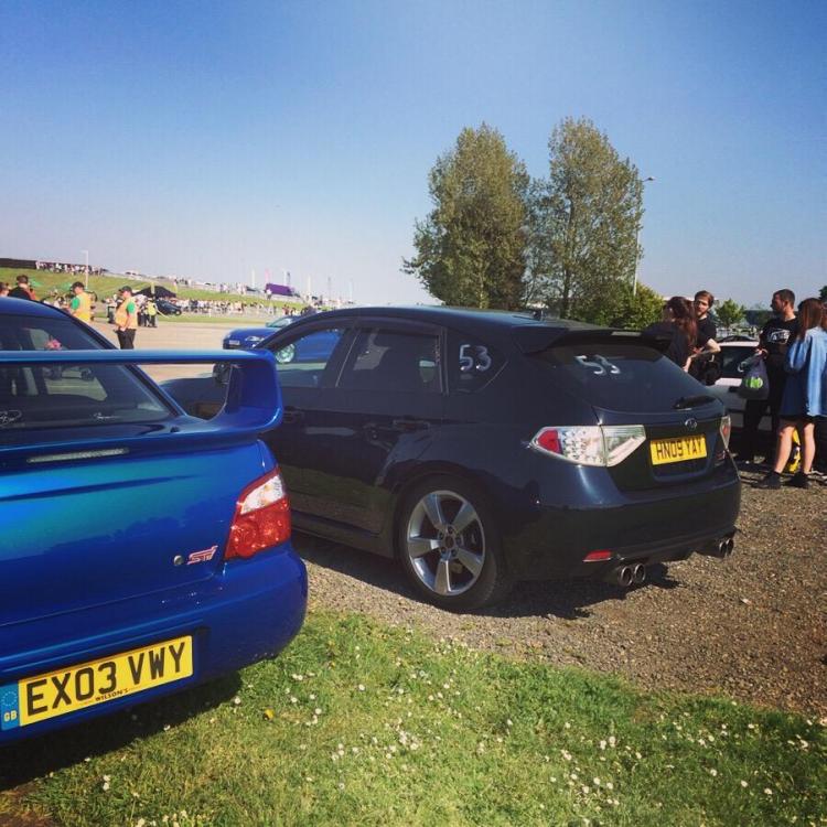

Well I thought it was about time I did a project thread on here.
So I've had my midnight blue 330s about 3years now . I came from a 350z 313 because I needed a more practical car, it's a lovley car plenty of power and all the goodies
Couple pics from when I got it
So every think was fine and I kept the car standard for almost 3 years. In that time I covered about 30k miles , plenty of long journeys upto santapod and silverstone. But it never missed a beat, didn't drink oil or anything.
