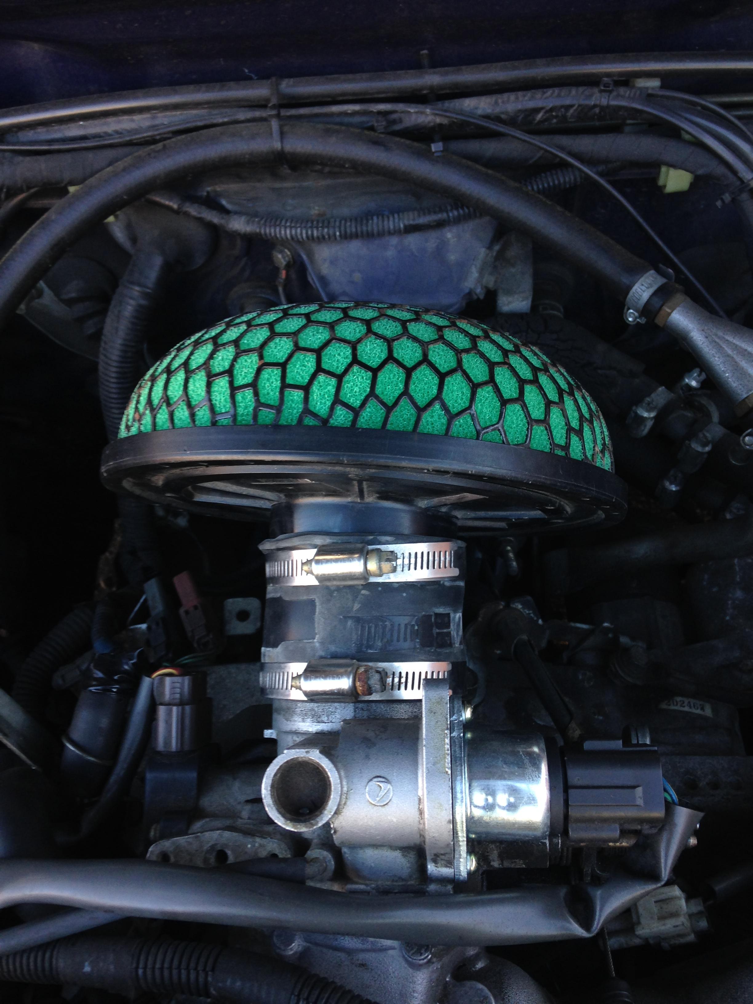

so i have a 2.0 sport impreza so its na. my latest mod was a hks mushroom induction kit. the nas have an air box which comes off the throttle body. i pulled that airbox off and directly attached the hks mushroom as a reverse fitting so that cold air is fed directly from the bonnet scoop. the air box had three hoses which i disconnected and covered with etape for temp. i feel like the cars hesitating to put power down compared to the standard airbox. is this due to the hoses? what can i do with those hoses? kayzarh said they wer pcv hoses but i havent a clue what to do with them and if thats the reason im losing power? can someone help? i will post pics tomorow morning when we get some daylight

    Could that filter facing backwards be causing some air supply issues?

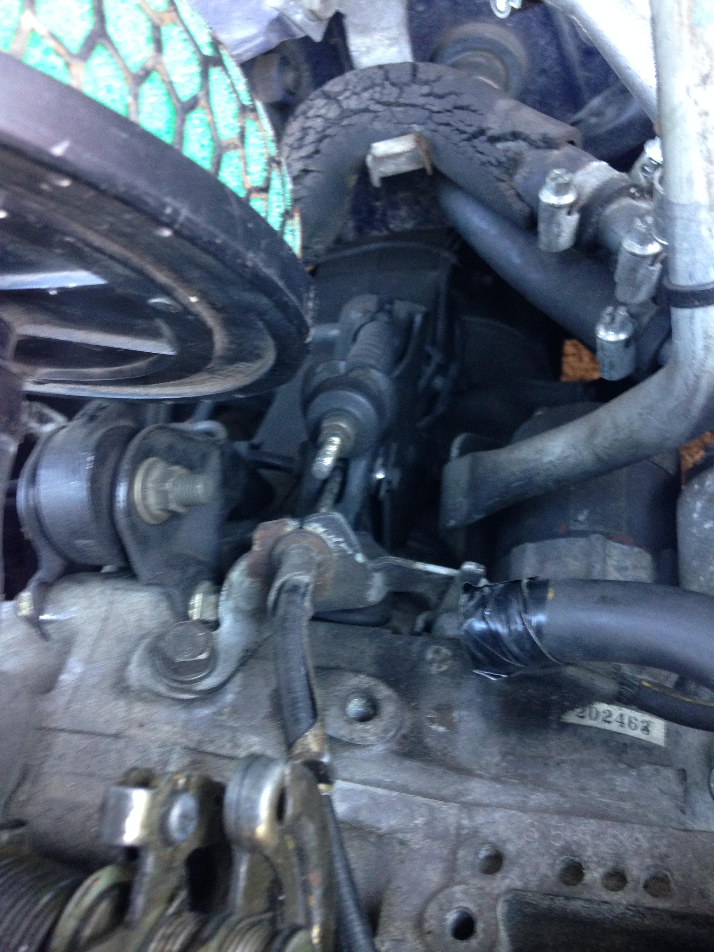

    Blocking off pcv hoses isn't helping as the crankcase needs to breathe and with what you've done, I think this restriction could be affecting power delivery.

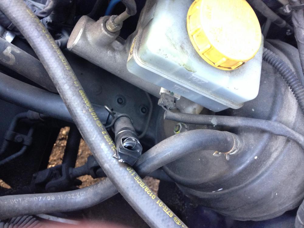

so thats the setup very basic and simple, but the those three hoses as can be seen from the pics which are covered with etape i dont knw if thats whats slowing my power down. has anyone else had this problem?

As i haven't got a scooby do what those pipes are for ,I'd Probably start by bunging the leccy taped pipes with a suitable sized bolt and jubilee clip .
Hopefully this will either cure the lack of power or rule the pipes out as the issue .

so i pulled off the tape and the hoses seemed like they wer sucking in air. kayzarh said that u need it to be open and in a clean area as u do not want it to suck in water and debris.
as for the power delivery its better but still a bit hesitant.
i was thinking of maybe getting the front area of the old airbox and maybe using it to shroud the mushroom and also feed the hoses back into it.

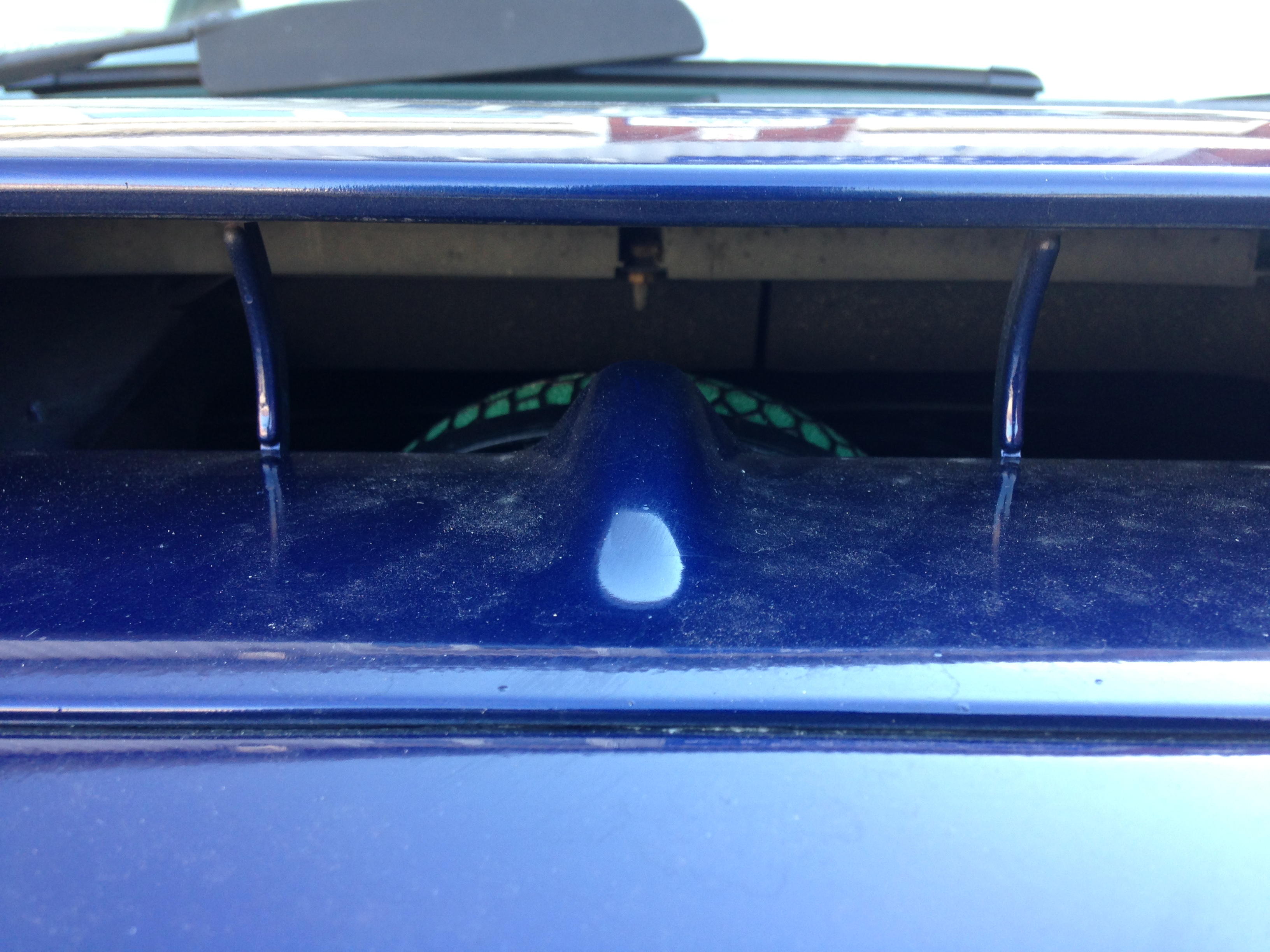

Cold air = power.
If you ask me, you ain't getting a drop of fresh air from that position, but what you are getting is warm air from one of the hottest parts of the engine bay.
Warm air is just as bad as lobbing in 87 Ron fuel.

Didn't know the pipes were crank case breathers as I've only seen a boxer na bay once (in the flesh)
So yep don't completely block them off as the need to breathe, but don't let them suck in debris or moisture either .
If your still gonna run the induction kit and can't fit the breather /pcv system back to oe , get a vta catch can plumbed in asap

removing airbox will be causing air turbulence issues over the maf, mix that with heat soak and pcv's 'there's your problem'
basically this a detuning mod, even forced induction subarus can have power/smoothness issues with filters similar to these unless fitted well and air flow mapping adjusted.
Subaru airflow sensors are very precise and easy get issues when change mechanical air intake without changing digital data .
I had this exact same problem on my 2003 wrx stuck a cheap short ram on, messed up the power and would not rev out, so tried airbox back on with inch sized holes bored in it, same thing, put standard air box on, back to normal, turbulence over maf is real and bad, and heated air is awful, don't know if this relates to your model at all but thought I would put it out there, i now have a quality cold air feed induction kit fitted on a different scoop, all good

so basically i should stick to the stock airbox right?
i thought i was mafless though so thought would all be well. but i think ur right. i reach eff it quite easily and so im probably eventually going to put the stock airbox back on ahahhaha.
cheers guys, was worth a try but i think your right, will stick to the standard airbox. sometimes stock is best😂😂😂 not always but sometimes😂
