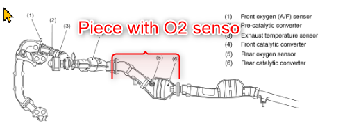

(2) uppipe
((4) downpipe
(5) secondary cat
then after is centre section I’m sure Thats it

If the piece below is foobar then it has an O2 sensor according to this diagram. If it the section after this then this is after the O2 sensor and would not trigger a check engine light and the issue is something else e.g. tgv. Which part of the exhaust has holes?
Have we established which part of the exhaust has gone?
Again there isn’t a sensor in the centre section look up a centre section as if your gonna buy one there’s no hole for a sensor. The cat pipe has a hole for a sensor.
