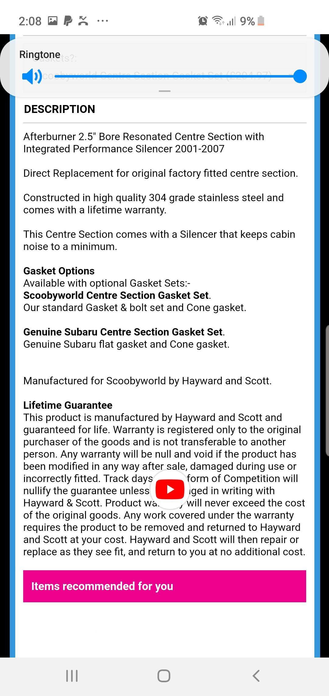

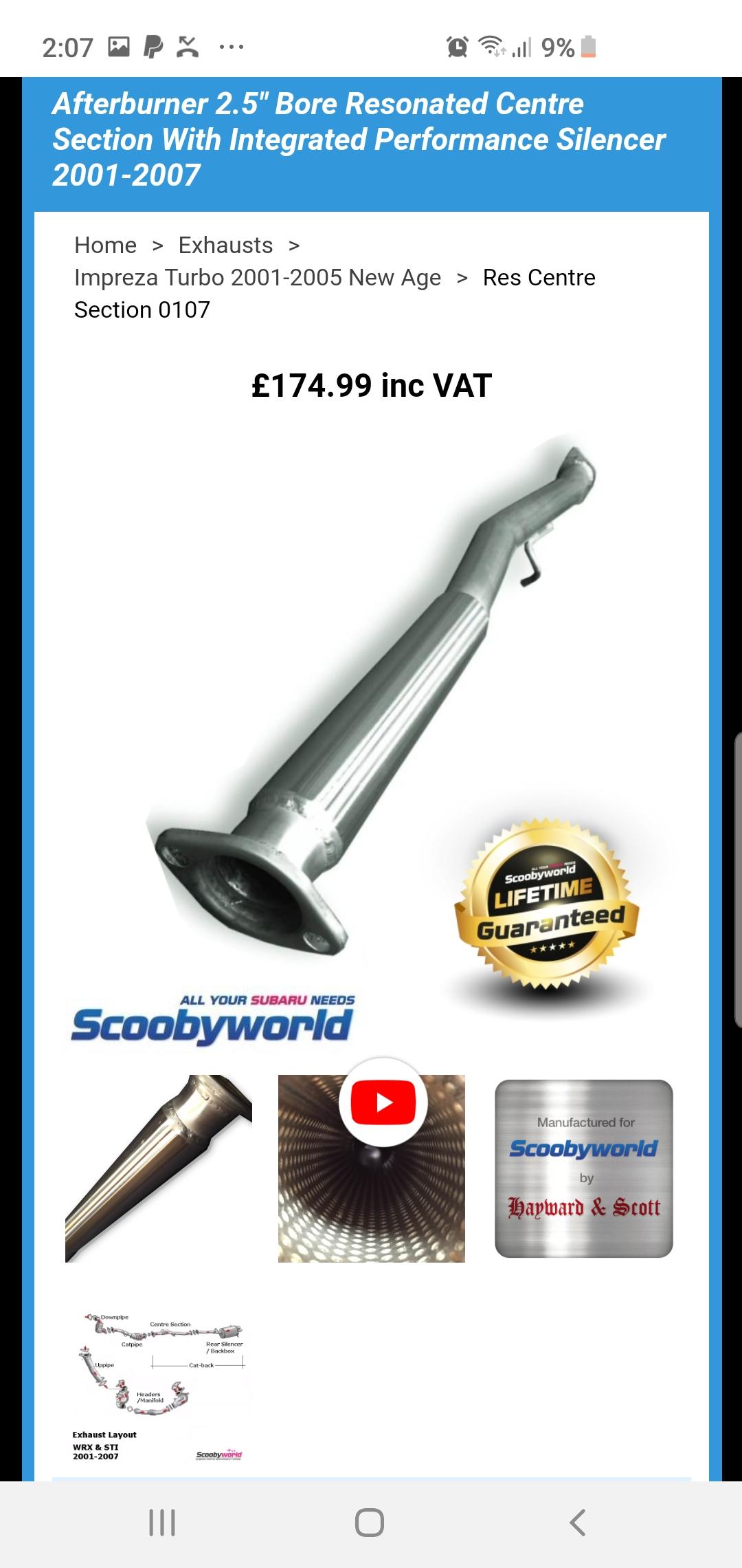

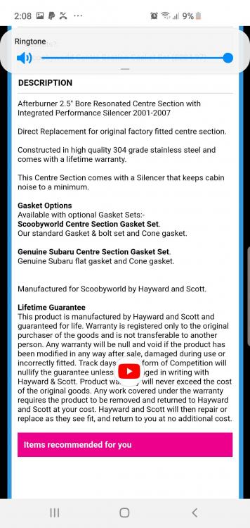

Hahaha 400 is a cert patience of saints you lot  it is appreciated honestly🙏. Stuartie thatd be absolutely spot on if you wouldn't mind doing that obviously I'll sort you out with some coin I just have one problem the centre pipe I wanted to order is made order wont get it till the 16th anyone know where I'd get one rapid?
Try Scooby world or Scooby worx you might get one faster from them mate, or failing that a custom exhaust company can make you one
Bit gutted.about that cobra pipe looked oright an it was on offer aswell just measured the c pipe its 126cm they.werent sure at the place I was getting it from gonna ring um see if they can pull their.finger out 😂
!Removed! hell just noticed within less than a week Darly has become an advanced member must be some sort of record too. 192 posts. Took me well over a year to have that many posts. Wicked
Haha I'll be a vet by.mid week👍 just got the centre pipe ordered from scooby world paid 16 quid for courier  maybe get Sunday an get it chucked on by monday some progress atlast👍
