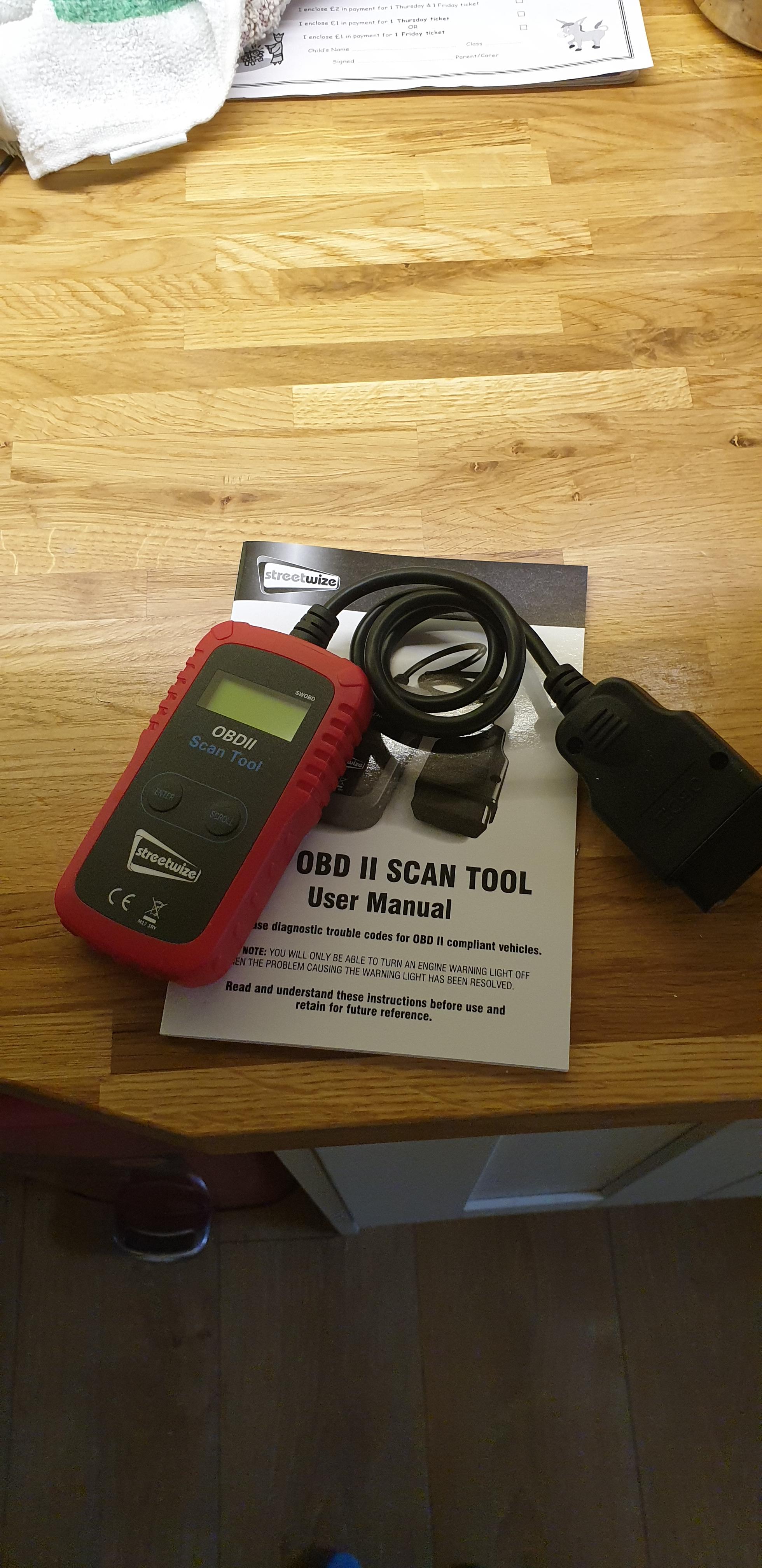

Haha good to know I need all the help.i can get! So the scanners finally here? Got the day off work today so gonna get on it shortly, I've not used one of these suckers before hope they're easy, from what I can gather you plug it in an switch ignition on but not to turn engine over?
It plugs in your obd port which is under your steering wheel column, you can read the codes with engine running but all you really need to do is turn ignition on and the scanner tells you the rest 👍👍

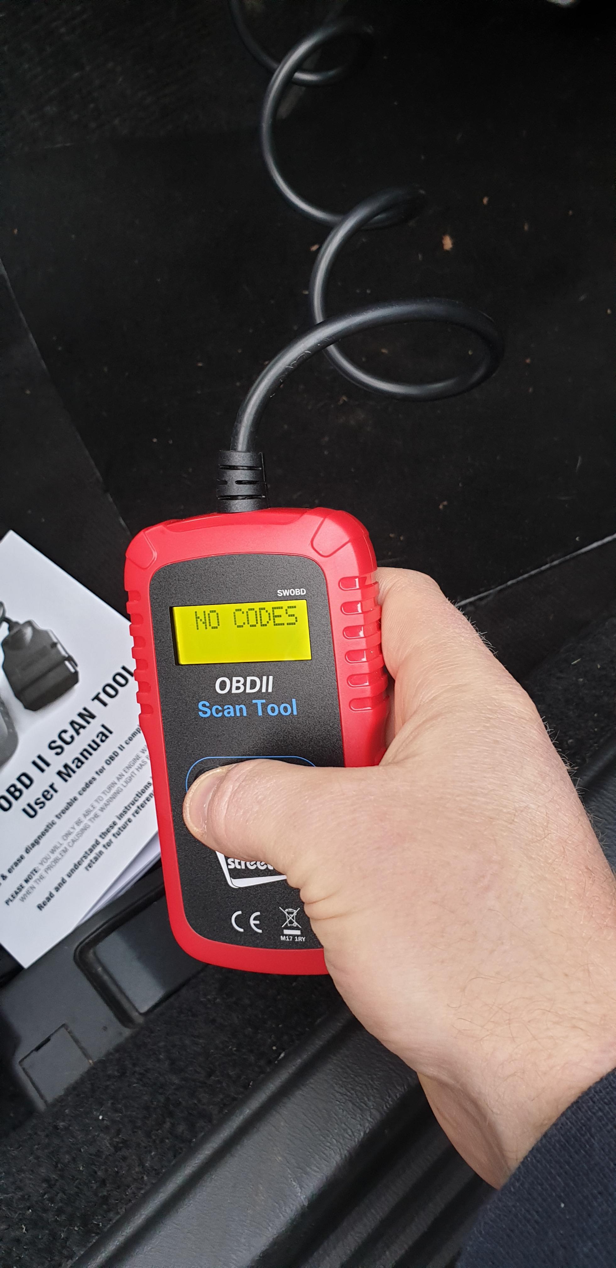

Ran through everything as the instructions said but no codes ? But check engine lights still on ? Wtf?
Checked it with engine running and just with ignition on
Just read it can be from !Removed! code readers😭 software error or somethin
Do you have an option to clear codes? I guess not if there aren't any. Is there any pending codes stored. These are codes that have been triggered but not enough to put the check engine light on?
Checking now dont know if I can see pending codes on this reader but I'll check now
Nah nothing like that on it jobs fooked
Cant believe my luck honestly wait all this time for the thing an it cant even read code now I'm gonna have to pay to have it done 🤣🤣🤣🤣🤣
Somethin I thought was strange it wouldn't tell me the vin number either an when I went on a menu for like the egr an fuel an bits like that it was just n/a

Does it mean it's a bad fault.if that wont read.it?
TBH no idea but I bet it is just the reader.

Check your fuses. The OBD port can share the same fuse as the cigarette lighter for example.
