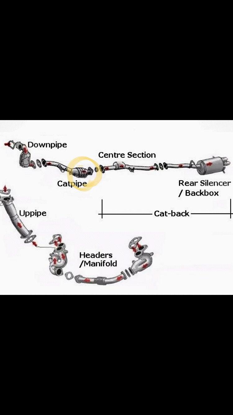

Afaik you'll have a sensor in the up pipe (pre turbo),one in the downpipe neck (just after turbo) and one in the centre section.  All these sensors are in the exhaust system after the gasses leaving each cylinder /bank have been mixed together.

The sensor is in the cat pipe before the centre section, £18 is cheap try and get a mechanic to sell you gaskets for that price lol. What gaskets did you order by the way cause the ones I posted were for the uppipe cause that’s what you ware asking about at the time? I’ve missed so much 🤣😂

You don't have a fault with the lamda sensor which is in the centre pipe so get them to fit it to the new pipe, that code is for o2 sensor pre-cats in the headers its either faulty or the tgv is stuck and messing with the air/fuel ratio on bank 1 👍
I’ve circled yellow where your rear 02 sits if you are just replacing the centre section the sensor doesn’t need be touched
Um so who's right then lol I'm confused, will that centre piece definately fit the wagon ya think? Nah mate got the right ones I called icp an asked for gaskets for the centre pipe👍. Right so either sensor in what part? Or solenoid for tgv or tgv sticking got it.
