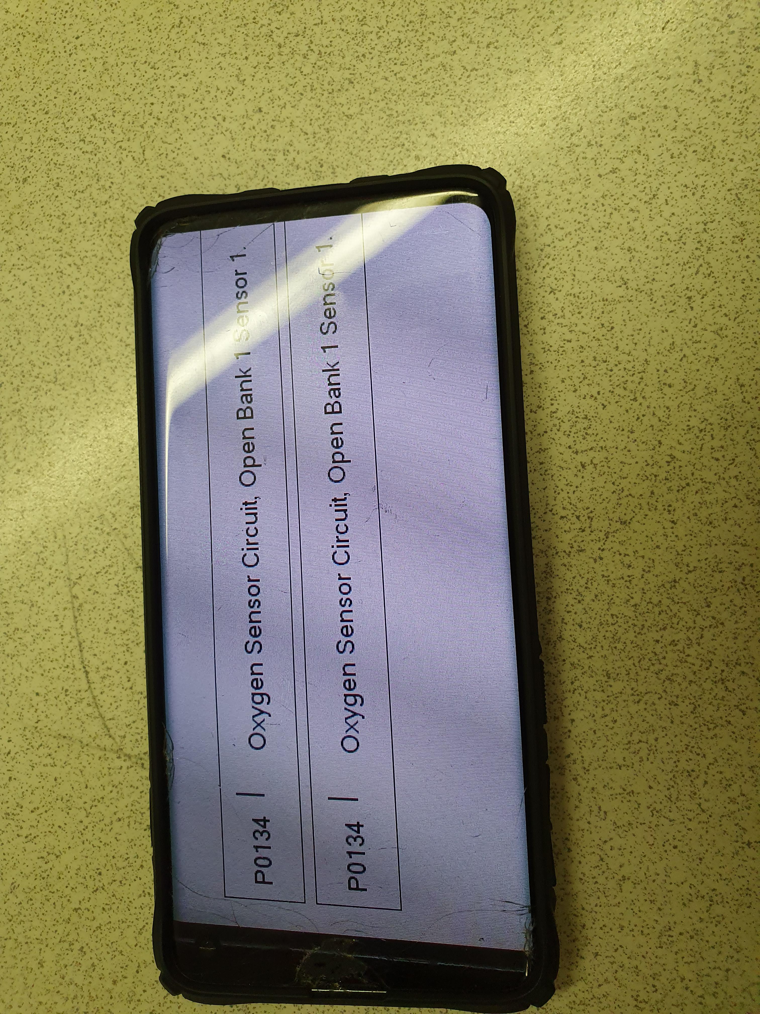

Update gents got a pic of the fault👍 centre piece is cooked just seen it, any suggestions on centre pieces?
I would say looking at that that it's what savage said about the tgv thingys, i would assume they are stuck or the solenoid is goosed pal 👍
Gutted take it those codes wouldn't suggest it could be the holes in the exhaust, Gonna have to sort the centre section anyways, what a swine. Is it hard to put right?

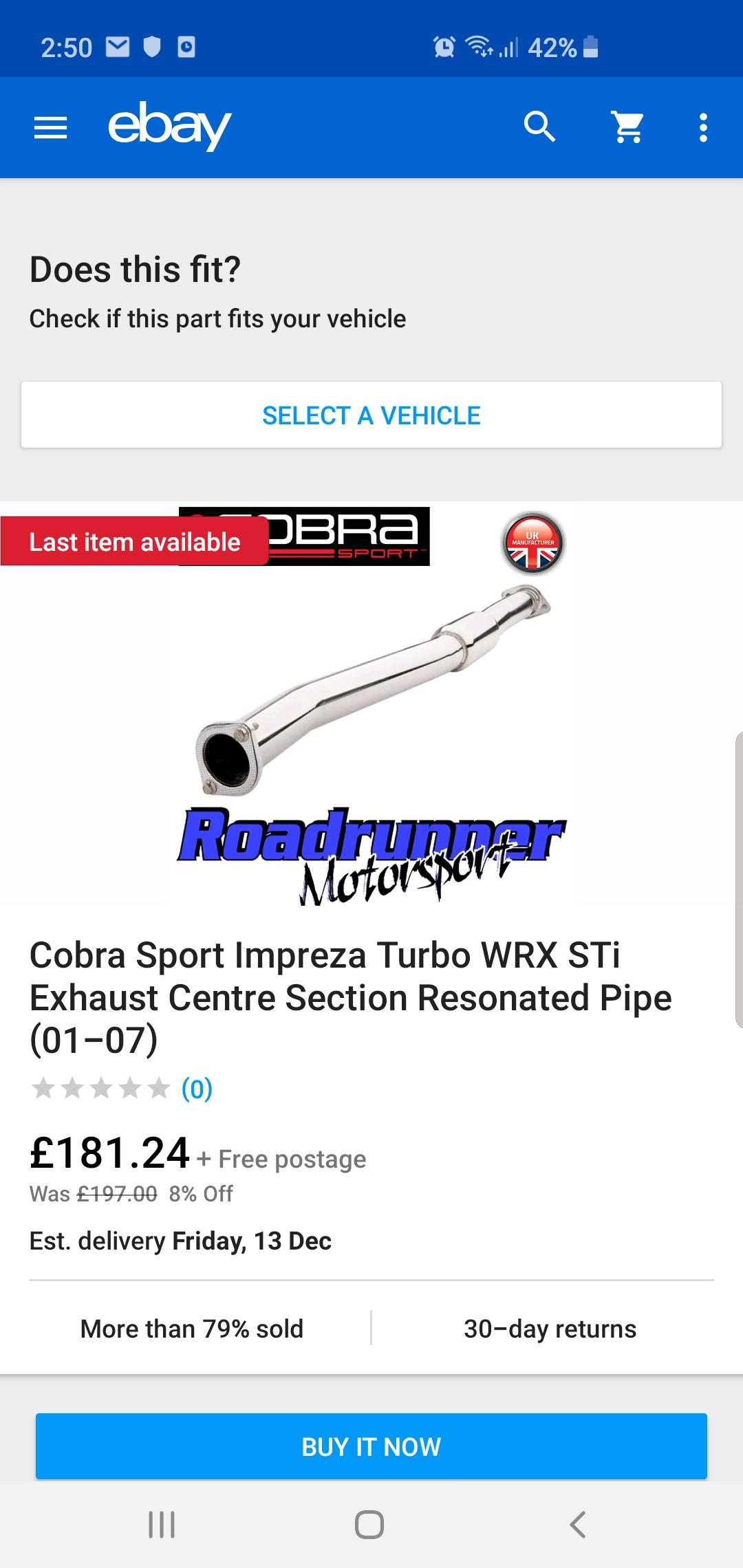

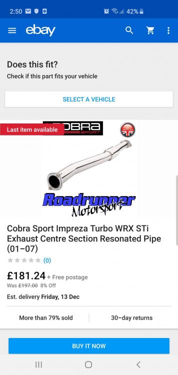

Had a look for different centre sections found this on offer? Should fit shouldn't it?
