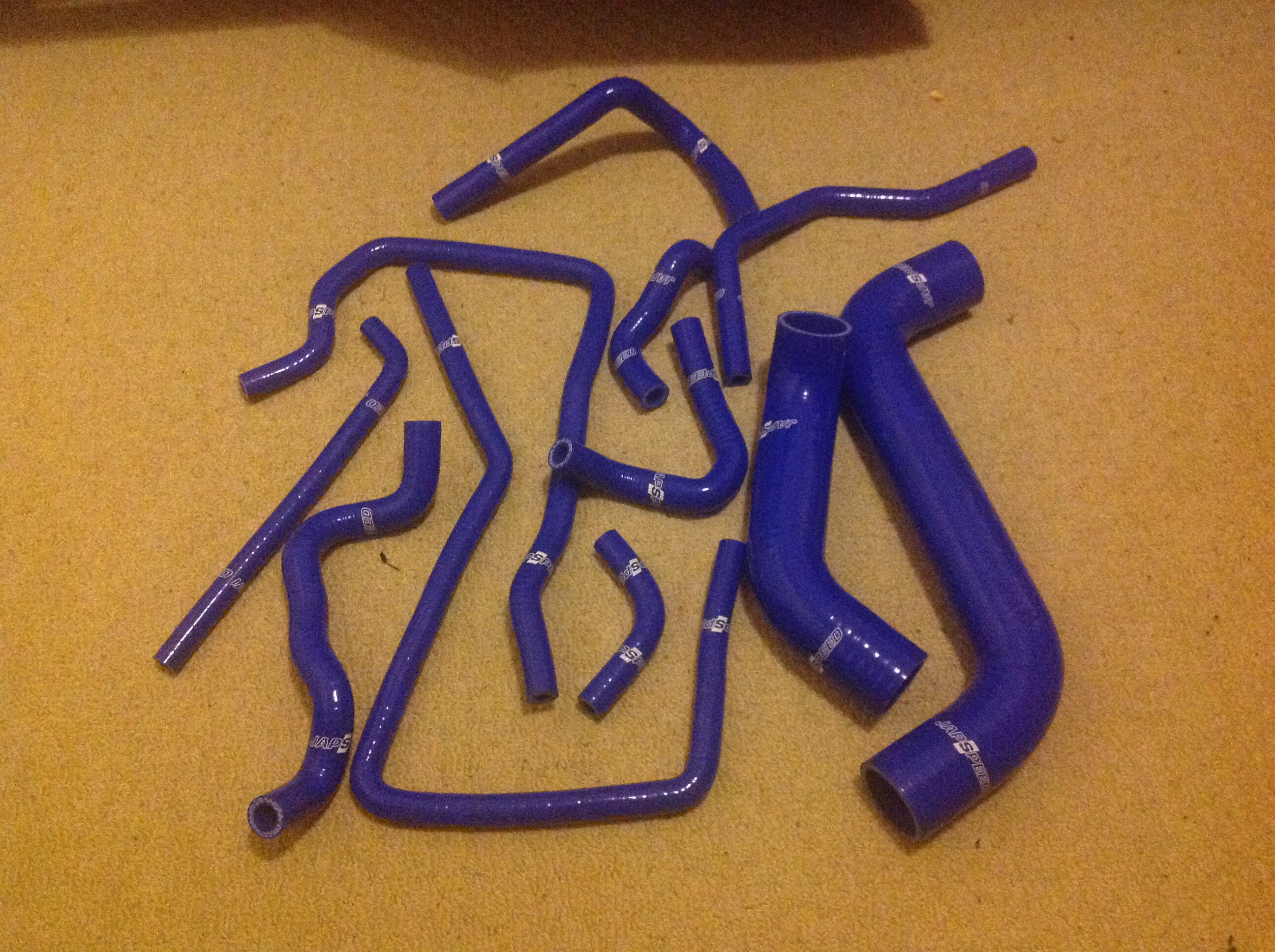

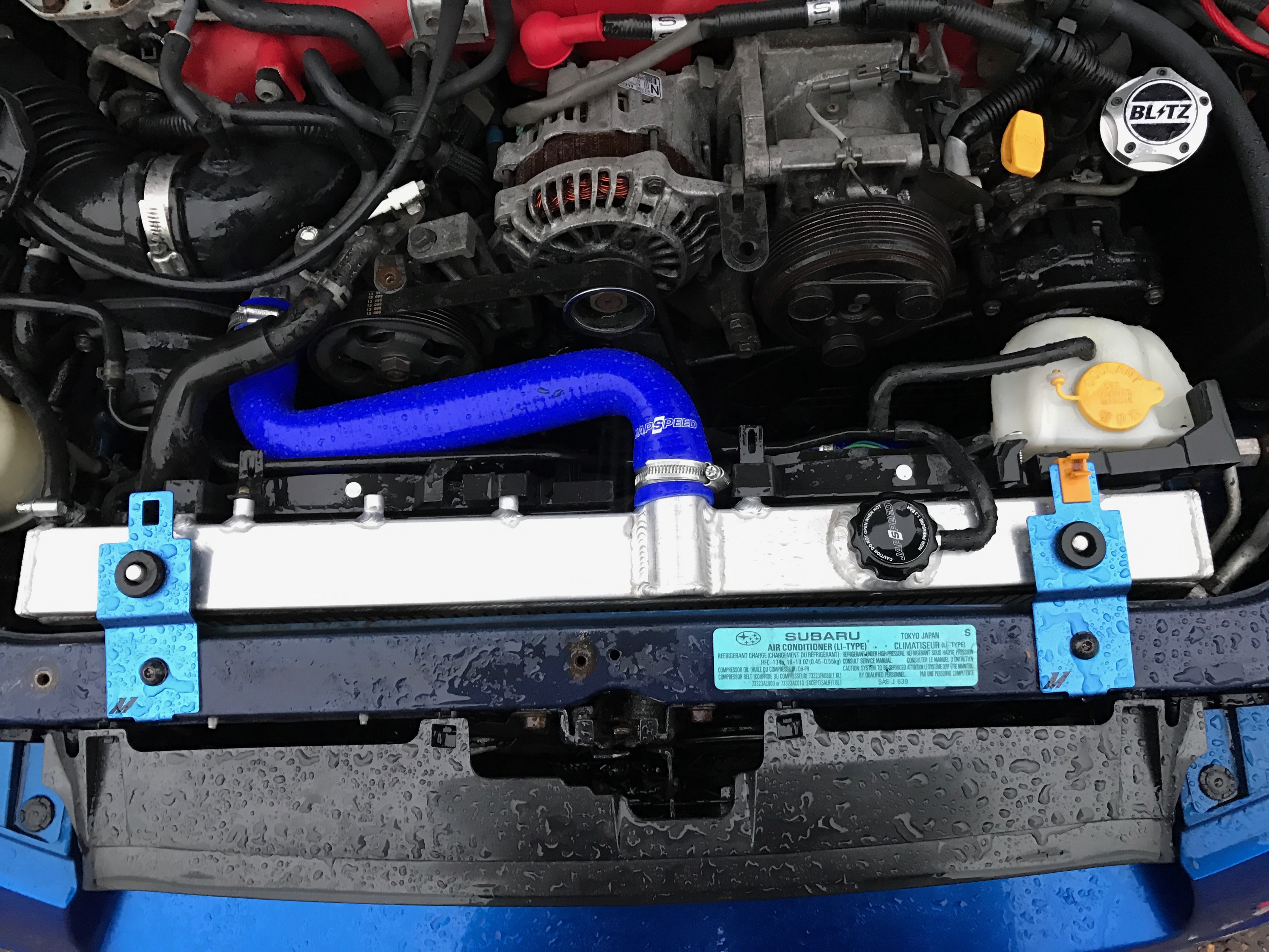

So today I picked up a set of silicone hoses from japspeed but due to the weather ( lashing down ) I've just replace the top rad hose and one from the expansion tank. Also fitted Mishimoto radiator stays.

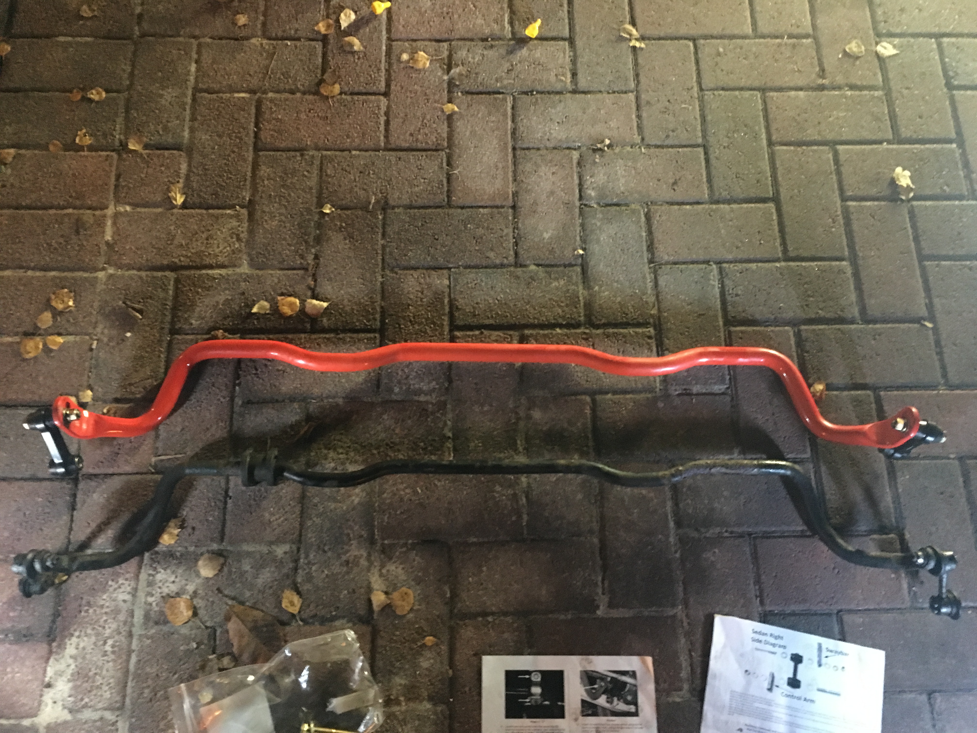

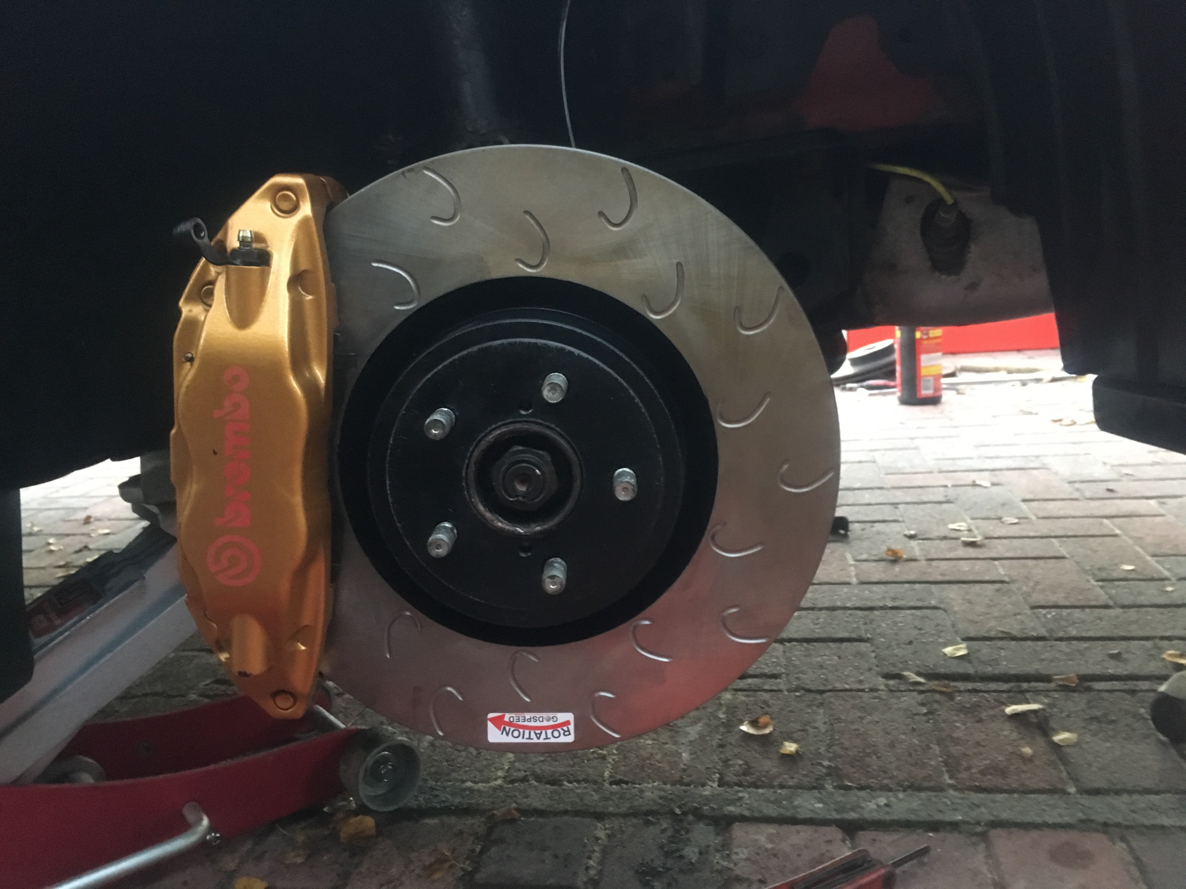

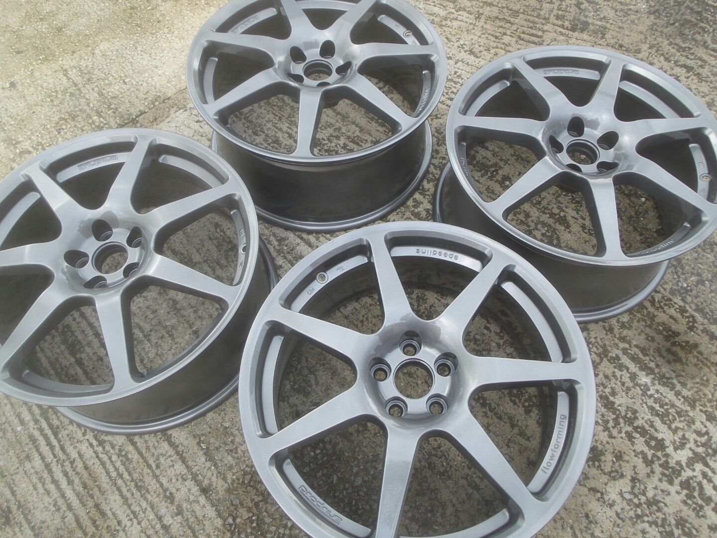

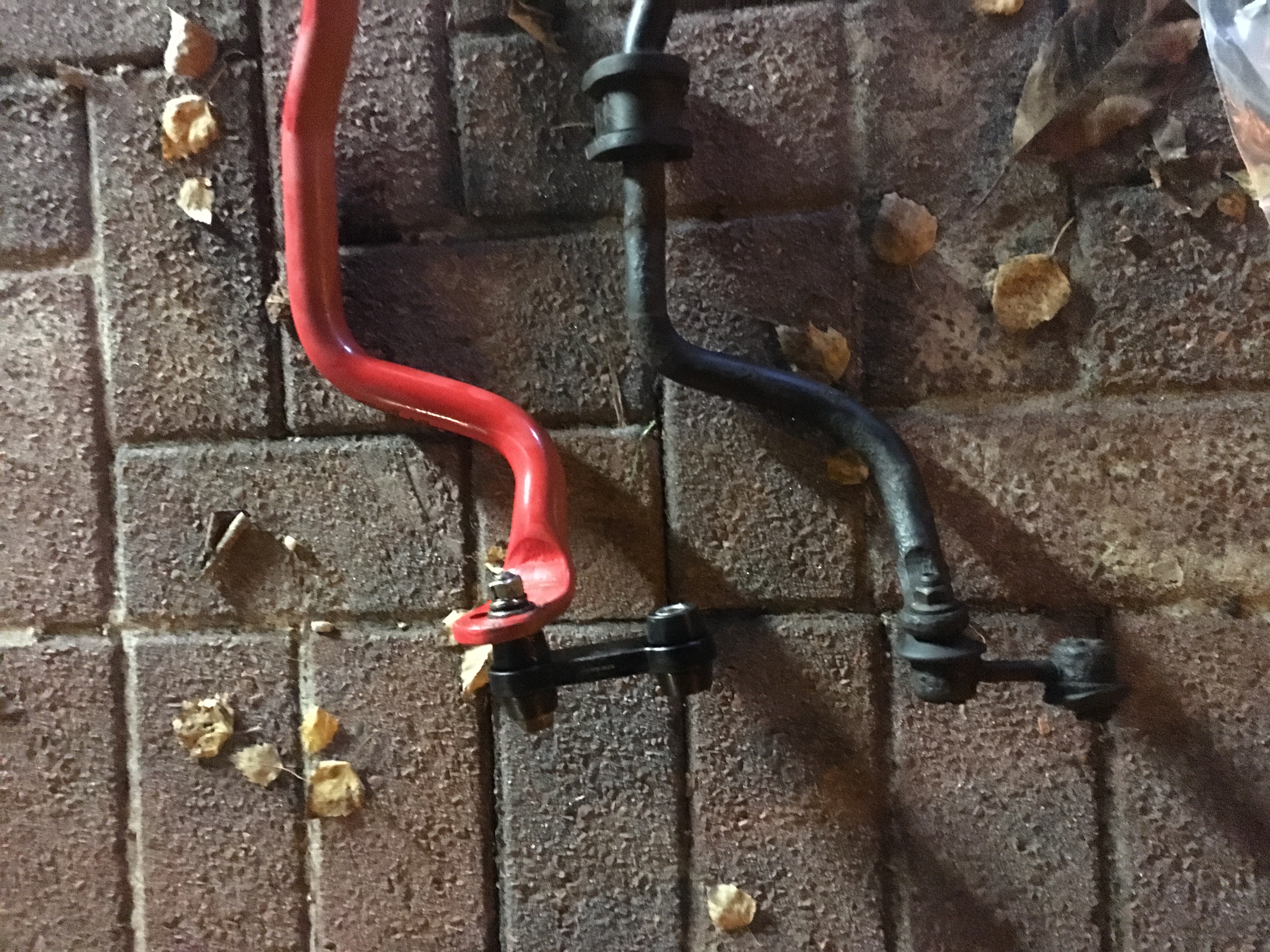

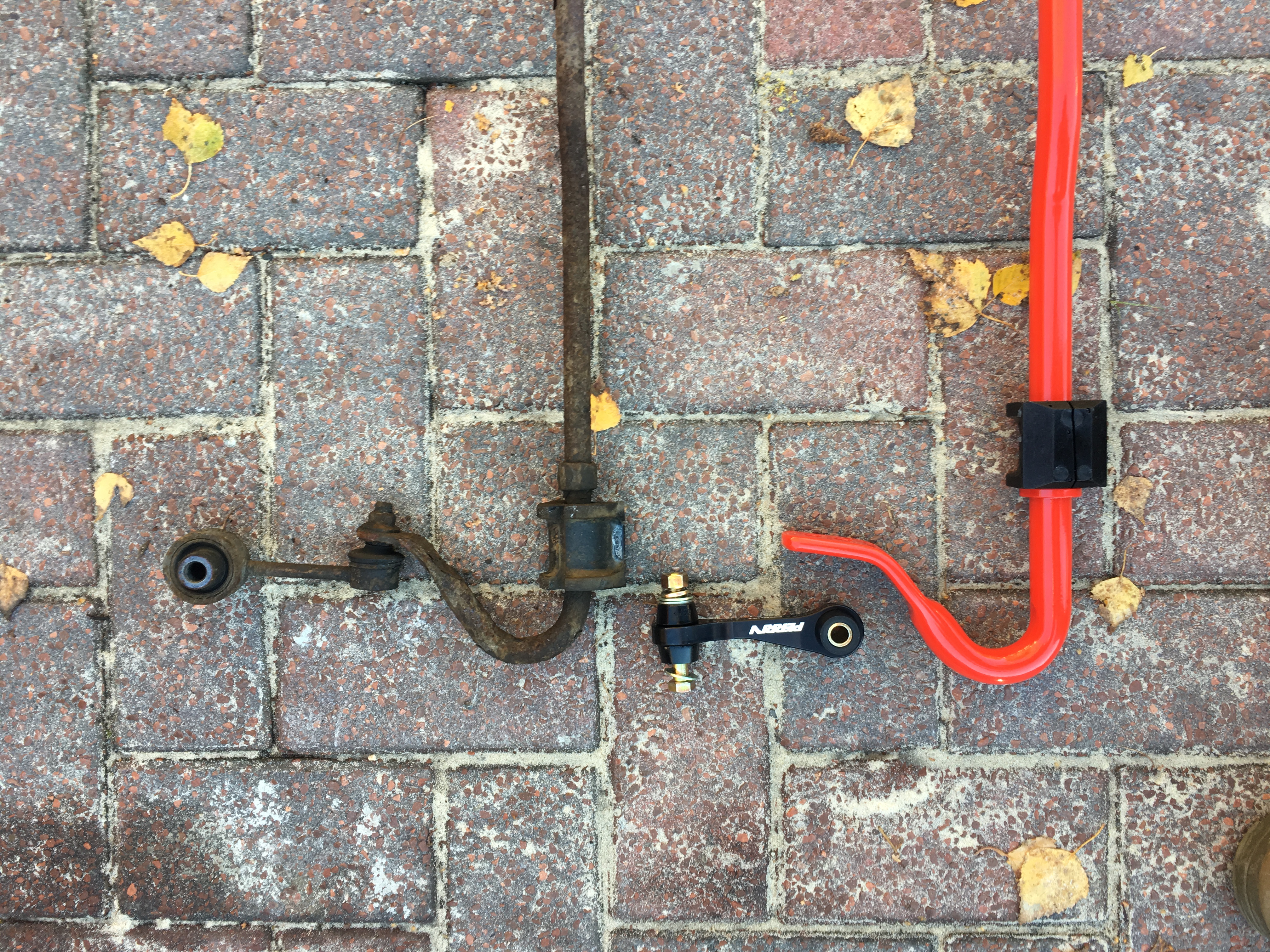

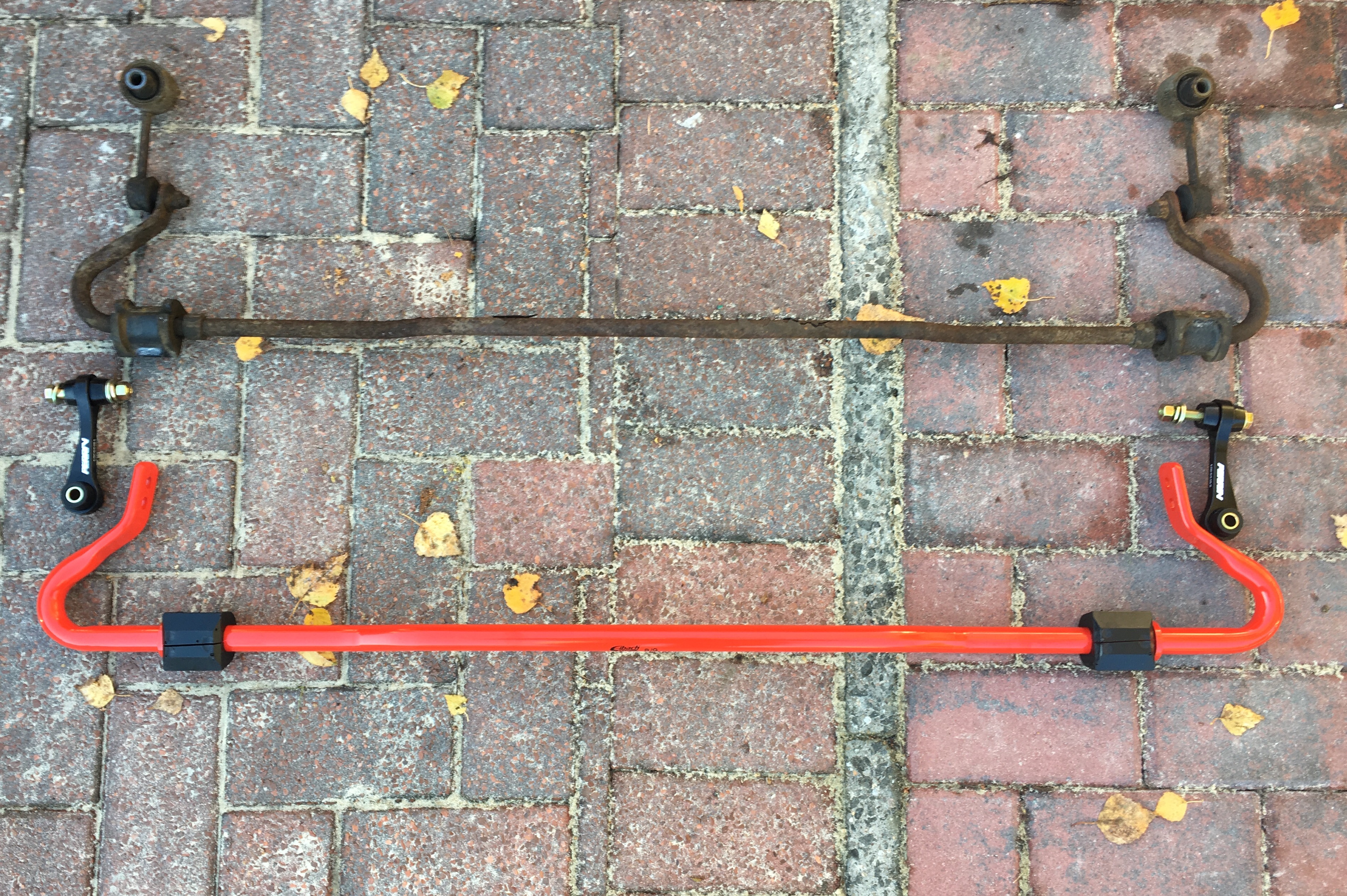

Got some chunky Eibach ARB's installed with Perrin endlinks front and rear, Gold STI Brembos on the front with PFC pads, Godspeed G-hook discs and Technik braided hoses all round. Also managed to pick up a set of Prodrive PFF7 alloys in Anthracite.
What diameter arbs did you go for ?
Rubbed the paint work in the multi storey car park today. Just under the front Skirt and the passengers side. Totally gutted but thank God it's only plastic.
Eibach ARBs are 25mm on the front 22mm at the back. Set on the stiffest setting at the back, softest on the front. Yeah the calipers were in great condition considering they are second hand. Just gave them a good clean 👍
Why so big on the front?
I've seen that kit online and I've always wondered why so big on the front did put me off that kit, most others are bigger rear or same size alround :/
Did a bit of research and decided that was the size that would suit me best. Gives great turn in feel, very flat, but does give a bit of understeer when corning very fast. Could have gone 22mm/22mm offered by other manufacturers to get rid of the understeer but for a daily driver it's the flat feeling that I was really after. Was sick of it feeling like a boat 😂

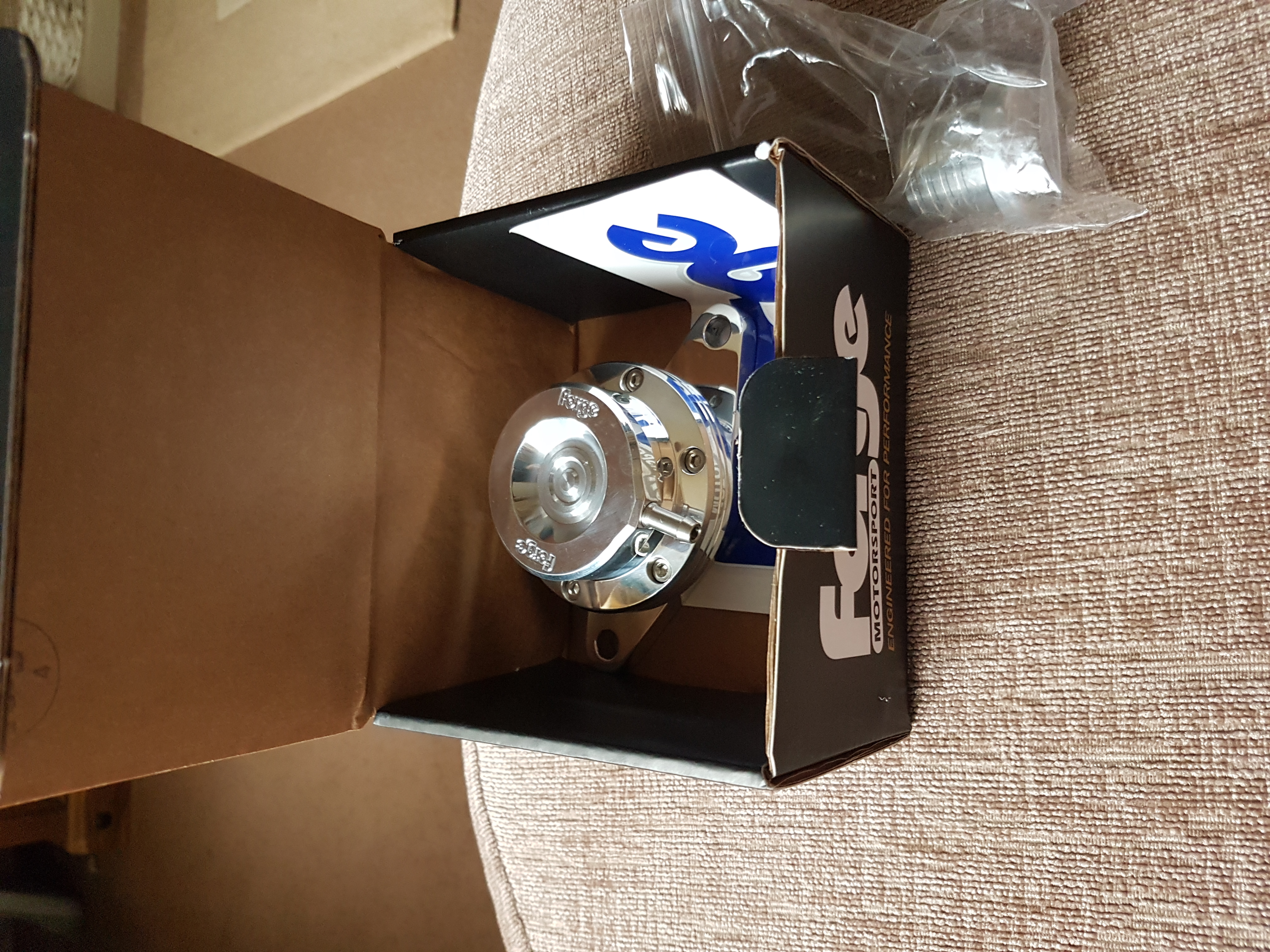

Fitted my dump valve myself. Only a little job I know but feeling proud I could do it. This is a result for me as ive never really been near a car engine before other than checking fluids and oil levels lol. Went for a little drive to my drug (subie parts) dealer who fitted a new fuel pump for me, as the stock one was struggling to keep up with the change in exhaust causing the car to backfire and stall. Had an extended drive home giving it a little welly. And have to say problem solved so far. Also eyed up (reserved) larger spoiler with larger front vent, 17" black alloys ready for next year 😆😆😆.
