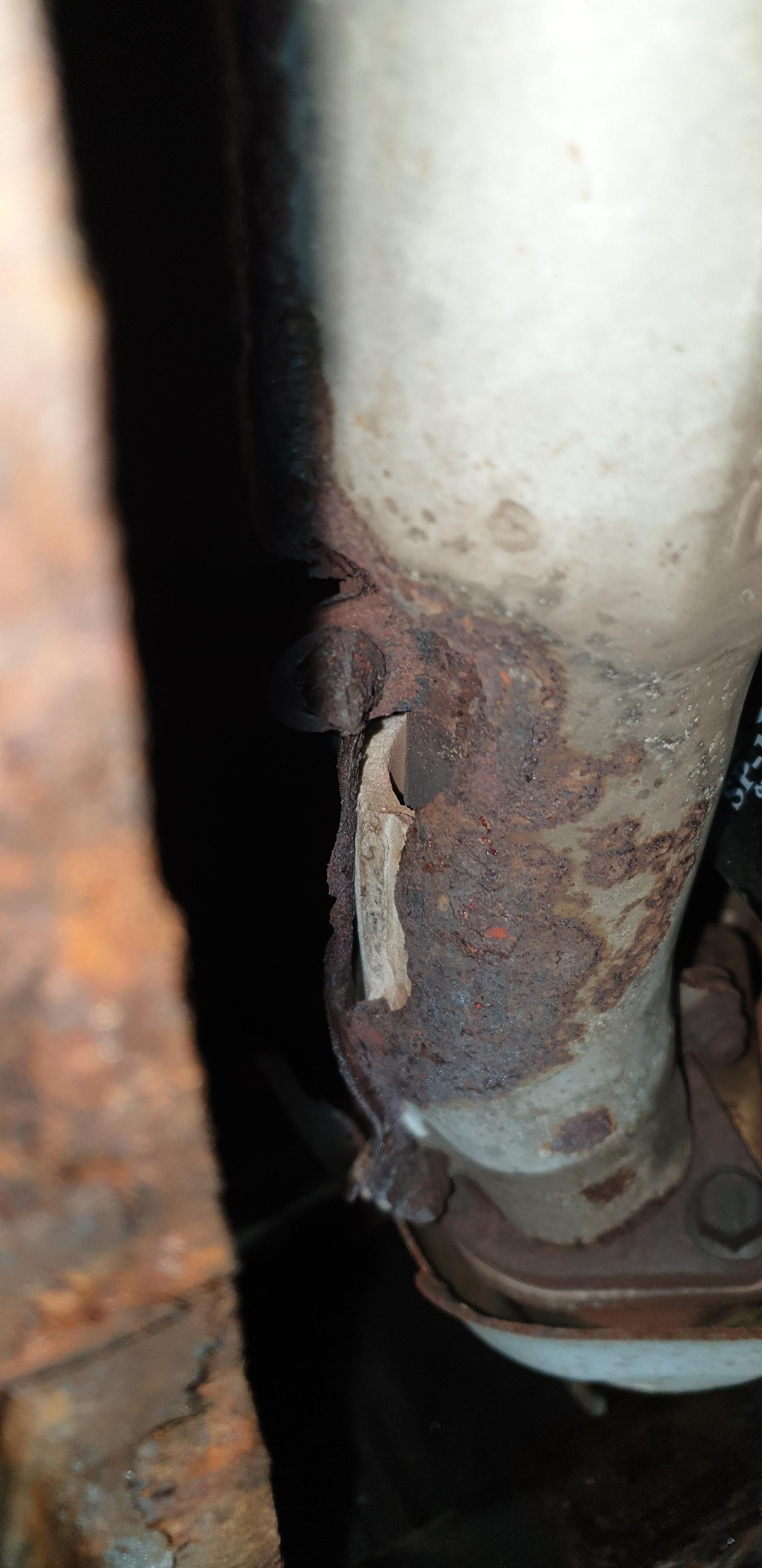

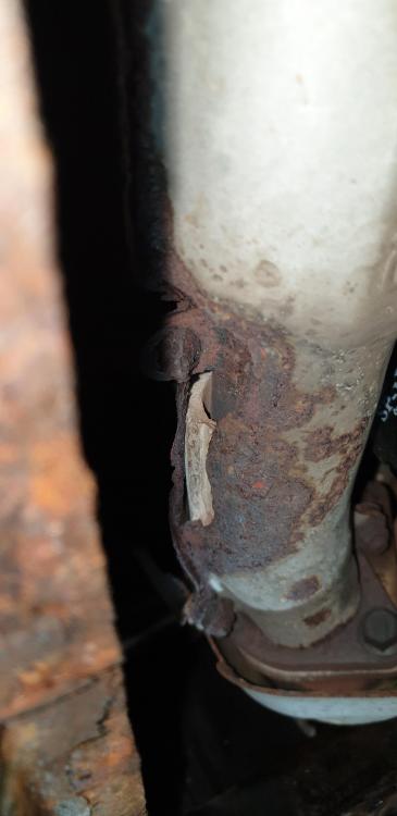

Pretty sure that's the heat shield with the hole in it. Salty roads do that. Not too bad for age. Wire brush and anti corrosion treatment all good.

That’s just the heat shield your looking at mate,

Is that just the heat shield warn through too?

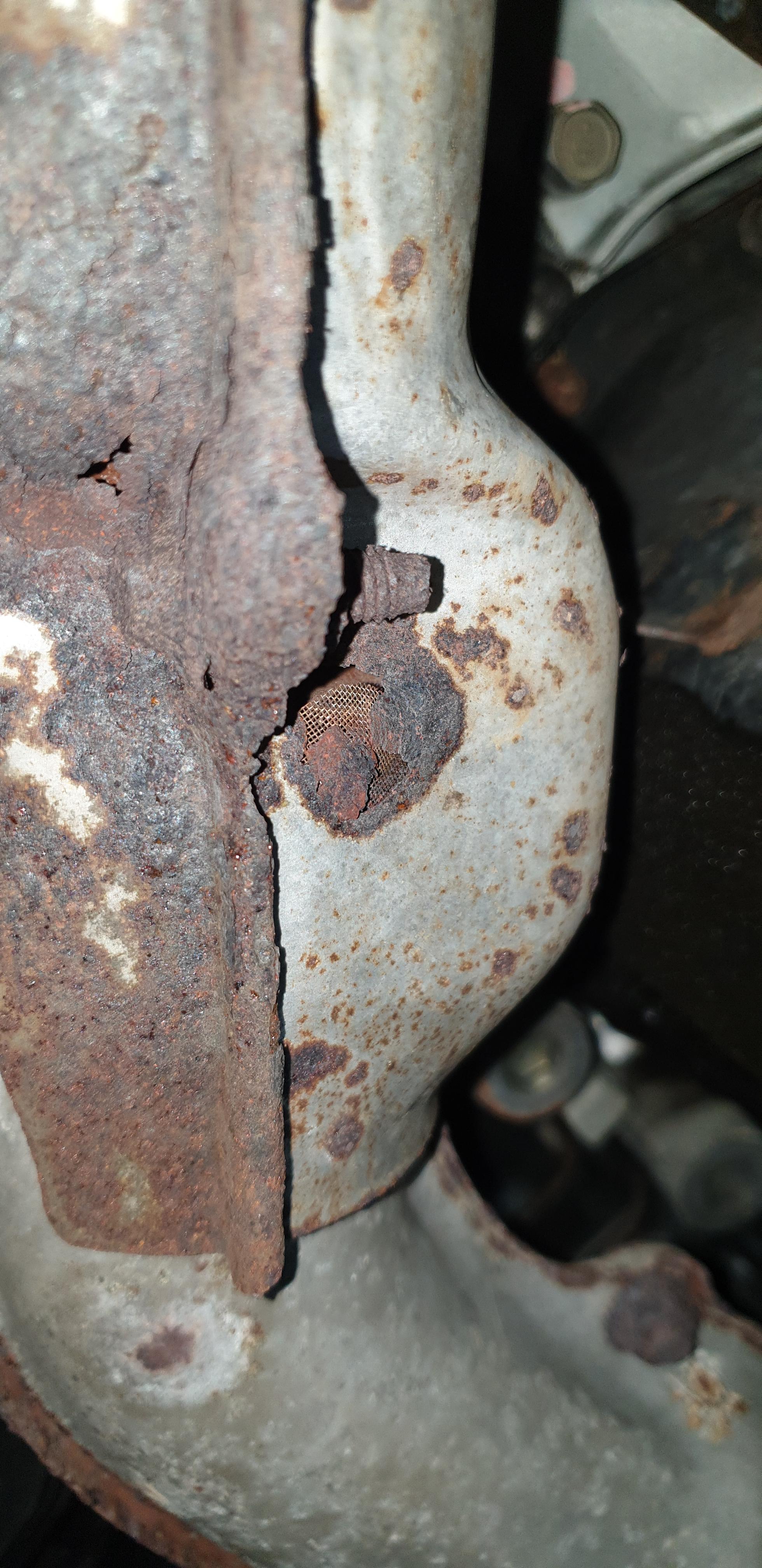

Better pics
Aye mate still looks like heatsheild I think the netting is some sorts of insulation. Best way to tell is run the engine and put so card or paper on it and if air wafts it about then it’s a leak. Obviously be careful it’s extremely hot
