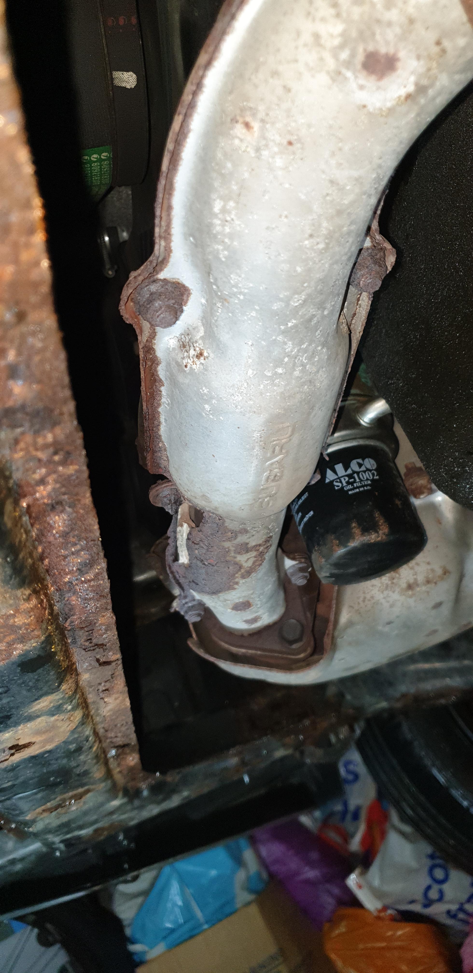

Under the plastic guard

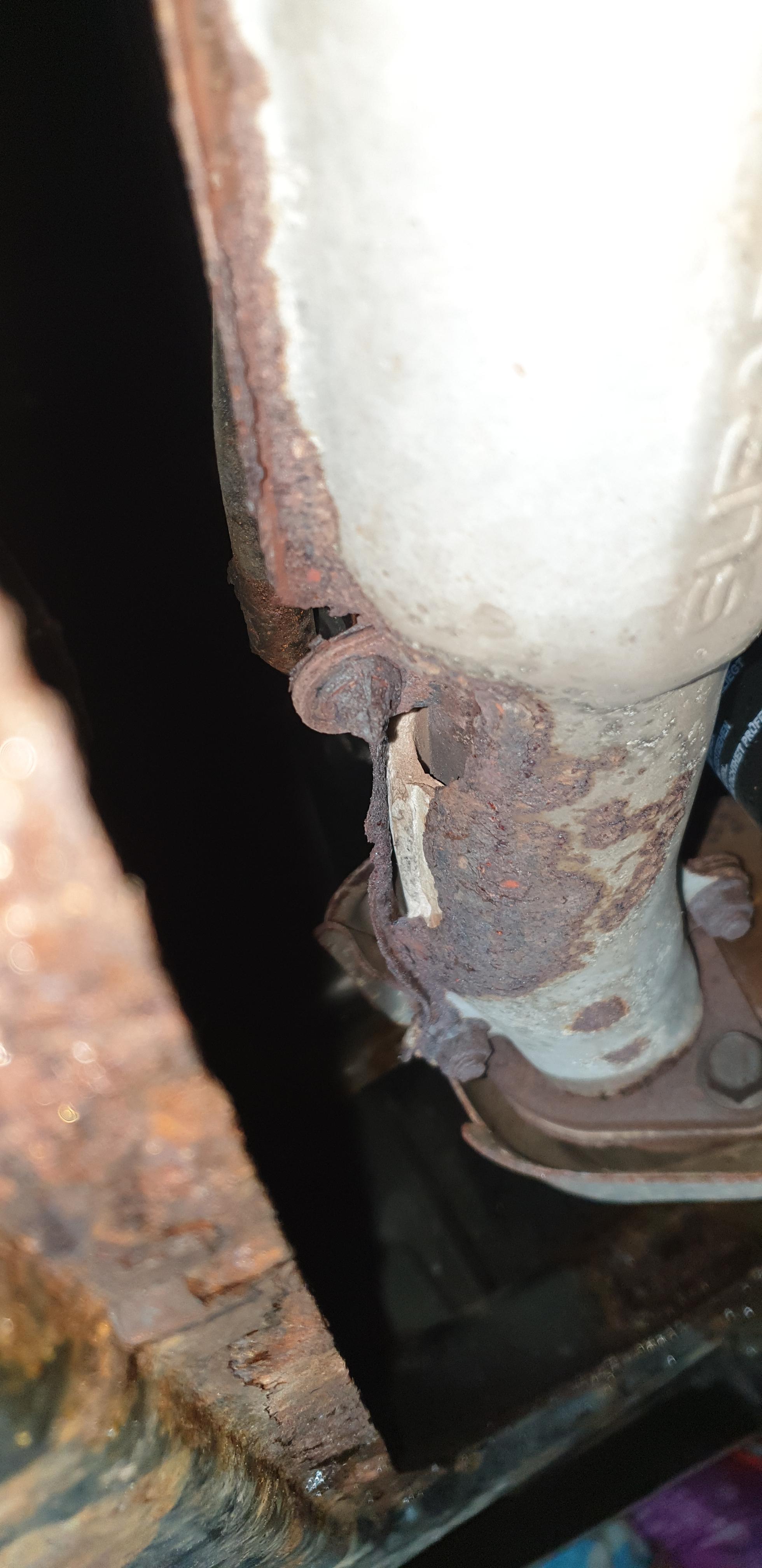

Wonder if this is the problem set the hole ?
